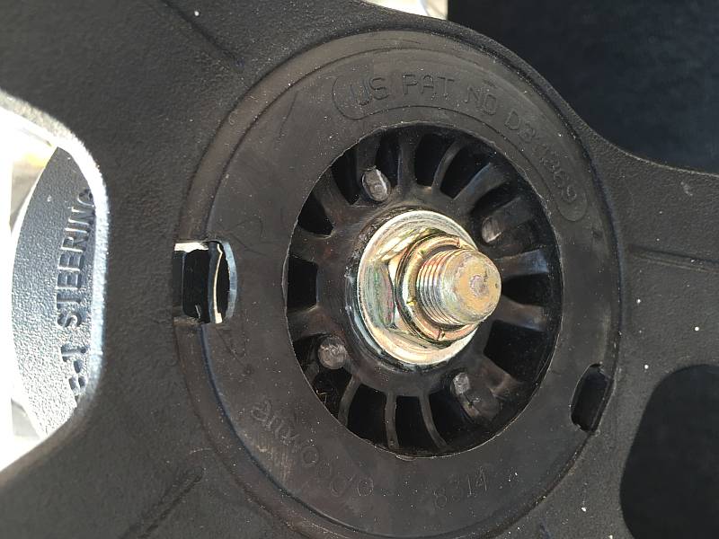

Need to do two things to my Teleflex Safe-T QC II steering. One is figure where the squeak is coming from so I need to remove the steering wheel and need to know the best/right way to pull it (see pix)

I would try a couple drops of oil between the wheel and the helm cover first. If that's not successful, remove the lock nut shown in your pic and pull the wheel straight off. The helm cover (plastic) should come off as well.
You will need to disconnect the steering cable sheath from the helm, then crank the wheel whichever direction sends the cable out of the helm.

I remember when mine had a squeek The steering wheel was rubbing on the back side .Remove the nut... take the wheel off . center the motor... put the steering wheel back on straight ! put the nut on to center it !!

Ok! Got the steering wheel off...with a little PB Blaster, a bit of carefully placed heat and a tap or two on the nut and it popped right off! The squeak turned out to be the shaft rubbing on the plastic cosmetic cover. Easy fix.
Steering wheel sitting 120° off turned out to be an easy fix too. Wheel is indexed by a key/slot in the shaft, wheel has three 'slots' P.O. mounted the wheel 120° off for some reason.. maybe one too many beers... hehe. Back together and steering is level when motor is centered.
