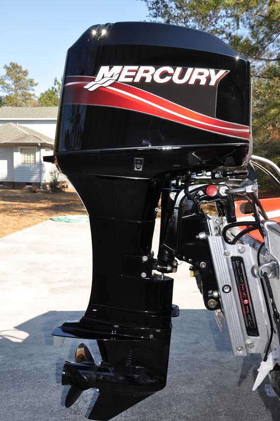

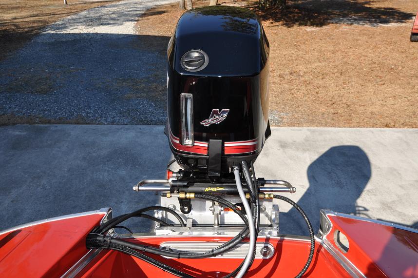

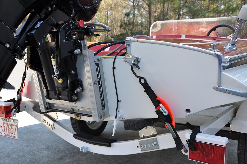

Jack:
You are very welcome on the info Sir!
The hydraulic jackplate that I have on our boat is from "Bob's Machine" down in Florida. The model is the "Ultralight", Part#
100-10400. Here is a link to the exact model Jack:
www.bobsmachine.com/4-Setback-Standard-Series-LIGHTWEIGHT-Jack-Plate-115hp-100-104000.htm
This model has a very minimum setback of about 3 7/8" although the wesbite calls it 4". It is light and has worked flawlessly on our G-3 since 2009. Their customer service is excellent and the maintenance on the unit is very minimal.
Jack, I was initially told by other G-3 owners that you could NOT use a jackplate on our G-3's due the short transom, but that claim
is TOTALLY FALSE! As I have said before, I see no "downside" to having the hydraulic jackplate on our G-3 and feel it was a good choice by me to add it to the boat.
Here are some photos for you Sir:
Jack, my newer Mercury 50 has a 20" lower unit versus the 15" lower units that are on the older Mercury "Tower Of Power" Models.
That was why I went with the jackplate as I didn't want to build
my transom up to 20" as I don't like the way that looks. Also, on my G-3 you don't have to have the jackplate up very much to get the "skeg" of the motor "even" or close to even with the bottom of
of the boat as the "experts" claim. The way ours is set-up, the jackplate is about 1 1/2" to get that skeg even, although I was
told by some that it would have to go much higher than that.
But,.....it doesn't! With a Mercury "Tower Of Power" like you are interested in you wouldn't even have to worry about that.
Hope this has helped you some Sir.
John

WOW thanks for the quick response. Pic's are great. If I'm understanding you correctly any motor with a 20" shaft could utilize the jack plate rather than perform the transom modification.
Thanks again
Jack not Sir please

Jack:
Again,...you are very welcome! I remember when I first inherited our G-3 from my Dad after he passed away and being on these classic boat websites trying to get information from other G-3 owners. I know how important it was to me to get back info quickly, so I am glad all of this has helped you Jack. ;)
Yes, you understood me right, you can install a hydraulic or "fixed" jackplate on a G-3, then mount any newer 20" lower unit outboard to that jackplate. You can also bolt one of those older Mercury "Tower Of Power" Outboards on that jackplate too. And as you noted, by using the jackplate you avoid having to "build up"
the original 15" transom to 21-22". Or, you can just find and buy
one of the older outboard motors with a 15" lower unit and bolt that directly to the original transom.
