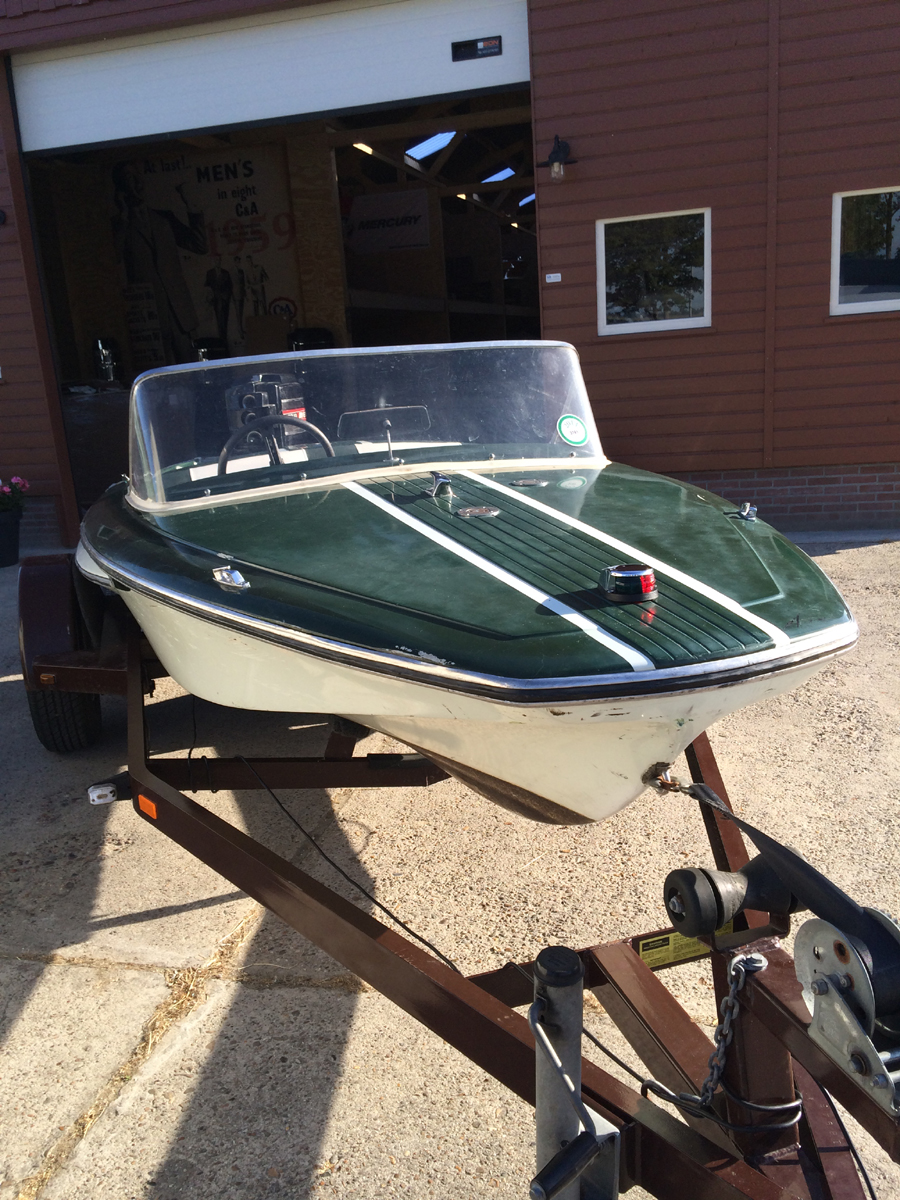

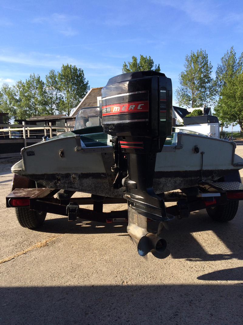

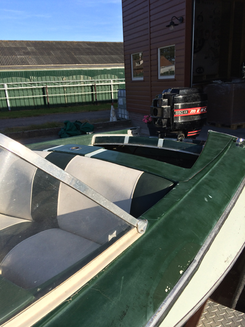

Picked up a boat yesterday that is very similar to the 1961? G3 centre deck. It is made in Belgium under the brand name "Eco fiber" modell F100. Boat is in 95% original condition including original gel coat and green color. Even the seat has the original fabric in very good condition. The windshield also original and perfect condition for it`s age. Boat came without motor. Saw a few of these boats on yoe tube with motors up to 150 Hp. I like to be advised on what motor is good or best for this boat. I have several short shafts to choose from. Mark 55, 75, 78 Merc 850 `64, 650XS, 850XS Lwpu, 70Hp `82, Merc 1350 `71 or 1500 J block `74.
I did hang the 650Xs on the boat for the pics and that looks pretty nice.

It appears you have a really good find, nice, original and unmolested.
Thanks for posting here. I read somewhere that in 1960/61 Glasspar provided moulds along with a licensing agreement to a couple of European manufacturers.
Yes, it is the same except for the starburst badge at the front of the sponson and possibly the windscreen (your screen looks different).
The G3 has some curvature in the vertical dimension and it may be that your windscreen has been replaced at some stage. Original G3 screens are next to impossible to find and with multiple curves not so easy to reproduce.
That's quite a collection of motors you have to choose from – which will it be?
Enjoy your boat, it is a heap of fun.

I should add, in response to your last question, maybe the 70hp or one of your 850s would be most suitable match, and would give you a top speed of around 50mph (80kph). Bigger motors have been fitted to numerous G3s but in most cases modifications have been done to the hull bottom, such as adding a pad (like a ski plank) to prevent chine walk and improve handling at speed. This boat was not designed for high speed and if it is speed you want then consider (and research) options in making suitable modifications.

I noticed some difference between the G3 and the eco fiber. But basically it`s the same boat. The windshield of my boat is the original. It even has the original decal on it that says "Gecoplast" or something like that. Will make a picture of it. Another difference is the hole for the water ski pole with a floor mounted piece of metal where the pole fits in. I also have the ski pole.

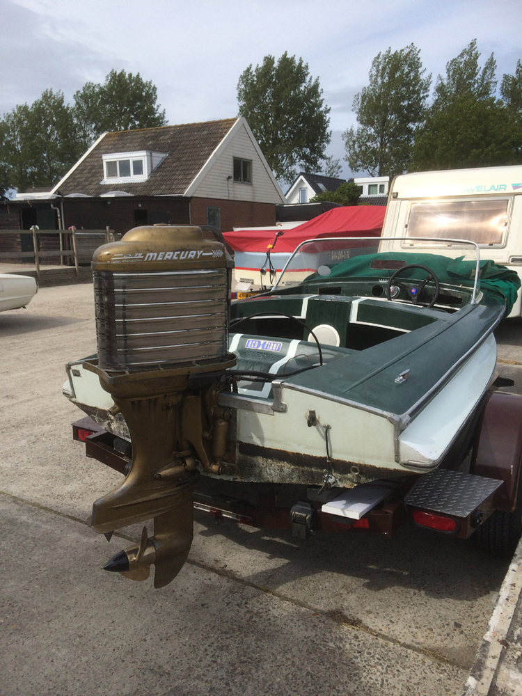

She found a good home indeed. I hooked up the Mark 78 and it looks pretty good. I have to make a new gas tank under the bow as the old one has gone. The boat looks very solid with only one soft spot in the floor behind the front seats.
