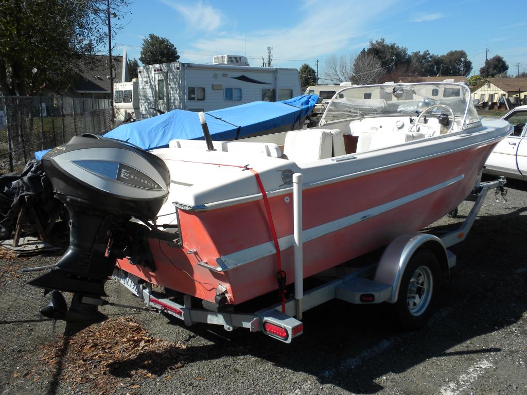

Thanks all for the 411. As far as transom strength goes, I allready discussed this with the fiberglass guy I got an estimate from, which includes transom rebuild, new bulkheads, stringers, and cockpit sole,(floorboard), and 3 more layers of fiberglass to the hull. He assures me It'll be a brick $###house when he's done with it. Here's a pic of what it currently looks like, 52yrs old but still turnkey.

Am going with the standard Evinrude 90hp inline 3. Went to a dealer to look em over and the 90hp HO V4 just looks like too much motor, size wise. Also the extra weight might be enough to make the boat stern heavy. Will have to alter the transom height a bit to get best cav plate location tho.
