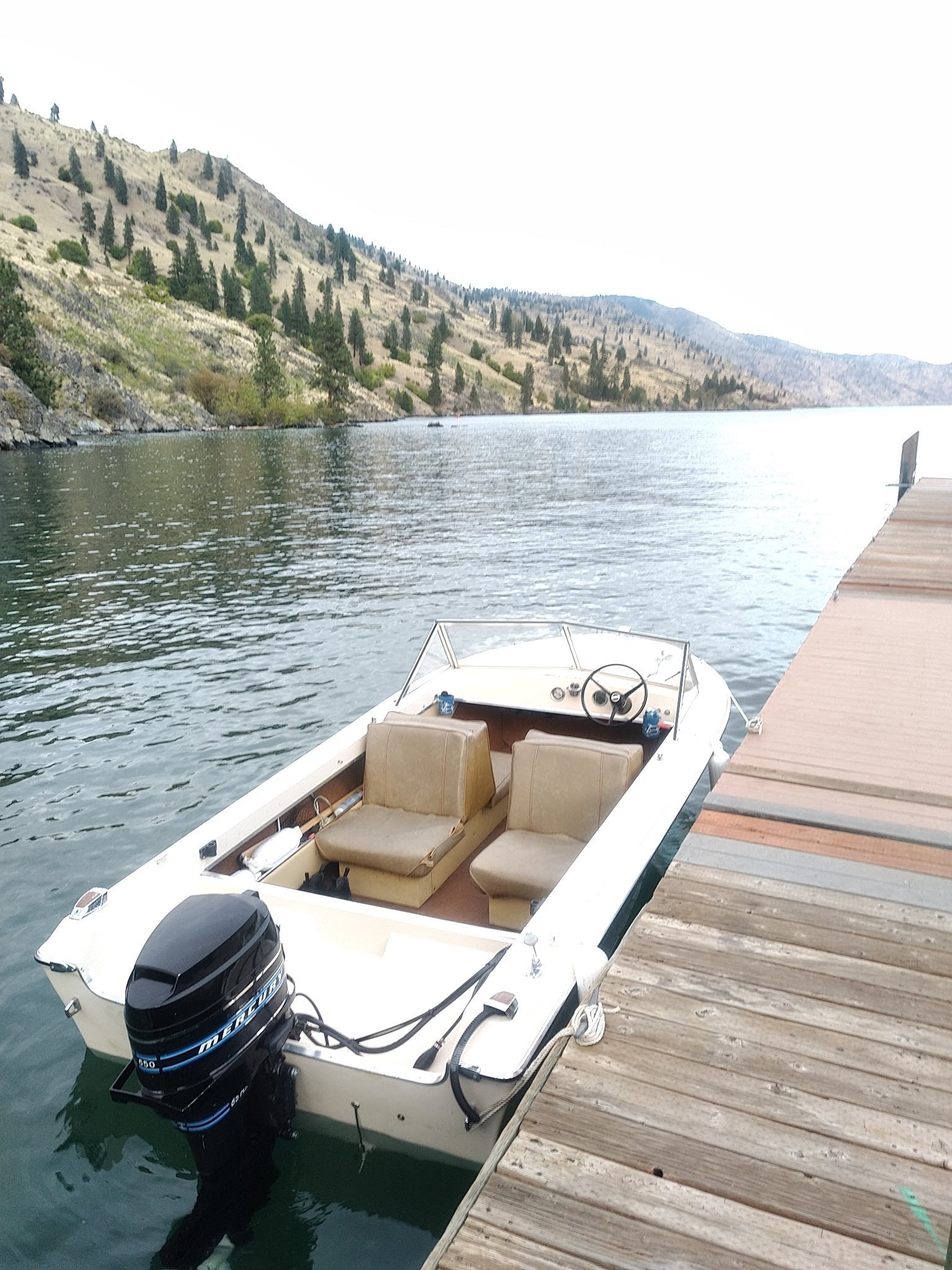

This past spring I purchased a 1970 16' GlasPly with a 1971 Mercury 650 4 Cyl on the original Holsclaw trailer in nice original condition. I work at a boat shop and had a customer bring it in for new control cables, the customer didn't like the price because he was going to put the boat up for sale. I purchased the boat for $1100 then sold the 1980s Suzuki kicker motor for $550.
I bought new cables but couldn't get them adjusted correctly so in creeping on here I found Dr. Frankenmerc and made the drive (not far from me) to have him go though my Mercury.
Doc put in my cables, rebuilt my control box, did a water pump service, serviced the lower unit, run checked the motor - and with a clean bill of health we were ready to hit the water!
We went to a few small Washington lakes with lakeside camp grounds and then when I was confident in the boat we took it boat in camping at the north end of Washington's Beautiful Lake Chelan.
I'm lightly restoring/repairing broken or worn out things, but I really enjoy the "nice original" look.
Looking forward to many boat-in camping adventures next year! Thank you FG community and Dr. Frankenmerc!

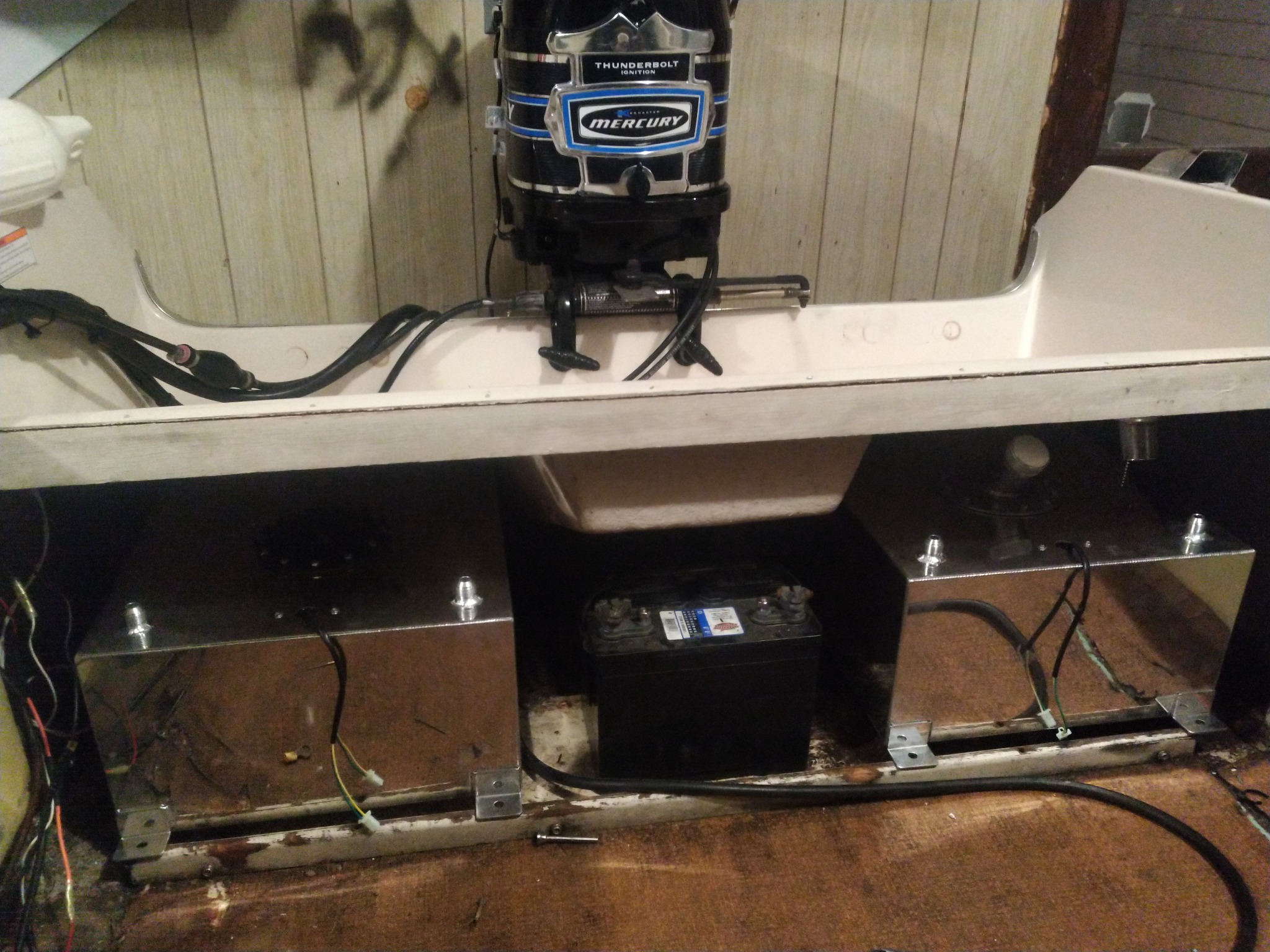

When I bought my 1970 16' the factory below deck tank was removed and there were 2 6gal portable tanks in its place. This was fine except I needed a bit more fuel and ideally to even out the boat a little so it wasn't listing. I was going to make a couple of fuel tanks, then I ran across these 10gal fuel cells with AN fittings for a good price and they fit almost perfectly below the splashwell. I will have a lower crossover to balance the tanks, breather lines connected across the top and 1 fuel feed line to the filter/engine drawing from the STBD tank. Yes, I know CG regulations on unleaded tanks, crossovers, drawn from bottom... Blah, blah, blah... Simply put, I don't care. It will be leak proof and safe before I hit the water with this new setup and it's still FAR better and safer than a 50 year old rotted out steel tank. I will now have the capacity to make the trip safely to Stehekin, WA. And back from our camp site that is about mid-way up lake chelan. Waiting for the fittings to arrive to finish the tank install. Next will be rewiring the whole boat to a busbar/fuse block instead of everything ran off 1 14gauge wire from the battery without a fuse....
