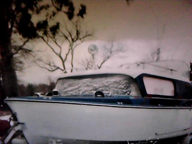

i need information on best way to start restoration :unsure:
Re:57 larson boat 15 years 3 weeks ago #41162
getting the snow off would be a good start... its aug, cant believe you still have snow :P
how long has it sat? what shape is the floor/transom in. Its prolly going to need a floor and transom. They are very intimmitdating jobs but actually pretty easy. While your in there you will want to put in new stringers too.

thanks for the information hoping to getthem indoors this week.they have sat for years ten years ago i worked on the larson and took it out till steering broke . i hade a leak then .so will probally have to see if i can fix the hull.would be grateful for more sugestions as .i go .thats not snow yet

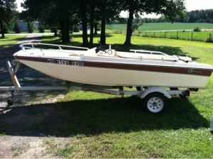

i got this for free today nice little boat
