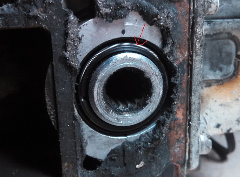

Attached it a photo. The spring retainer around what I guess is the seal at the bottom of the shaft was hanging loose when I removed the mid and lower units (I put it back in place). I think I read somewhere this could indicate a problem with the shaft (which I'm guessing could be a big deal). What do you think? I'll have to recheck the compression once WI weather permit.

Image above now. Since the spring retainer (see red arrow) was hanging part way off when I dropped out the gear case, my question is, is that an indication that the crankshaft, seal, bearings, etc. may have problems, and can I ck that? Thanks.

Doesn't necessarily indicate their are any problems. If the seal is not sucking wind and the lower compression is good then put it back together and test run it.
