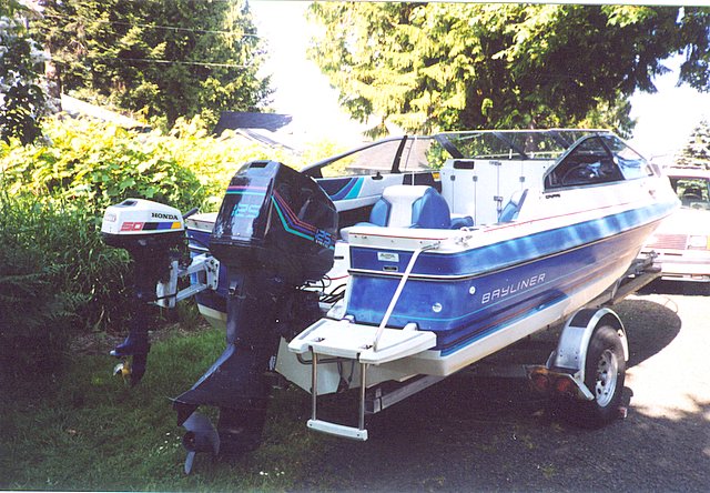

Might as well get something going here. I don't care what some say about Bayliners/Force. Mine is one the best "does it all" boats owned! 1988, bought used 20 years ago, slipped in salt, takes a licking and keeps on ticking!
Only problems been a bad stator (known problem, starts dropping fire to one or more plugs)), upgraded to Merc, and zero problem since. Also snapped a driveshaft, but it was corroded up top from salt, and hit a log and had to replace that. Otherwise, still runs great. Only one bit of caution that motor. NEVER EVER pull the side screw in the bullet the L/U. Thats NOT the drain plug! It a long bolt that holds the shift fork in place. Ya pull that, the fork drops, and the guts need to come out to get it back in. Drain is way under the nose, small hex screw.
Pic the beast.

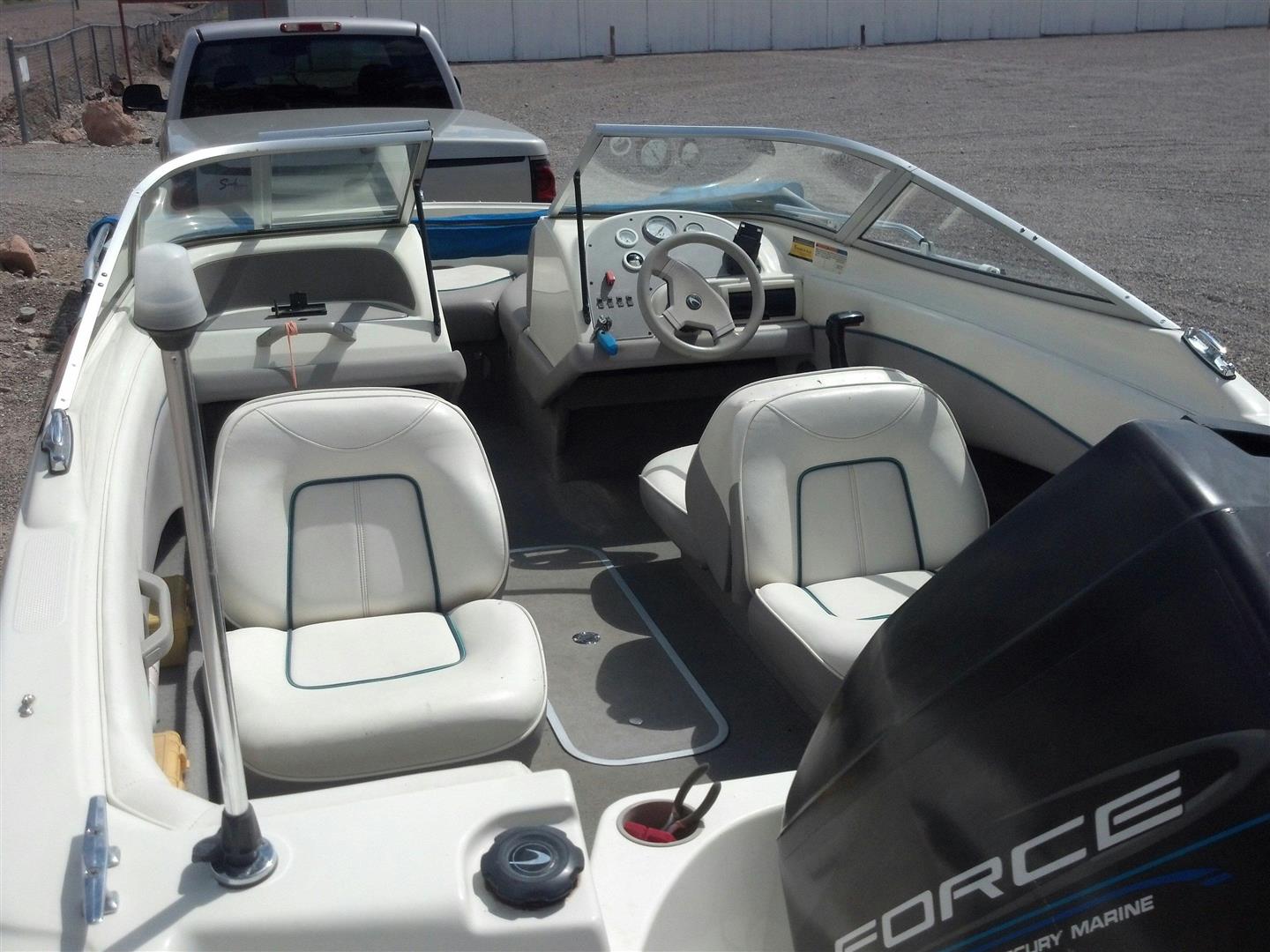

Checked it out today. Clean boat, and that 120 runs real well. Tons of power for a 17 foot boat. Floor and transom are solid. Seller says it will hit 50 mph with one person aboard. I didn't bring my GPS but I would guess we hit 40-45 with two on board, with the motor trimmed out. The lake was glassy but we did cross our own wake a few times at speed and it handled that well. I like the lines of the boat as well. Sporty.
It followed me home.

Looks pretty nice Norm, congrats! ;)

Thanks Mark. Not a Glassic for sure, but a nice boat for a 20 year old. I crawled over under and through it all day today and everything looks good. New Interstate battery, dual battery setup, all new load range C radial trailer tires, Blaupunkt stereo with 50+ watts per channel, fish finder, everything works. So, yet another boater goes over to the darkside, Bayliner ownership! This will give me time to work on the Glasspar and Merc 650 without starving for lake time.
Tomorrow morning it's back to the lake to wring it out and decide where the rod holders will go. I did take a few minutes to uncover Swee' Pea (the Glasspar), climb aboard, and talk nice to her, so she won't feel so bad about staying home this time. I think she took it well.

Looks like excellent shape for its age! Have fun with it!

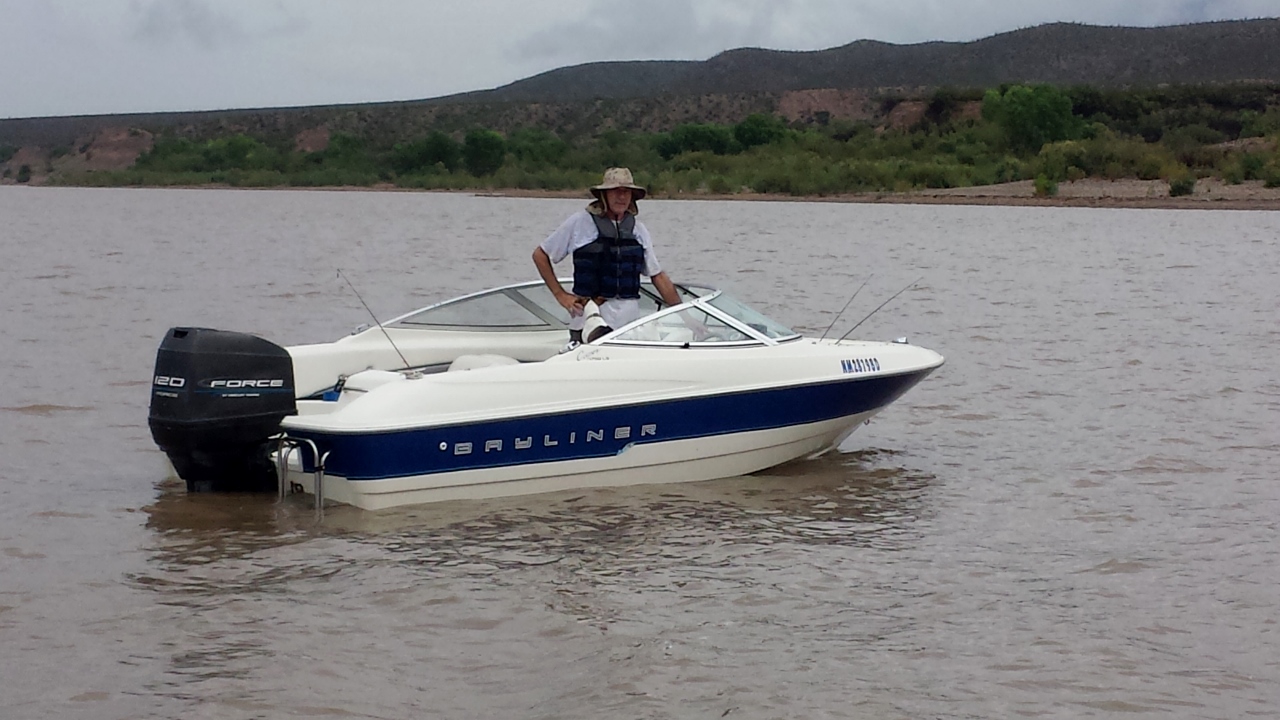

I will, Robby. It ran great at the lake today. However, the prior owner's tales of 50+mph must have been based on the now non-working factory speedometer. Best I could squeeze out of it was 40mph, using gps for speed readings. Still, pretty decent. Also idles down to trolling speed of 3mph and idles along nice and smooth. I ran past my son's boat at speed a couple of times and he says it really trims out nice, only a small amount of hull in the water at full speed. Very stable.
Never heard of this setup before: The pitot tube that drives the speedometer is located inside the lower unit on the 120. From what I hear, it's common for the speedo to stop working after the owner changes his impeller. Mine was changed within the last year and Voila, no speedo. I guess there's a tube that folks forget to reconnect in there.
When we launched today it was raining pretty hard. The photo is me right after the rain stopped. I was wearing the ski vest and boonie hat to stay warm!

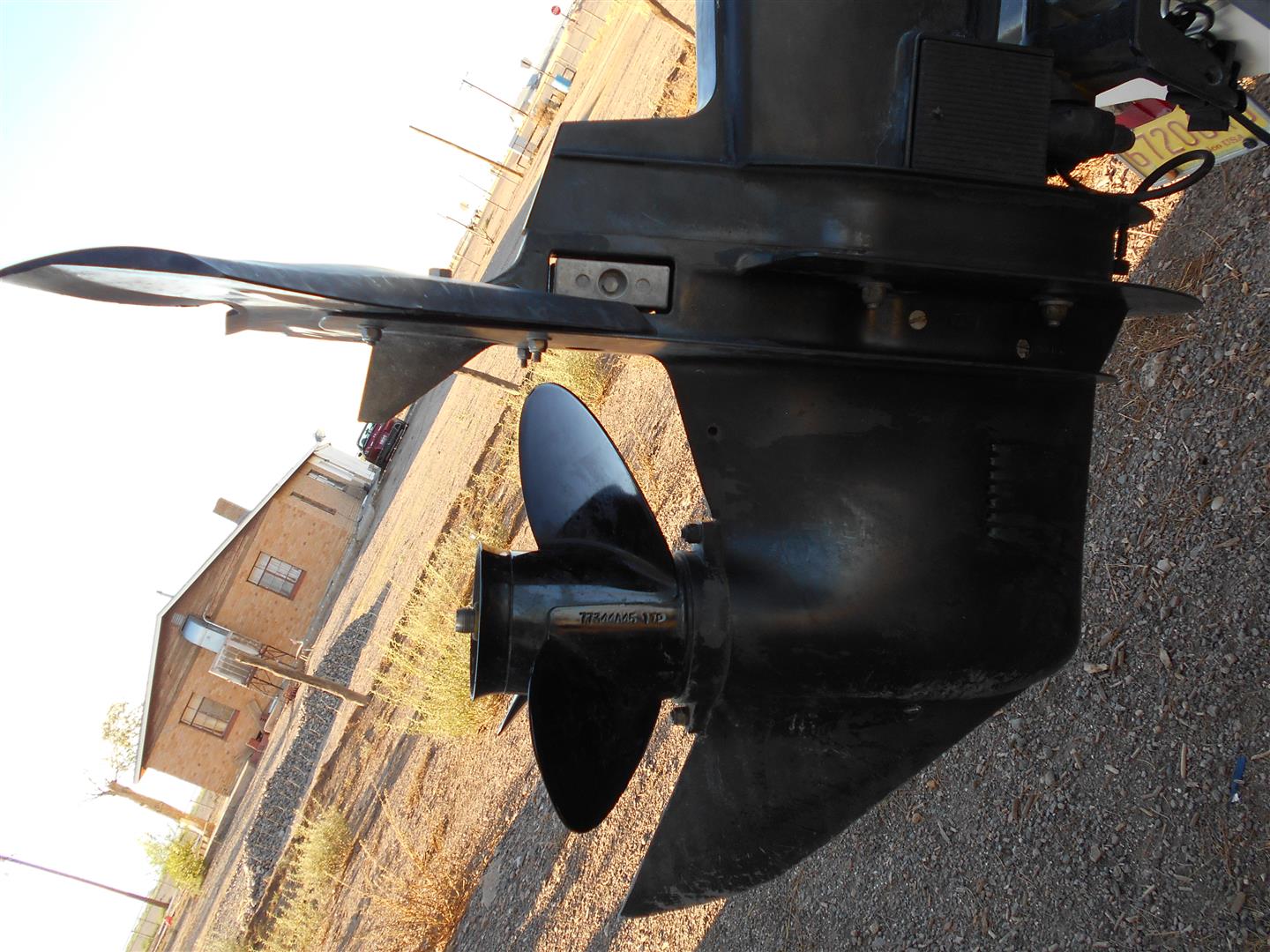

I'm glad you brought that up Robby. Examining the motor and the diagrams, I believe the 120 Force I have is actually newer than 1994. My lower end is more like a 96-97. Doesn't have that troublesome screw, the fill, vent and drain plugs are all on the right side of the case, the skeg and bullet are shaped different, the anode trim tab is a different design, and the cooling water inlets are in vertical rows on each side of the case.
Looks like the original owner (I'm the 3rd) changed out the motor. Had to be done over 7 years ago. Title still reflects the original motor number, my state MVD has no provision to update the titled engine number on boats. Haven't found the serial or model number on this one yet. Sure does run nice.
Oh, and that curly looking black tube on the front of the case is the speedo tube where it enters the lower unit. I agree, I really don't need it, my phone has a gps speedometer in it.

And the plot thickens! I searched some, and came up with this. Looks like its a Merc L/U/Force PH. So it could be a 1995? Says no more Force made 1996. Link

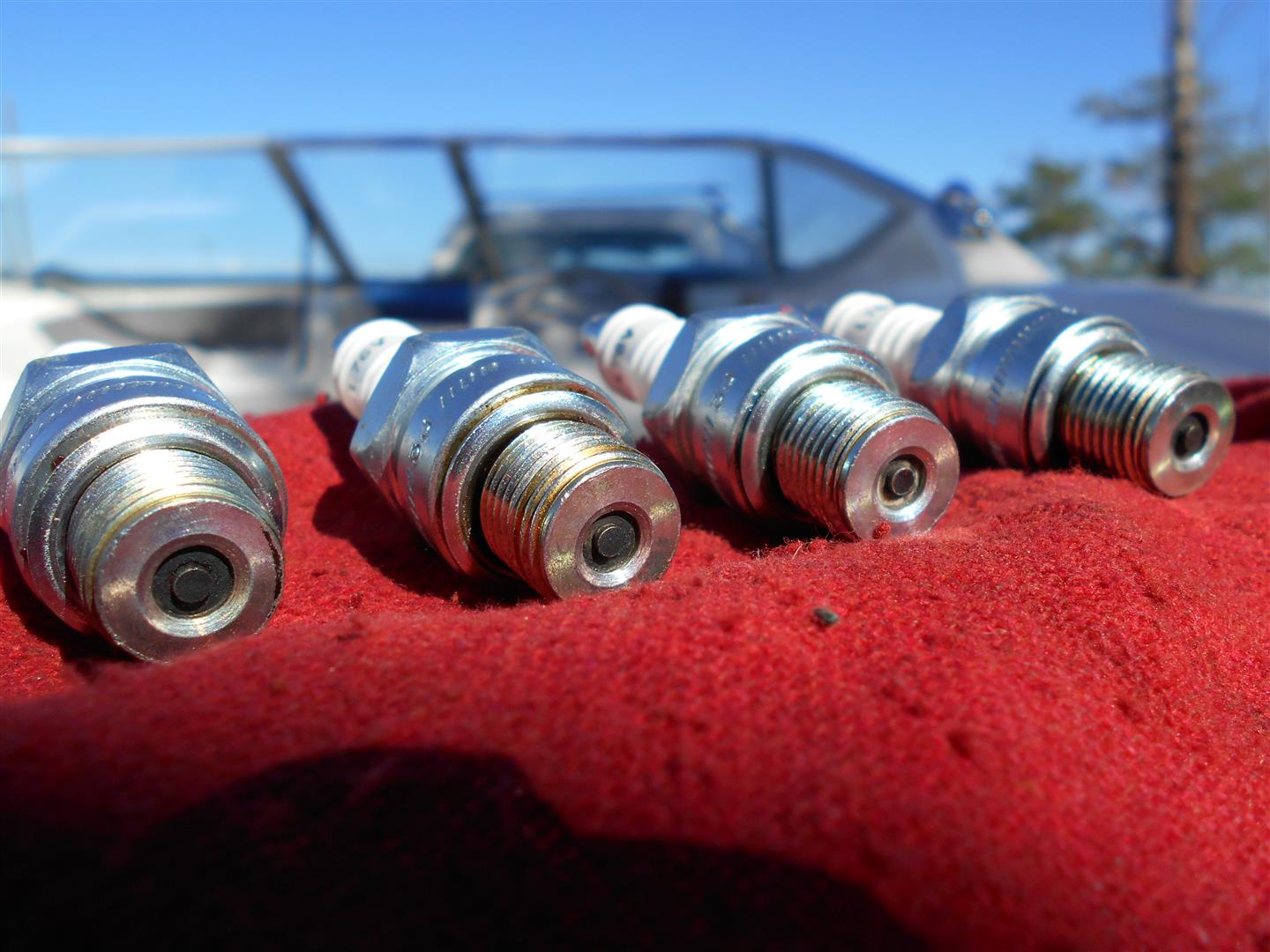

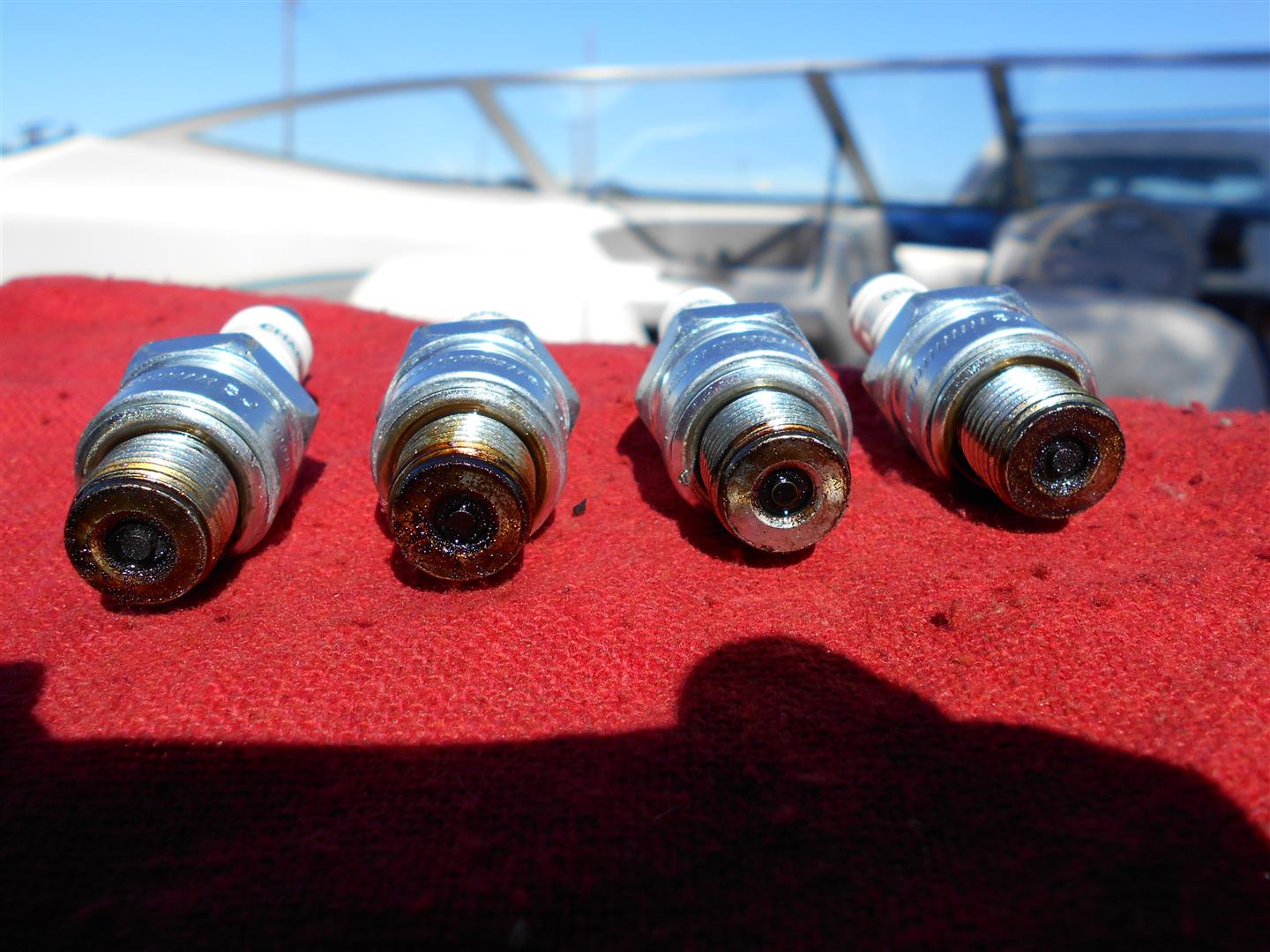

Robby, took the boat fishing for 2 days this week. Spent 10 total hrs running it, almost all at idle trolling speed. Had brand new plugs and at the end of day 2 I picked up a miss at around 1/2 throttle. Ran it up to full throttle, smoothed out and when I dropped back to 1/2 the miss was gone. Back home I checked the plugs. All 4 were pretty dirty with #2 being the worst. Shot them with some carb spray and electrical cleaner and they look new again. I think it may need that Deep Creep treatment to clean up the innards. Also I haven't adjusted the idle mixture yet, didn't want to start changing things before evaluating the way it runs, but I do think they're a little rich at idle. Other than that, ran great. Running 50:1 TCW3 oil plus Marine Sta-Bil.
After I cleaned the plugs I put them back in, but put #3 and 4 into the 1 and 2 cylinders, and put 1 and 2 in the 3 and 4 holes. (3 and 4 seem to run cleaner). If #2 fouls again I'll look into the idle mix and electrical, but I think this was mostly due to all that trolling. Also might try synthetic TCW3 oil but that would cut into my beer budget.:S

Well they sure look pretty funky. I don't think Force like long idle periods. Mine doesn't but cleans up on the punch. I would think about putting a kicker motor on if your going to do a lot of trolling.
But sure, go ahead and spray the Deep Creep. Put the old plugs in, warm it up, spray the carbs high idle (just use your hand on throttle blade shaft)then soak it until it dies. Plugs out, tilt up the motor and spray/soak good around the jugs. Plugs lightly screwed in, and let it sit over night. Then plugs out, tilt down and crank the motor to blow out any leftover stuff. Then old plugs back in and go ahead and "smoke" out the neighbors! Then best to get it on the water under load with the new plugs (carry some spares as one might still foul).
Also do a comp check before and after and see what numbers ya getting.
