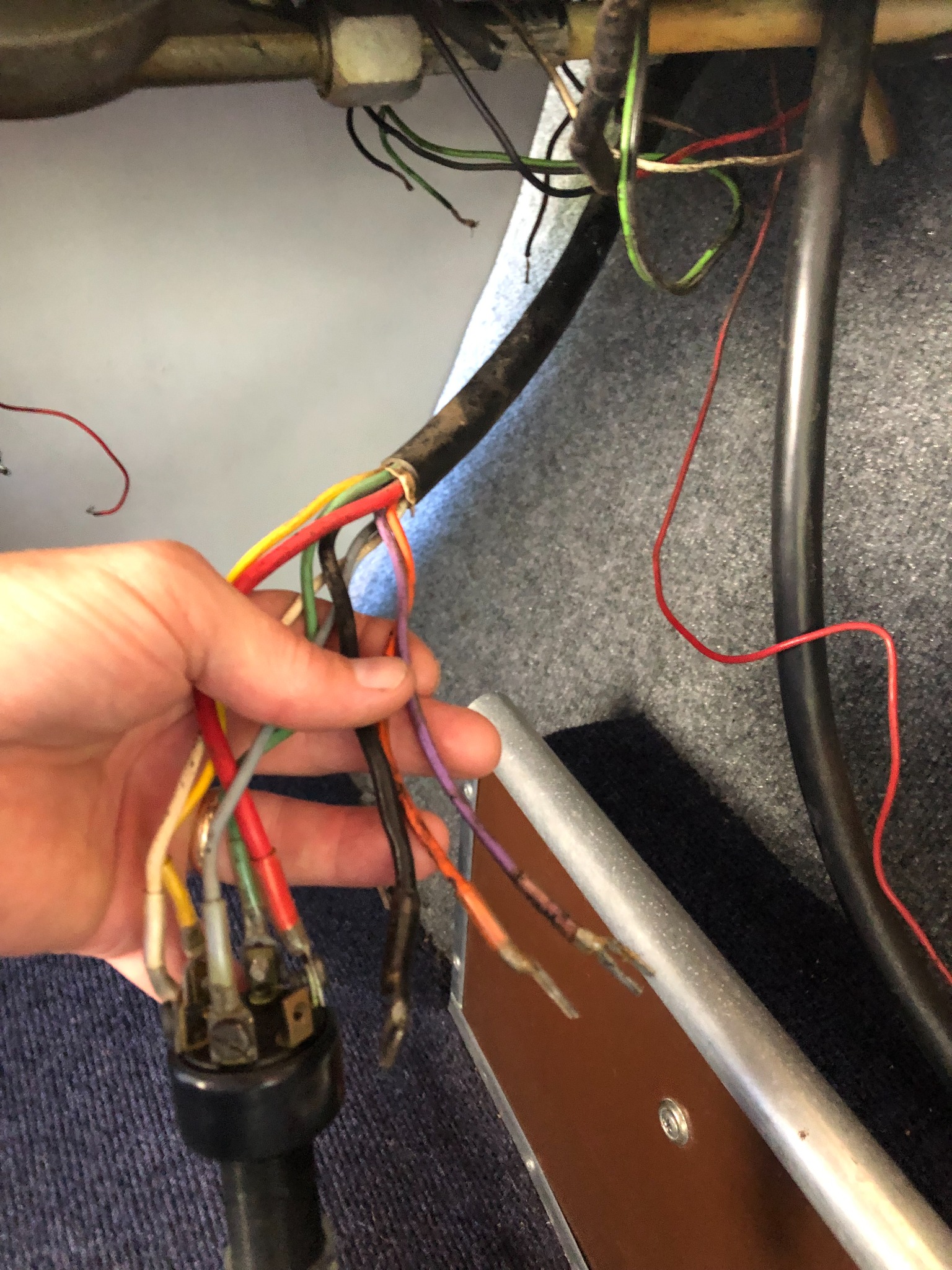

I have a couple more problems I am hoping you can help me with. The starter occasionally engages while the engine is running. Would that be the ignition switch or the solenoid? I don't see how the solenoid could engage without power coming from the switch.
Next problem is, I have three loose wires coming out of the harness at the ignition switch. One is the the black wire labeled ground, one is the purple wire labeled generator and one is the orange wire labeled temperature.
The wire length is the same as all of the others as if they should be attached to the switch. The engine operates as it should. It cranks, runs, generates power to the battery and shuts off. Please see attachment.

Black, return ground.
Orange, overheat buzzer.
Purple, tach output from rectifier.
All extras for dash gauges/accessories.
Pick the appropriate diagram at this site:
maxrules.com/fixchrywiring.php
You probably have battery-powered ign, there's a diagram for that. If not there are others
The starter solenoid thing sounds like a bad switch, if it's doing it enough to catch it in action, connect a test light from the small terminal on the solenoid to ground. If the light is lit when the solenoid inadvertently activates, then the switch is bad. If it does it with no power applied, the contacts must be rattling around inside. You could also disconnect the actuation wire after the motor is running, if the solenoid does or doesn't act up, you'll know what's up with it.

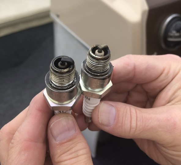

I took the boat out this past weekend and only had a couple of problems. The first was that it wouldn't shift into drive but would shift into reverse fine. I made a cable adjustment and I think it is fixed. The other problem is a bit more puzzling. It fouled the top spark plug about 25 minutes into the run. The bottom spark plug looks like it did when I installed it new. It's a 2 cylinder 2stroke with 1 carburetor so it seems strange to me that it would foul only 1 plug while the other one looks new. I checked the top cylinder with a new plug and it fires fine. I am thinking it may be something in the ignition. I replaced the coil for the top cylinder when going over the engine a few weeks ago because it was bad. I checked the fuel pump diaphragm and couldn't see any holes. It is a new diaphragm also.
Any thoughts on what else it could be?

Could be points or condenser. Did you take apart the points and clean to bare metal? It also helps to burnish the points with some crocus cloth. Set points gap at .020"

This past weekend I burnished the points, cleaned and re-gapped to spec., took it out and ran it and had the same problem with the top plug fouling. I swapped the plugs before it completely fouled out and the bottom cylinder would clean it in about 5 minutes of running but it would start to foul the top plug. I did that several times. So then, I swapped the coil wires and ran it again about 5 minutes and the top plug was clean. I thought the problem was solved so I ran a while, about 15 minutes, and put it on the trailer for the day. When I got back to the house I checked the plugs and the top plug was starting to foul again.
I swapped the coils and cut the ends off of the coil wires for the next test hopefully this weekend.

Well, you're getting somewhere! The coil swap should pin it down. Sure sounds like a weak spark issue and not anything with the top cylinder itself.

Crankcase leak would cause poor idling/running. Only the idle mixture is adjustable, main jet is fixed. So having one cyl lean won't affect the other cylinder much, at speed.
I'm assuming the top plug, when that cylinder cuts out, is all black and oily? If it's spotless white, then either that cyl is lean or the plug is being steam-cleaned by water ingestion. Any drops of water or foamy grey material on the plug?
When it is running on both cylinders, does it run well? How's the idle quality? If the plug is indeed fouling, it's typically a lack of spark energy. Not many components left to check, though. But it could be a condenser. Guess we'll rule that out when you next run the boat!

The plug is black and oily, no water of foamy grey material. The engine cranks with a quick bump of the starter and idles fine and runs fine at all throttle settings. I will take some pics the next time I run it.
