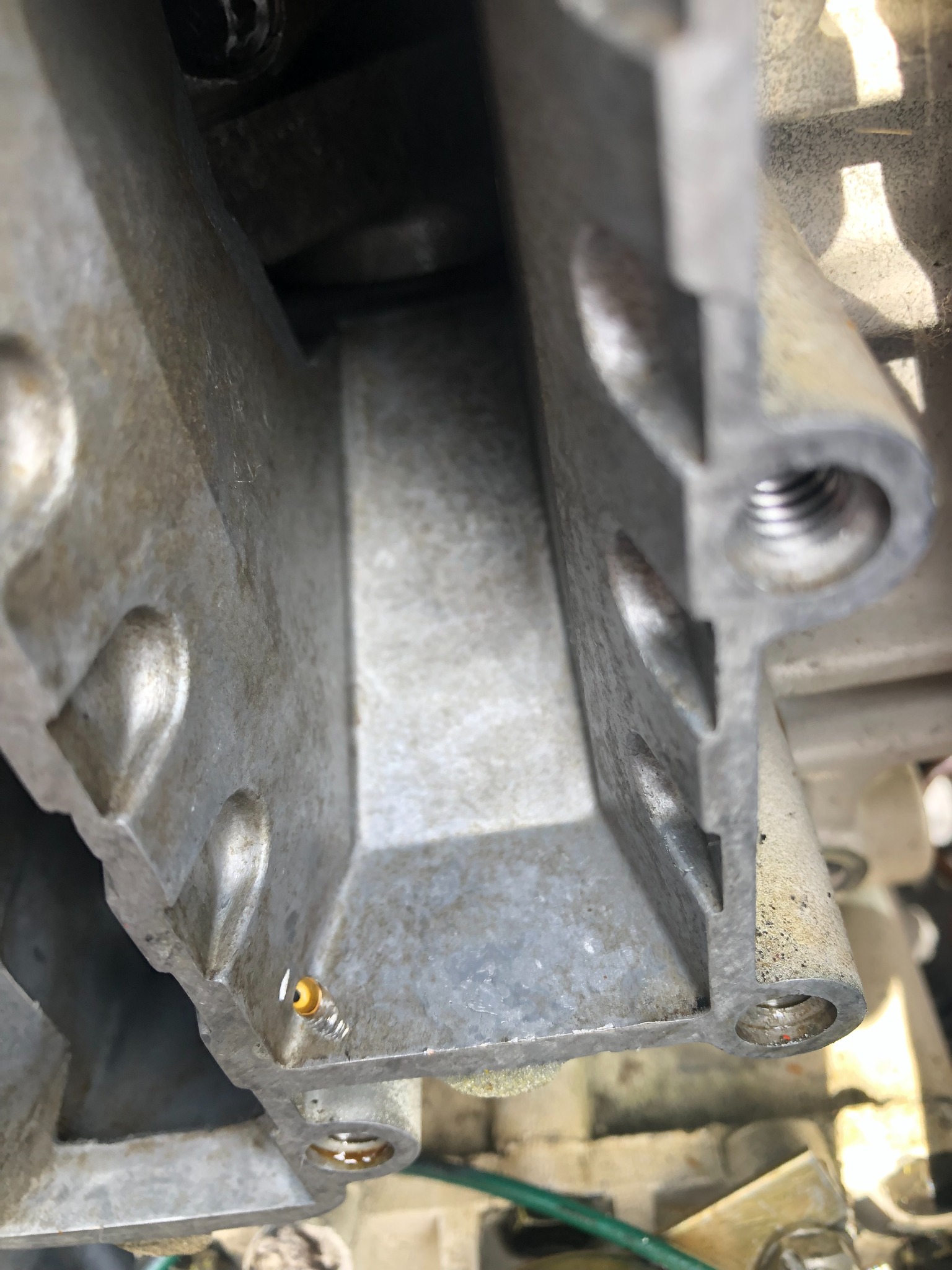

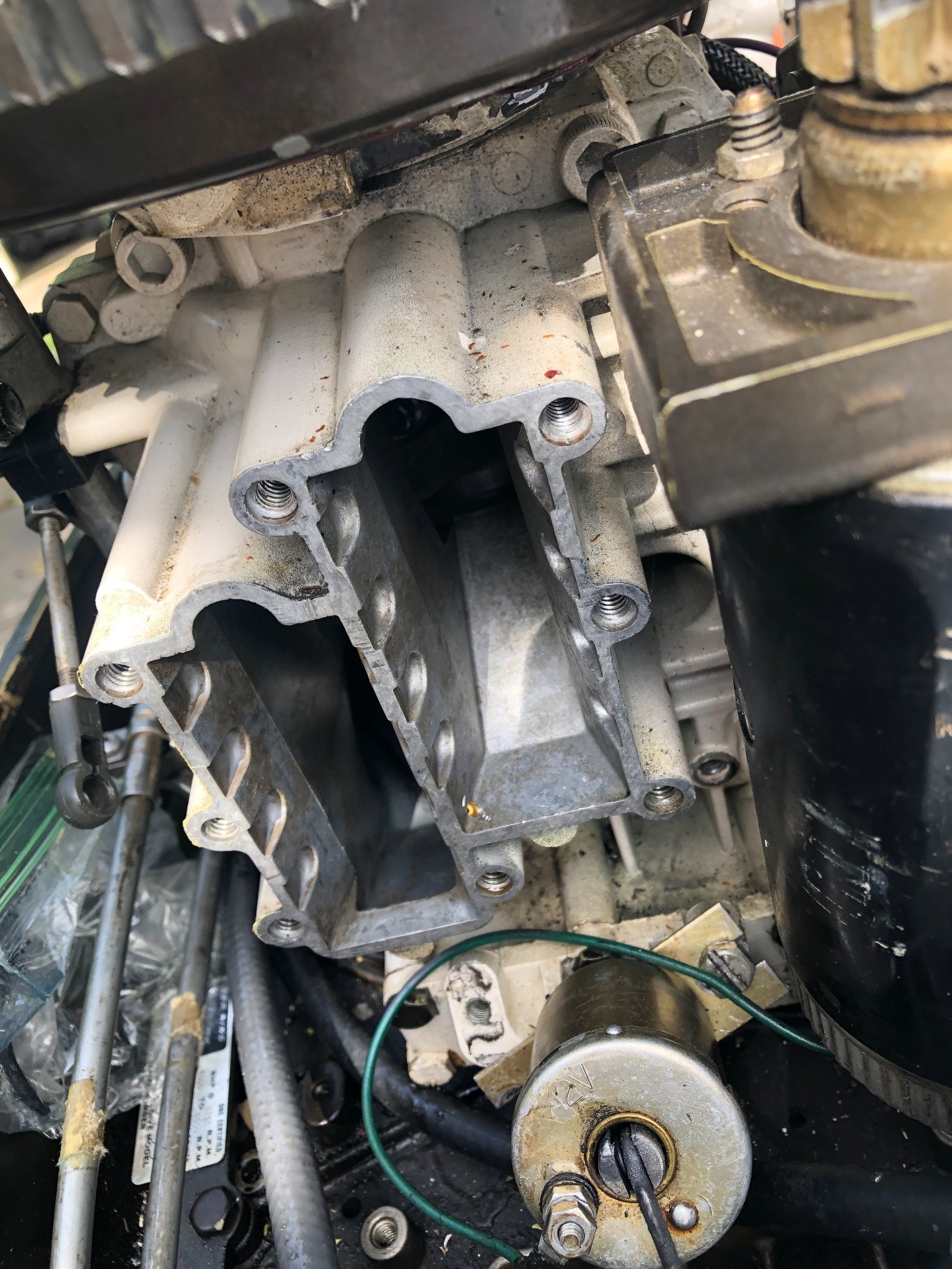

I was planning on replacing the reed valves a couple of weeks ago but before I pulled the intake off, I noticed that the gasket wasn't correct. I also noticed other minor differences from the 1970 parts catalog diagram. After countless hours of research, I discovered that it doesn't have the original powerhead. It has a 1973-76 powerhead. I ordered the correct gaskets for the intake so I can replace the reed valves.
I checked the crankcase and cylinder drains yesterday to make sure they were working properly. I also tested the check valve on the crankcase drain. Everything is working properly with no obstructions. I checked the cylinder drain reeds a few weeks ago and all was clean and clear.
I removed the exhaust cover to get a look at the pistons and buildup of carbon as well as any other clues. Everything looked really good with very little carbon buildup and the pistons look like new with the lathe grooves still prominent.
I will change the reeds next time, hopefully!

I was finally able to remove the reed valves this past weekend and I am pleased to report that the reed valves look like brand new. They lie flat with no gaps, so I didn't replace them. There is a small drain in the bottom corner of the top intake port that seems clear. See pics. At least I think it is a drain. I tried to blow air through it but the hole is so small I couldn't tell if it was blowing through. There was no oil in the intake.
In another twist, I know the powerhead cases are 1973-76 based on the design, but while I had the reeds out I noted the crankshaft part number on the counterweight. It matches the part number from the 1970 engine but not the 1973-76. I can't find any numbers on the cases to determine the exact year of the engine. It has nothing to do with the problem that I am chasing but still puzzles me.
Gas Hog? 3 years 6 months ago #147956
After exhausting all conventional avenues to solve my plug fouling problem, I started thinking outside the box. I took an extra set of reed pedals and cut three of them off. I removed the reed stop on the top reed pedal set and mounted this on on top of the existing set of reeds and reinstalled the reed stop. So I now have one extra reed pedal that applies extra tension and restricts a small amount of fuel and air to the top cylinder.
I ran it this weekend and am happy to report that after checking numerous times the top cylinder plug looks like it should and did not offer to foul. The bottom cylinder plug looks great as always. Maybe it will hold up!
