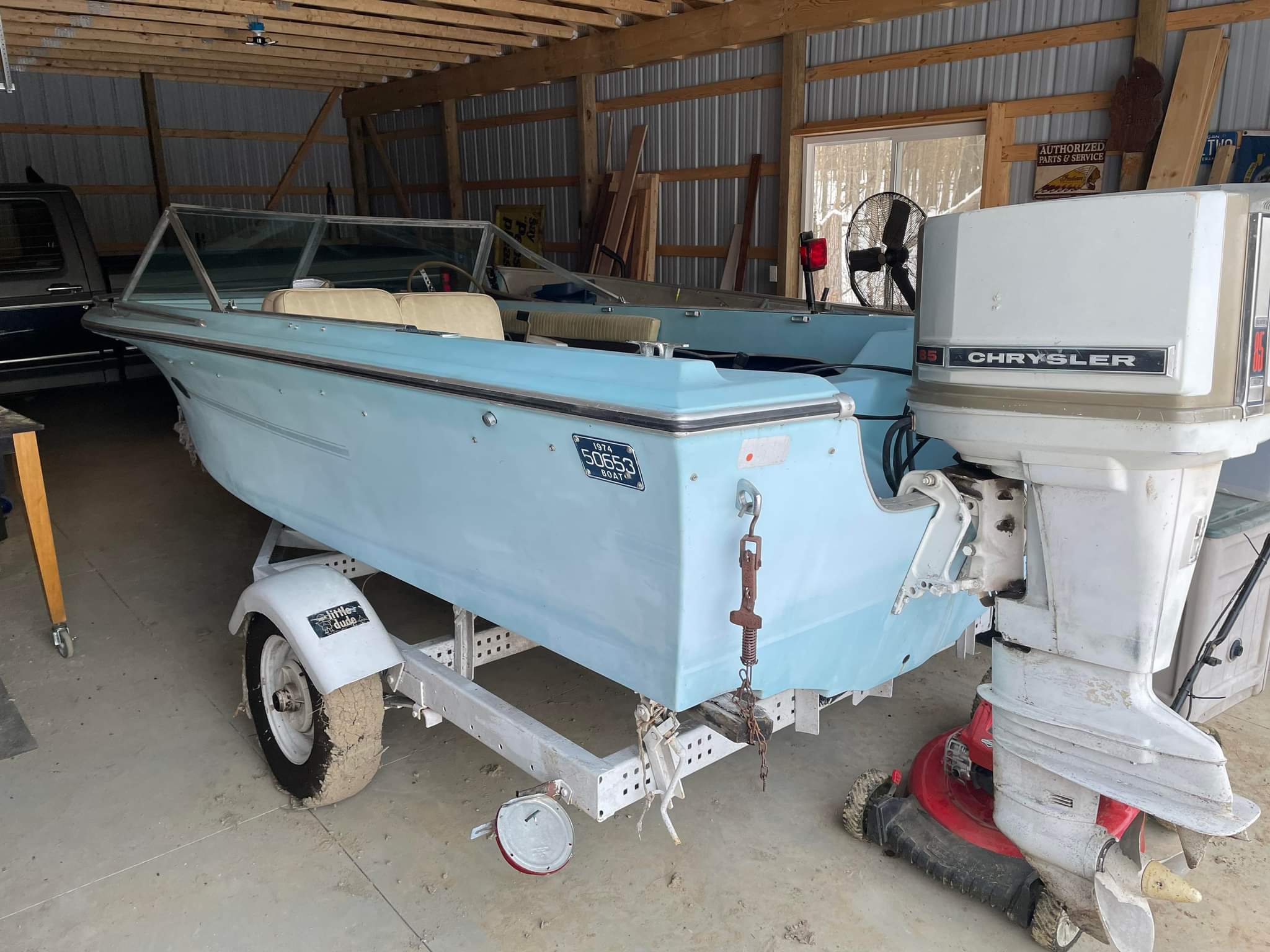

The controls would come with it but after further consideration I started to back out of the purchase. 85hp may be way too much motor for my project boat and will most likely just clean up the 50hp Johnson. But now have a new problem. The damn seller wants to sell the boat also! He claims everything is solid only needs a good polish, spark issue resolved, and tires that he would replace. Asking $800. 1972 Arrow Glass Challenger. I am considering offering less, declining tires and taking the risk on the motor issues if he still has this after X-mas. I am afraid I may be getting addicted.

Decent looking boat, nice V-hull. It should handle well. Interior looks nice, too. Check the floor for soft spots and also check the transom for stress cracks that could indicate rotten wood within.
To really check it well, with the motor down place your foot on the rear upper end of the lower unit, and press forward hard. If the transom is shot, all that forward stress will make a lot of motion. If it's solid, it won't move much if at all. You'll know as soon as you push on it.

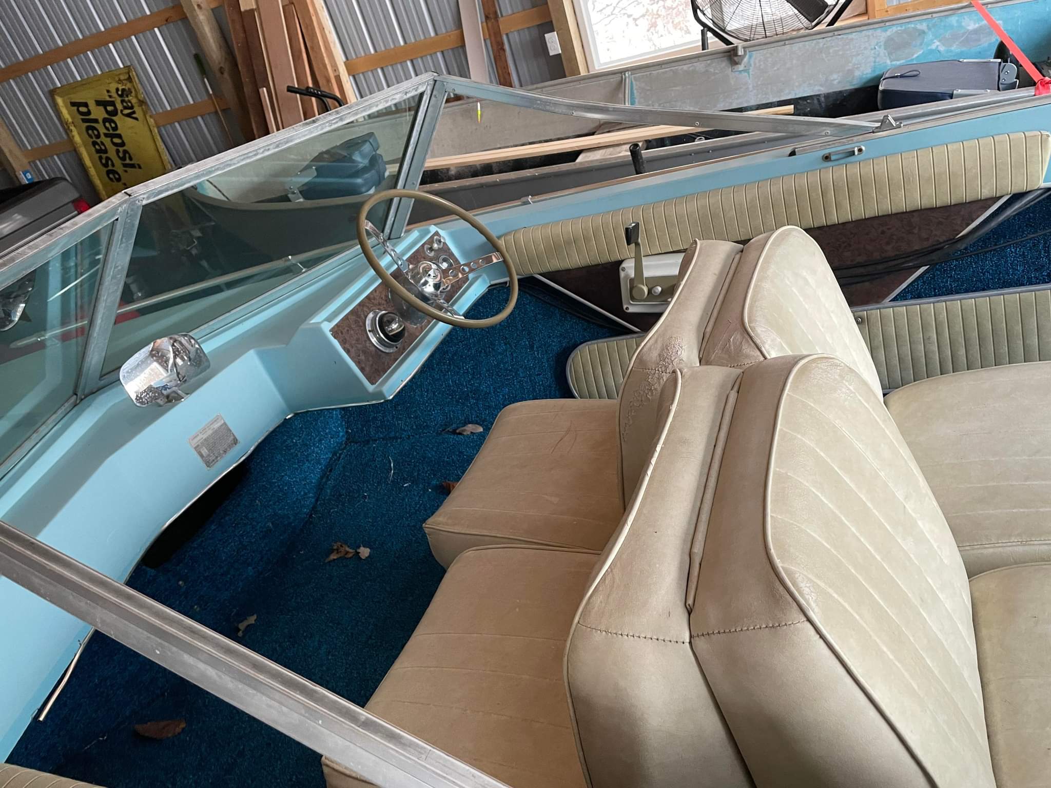

The boat looks good. Nice seats, but they don't look original to the boat and mounted in an odd arrangement. Normally the seats would be mounted almost all the way out to the sides so theres a walkway between them. The way they are the driver wouldn't be sitting right behind the steering wheel either. Easily fixed tho.

Maybe they were working on something under the dash, or needed access to the bow area. Looks like it may be only the driver's seat that's displaced, the pssgr seat seems to be over to the side, where you'd expect it to be. And yeah, easy enough to re-mount 'em.

I'll bet you're right. I didn't notice that they're all the way over on the port side.

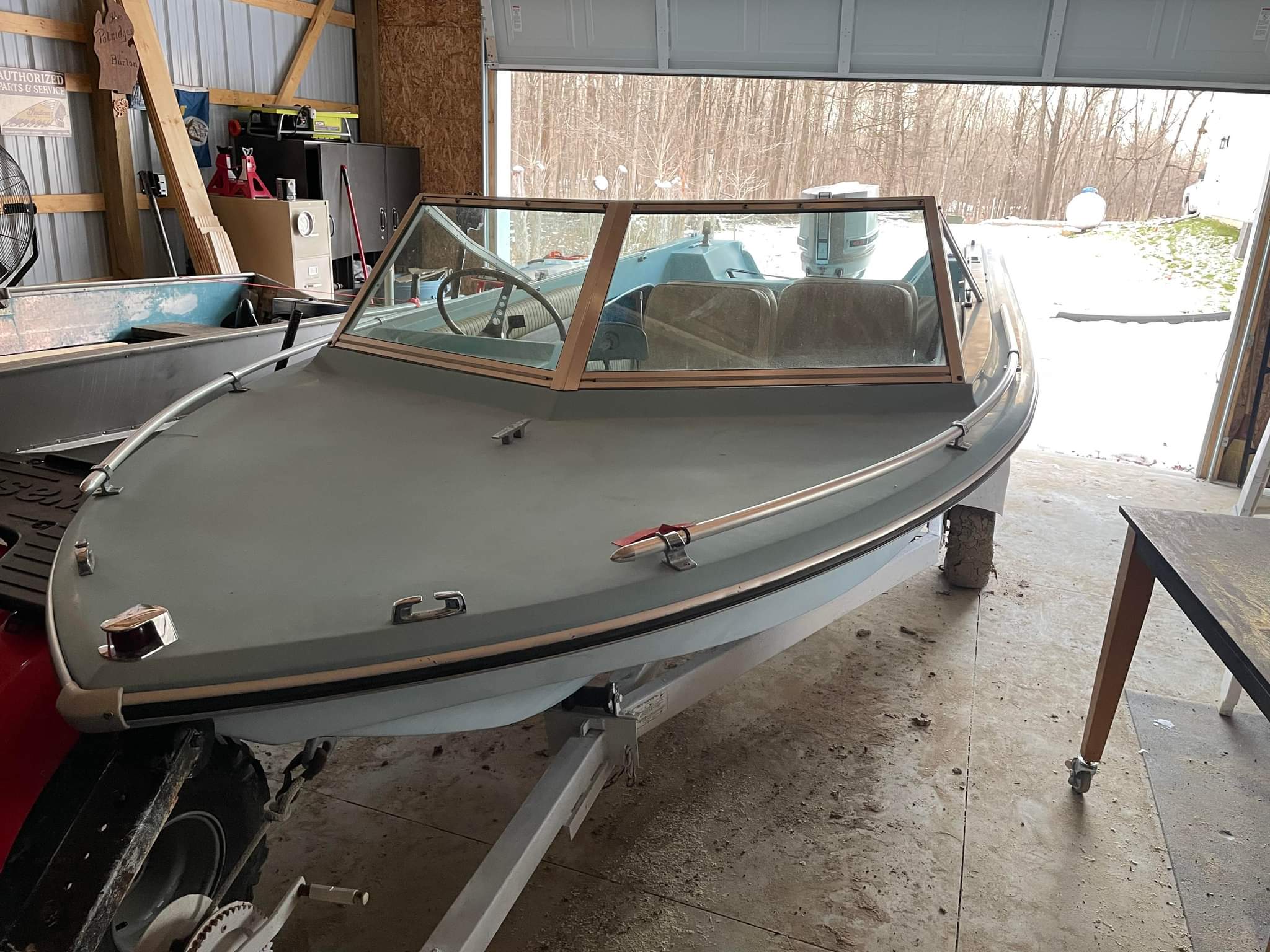

I expanded some of the pics of the boat for sale, and that's a pretty clean-looking hull. Needs the oxidation buffed, but there are 3M polishing compounds that will work wonders, along with a heavy-duty buffer. Or even a cheap one from Harbor Freight!

I forgot to mention there are a number of members here with Arrow Glass boats, they seem to think highly of them. One post I saw mentioned knowing a guy who used to be their test/torture driver, they put the boats thru all kinds of punishment. Apparently are very well built. I didn't see any cracks on the zoomed-in pic of the transom.
