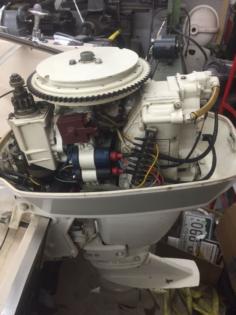

I bought an old Sea King boat and motor last year and am trying to get it living again. The boat is a time capsule...it looks nearly new. Everything is solid and in great condition. It was clearly loved and stored indoors all its life.
The motor looks really clean. When I bought it, the gentleman I bought it from just said "the motor needs some work." I was so pleased with the boat that I really didn't even care if it ran or not.
I did a compression test on it when I got it home last fall, and I had 140 in both cylinders. I hooked it up to muffs and I could get it running without much effort, but it ran rough. I stored it away until this spring, and here's what I have so far.
When I first started it this spring, while it was running rough, I pulled the top plug wire and nothing happened. Kept running the same. Reinstalled that wire and pulled the bottom one and it died instantly. I removed the wires, inspected them, and switched their positions. This time it ran better and when I would pull either one it would run rougher but keep running.
Being impatient, I took it to the lake to see how it would run under throttle. Idled rough, vibrations at slow no wake speed, but wide open it was pretty good. However, while running WOT it bogged down and quit. I had to let it sit for 5 minutes, then it fired up and ran for another 10 minutes. We had to idle before a bridge, and it died. Couldn't get it restarted.

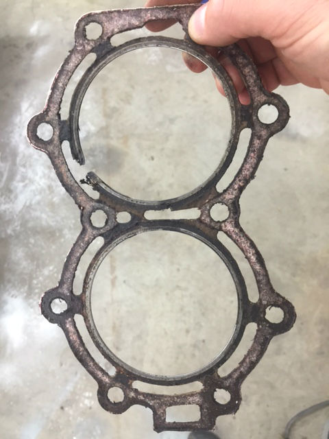

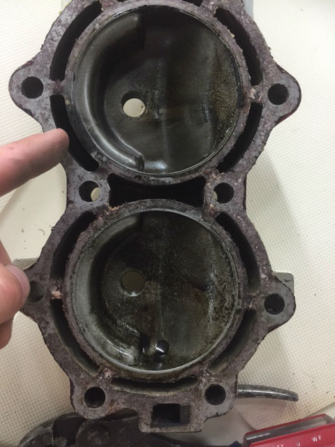

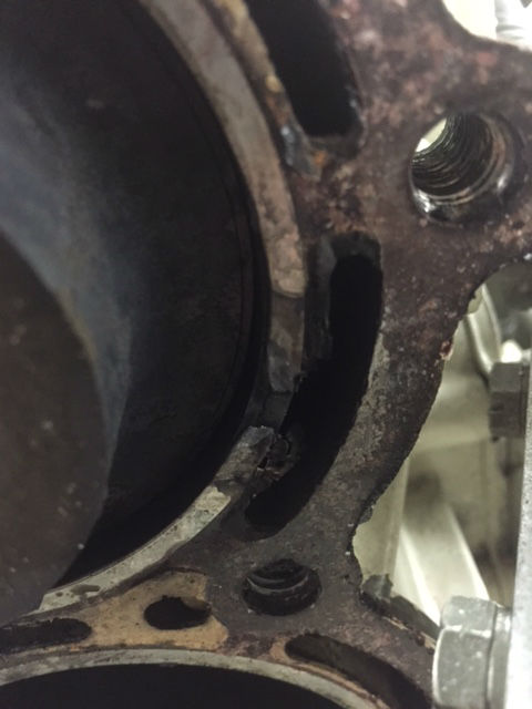

I got a sheet of heavy glass and adhered 120 grit sandpaper to it. Moving the head in a figure 8, I slowly progressed to get the surface shined up. If the presentation of low spots was any indication, the head does seem to have been warped. After a lot of elbow grease, all areas are nice and clean. I carefully scraped and sanded the block as well. Just out of curiosity (I won've received the gasket until Monday) I mated the head to the block to see how it fit. Interestingly, it seems high in the middle, as it teeters a bit. I can rock the head up and down pivoting in the middle. When I hold the bottom of the head tight to the block, I can get a .006 feeler gauge in between the head and block at the top edge.
Is that ok? Am I concerned over nothing as I don't have the gasket in there?
Thoughts?

Nice engine! That head needs to be FLAT. You'll want to either keep on hand-lapping it in until it is flat, or take it to a machine shop, as .006" is way too much warp and it'll surely blow another head gasket.
Usually what happens with these is that they've overheated sometime in the past, or the head bolts were never re-torqued and have gone slack. Usually you see a low spot in the middle of the head, but a lot of things can happen in 50 years or so!
Anyway, if you get the head flat, and providing the block surface is decent, you should have pretty good luck with a new head gasket.
Be sure to coat the bolts & threads with either a very thin layer of waterproof boat bearing grease, or Permatex #3 Aviation-Type gasket dressing (you can get that in most NAPA stores, among others).
Coating the head bolts ensures they will never seize in the head or block, and you'll be able to get an accurate retorque.
ARP sells some pretty good assembly lube if you really want to go the extra mile. This stuff guarantees even torque on every bolt.
HTH & let us know how it turns out........ed

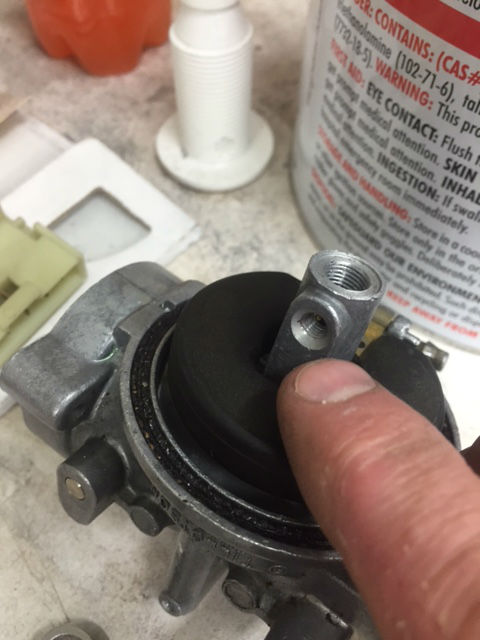

Seems I buggered the carb by trying to drive the idle tube out so I could remove the main jet for cleaning. I quit when I realized I was not going to be able to do so without destroying the tube. The little I did was damage enough, causing the mixture needle to bend when seated.
Fortunately the guy that helped me tune it up last month said he had an extra carb.
Went and picked that up today, and after a good cleaning, adjusting the float, and installing it, the motor started right up.

I figured it had to be something with the "new" carb. Seems the new carb was missing this nozzle:
I'm frustrated with myself for not noticing that it was missing when I cleaned the carb. I took the one off the old carb. I will barrel run it tomorrow, and I am hopeful that I will finally have this thing up and running!!

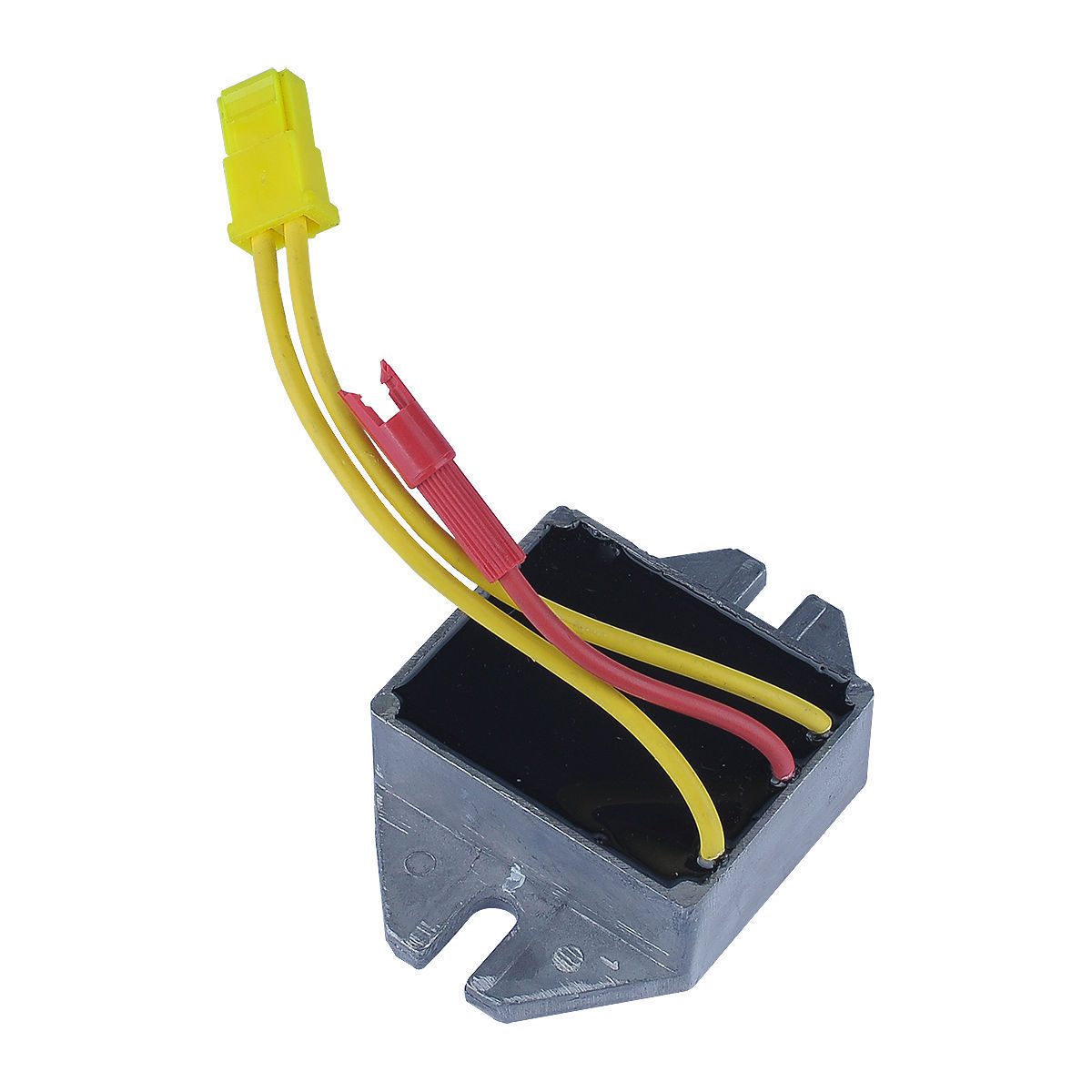

I was doing a bit of research on eBay and found that Briggs & Stratton uses a very basic voltage rectifier/regulator assembly, that looks to me like it could be easily adapted for outboard use.
Here's a link to one of 'em at Amazon, but I'm sure if you trolled eBay you might find an even cheaper item:
www.amazon.com/HIPA-Electrical-Voltage-Regulator-Stratton/dp/B00XNI8396?SubscriptionId=AKIAILSHYYTFIVPWUY6Q&tag=duckduckgo-d-20&linkCode=xm2&camp=2025&creative=165953&creativeASIN=B00XNI8396
Edit: $12.50 on eBay!
This is rated for up to 16 amps, which would be fine for most of the older outboards, most of which didn't put out much over 10 amps anyway.
Just figure out an appropriate place to mount, and decide how you want to connect, and away you go!
You could use bullet connections, spade, or lug-to-lug, fastened with screws and insulated with electrical tape. Any of these will easily handle a 10A load.
You can be our Test Mule, install one of those and let us know how it works! :P
HTH.........ed

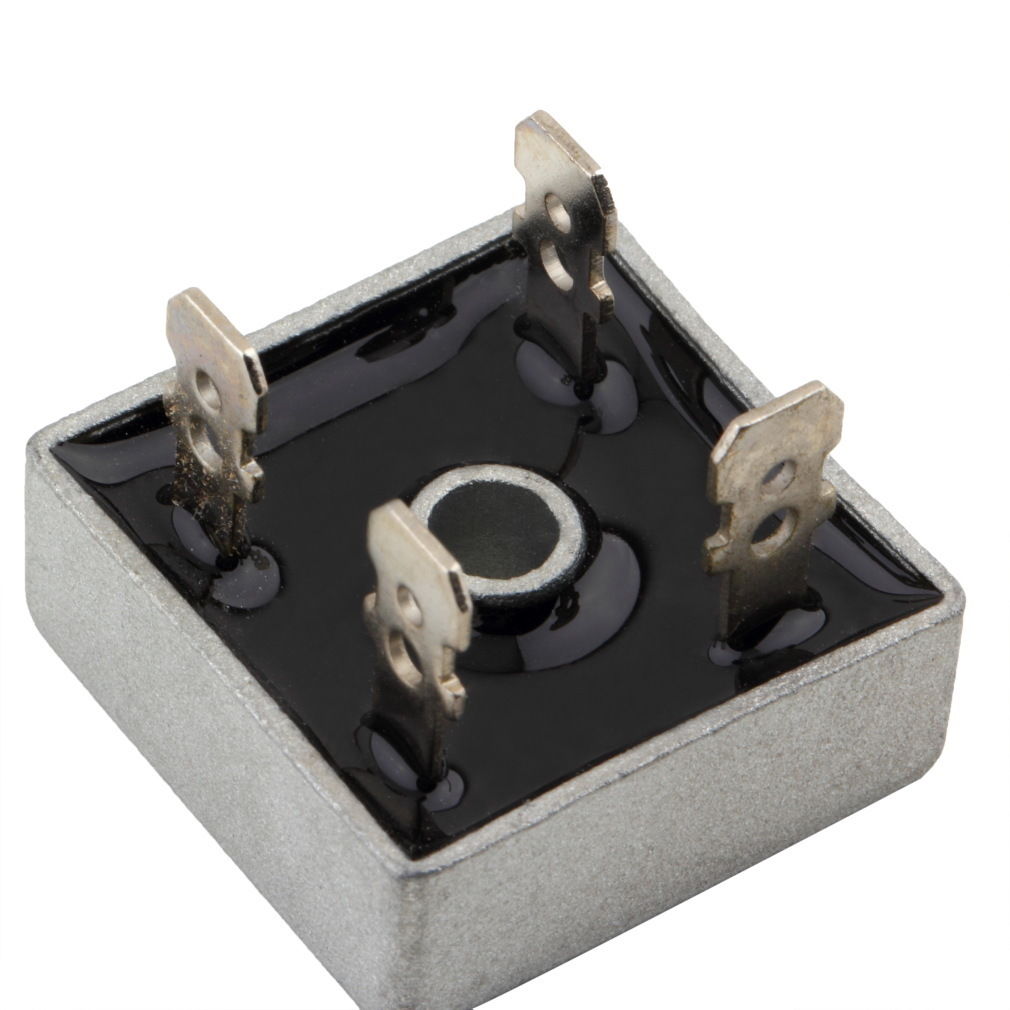

p.s. I prefer this style of bridge rectifier to the Rad Shack item, it's got a metal case and a higher rating. You can get 'em from Hong Kong seller for only 99 cents, but you'd have to wait a month for shipping!
Avail from a California seller for under $5 shipped:

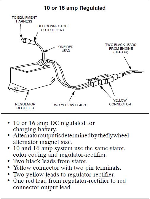

One more thing, here's a wiring diagram I found that shows the connections are pretty much identical for an outboard that uses a 2-wire stator-output to a rectifier (or regulator). The regulator's wires are even yellow, same as a Merc.

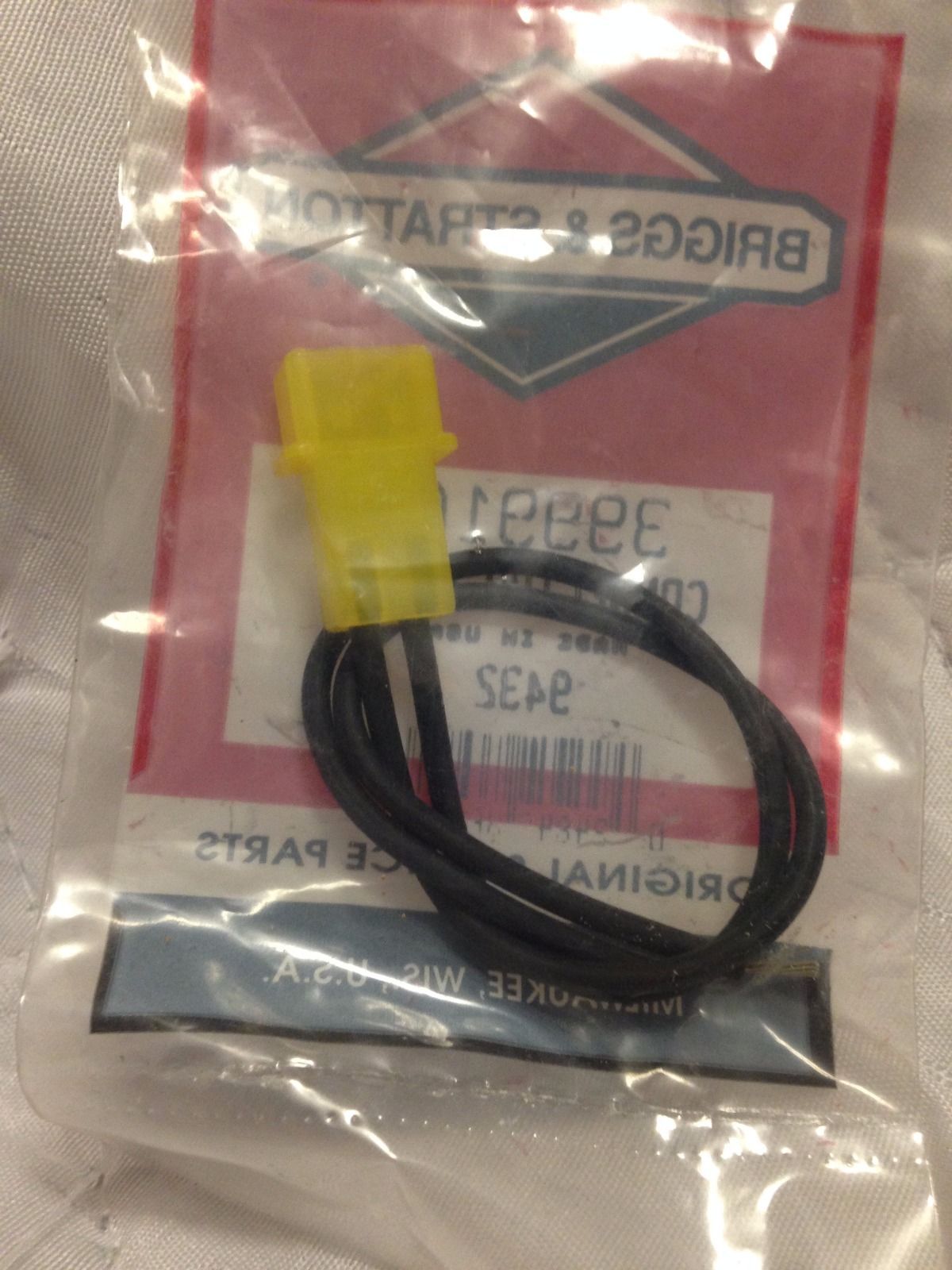

OK, I think this is the right connector to plug into the V. Reg. You'd have to confirm at a Briggs dlr 'cause I couldn't find a straight-on view showing the pins. But a chart I found shows it being used with the 16A alternator and V. Reg. so I'm pretty sure it's the one.
Only $5.00 on eBay:

First off you cant go switching carbs unless you know its exactly the same as the one you have. Even carbs off the same HP motor of a different model number in the same model year can have serious changes in jet sizes and other things. The worse case scenario is a carb that will cause a high speed lean that will seize a motor in seconds at WOT.
But this may be a moot point. If I am reading that picture of the head surface of the block right, the block is ruined by that eroded place that blows into the water jacket. Likely its from detonation, bad gas, lean mix, over advanced, over loaded.
