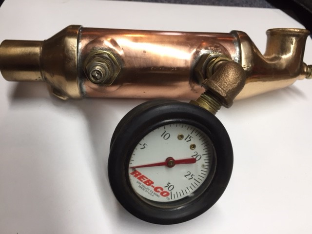

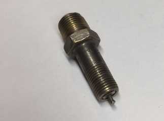

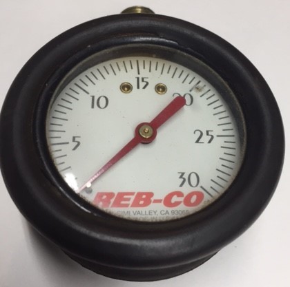

So let’s say you suspect a leak, how do you find it? We use air pressure. Begin by removing the oil cooler from the boat. Clean everything off and using some brass fittings adapt a 30 psi pressure gauge to one end of the oil circuit and a tire valve (like the one you use on a bicycle) to the other end. You can find these at the local hardware store. Ask for an inflator valve for a well water surge tank. It typically is a tire valve mounted in a 3/8 NPT brass fitting. Screw this all together and VERY CAREFULLY add just a little bit of compressed air. DO NOT OVER PRESSURE THE COOLER or you will cause a leak or the cooler may explode from the pressure. Fill a bucket with water and submerge the assembled cooler and gauge in the water. If it has a leak, bubbles will start appearing. If you don’t see any bubbles, leave it pressurized and check it out the next morning. If the cooler will hold pressure overnight, chances are there is no leak. If it will hold air, it will hold oil. The only other thing you might want to do is heat the cooler up by filling your bucket with hot water to run your test, just in case the leak only occurs when the cooler is hot. Simple, clean, and visual. At this point somebody will say. “I don’t have an air compressor, I will just hook up my garden hose and run the test with water. DON’T DO IT!! Tap Water has pressures as high as 80 lbs. You will ruin the cooler. If it didn’t have a leak, it will by the time you have finished your test.

Below is the cooler with the valve and pressure gauge all installed and waiting for some compressed air.
