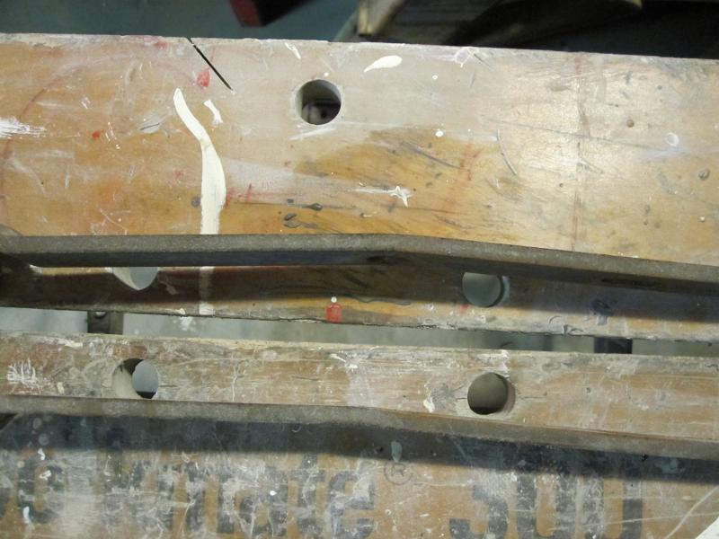

A few pics 16 years 3 weeks ago #15526

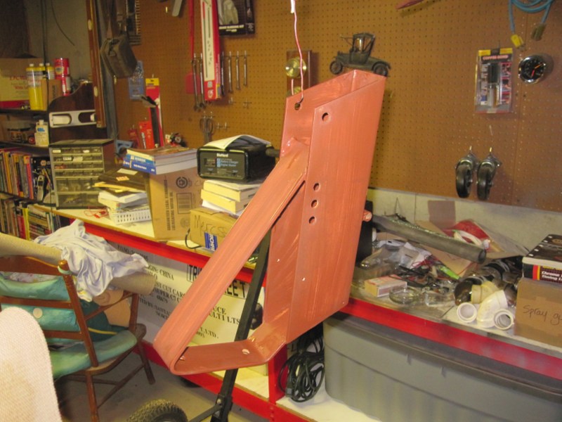

I may put this off a bit. There's a chance I might sign up for an auto body repair course later this month, and this trailer would be my project.
Anyways, here's a couple pics of the bow roller holder brackets. they were bent and are straighter now. Also one of the i.d. tag.
Frank

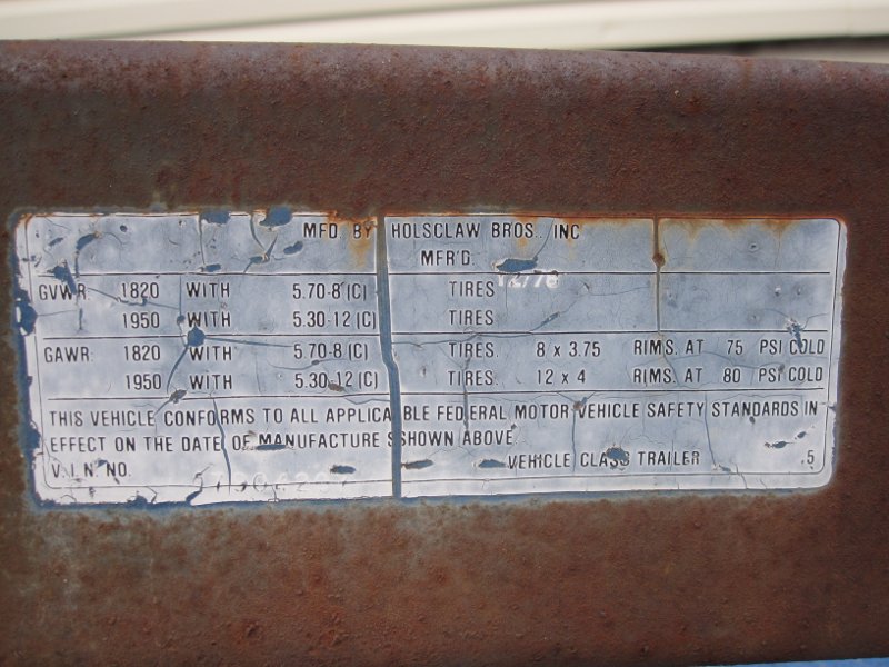

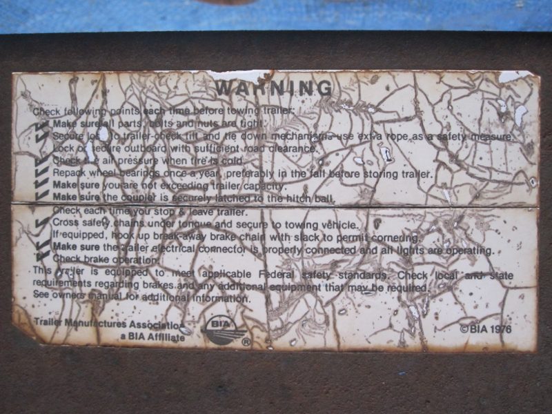

Manufacturer's label 15 years 6 months ago #28839
Finally got the entire trailer in pieces. Now the fun begins.
Found this label on the tongue. I doubt the trailer weighs more than 500#s, so this means it could haul a good sized boat again someday.
Frank

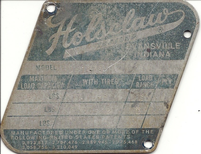

Replicating old trailer decals 15 years 5 months ago #30028
Trust me Mark, I know about tight budgets.
I am going to make my own trailer decals at home, as I don't really have the cash to have a pro shop do them. Any easy ways to "fix" an image like this (you can see the tear down through the "a"), and then fill in background color? Any suggestions for adhesive paper to print on from an ink-jet printer? This is exact size, about 6.25" long.
Thanks for any help.
Frank

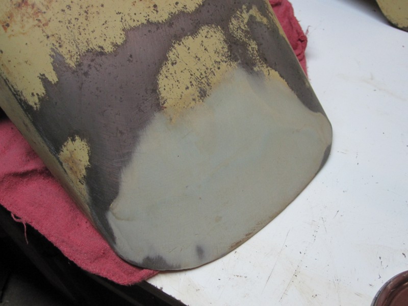

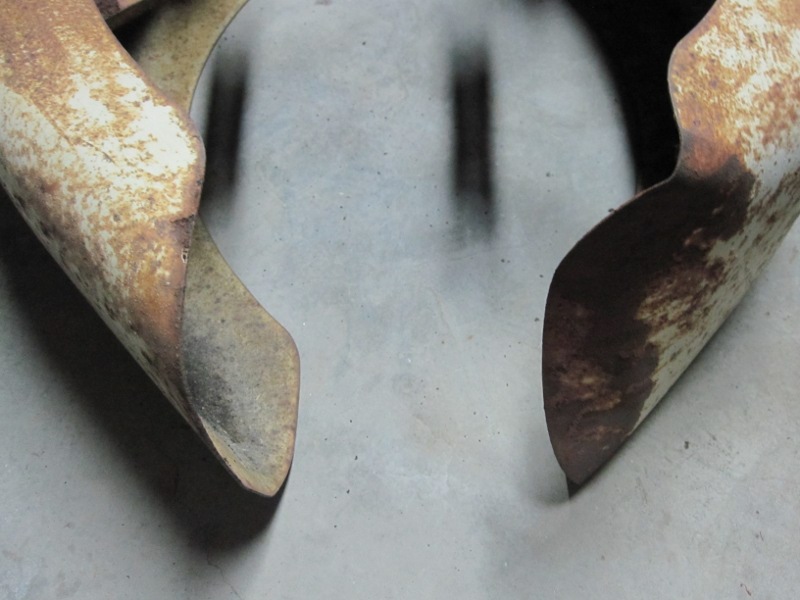

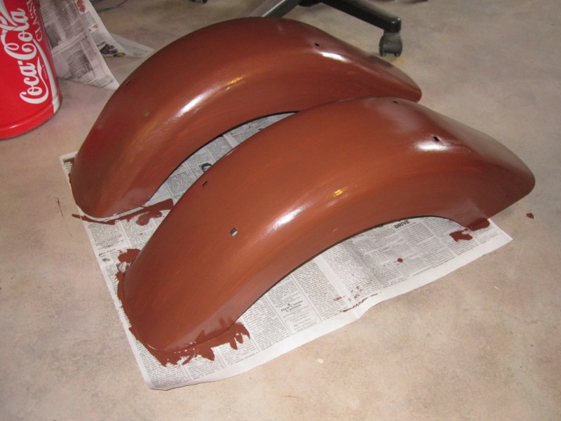

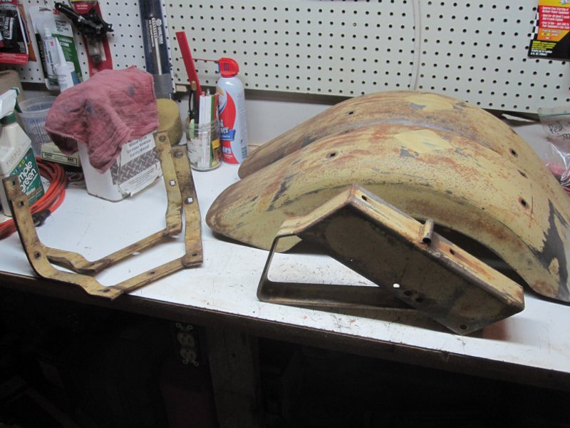

Almond parts in primer 15 years 5 months ago #30548
Had to fix a badly damaged lip on one of the fenders, but it came out okay in part because the metal is heavy gauge. A skim coat of filler and you couldn't tell under the primer that it's been damaged and fixed.
The only other almond stuff to get done is the roller/bunks. I still need to remove the rollers before I get to the metal stuff. Maybe play with that today.
There is very little pitting on this trailer, but a lot of surface rust. As a result, after sanding with 80 grit, and careful cleaning, I coat it with Rustoleum Rusty Metal Primer. I'll let it sit at least 2 days before final paint.
I got rebuild kits for the hubs, and will eventually get new wheels, tires, and shocks for it. This is going to make some vintage boat owner a real nice trailer someday! These babies are heavy duty.
Frank
Re:Holsclaw D1475 rebuild 15 years 5 months ago #30591
looking good there Frank. Keep at it.
Re:Holsclaw D1475 rebuild 15 years 5 months ago #30593
Thanks Skip! More to come....
Frank
Re:Holsclaw D1475 rebuild 15 years 5 months ago #30595
Wow Frank, you're really going to town on the Holsclaw! It took me a while to straighten one of my fenders yesterday, those babies are built tough - thick steel. Had to grind out the bolts holding the fender to the bracket, they were rusted so bad they wouldn't budge even after multiple soakings in PB Blaster! My trailer is rusted a good bit more than yours, but what are you using for sanding/rust removal there?
Re:Holsclaw D1475 rebuild 15 years 5 months ago #30599
I'm using 3M Sandblaster 80 grit Mark. While it's predominantly surface rust, there's a lot of it. I have very little pitting. In disassembly only a couple bolts broke. I'll have to cut out one of the shock bolts, but it would take a picture to explain, and I have to finish up getting hubs on the Power Cat trailer before we head off to the outlaws, er, in-laws for Easter. That gives me two hours and I'll need to get cleaned up too, darn. Want to get a coat of finish paint on my new tongue this a.m. if I can. Too many things to do!

wow frank,your doing a fantastic job,especially on that fender,it was bad,but looks great now,i cant wait to see the whole thing done.

Looking nice- It'll look even better with those new stickers on it :)
If you want to replace the sticker with the specs/VIN on it, that would be easy, too... I wish I'd have seen this post earlier, it probably would have fit alongside the fender sticker.
-Andrew
Re:Holsclaw D1475 rebuild 15 years 5 months ago #30630
I'd love to replace that sticker Andrew. See what you can do and let me know. Again, I'm in no rush.
Now if i could just get a new metal plate to replace this old one...
Frank

What size is the sticker??
I'm working on a way to replace the aluminum plates, too, in small quantities, using waterslide decals... We'll see how it turns out. It might be a while, though- I have plenty of time to do graphics work now since I'm on the ship, but once I'm back home I've got a TON of projects to tackle :)
-Andrew
Re:Holsclaw D1475 rebuild 15 years 5 months ago #30643
The trapezoid is about 3 1/4" top to bottom and 3 1/2" on a side.

Andgott wrote:
What are the dimensions of the capacity/VIN sticker? That will be an easy one. I'll have to work on the other one a bit :)
Dimensions on the capacity sticker is 4.825" X 1.75"
How about a Warning sticker? (By the way, this is reduced to 800 X 600 pixels. I have that in 45" X 34") It is 4.825" X 2.5"
Frank
