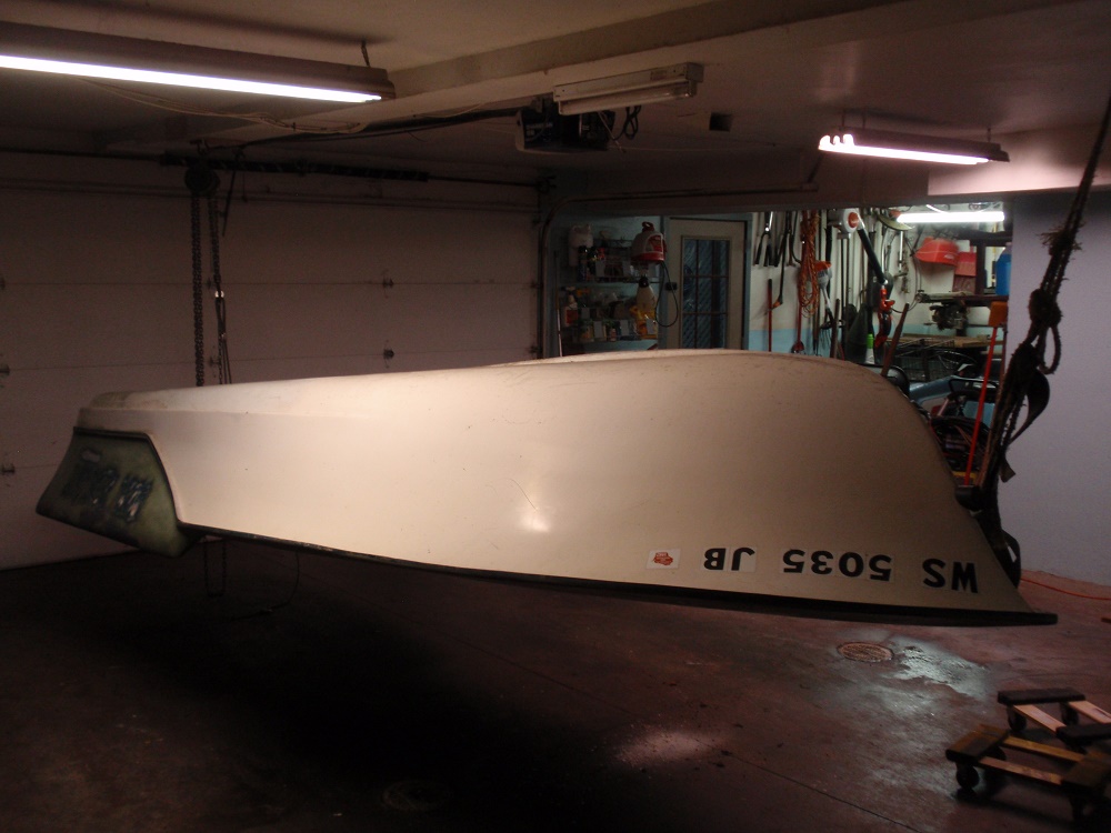

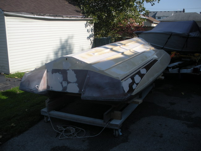

Also this winter I bought an industrial sewing machine so I could do my own interiors . Rebuilt the rear bench seat and replaced foam and sewed up new cushions only made a few mistakes but I think they look pretty good for first effort .Started on front seats but they are proving to be a little harder seeing I have nothing for patterns. Was a little of when doing buttons on lower center cushion so will redo.

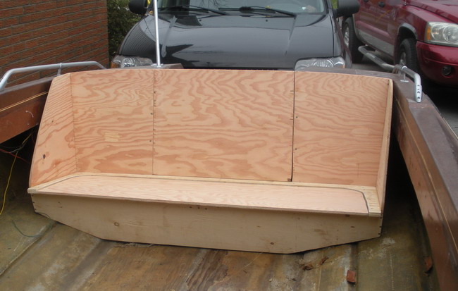

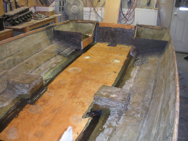

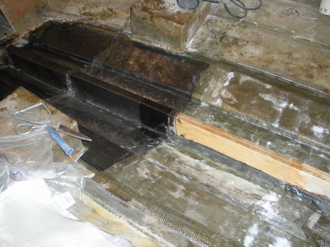

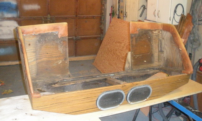

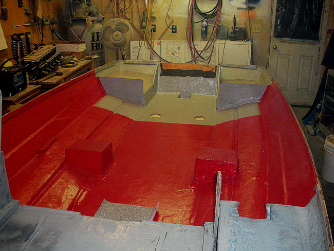

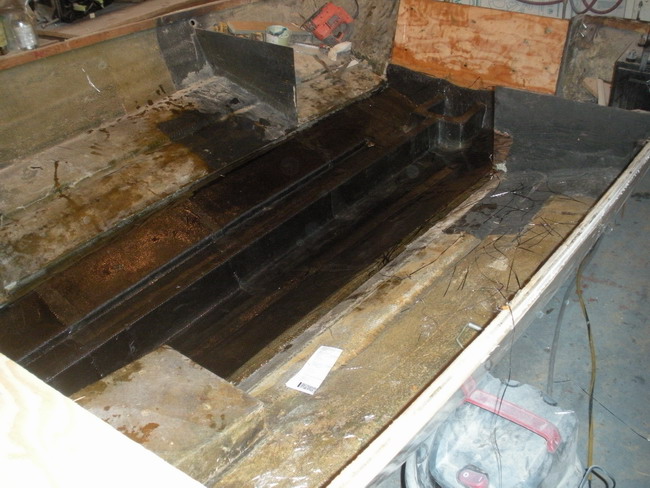

Been working on the floor , glued two pieces of 3/4 ply together for center beam, glued in place with mixture of milled fiber and epoxy and then used glass and carbon fiber cloth to seal and cover beam in place. On this hull I have been using Marinegaurd 8000 epoxy that I got from Amazon , very similar to West System epoxy but a lot cheaper , also had a roll of carbon cloth time X at work so I was able to get some for the floor and transom.
Glastron CVX 16 Rebuild 8 years 7 months ago #135854
  • hodgify
  • hodgify's Avatar Topic Author
  • Senior Boarder
  • Senior Boarder
  • Posts: 163
  • Karma: 8

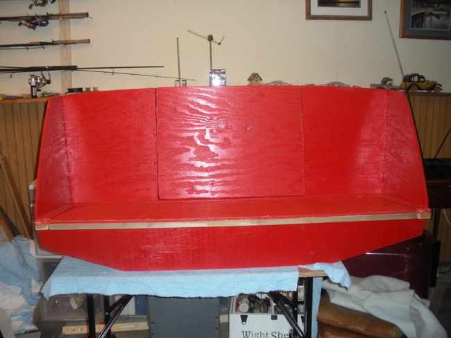

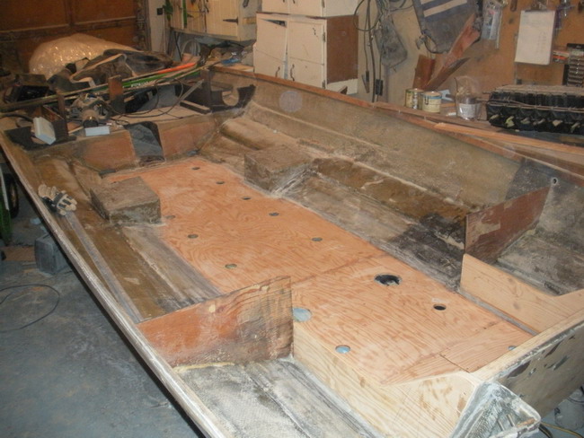

next cut 1/2 ply sealed bottom with epoxy and glued in place , let that dry then cut holes and used Total boat two part foam and filled the floor ,then used some carbon and a layer of glass to seal and reinforce floor.
Glastron CVX 16 Rebuild 8 years 7 months ago #135855
  • hodgify
  • Senior Boarder
  • Senior Boarder
  • Posts: 163
  • Karma: 8

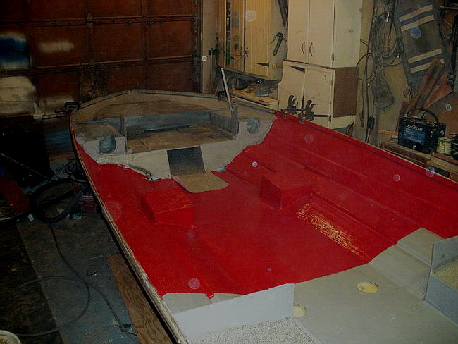

finally filled the front and rear corners with foam and then applied a coat of grey and red polyurethane paint to seal everything up .

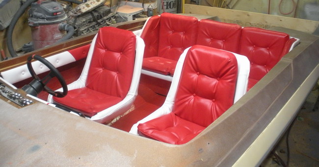

WOW! Great work and the seats look FANTASTIC!

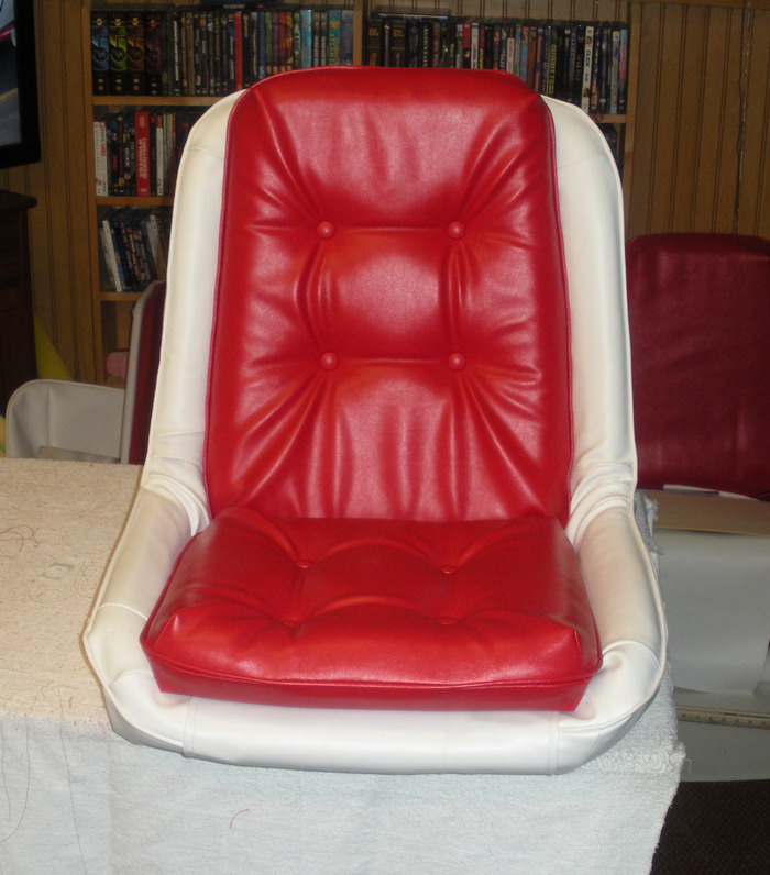

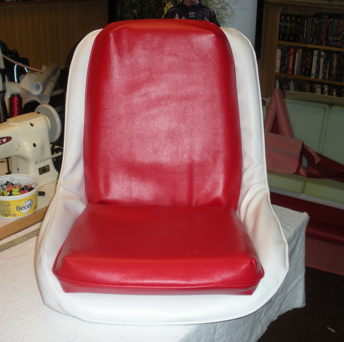

Glastron CVX 16 Rebuild 8 years 6 months ago #136048
  • hodgify
  • Senior Boarder
  • Senior Boarder
  • Posts: 163
  • Karma: 8

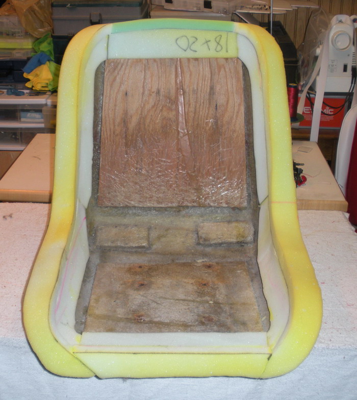

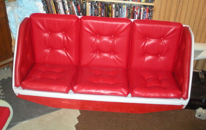

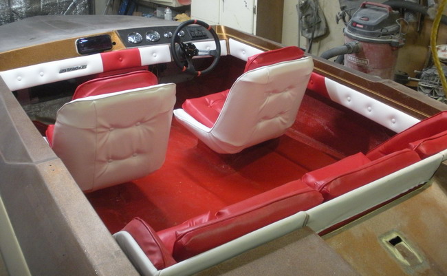

first front seat finished , not perfect but pretty close to factory .
Glastron CVX 16 Rebuild 8 years 6 months ago #136050
that seat looks great. I'm inspired on the interior.
My interior, the bumpers(?) on the sides and on the dash are there for templates. The rear bench cushion was also included, but again, template only. The front seats were not included, nowhere to be found. So I will be doing 100% of the "cabin" for seating.
Eight hulls split, and this was the easiest, thats encouraging. I cut the three tabs you mentioned for the front deck, thanks for that advice. Will remove the rub rail and prepare for the separation at the transom....
Thanks again Hodgify!

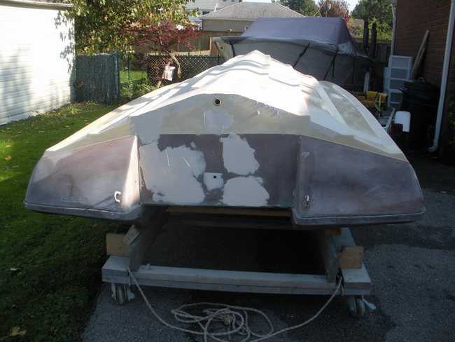

I have been lucky that most hulls that I split had transom that were so wrotten that they came apart easy. What I would do is in the second picture I would cut along the lower red line of the red box and up the two sides , on the outside in the first picture I take a chisel and pry bars and loosen as much of the lip as I can with out doing to much damage . I would then start to split the hull starting at the front , see how far you can’t split and put a 2x4 across to keep it apart and put some pressure on what is left holding the transom together and then use chisels and pry bars to finish splitting any of the glass that is still holding it together. Good luck
Glastron CVX 16 Rebuild 8 years 6 months ago #136135
  • hodgify
  • Senior Boarder
  • Senior Boarder
  • Posts: 163
  • Karma: 8

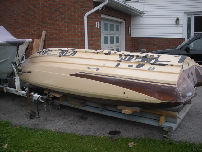

I do not have a picture of CVX after split but here is a picture of one I did last year to show how bad it can be and what it could look like after split.

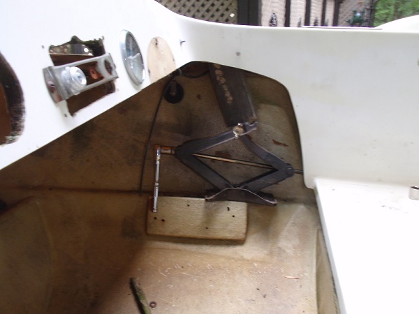

I have a suggestion to help separate the top. I have an old screw jack that works to push the top up gently then put the 2x4's between the two halves. Something similar from your car would work.

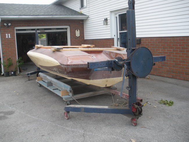

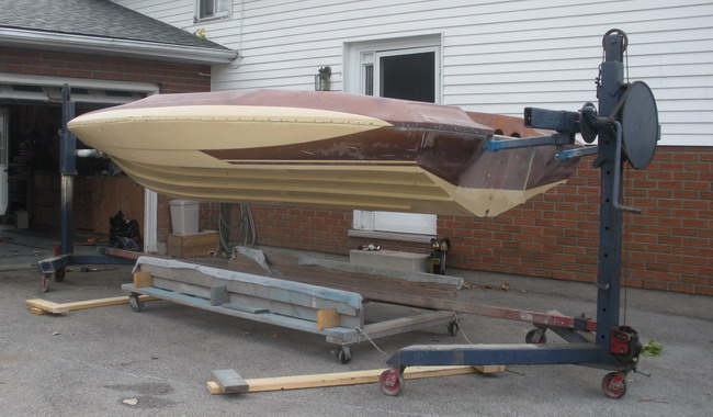

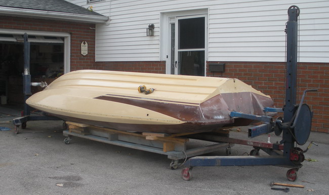

now that summers over its time to get back to work on the CVX . Lucky I have a friend that owns a marina , and he has a rotisserie for working on hulls . First time I have been able to flip a 16ft boat on my own. Hope to start sanding and repairing a couple cracks tomorrow .Would like to get bottom painted be for the snow flies. Heres some pictures of the flip.
Glastron CVX 16 Rebuild 8 years 1 month ago #137703
I want one of doze "flippers" I have to rely on the old sky hooks.

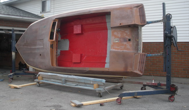

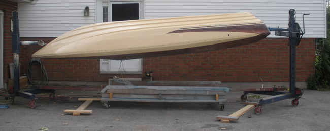

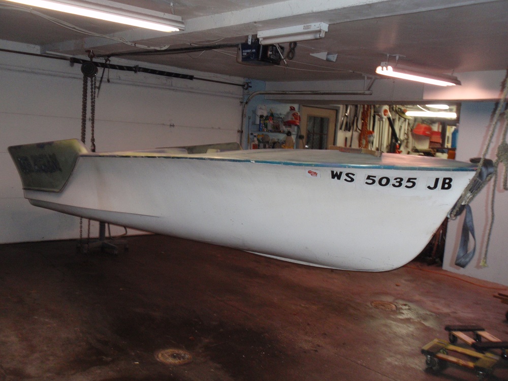

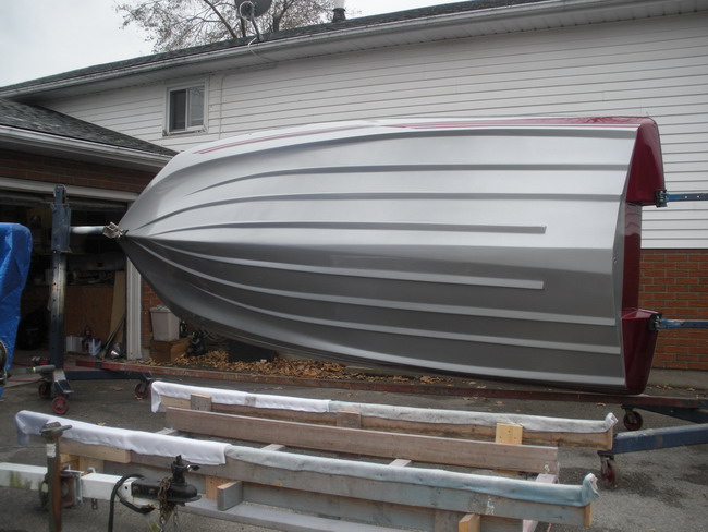

Now that the hull is flipped I took a 2 inch angle grinder and ground out all the stress cracks in the bottom, after grinding and cleaning I mixed epoxy resin with 1/4 inch carbon milled fiber , I find the epoxy does not like soaking into fiber glass mat that's why I prefer the milled fiber. I then spread and fill ground areas . After curing for a few days I sand smooth and then fill and imperfections with bondo . Will be spending the next week or two sanding and smoothing the bottom for primer. heres some pictures.
Glastron CVX 16 Rebuild 8 years 3 weeks ago #137951
Good progress hodgify, nice work.

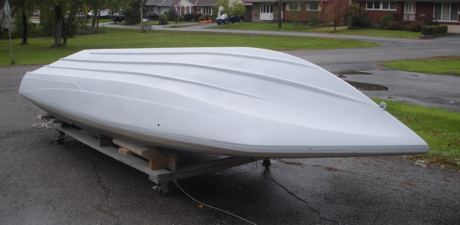

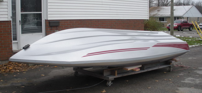

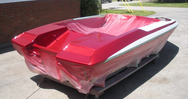

I got the bottom primed last week , used speedokote urethane primer I bought from amazon for $75.00 . Went on nice and sanded easily . Got it masked up and applied s\the stripes on the side, used a firemist red acrylic urethane paint I bought from TCP Global , paid $129.00 for a gallon with hardner . Paint sprayed on nice and has nice shine , will try to get pictures tomorrow if we do not get lake effect snow tonight.
Glastron CVX 16 Rebuild 8 years 1 week ago #138088
Looking good, what's more fun painting the house or painting the boat. Coming to an end of all your hard work and fabricating.

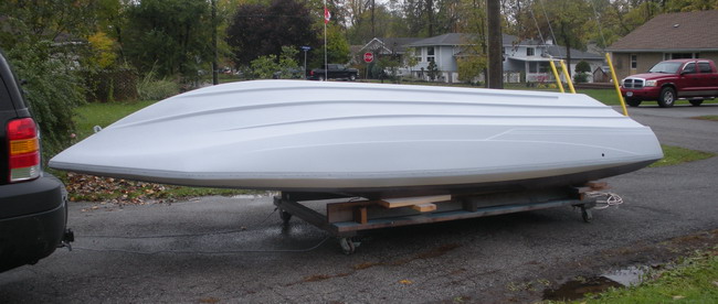

got the two colors on the bottom . flipped over and will get started on the interior and and then paint the top.
Glastron CVX 16 Rebuild 7 years 11 months ago #138146
Excellent job she looks awesome!!!!!!!!!!!!!!!

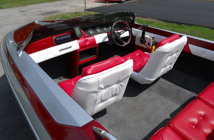

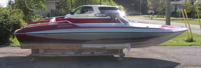

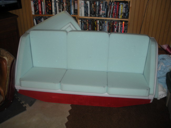

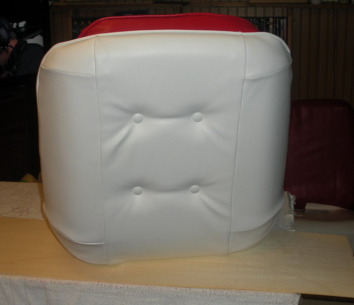

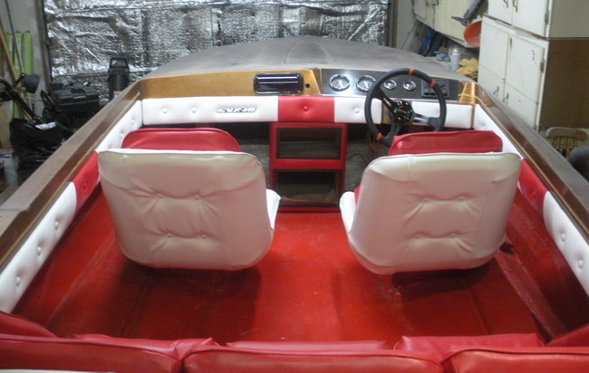

Finished sewing up the last seat , so today did a test fit of the interior including gauges radio and new wheel . Will strip it back down and over Christmas holidays will repair the top deck and get it painted . Still need to order new carpet and then decide to rebuild 150 merc or use the 90 I have on another of my boats.
Glastron CVX 16 Rebuild 7 years 11 months ago #138490
Looks really great. Like the way you did the seats. Good job!
Glastron CVX 16 Rebuild 7 years 10 months ago #138551
That paint Job looks Great! Super choice of colors..nice blend of Sexy and Tuff.
Cant wait to see the finished product, looking like its going to be a fun summer of 2019!
Had to sell my CV23 project due to health reasons, Glastron sure has a great looking hull design, Sexy and Tuff!

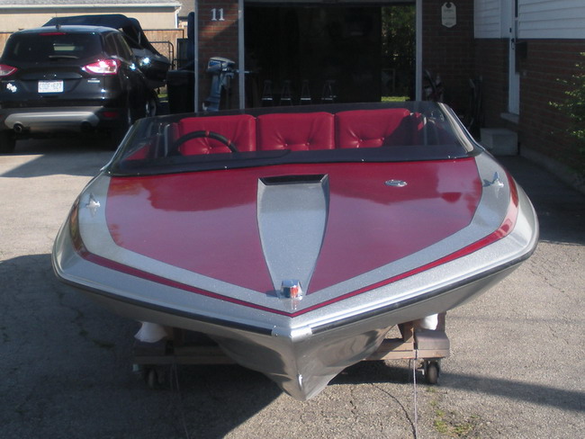

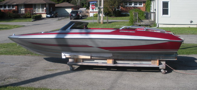

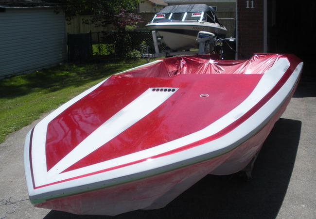

Painted the silver on Saturday and started assemble today. Put a black pin stripe to separate the two colors, and started installing hardware.
Glastron CVX 16 Rebuild 7 years 4 months ago #140168
Outstanding!!!!
Glastron CVX 16 Rebuild 7 years 4 months ago #140175
  • Dr.Go!
  • Dr.Go!'s Avatar
  • Posts: 1719
  • Karma: 19
  • Thank you received: 125
Love everything about this boat. Great color combo, stylish model and professional looking work. That will certainly turn heads and also should be tons of fun. I really appreciate the picture updates.

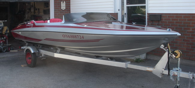

Thanks for all the comments ! Got the boat on the trailer and have spent two days getting it set up . I remember not to long ago it would only take a few hours to set a boat on a trailer . Also had a stencil made up and got the registration number sprayed painted today . Tomorrow plan on pulling the 90 merc of one of my other boats , so I can get it mounted and on the water before summers over.

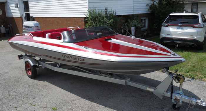

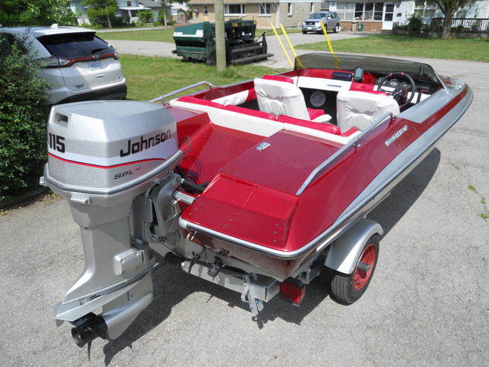

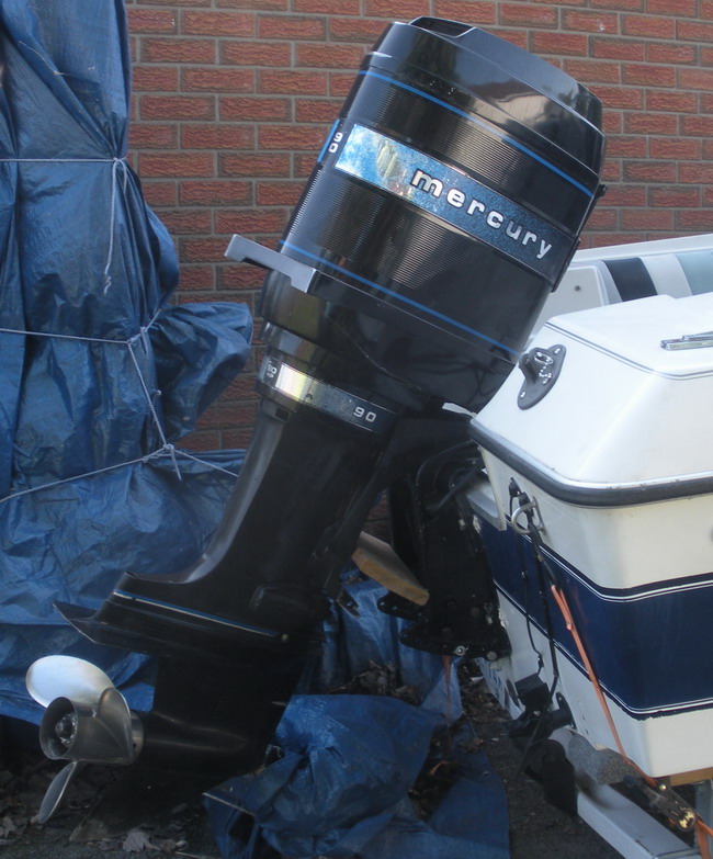

Finally found a motor and had time to paint it and get some new decals . Mounted motor fond a control box and rewired , finished hooking it up and finished putting all hardware on boat . Only thing left is to order a new bow tank and install . Now jusrt need to find time for test ride before summer is over.
Glastron CVX 16 Rebuild 6 years 3 months ago #142940
Looks pretty spiffy! Showroom condition. What year is the motor? Late 70's?
Beautiful work.
