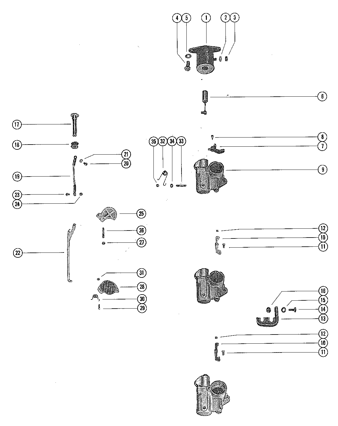

One minor problem: can't remember how the rod that connects the two top carburetor chokes, see item 22 in the picture. There is a spring that attaches to it also, can't remember where that attaches.
From the picture, it looks like the arm's extension (hand?) points to the right but it doesn't seem to fit that way.
The spring (32) attaches to something but I don't know what yet.

The carb linkage I figured out. It hooks into a nut at the bottom of the top carb. It keeps the choke open when there is no pull on it.
BIG NOTE: I don't remember the spring being hooked up when I took it off the other day. Either I'm loosing it or it wasn't done. Would this possibly be the cause of the problems? I'll know a bit later when I can get it started and out to the landing.

After work today, started the 1400 up on ear muffs just to make sure, then hooked the SSV 176 up and took it the 5 miles or so to Ancarrow's Landing (named after Ancarrow boats) in Richmond.
The engine started fairly easily, and giving it gas, it ate it up! It roared down the river and I was "stoked".
Here's what I'm 99.9% sure about what caused the problem: the choke spring wasn't hooked up before. Therefore the choke never really would return to the no choke position.
