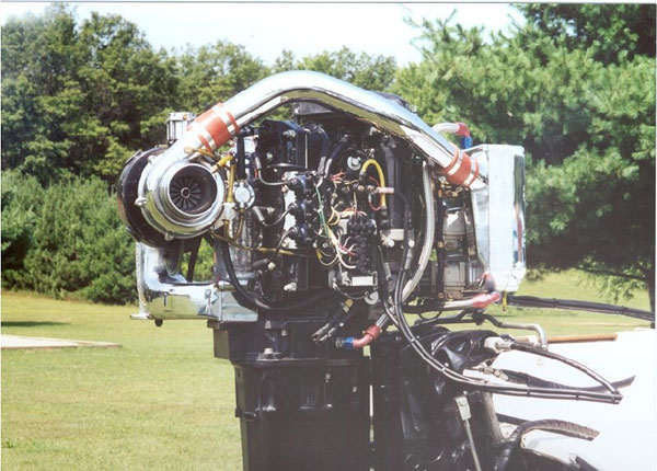

There are several turbo charged motors that have been made and shown on Scream and Fly website.
I think I have seen an old inline 6 turbocharged a long time ago.
Its very possible, but is time consuming and not easy to do. I dont even know how they do it? I just know its been done.
I need to re-read some of those old posts and see the outcome of each motor.
Conrad
Re:Spilling the beans on my supermodified 1500 15 years 4 months ago #35350
Here are a few that I found quick.
Conrad
Re:Spilling the beans on my supermodified 1500 15 years 4 months ago #35351
A v-6
Conrad
Re:Spilling the beans on my supermodified 1500 15 years 4 months ago #35352
And one more.

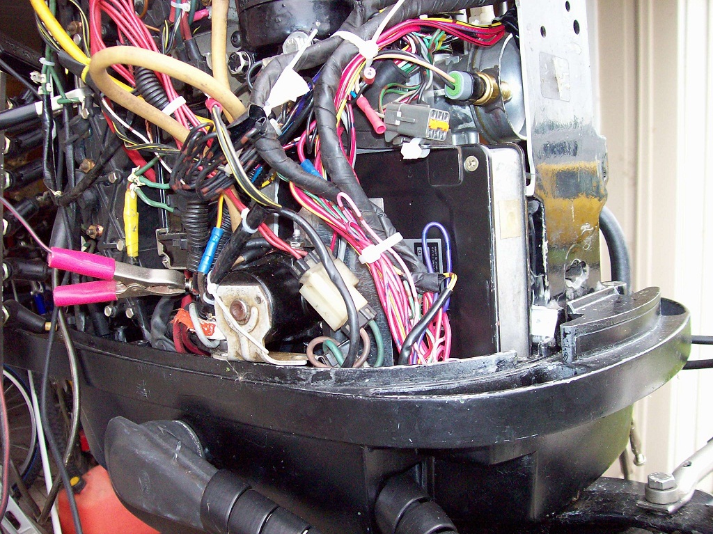

A little busy, the pic that is, here you can see where the computer is tucked, the side of the throttle bodies and the air temp sender.

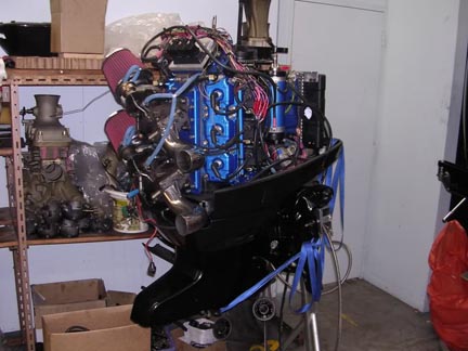

Here you can see the fuel pump and the fuel rail and injectors.

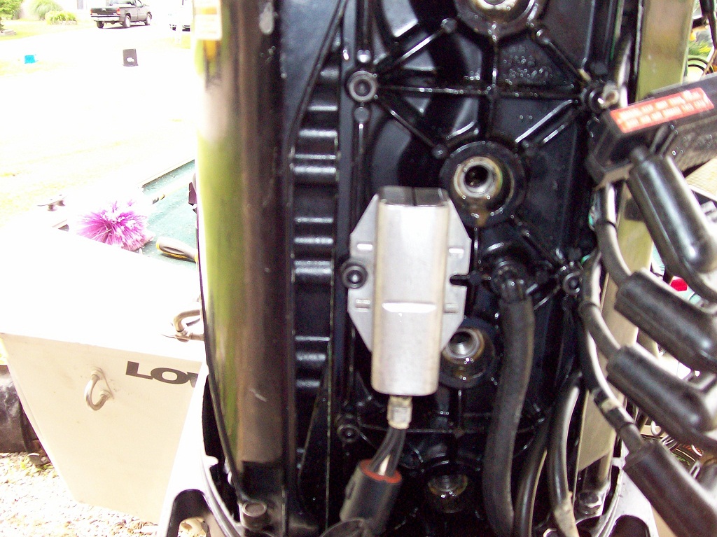

Here you can see the ballast resistors for the injectors, low impedance.

Wow, now that's a set up. How do you make heads or tails with all that wiring? Well guess it's easier when you do it yourself. LOL Great set up Dave!
Re:Spilling the beans on my supermodified 1500 15 years 4 months ago #35602
  • daveswaves
  • daveswaves's Avatar Topic Author
  • Posts: 396
  • Karma: 36
Thanks Bob. I still have to shorten some of the harness but it does all fit under the cowl. I took the pics while setting the W
OT timing (you can see the connections for the light). I know the wiring by heart :laugh:
