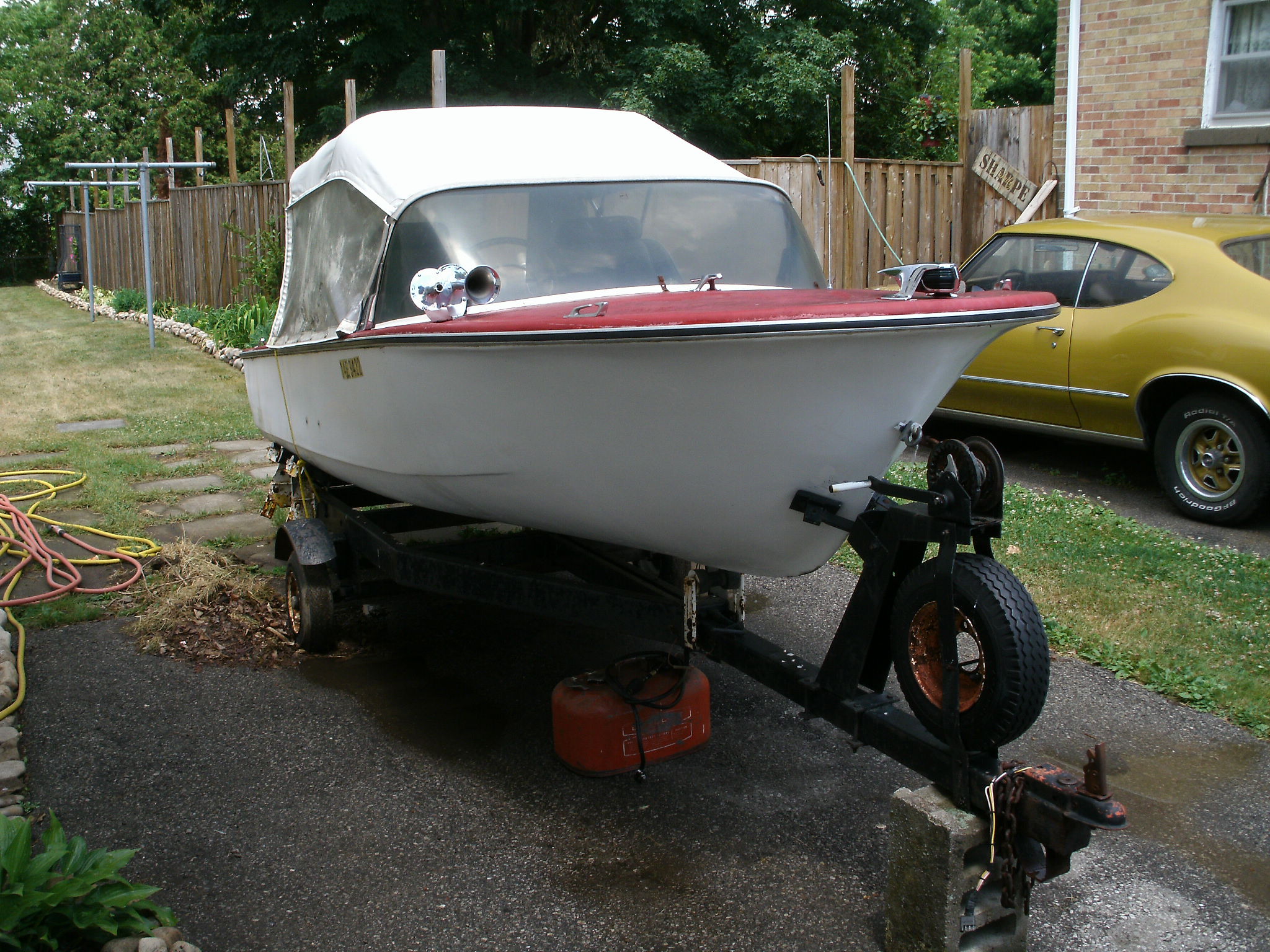

I'm in the same boat with a different boat. lol. This is my "new2me" 1960 Humber. It hasn't been started in at least four years but it's really clean and was well prepped. I just learned what I told you about that impeller a week ago :) I'm not sure if you can use the mufflers they have to cool yours or if you'll need a barrel. By looks it ain't bad. Those spark plug boots are shot and should be replaced. I really don't see anything else that would worry me. Nice find ! I hope it does fire right up for you but you might want to rebuild the carb(s). I'd imagine all the rubber bits are hardened up by now including that impeller. You'll have more and better answers before the day is out I'm sure. Good luck, I'll cross my fingers for you.

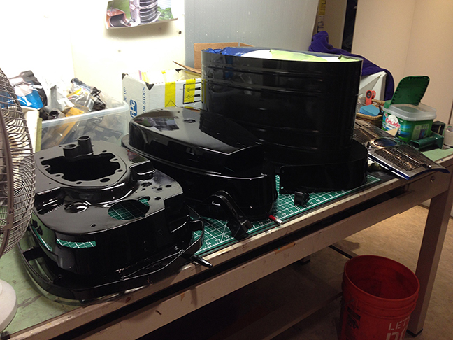

Painting with a brush will not look good unless you are a pro. I am and I couldn't do it.
You have a nice engine there, you should do a nice repaint. I get all my decals, medallions and paint from Peter at NY Marine: www.nymarine.ca/ . His site is down right now but he has all the stuff you will need. You can get a rattle can of the paint to match your motor and decals for the proper model. I buy his Urethane by the pint and use a detail gun to paint all parts.
It is tough to get to all those little areas. I am a freak and clean, prime and paint them all. It is all how far you want to go. I like factory fresh.

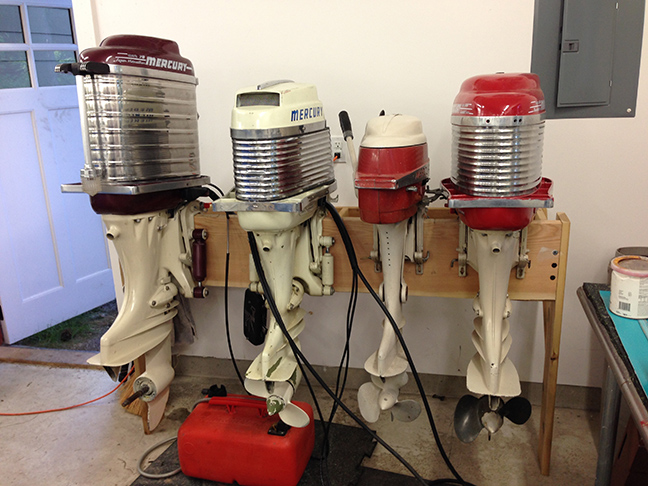

Headley, what is that bright red color on the far right called? Thanks for the site!
Re:New 2 Me 1957 Mercury Mark75 Where should I start? 9 years 11 months ago #124247
sunset orange I think
Re:New 2 Me 1957 Mercury Mark75 Where should I start? 9 years 11 months ago #124254
Cool that's what I thought. Thanks!
Re:New 2 Me 1957 Mercury Mark75 Where should I start? 9 years 11 months ago #124277
The Sunset Orange is really a beautiful paint color.
