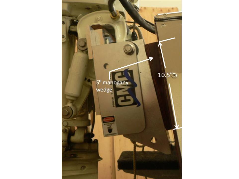

Hi Kerry,
Thanks for the advice. Currrently, with CMC PT/T and a 5 deg wedge on transom, there is about 7" set back. The cav plate is currently 2 3/8" above pad. Have good water pressure. I suspect the "side spray" is caused by cav plate deflecting the water when it's trimmed in.
I may be able go higher on the CMC w/out re-bolting the unit to the transom. The motor mount hole locations (port side) on the Merc will interfere with the hydr. sump on the CMC if I do decide to go higher, leaving only about 5/32" of thread or so to put the nut on, before interference. Not too keen on that idea though. That's with the unit trimmed all the way in. Or, I could put a hard stop, keeping the unit from trimming all the way in, leaving enough room for the bolt.

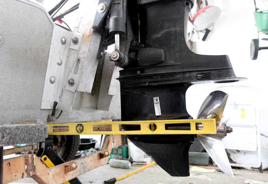

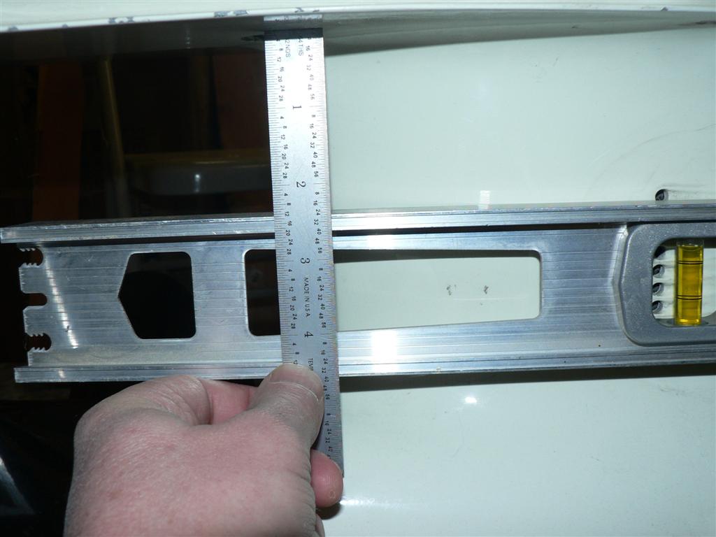

Hi Dave, thanks for the suggestion. Here are two photos showing the CMC unit and cav plate. I'll try to get an overall side view showing everything at once.
In this photo, cav plate is parallel to keel/pad. The upper edge of the level is touching the keel/pad. It shows the cav plate 2 3/8" or so above keel/pad.
This next photo shows the set up from the side, including wedge and CMC unit.

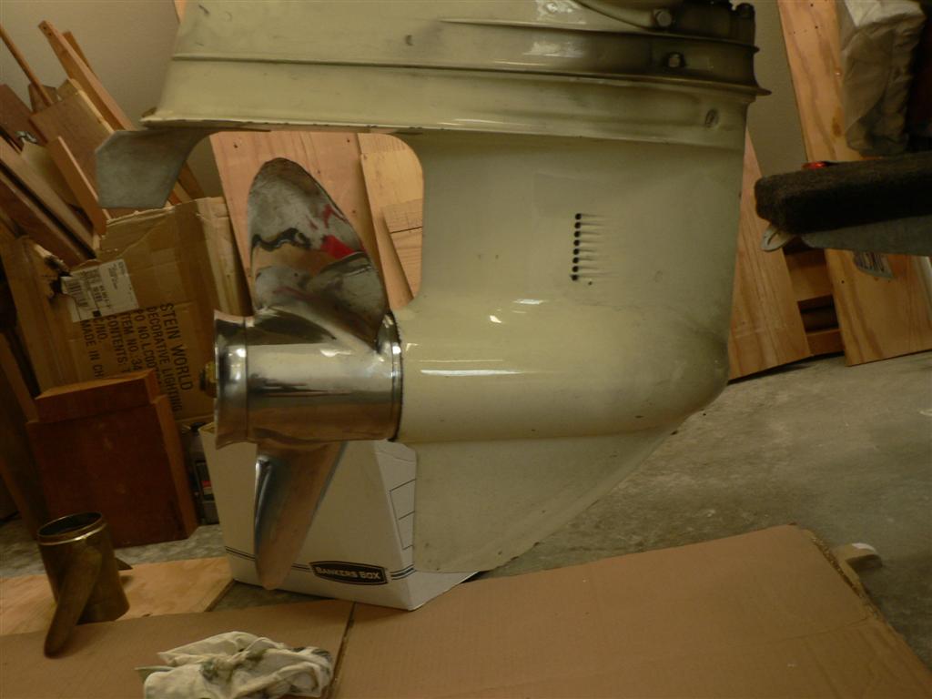

My lower unit specs are:
Through hub exhaust
4.25" dia. hub
7.5" from center of prop shaft to cav plate
15 spline hub
Here are side and back views of the lower unit
Pete
Re:1961 Merc 800 - video from shore - different prop 11 years 8 months ago #106792
Looks good Pete, you have enough clearance with that trim tab to take a higher rake prop. Ed is right on with the water pressure.
Re:1961 Merc 800 - video from shore - different prop 11 years 8 months ago #106793
Your current height (as Ed says in his post) is pushing the limit for water intake. Your top holes on the lower unit may be out of the water at trim so keep an eye on that water pressure. Nice set up, wish I lived closer to see it run in person.

Re:1961 Merc 800 - video from shore - different prop 11 years 8 months ago #106795
  • ed-mc
  • Posts: 1482
  • Karma: 235
  • Thank you received: 131
Pete, looks like you could use a prop with more rake, since you have the water intakes on the side of the L/U.
Merc makes a special trim tab which will accomodate a prop with more rake. You'll get some stern lift, which may be what your rig needs.
BTW the Doc showed me what he's done on lower units such as yours; he's either tapped some of the upper intake holes & installed allen plugs, or had the holes welded up.
This ensures that, if you're running a drastic engine height, the upper holes don't suck air.
Your L/U would be a perfect candidate for a nosecone and low-water intake, maybe that'll be something for down the road, as it were!
Edit: didn't notice before, but I see you already have the Special Modified Hi-Rake Trim tab installed!!! :0 Pretty funky there!

Just my 2 cents..(probably not worth a penny!)Spray starts .38 in the vid, gone at .42. Best I can think looking the "level" pic, its simple the V of the hull displacing water, and returning to fill the void created and hitting above the cav plate until you get more lift back end and gone. Understand what I'm trying to convey? Its not a big deal and don't worry it.
And looking the level pic, I would at least fill the top water intake hole as looks like it would be out of the water at speed.
But you are getting damn good speed out of it! Wish you were closer as let ya try my SS12x24 cupped. And yep, damn hard to find. I found one ebay and bought it on the spot. Lucky find!

Pete...PARK THE Boat and go on the overseas vacation! When ya get back I'll send that 13x23 2B to ya. Might just be the ticket, but like said PM at the moment I have no use for it. If it works, good. Keep it. If not leave it in your stash. One can never have enough props! Just never the one ya need! Have fun on vacation!
Re:1961 Merc 800 - video from shore - different prop 11 years 8 months ago #106926
  • Robby321
  • Robby321's Avatar
  • Posts: 902
  • Karma: 42
  • Thank you received: 10

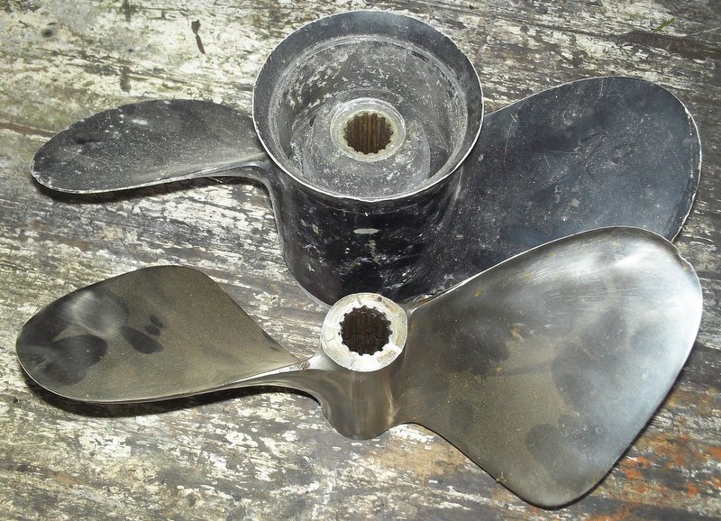

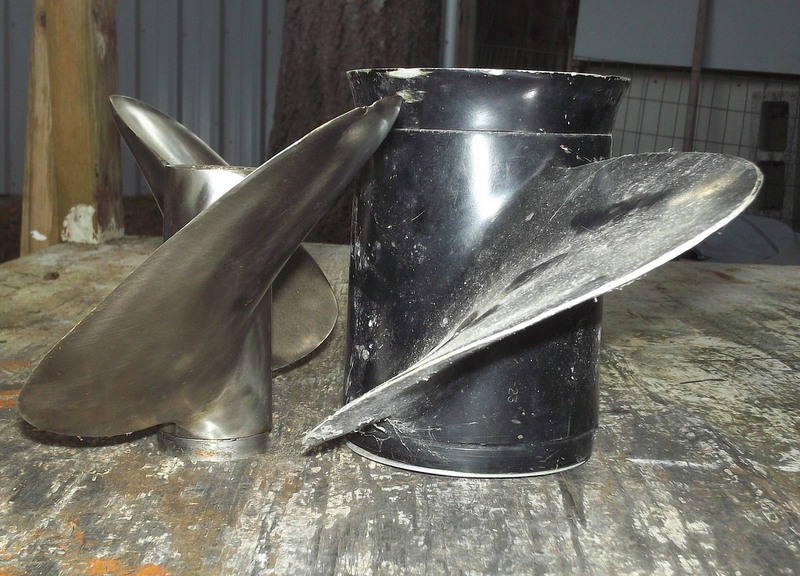

Pete, prop is boxed and waiting yer return to send ya. Heres a couple pix it 13x23 and next my 12x24.
Re:1961 Merc 800 - video from shore - different prop 11 years 8 months ago #106927
  • Robby321
  • Robby321's Avatar
  • Posts: 902
  • Karma: 42
Whoops, pix to big and had downsize. Hope this works now.
Re:1961 Merc 800 - video from shore - different prop 11 years 8 months ago #106929
That might be a perfect prop for him Robby. At some point to really utilize that prop Im guessing the motor will have to go up at least an inch.
Peter, Vance Manufacturing makes a thin 3 inch jack plate you probably could attach to your CMC tilt . It would give you a total of 9 inches of set back, which you may or may not need, but it would give you easy ability to raise and lower the motor. The Vance would give you 4 inches of travel up.
Just an idea.
Conrad
Re:1961 Merc 800 - video from shore - different prop 11 years 8 months ago #106936
  • Kerry
  • Posts: 675
  • Karma: 51
Yeah, that 2 blade looks absolutely wicked, I just wonder about its ability to "hold" the water/air mix at speed. It will, up to a point, then it will fall off. There is a reason for higher speed boats having 3 or more blades. The more air you introduce to the prop, the less "grip" it has. Adding a third blade gives more blade area in the mix, and adds grip. I do believe the best prop, especially with more height, would be the 1970's 22p inline Chopper already mentioned. However, if the 2 blade is close, and just needs a tweak, I've heard lots of good about these guys. www.dahpropellers.com/
