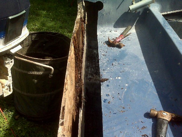

the original glass over the rotten wood was so thin the mulch was exposed in places , now its thick enough to stand on its own if the wood ever rots again

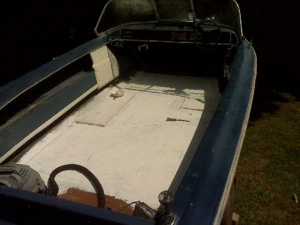

Re:1968 Larson All American purchased last year 14 years 7 months ago #58092
  • coolbri70
  • coolbri70's Avatar Topic Author
  • Junior Boarder
  • Junior Boarder
  • Posts: 64
  • Karma: 2
gelcoating the floor :cheer:

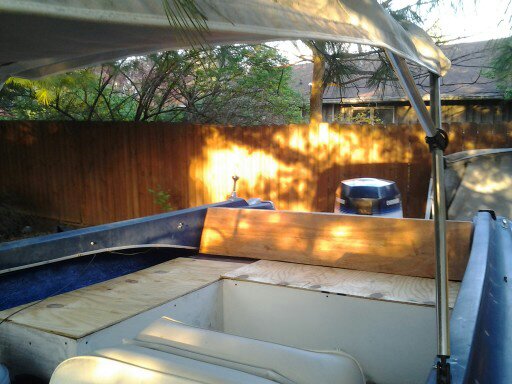

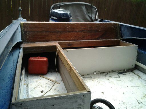

;) framework for ski locker and bench seat when i finish tabbing it in i will remove the screws and fill the screw holes and glass over, the large holes will have removable and hinged seat cushons with hinges

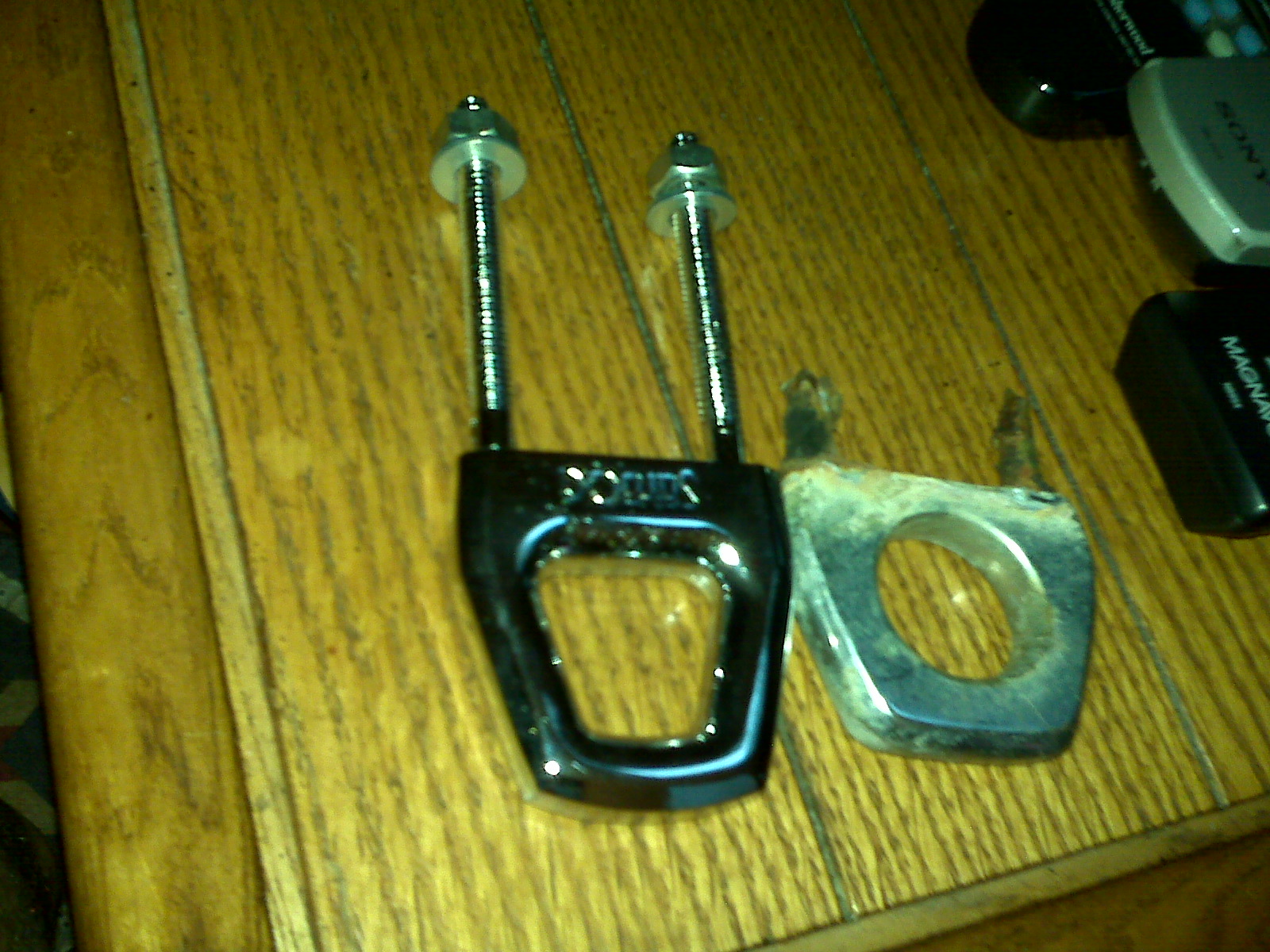

:(my bow eye was broken so a new one comes in the mail ;)

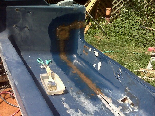

:unsure: color is worn off in places :angry: do i paint or gelcoat?

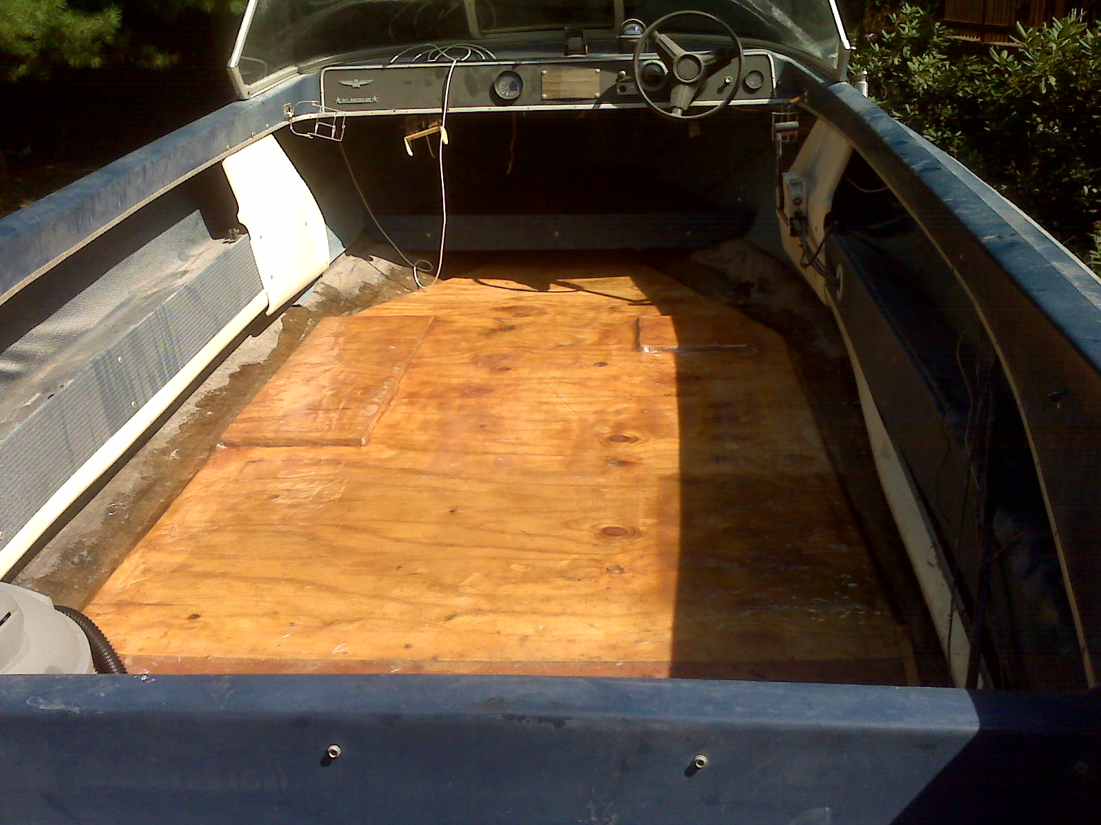

Re:1968 Larson All American purchased last year 14 years 7 months ago #58108
  • coolbri70
  • Junior Boarder
  • Junior Boarder
  • Posts: 64
  • Karma: 2
repairing the engine mount i will later redrill the bolt holes for the top 2 motor mount bolts paint would be easier gelcoat last longer those cracks are gone now :unsure: :cheer:

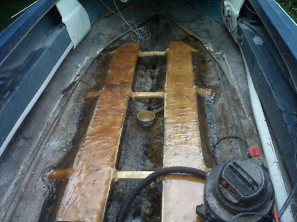

Re:1968 Larson All American purchased last year 14 years 7 months ago #58114
  • coolbri70
  • Junior Boarder
  • Junior Boarder
  • Posts: 64
  • Karma: 2

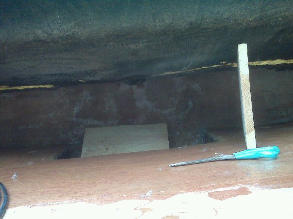

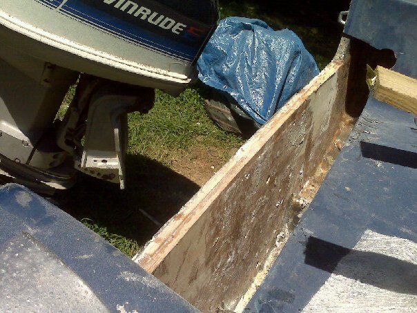

where the stringers meet the transom
Re:1968 Larson All American purchased last year 14 years 7 months ago #58116
  • coolbri70
  • Junior Boarder
  • Junior Boarder
  • Posts: 64
  • Karma: 2
i wrapped the new transom with glass then tabbed it in with filleting, cloth chop strand matt,more cloth then more csm new stringers and transom were tons of sweat :S
Re:1968 Larson All American purchased last year 14 years 7 months ago #58118
  • coolbri70
  • Junior Boarder
  • Junior Boarder
  • Posts: 64
  • Karma: 2

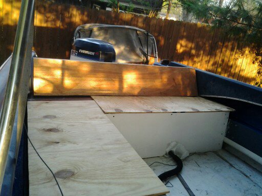

the floor finally :lol: the motor dos'nt bounce anymore and the hull stays rigid when you shake it :cheer:

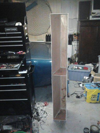

this is gonna be my backrest/speakerbox for the rear bench

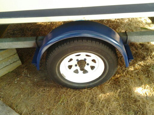

some paint and tires

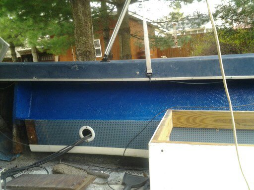

Re:68 Larson stringer, floor and transom replacement 14 years 7 months ago #58358
  • coolbri70
  • Junior Boarder
  • Junior Boarder
  • Posts: 64
  • Karma: 2
ripped out the moldy rubber then painted the sides

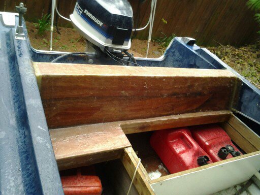

then test fit the back rest and seat bottoms
Re:68 Larson stringer, floor and transom replacement 14 years 7 months ago #58362
  • coolbri70
  • Junior Boarder
  • Junior Boarder
  • Posts: 64
  • Karma: 2
the ski locker lid will be on hinges and the bench will be a lift out

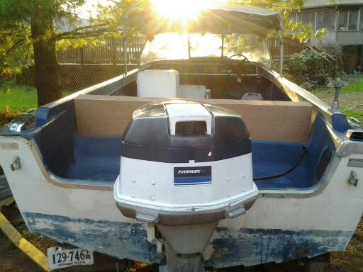

Re:68 Larson stringer, floor and transom replacement 14 years 7 months ago #58364
  • coolbri70
  • Junior Boarder
  • Junior Boarder
  • Posts: 64
  • Karma: 2
from behind trim to fit then i can glass it in

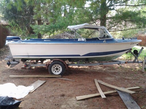

at the launch :laugh:trying to post pics, not working
