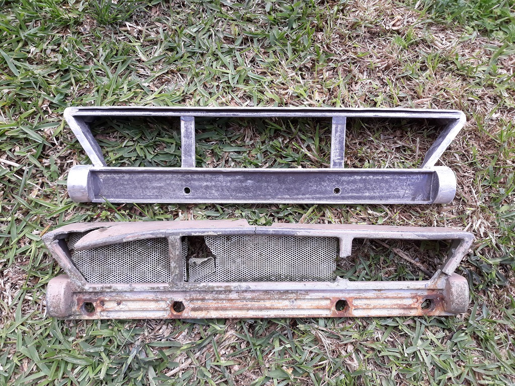

I take advantage of my post to put some pictures of a friend’s sea sport.

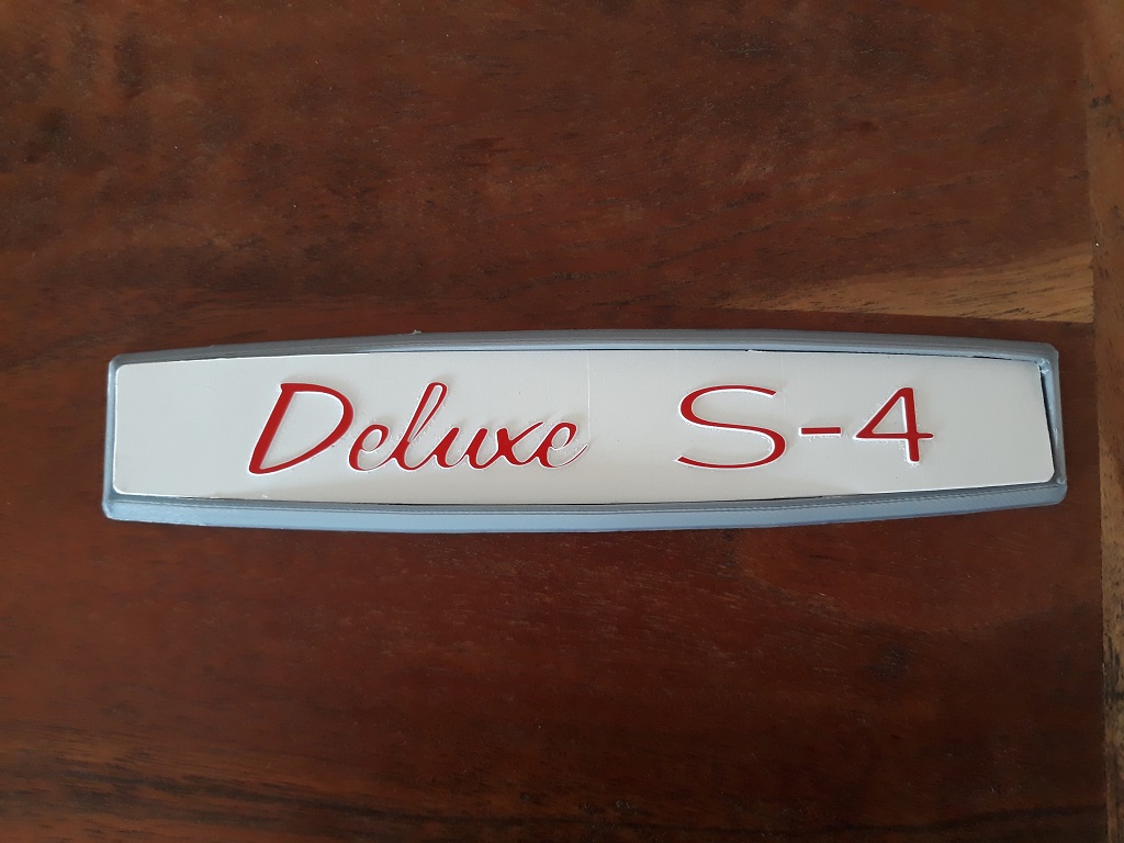

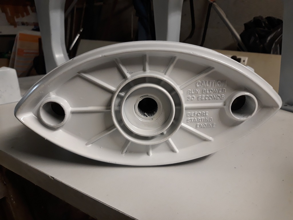

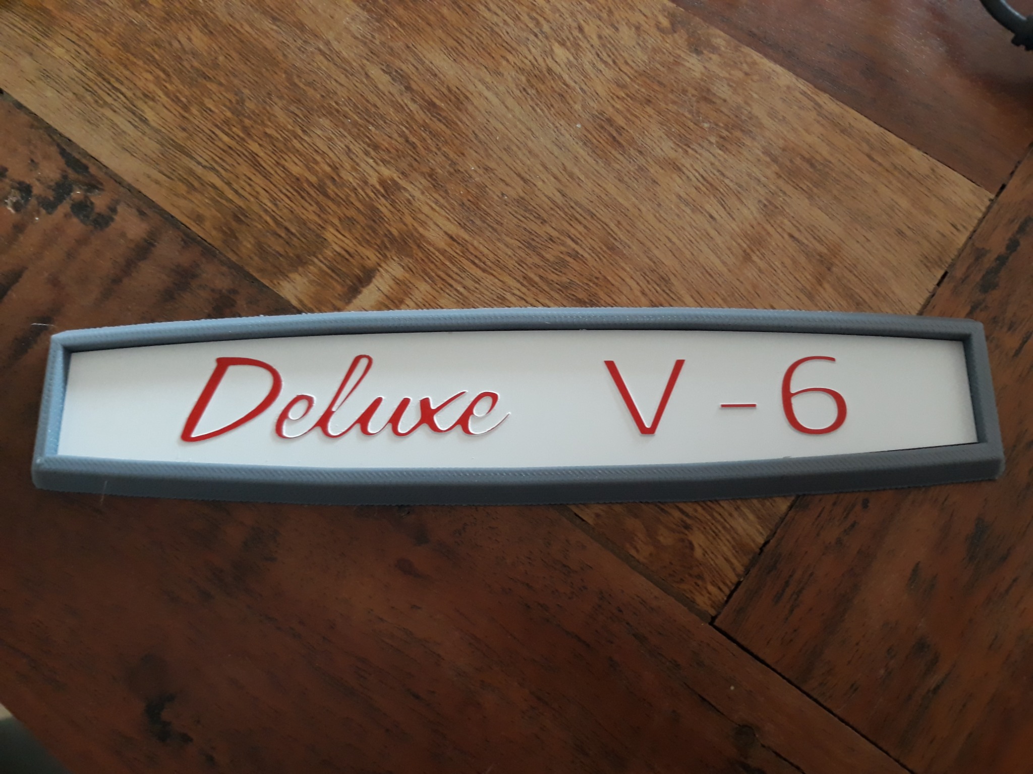

In the process of finishing. Made with a 3d printer by a friend. It must achieve the same with the acronym v6
I will see which one I put according to the engine I will install

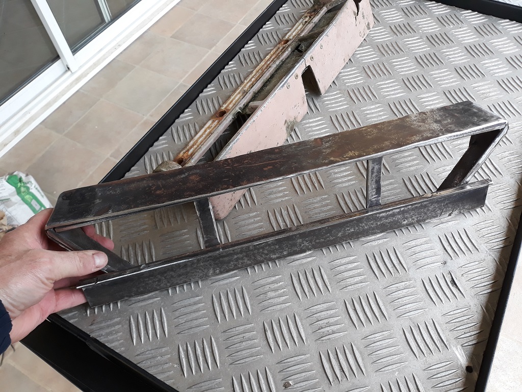

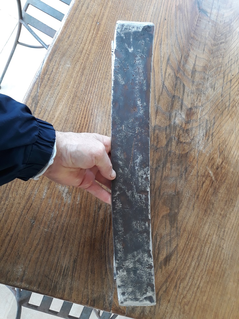

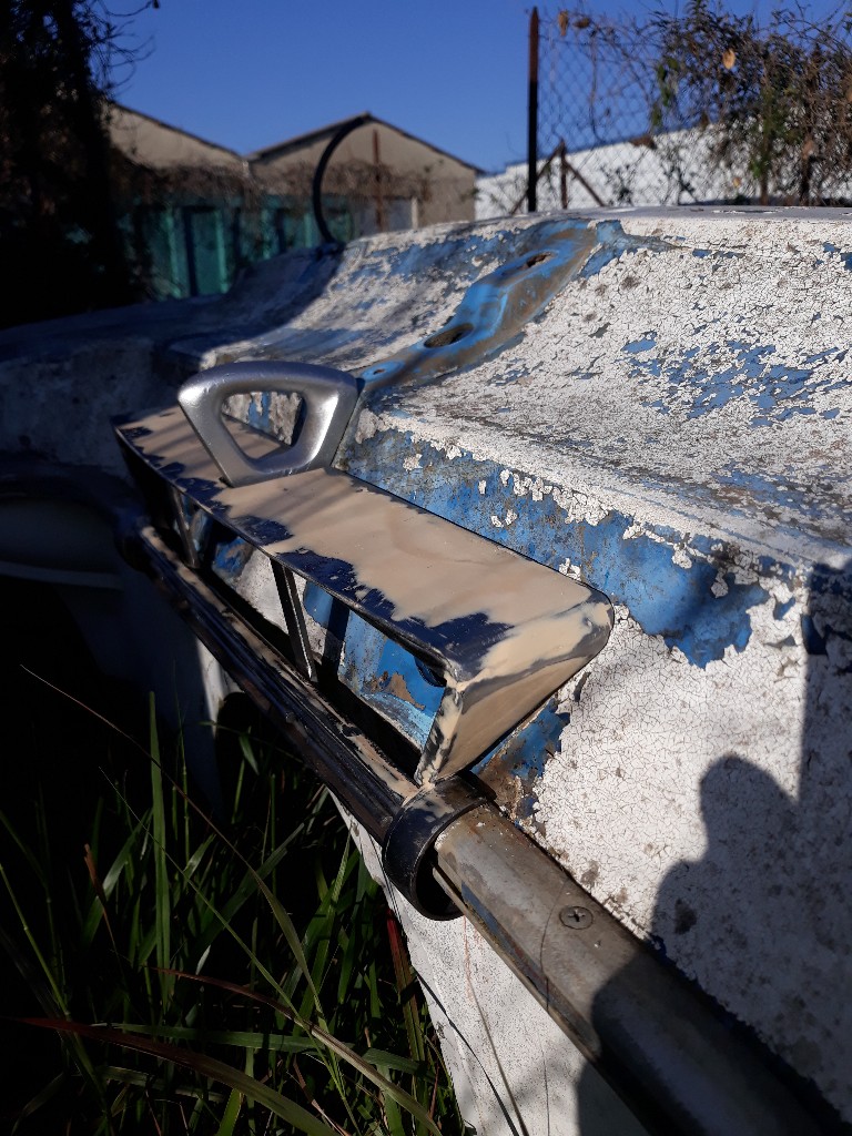

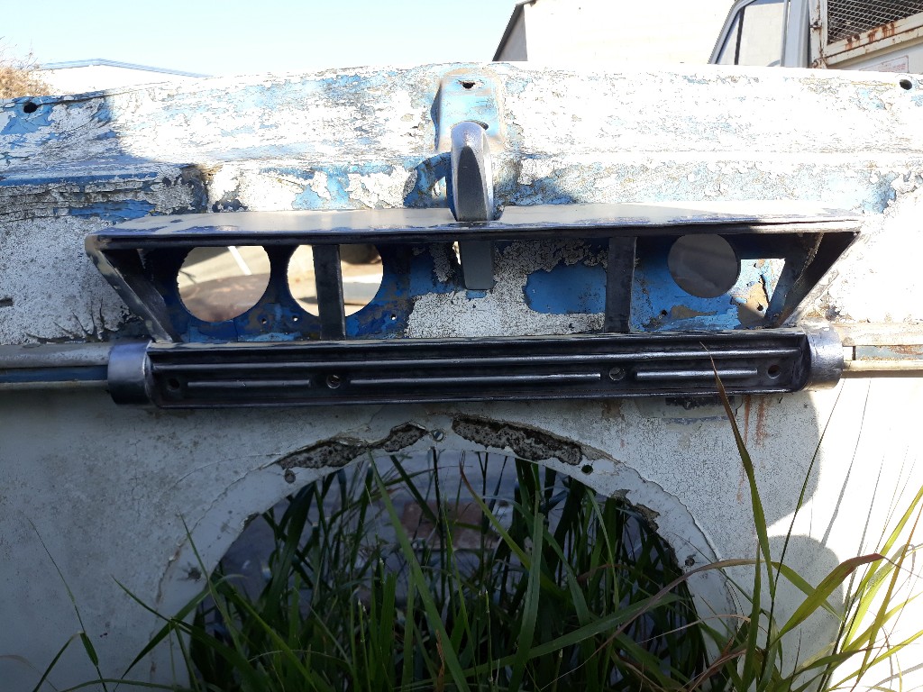

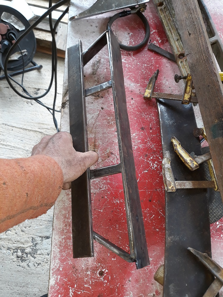

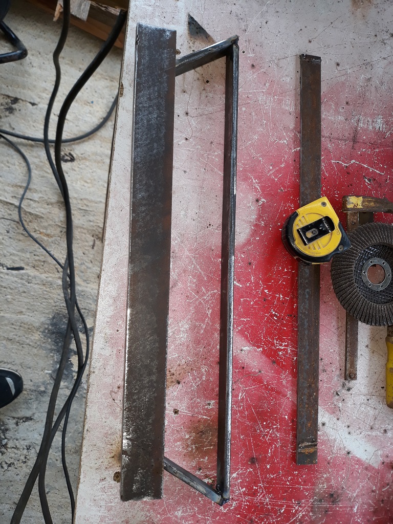

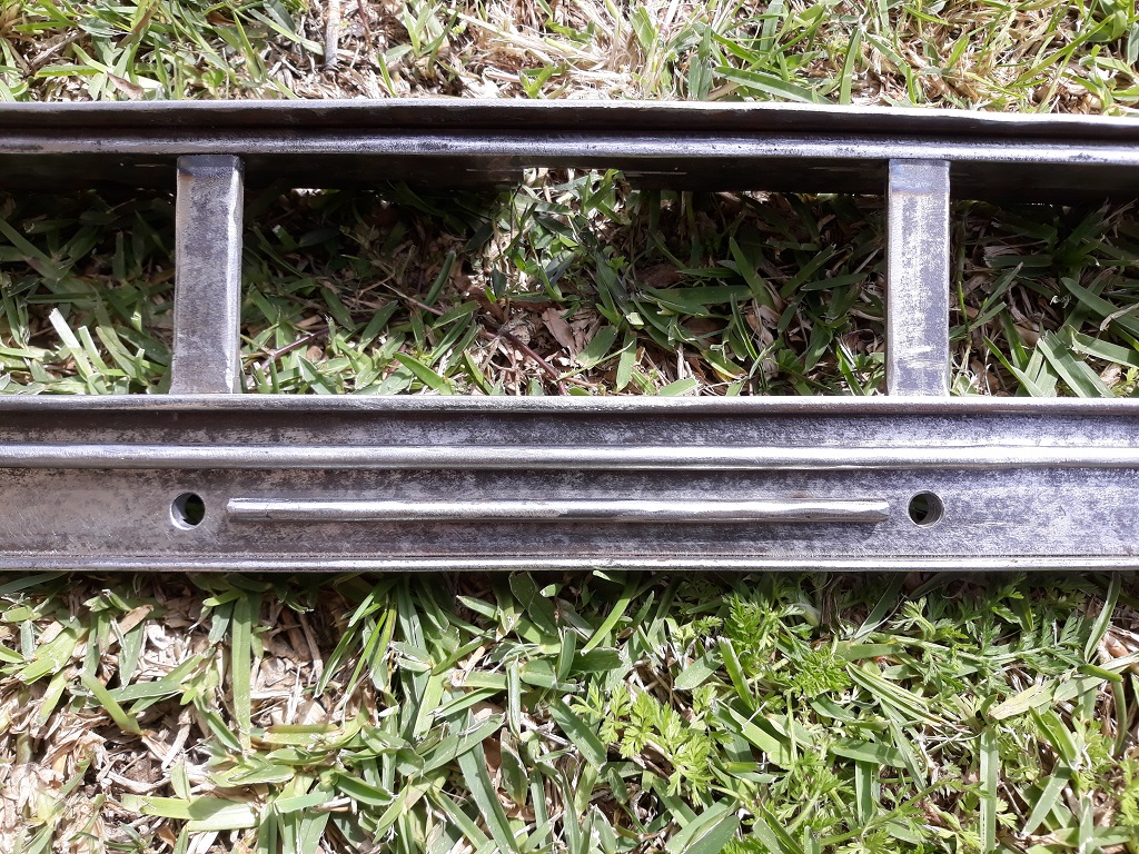

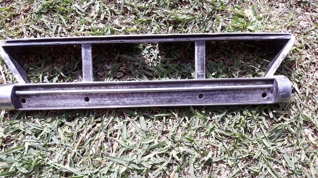

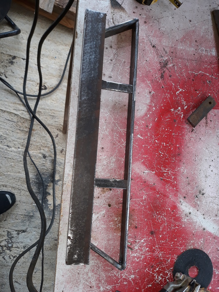

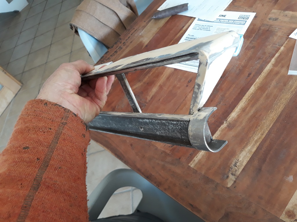

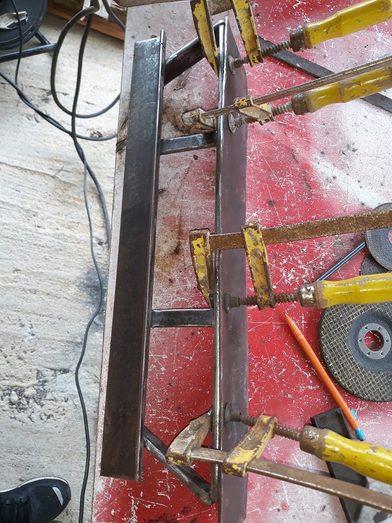

Having a little time right now I had fun with scrap metal to reproduce the back part of my deluxe. A friend who picked up an old deluxe gave me his that is very damaged so I can have a model. Now i have to see if it fits well on the hull. Not having it at home I will see this weekend. There are still some finishes to be done but it looks pretty good ! ;)

Nice... that is some serious talent and hard work. Pretty cool!

I went to try the part on the hull, and it fits well. remains to finish !

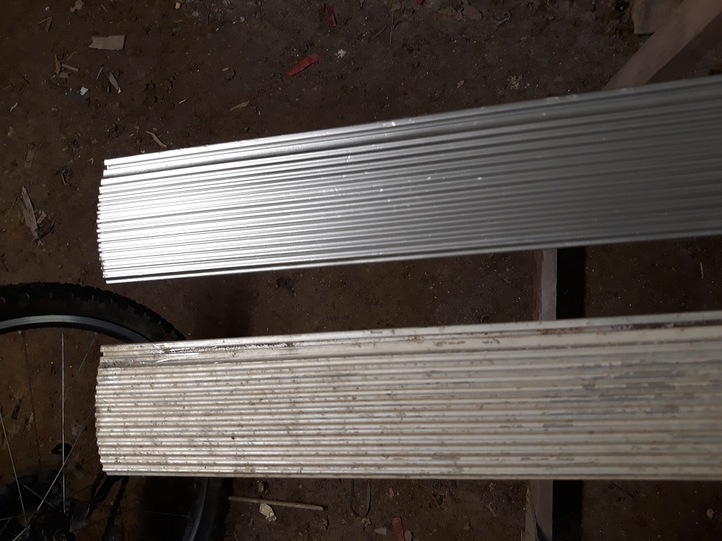

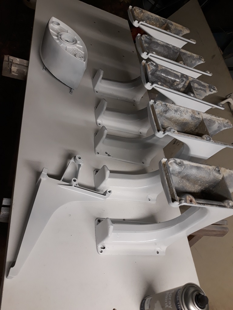

Restoration of the plates of the small interior shelves....
Before......
After....

Back part completed. Unfortunately not having for the moment the possibility to work on the hull I continue the restoration of small interior parts....

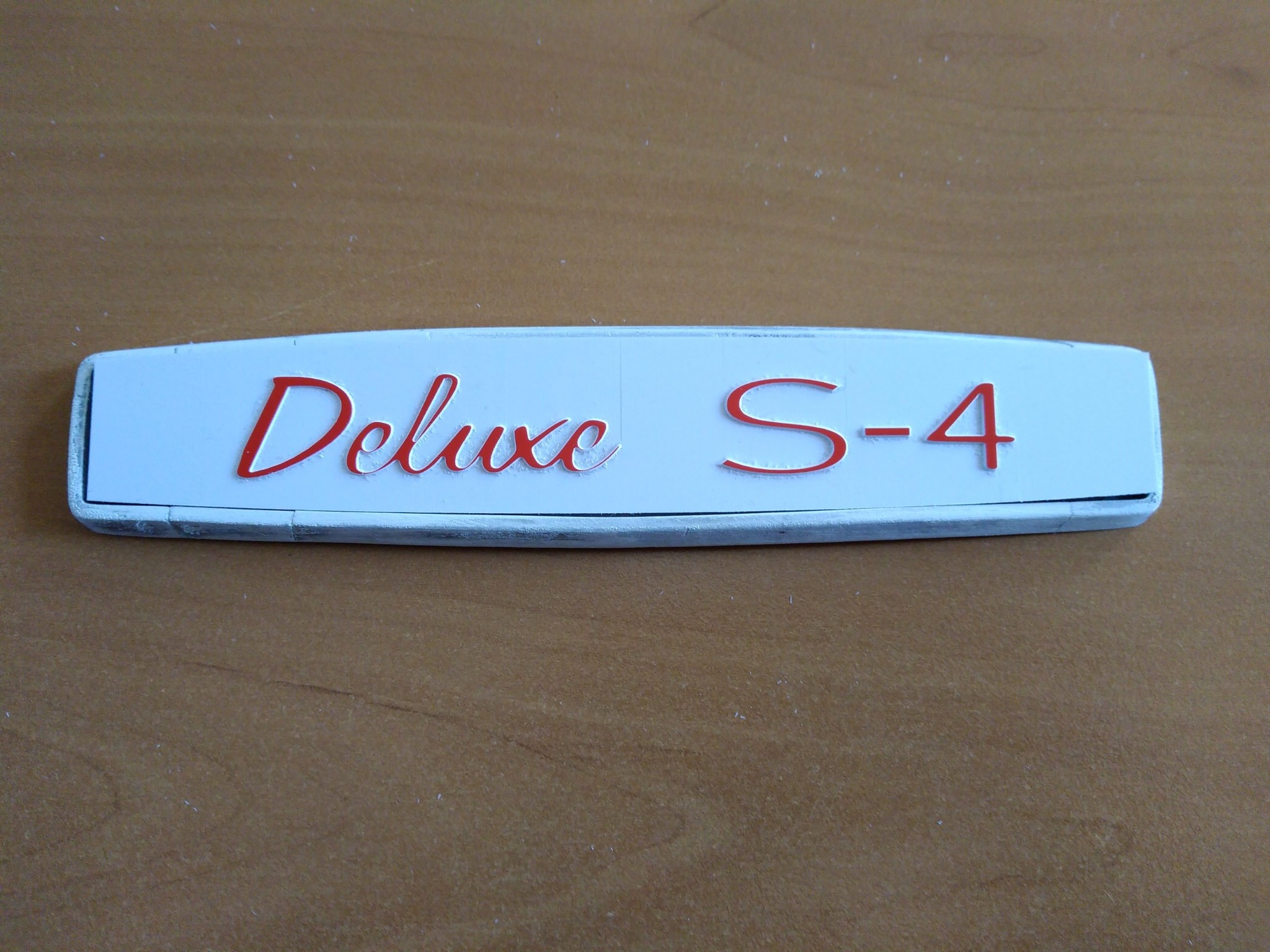

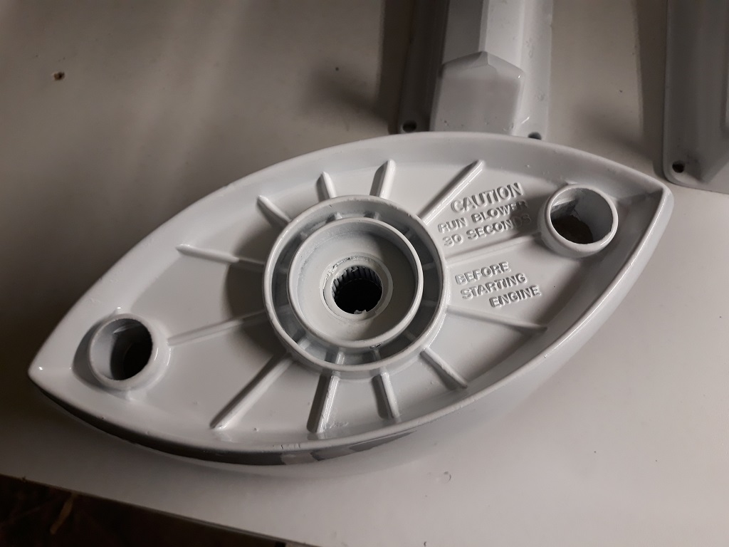

Made with 3 d printer. I was inspired by this one. I will achieve the same with V6

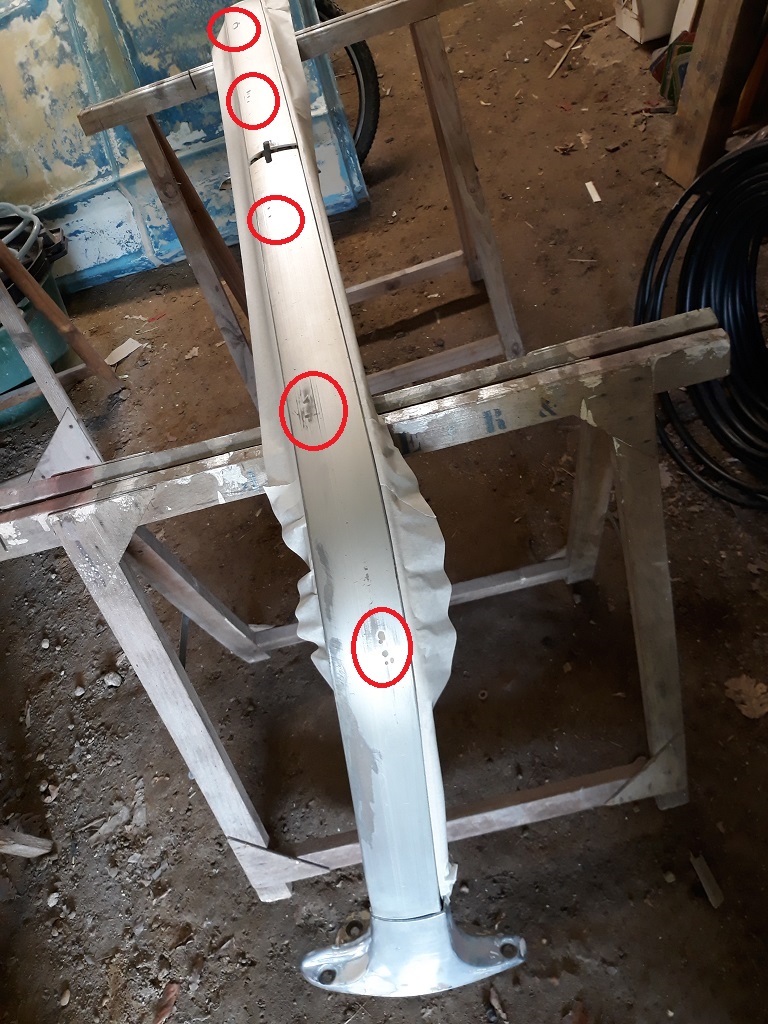

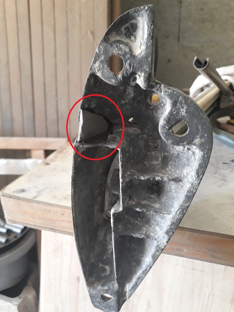

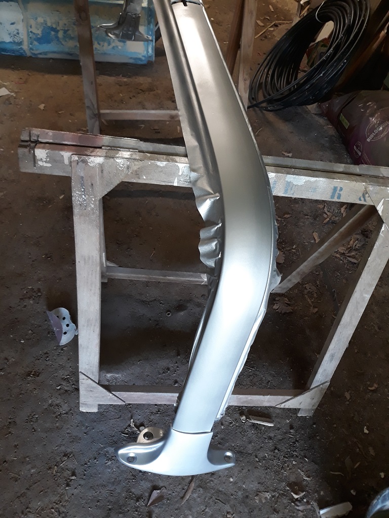

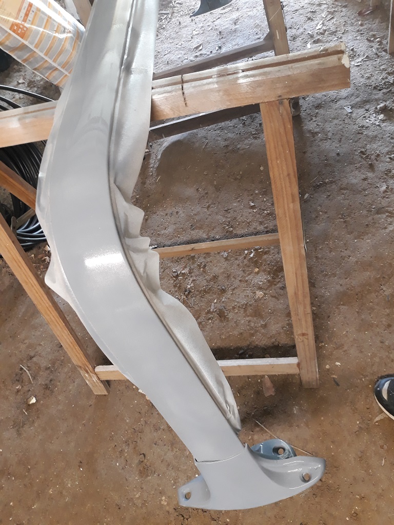

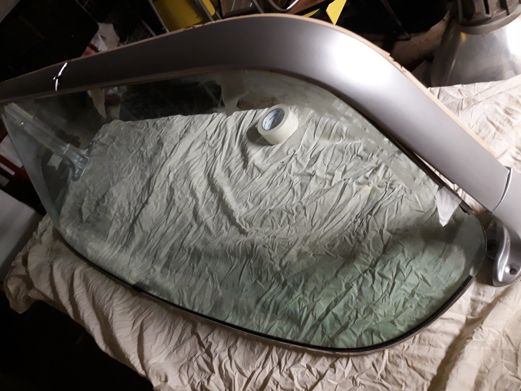

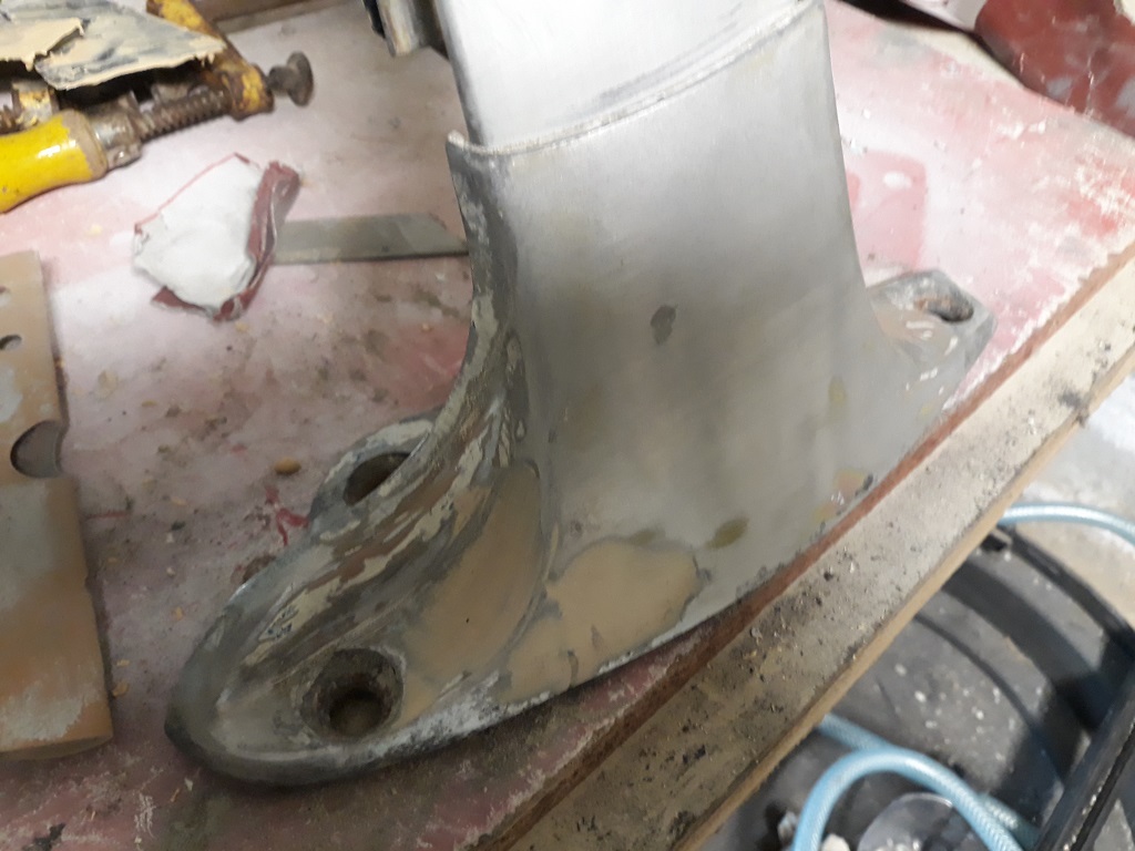

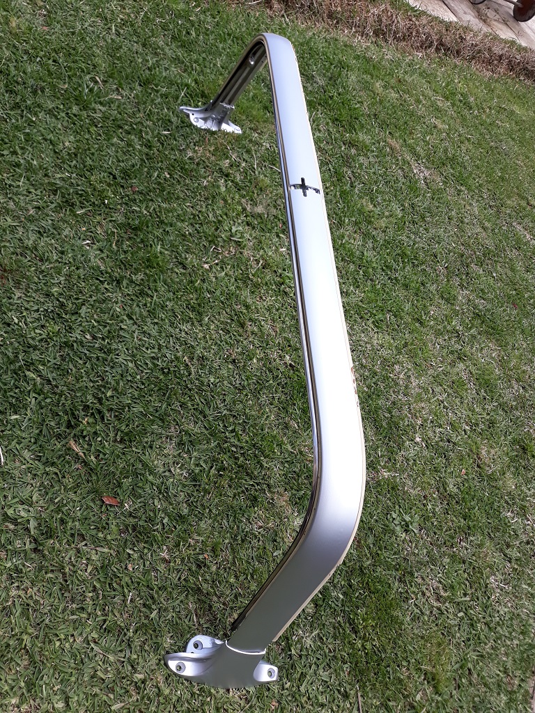

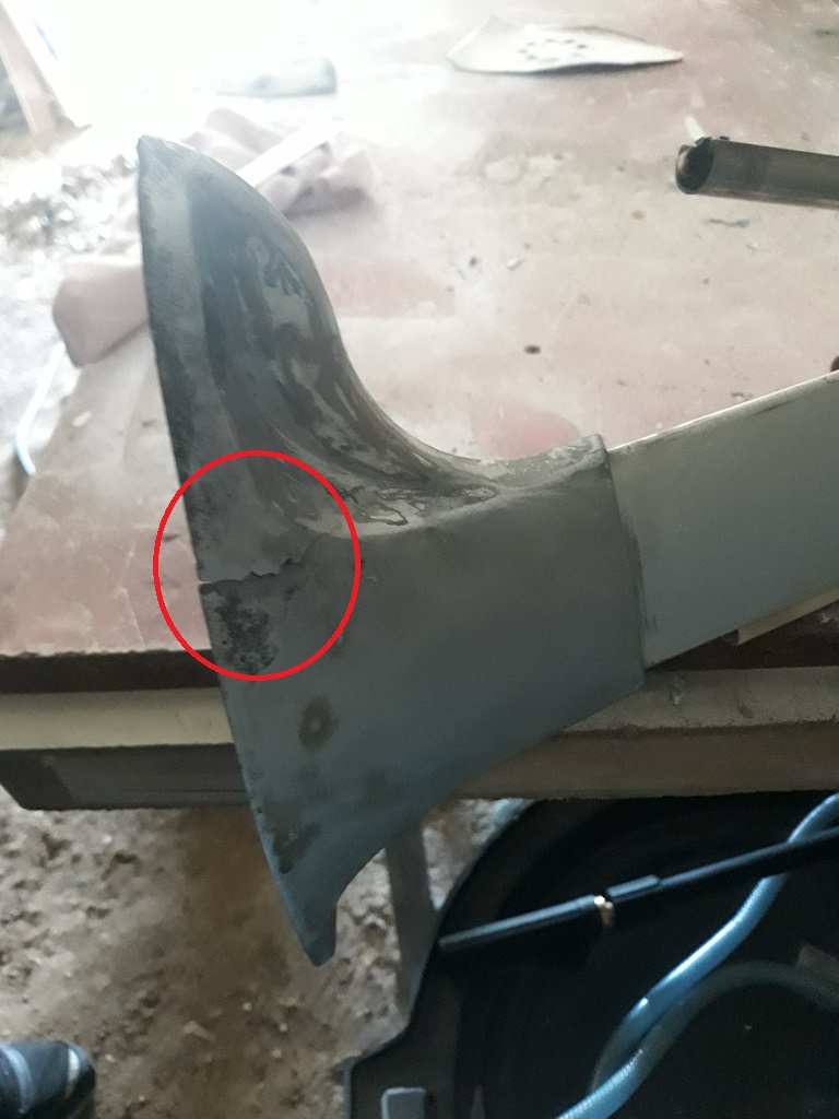

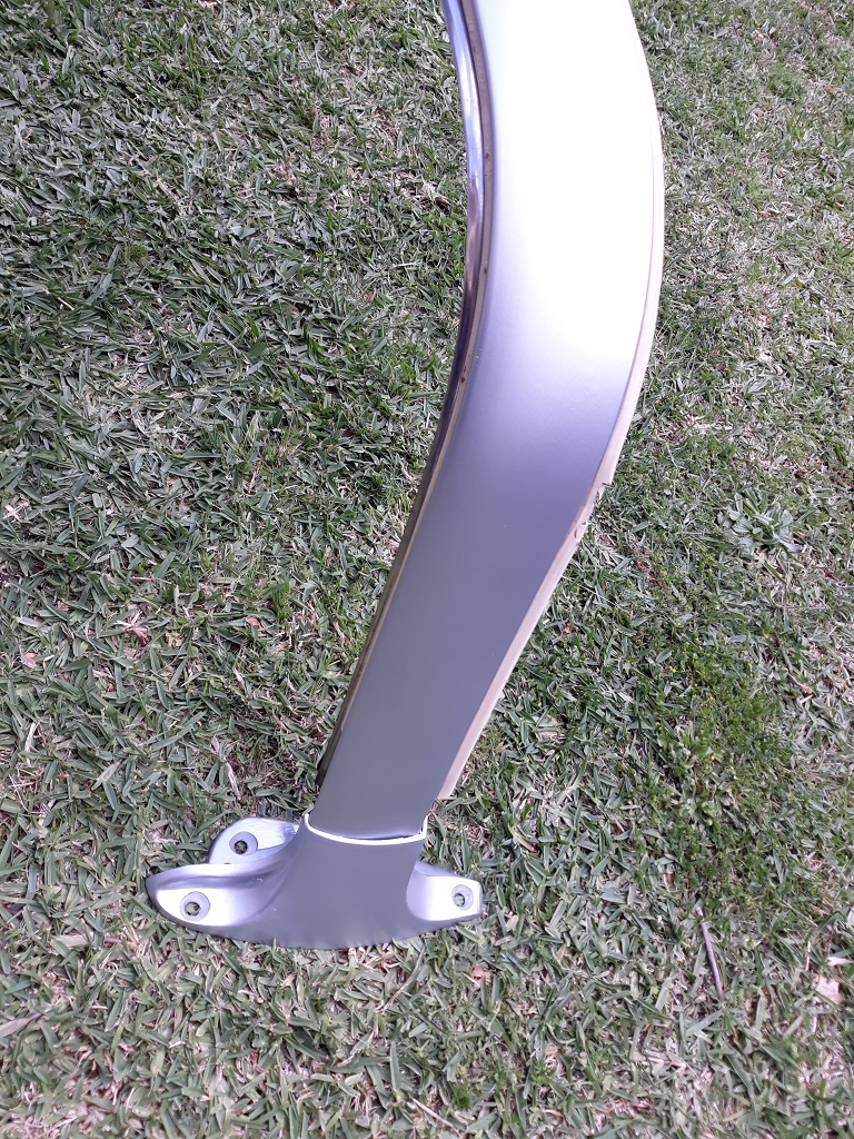

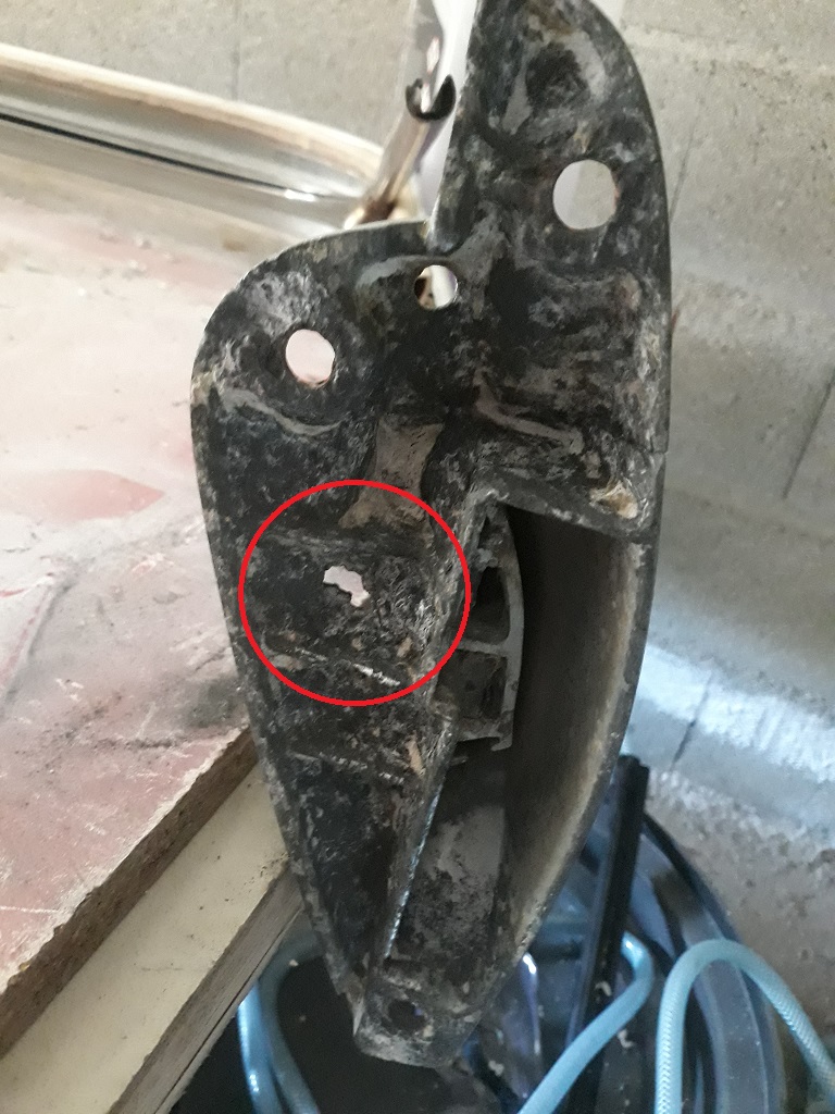

Repairof the windshield pillar. Installation of small plates glued with epoxy to reinforce the breaks. Filling of the holes, coating afterwards and painting.
1964 Johnson deluxe restoration project for 2021 5 years 4 months ago #144625
  • evb11
  • evb11's Avatar Topic Author
  • Junior Boarder
  • Junior Boarder
  • Posts: 94
  • Thank you received: 7

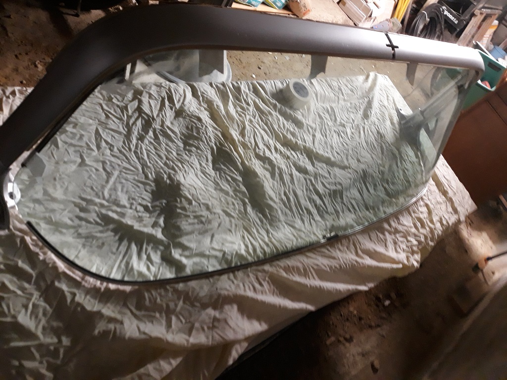

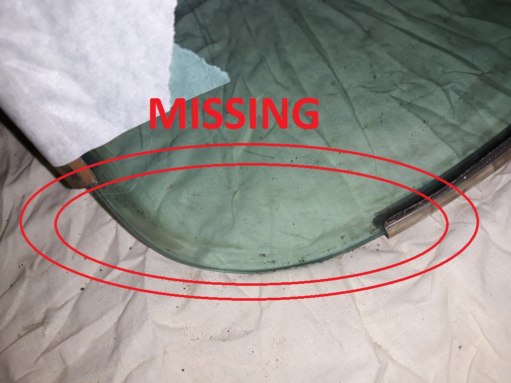

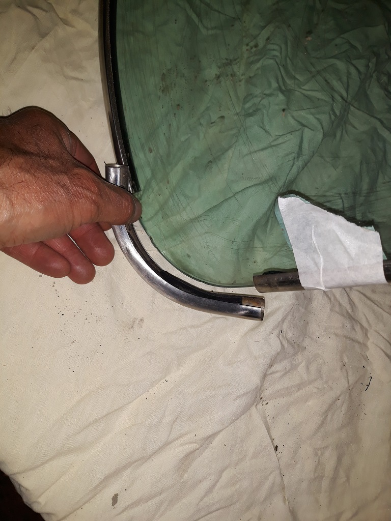

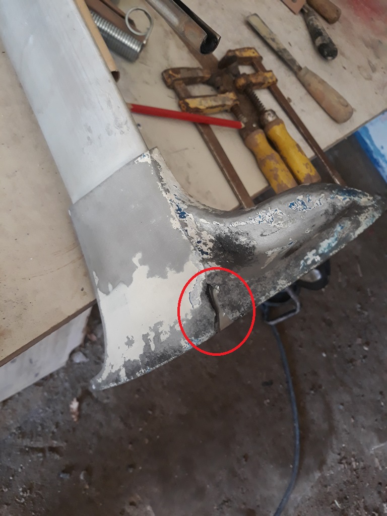

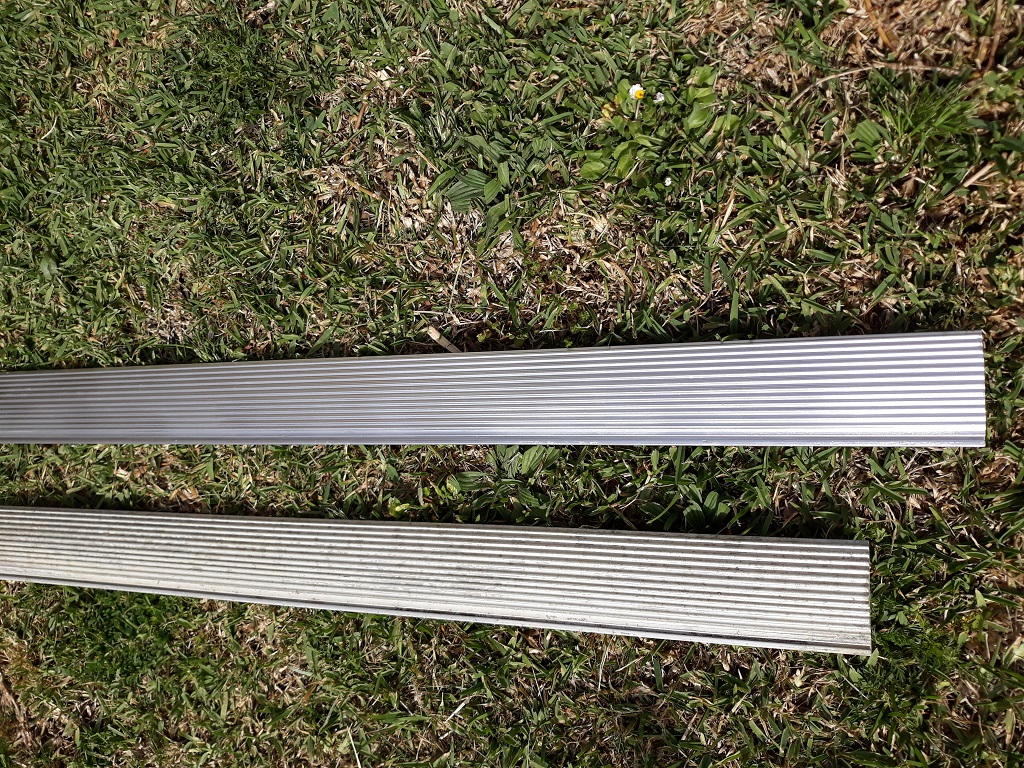

Glass adjustment. I'm missing a metal angle, if anyone has one to help me out ;)
This is the right that I miss

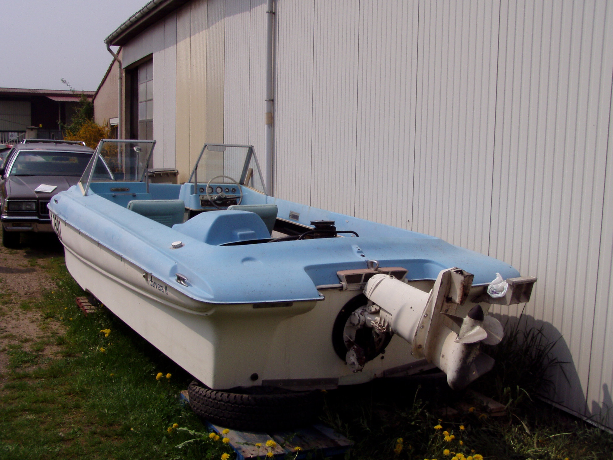

1964 Johnson deluxe restoration project for 2021 5 years 2 months ago #145227
  • evb11
  • Junior Boarder
  • Junior Boarder
  • Posts: 94

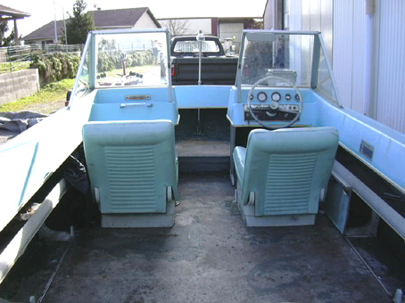

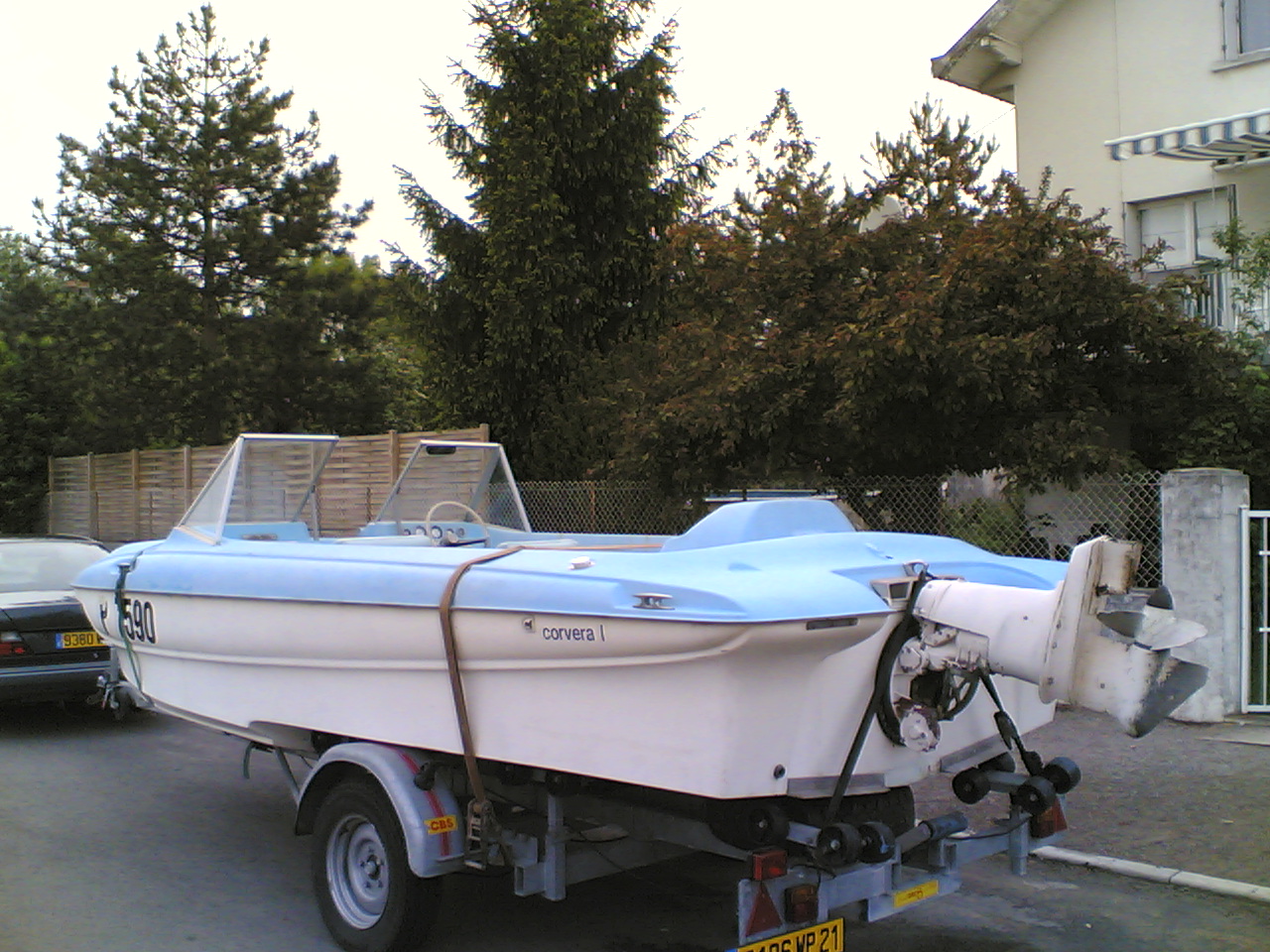

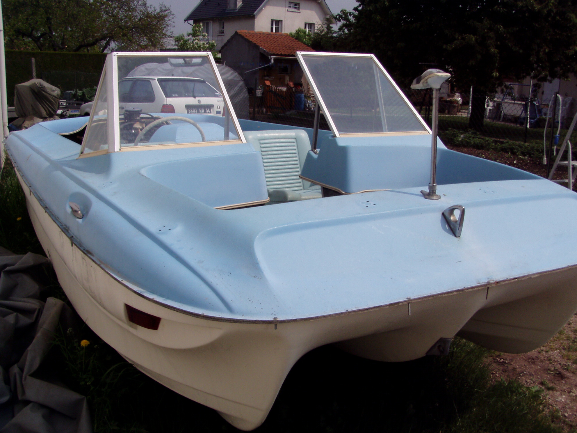

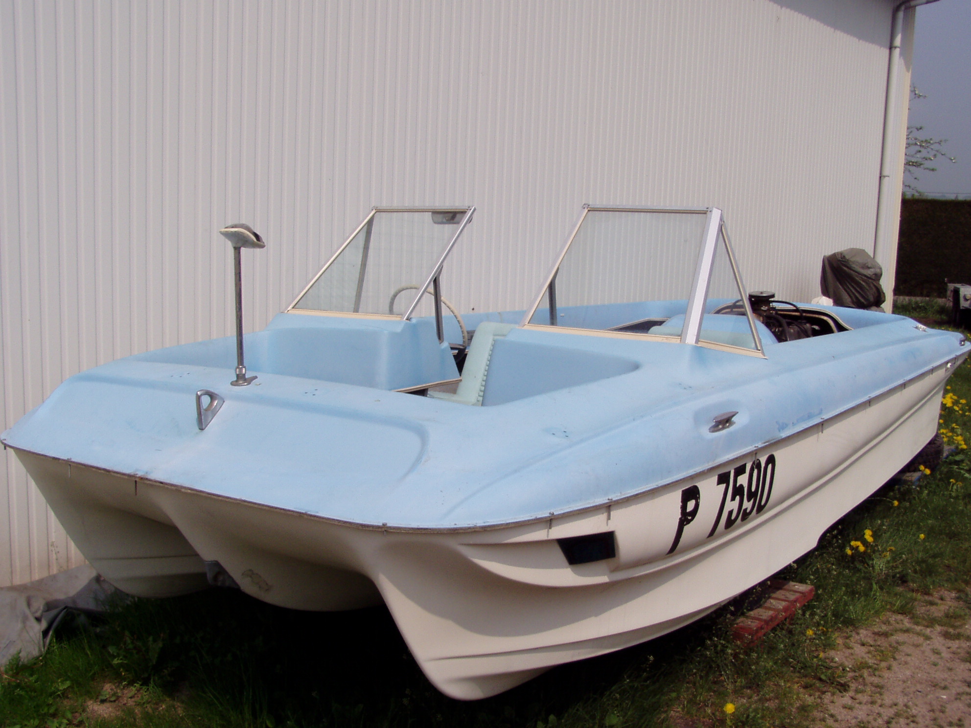

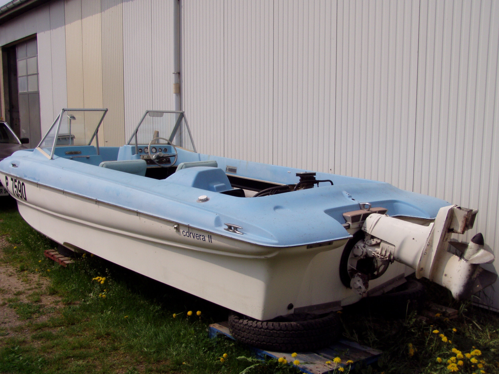

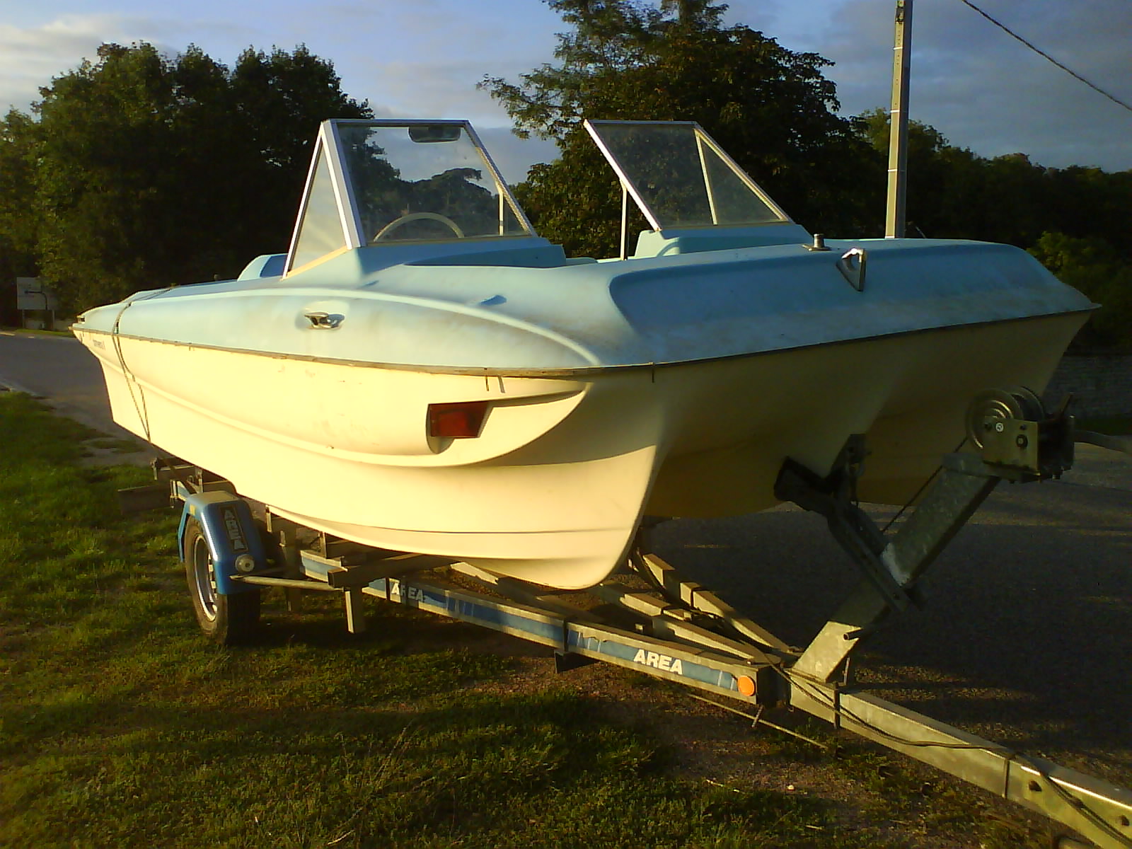

Hello, I’m starting to think about the organization of the deluxe restoration. For practical reasons concerning the engine I plan to switch the inboard engine to outboard . Has anyone ever done this on a deluxe? I am a data or photo taker. I would like to get closer to the original, like the one in the photo. Thank you.
