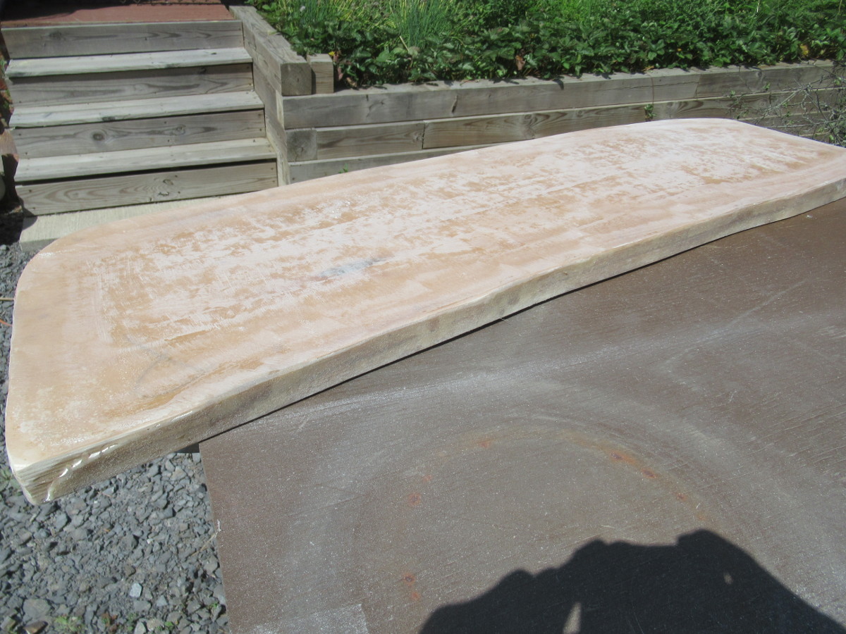

Test fitted the new transom yesterday, just to make sure! Looks like it will do fine, just needs a tad more attention (like all my fiberglass projects!). Sanded two inches back around both sides for future adhesion.
Sanded the stern of the boat down gradually from 2 inches out to paper thin in, or best I could do. That way I can lay successive layers of cloth from smaller to larger final layers to match original gel coat.
Need to clean inside (especially bottom) today where new transom will sit. Then hope to at least tack in Wednesday, if not completely install from the inside. That will not be fun. Finish of the outside is relatively easy and can wait.

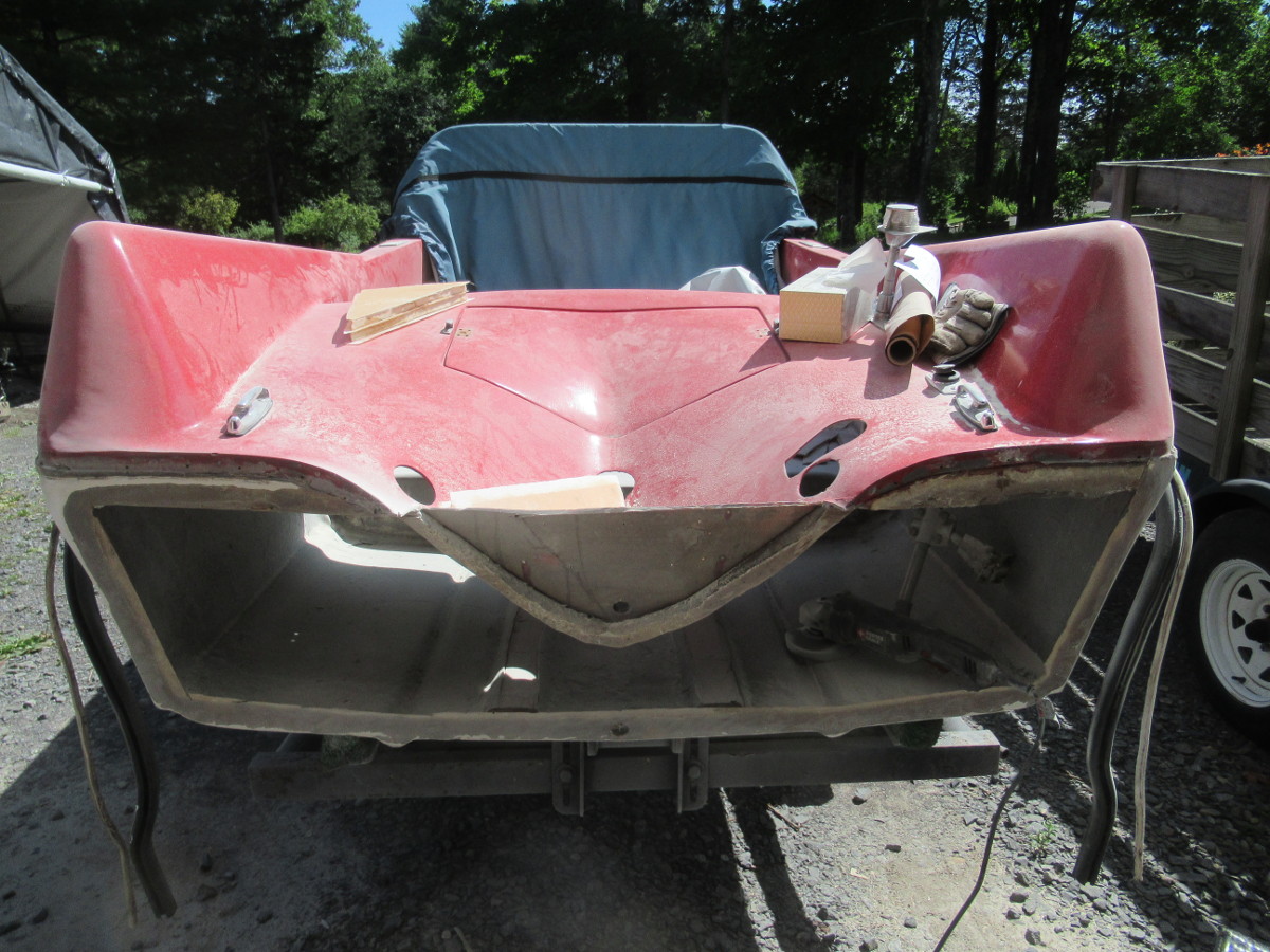

1959 Cutter Jet Deville 7 years 3 months ago #140214
Transom is in rough tonight. Needs to get wedged tight tomorrow and glassed in. Was kind of a job getting it in, but I was prepared to do whatever was necessary. Had to cut the stringers back and part of the engine well to get it in.
Spent a good part of the morning between grinding inside where fiberglass and resin would go (i.e., all over!), then a bit of final detail on the transom, basically a quality inspection to make sure everything was coated and there were no spots moisture could get in.

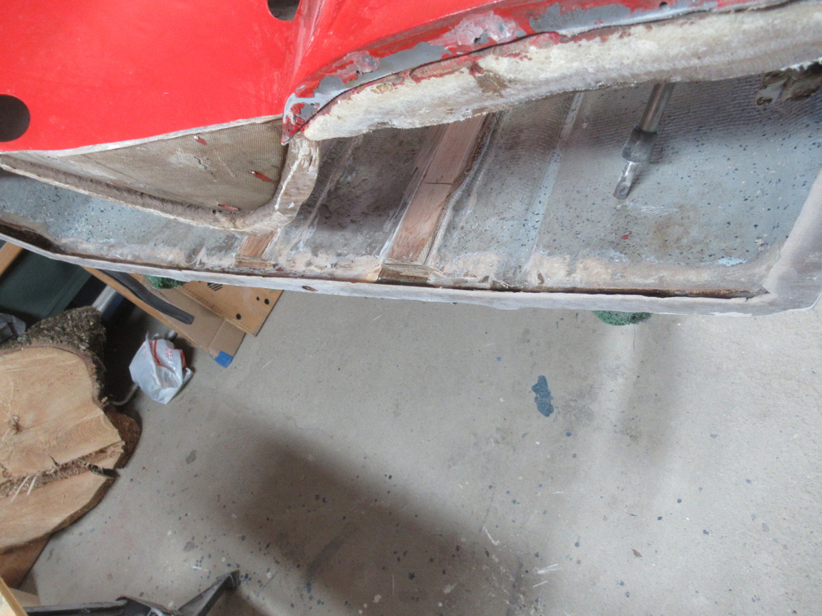

As a benefit of cutting just enough engine well out to get in my 1-1/2+ transom, I have found I do NOT have to crawl inside to do transom glassing! Wonder of wonders!
First pic is of the outside bottom glass. ( generally do not mix more resin than 8 ozs, and often do just 4. Second pic is one of the inside ends. Did both. Have first layer of everything, except inside bottom. That's next.

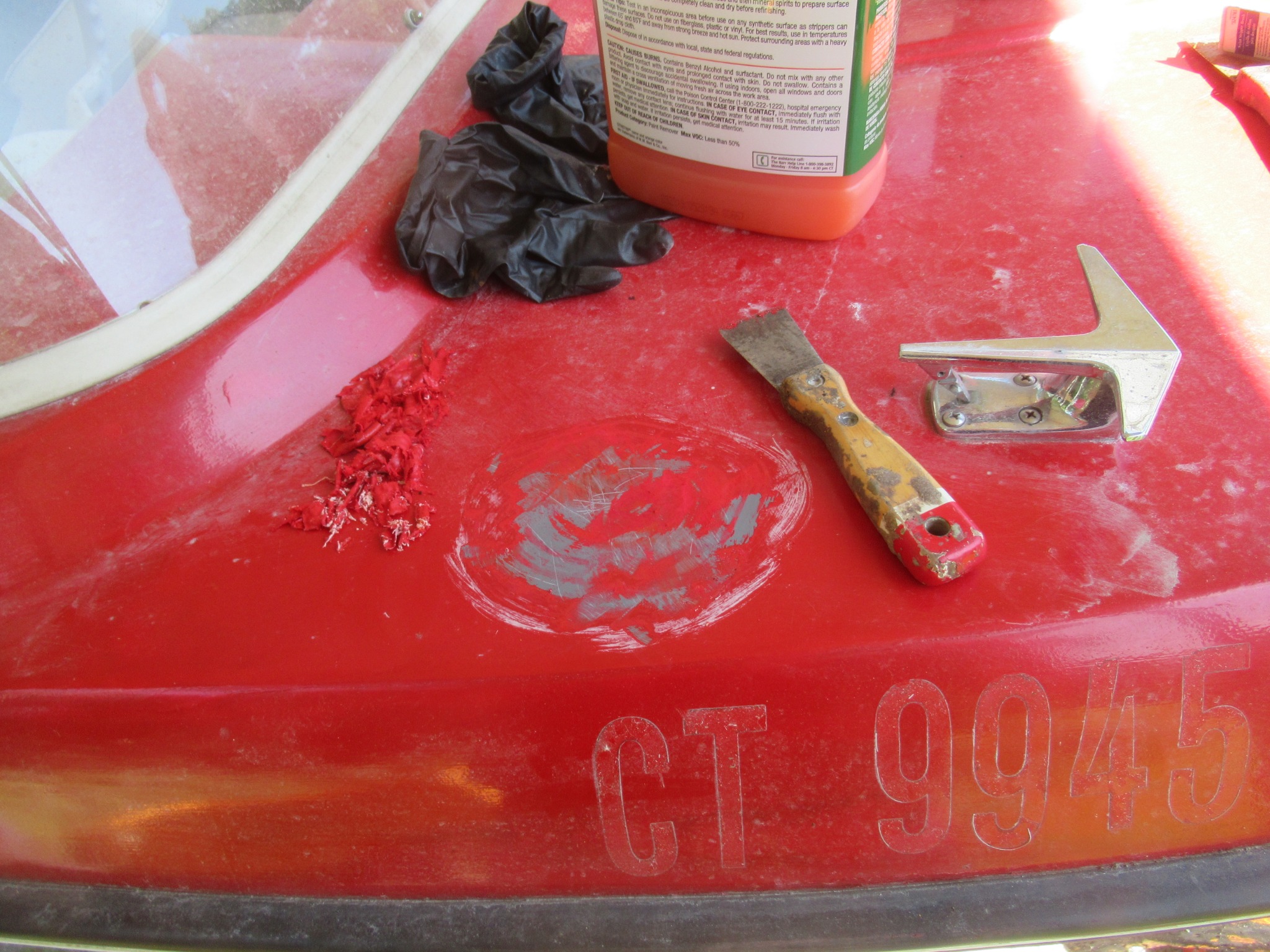

A small test of CittrusStrip on the starboard deck of the Jet Deville. I think I need to let the CittrusStrip sit a bit longer than 30 minutes. I can't imagine the gray is gel coat, but maybe? Stripper will probably run me 100 bucks and lots of labor.
1959 Cutter Jet Deville 7 years 2 months ago #140752
Looks like a white hull, light gray primer and red paint. Not knowing what kind of paint it is, it all has to come off. I will keep expanding the circle, but tomorrow when I get home from getting an oil change for the F150, I have to get under the foredeck and remove hardware. At some point soon, I also need to finish the transom so I can get a drain tube in. Otherwise I can't rinse CittrusStrip debris off.
1959 Cutter Jet Deville 7 years 2 months ago #140755
That brilliant white spot is a repair of some kind. It is slightly above the paint and primer around it.

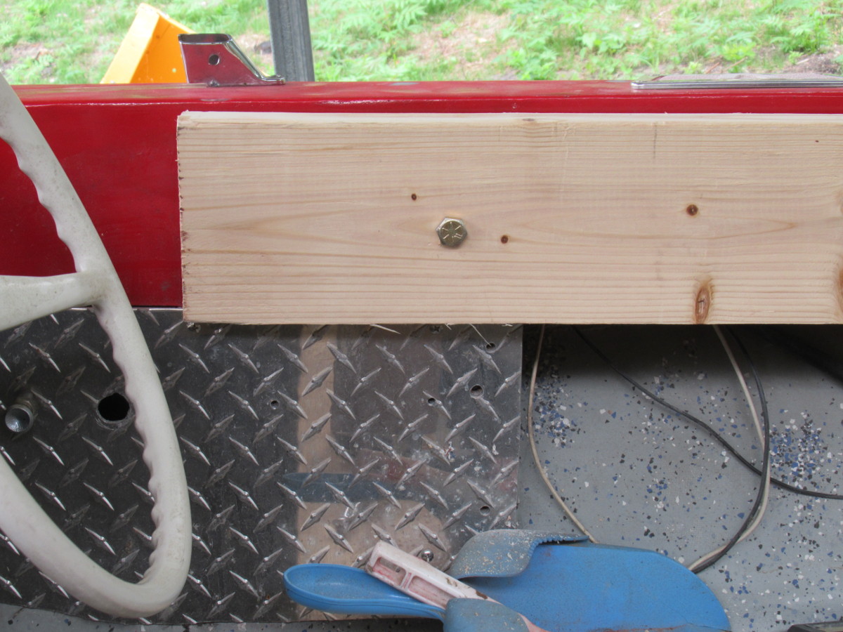

Got the sides in, but still having trouble removing the steering wheel. Regular automotive puller I have won't do it, so was trying a three jaw puller. Need one or two more hands to get that off.
What should I back these support 2x6's with? Big pieces of plywood? Or would just big washers on the 1/2 inch bolts I'm using be sufficient? Also on the sides, they are flat then curve in, so if I want middle bolts, I'll need shims. Also, I can lift the bow no problem. Can't lift the stern.
I'm planning on using deck screws for the upright 2X6's so they don't penetrate the fiberglass.
1959 Cutter Jet Deville 6 years 3 months ago #142816
Large fender washers would probably work but if you have some 1/2 ply and a washer then your sure to have back support and the washer will prevent the nut from pulling into the plywood. The side you can probably put a plywood spacer then drill through and back like I said. The deck screws on the upright should be ok. Do you have a cherry picker? I'm assuming you had one for pulling the engine on the hotrod. you can lift the stern with that. Or if you have some old tires, lay them next to the hull and have a few neighbors come and help flip it over onto the tires then over onto the supports. That's how I'm going to have to flip the Resorter when it's time.

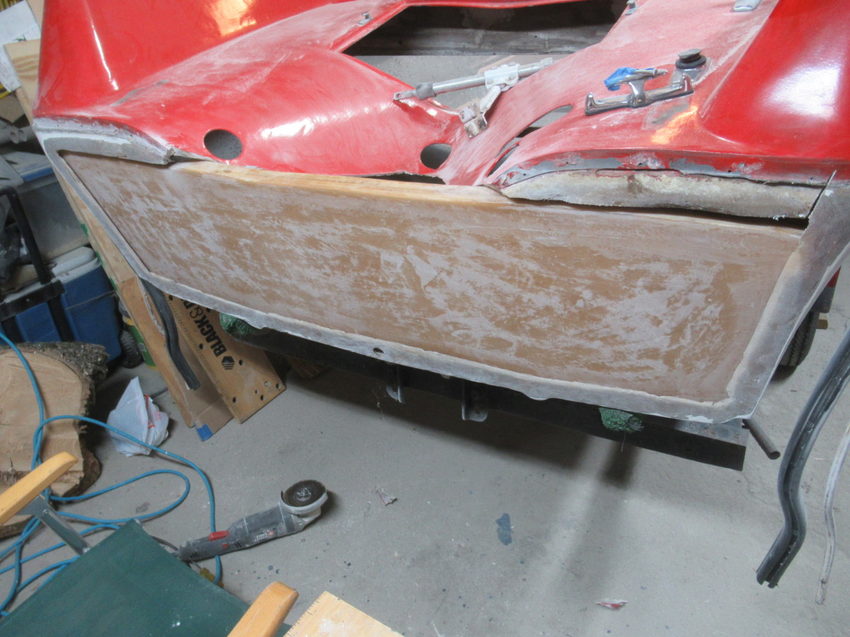

Flipped the boat this morning onto sawhorses I built for it. Right height so I can work on the already once-painted hull. Did some sanding on the transom that still needs work. Found a few holes I could not see before that will get filled today before I scrub the hull.
1959 Cutter Jet Deville 6 years 3 months ago #142841
Filled those holes with resin-saturated fiberglass insulation.

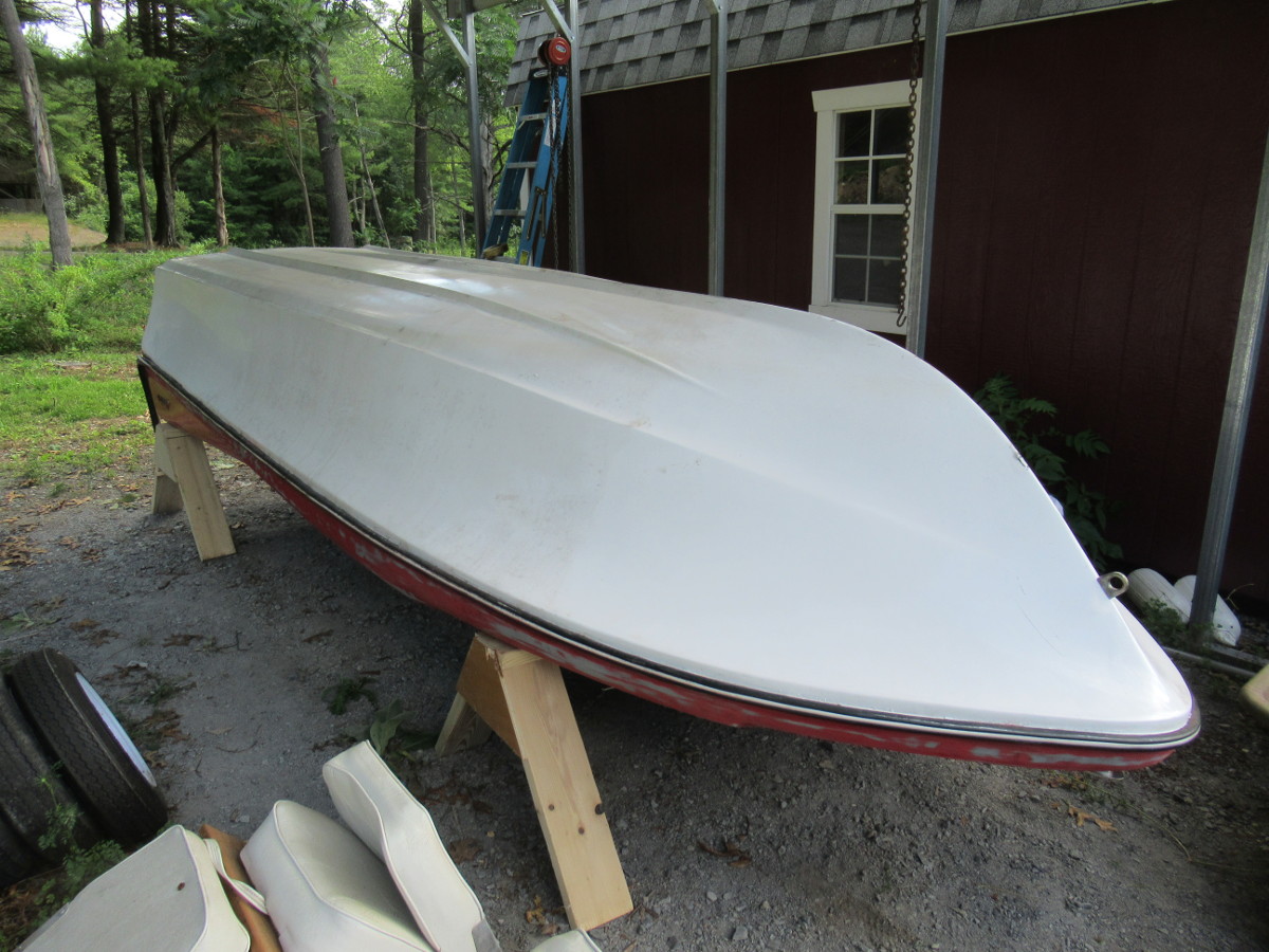

1959 Cutter Jet Deville 6 years 3 months ago #142878
Here's where I got to this morning. Very hot and very humid (96%) when I did this, so it hasn't kicked yet (the green stuff is fiberglass resin jelly, great for vertical surfaces). That's okay, a bit too hot for this old guy to do much more, at least right away. Next will be hand sanding, then a layer of cloth. I want it be be very smooth before the cloth. That may happen later today, we'll see. Once that's ready for paint (Interlux VC Performance), I'll start on prepping the hull.
Now off to interior house projects.
1959 Cutter Jet Deville 6 years 3 months ago #142879
Still not ready for cloth. Maybe tomorrow. Tough day today for any resin.

Another brutal day. Fiberglass resin jelly I did yesterday I mixed hot, and still can't sand today without loading up my paper. Maybe later today or tomorrow morning.

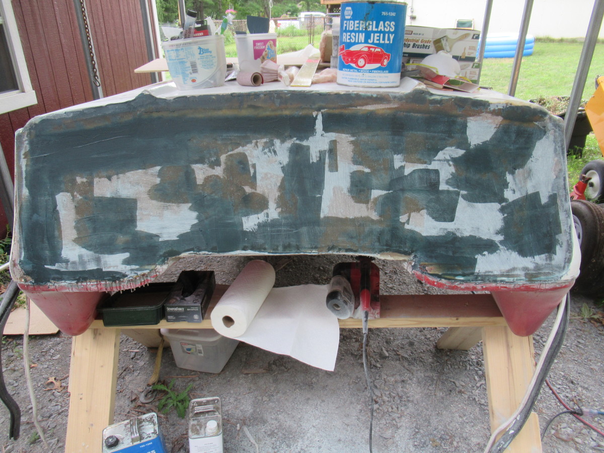

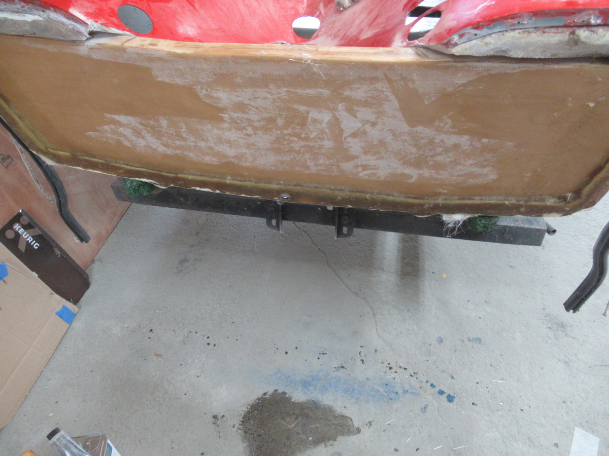

Finally a dry day! Tomorrow will be muggy, so trying to get this transom done today. Been a long journey!
1959 Cutter Jet Deville 6 years 3 months ago #142900
Might be done once this is sanded. Two vertical low spots on the right in the pic keep getting low after sanding. Plus a bit of detail on a rib. Still might be done today.

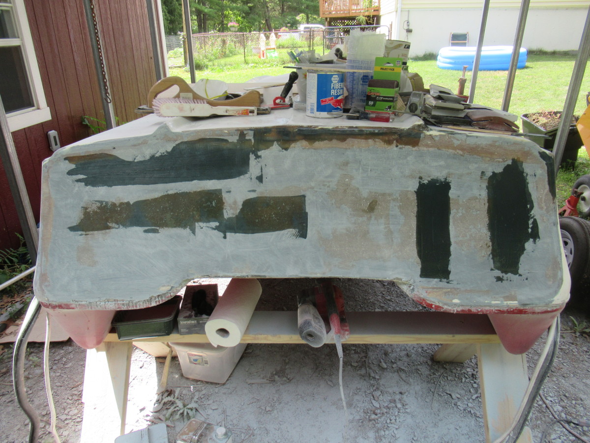

1959 Cutter Jet Deville 6 years 3 months ago #142907
Think I figured it out. Wide stiff spreader should level that big area out. We'll see later today. Have errands to run.
1959 Cutter Jet Deville 6 years 3 months ago #142908
Yup, worked great. A bit more with the wide spreader and I should be ready to start sanding the hull and see what I have. Pics later...

1959 Cutter Jet Deville 6 years 2 months ago #143017
Think I got the transom flat (finally!). Few pin holes, but will start working on the hull. Sure wish I had an air conditioned shop!
About got the transom flat, but way too hot to sand.
