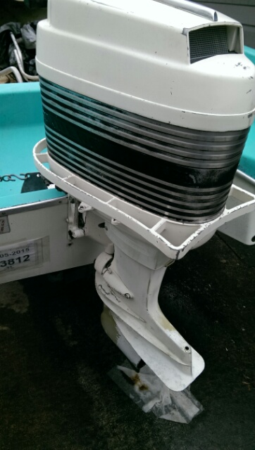

Mercury 450 45 hp motor

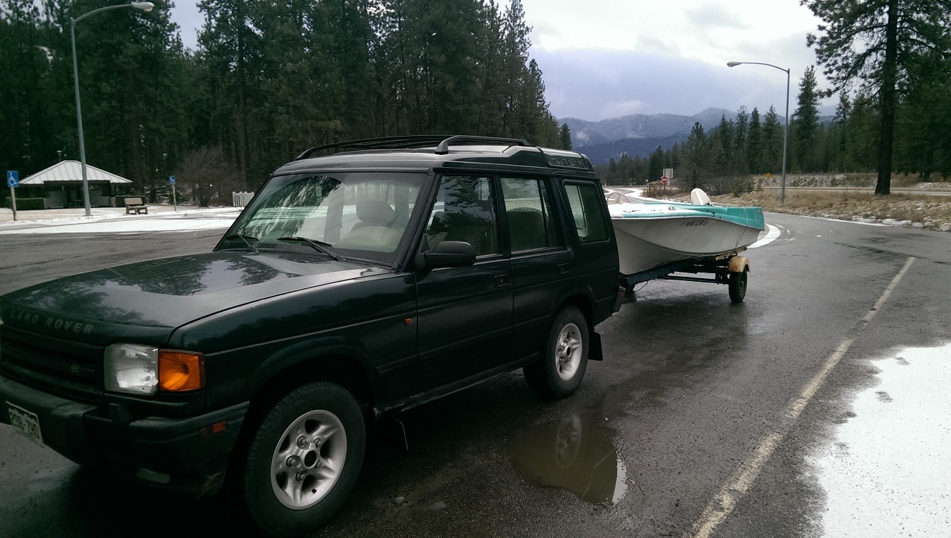

On the way back to Washington, trailer is in good shape too, pretty good buy for $300 bucks for boat, tailer and motor. and new tires on the trailer.

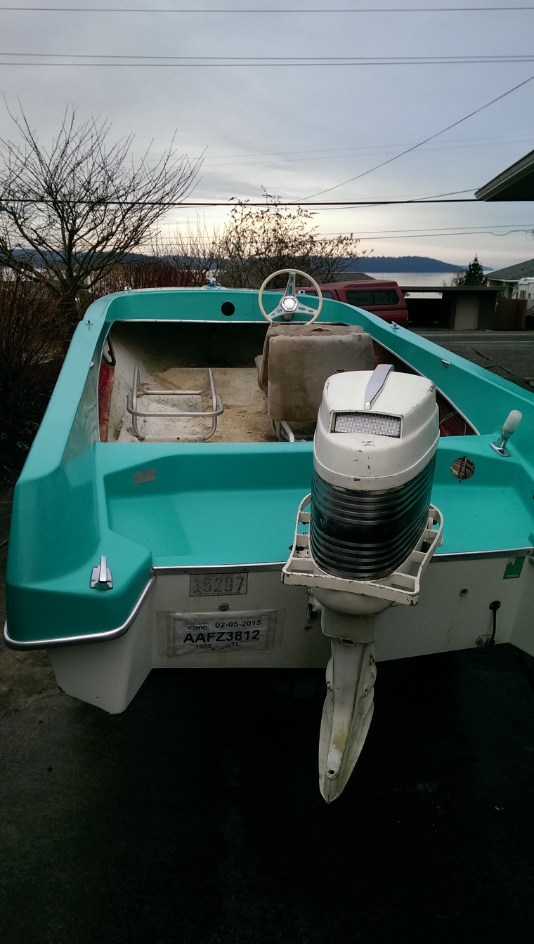

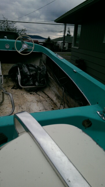

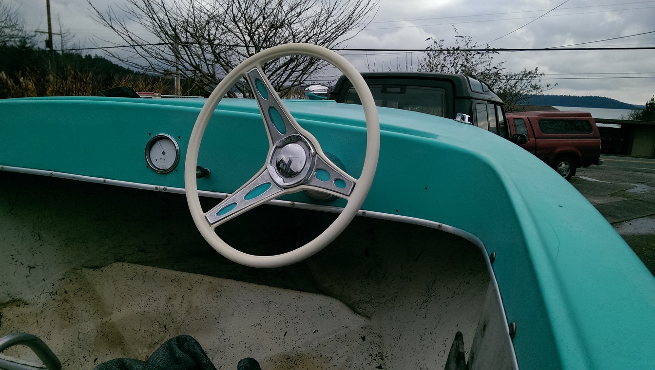

Yes just needs some seats and cables and dress up that dash.

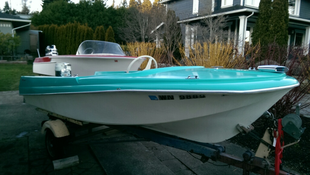

Ok 3 quarters done, just 400, 1150, polish then wax, it looks amazing for almost 50 hope to have it in the water in a month, just need seats and finish the motor

Turquoise and chrome

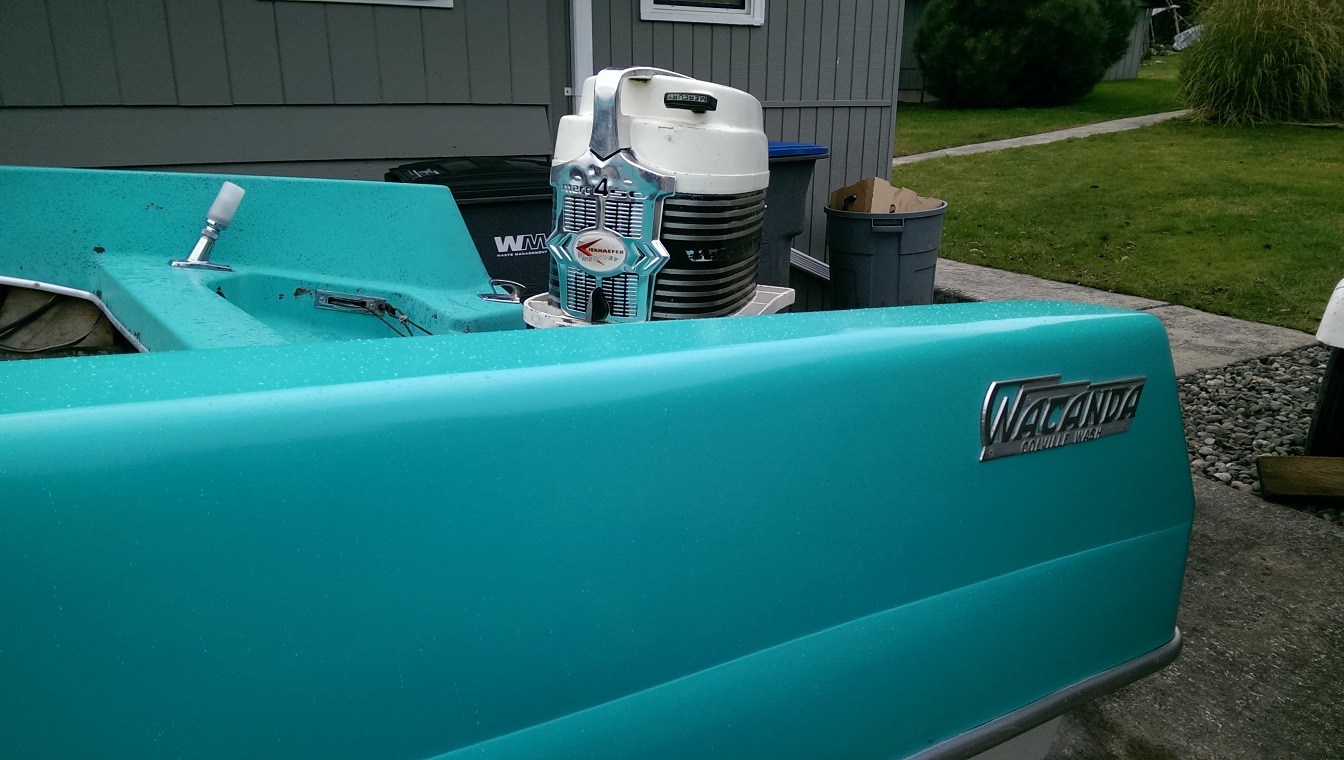

Well finally finished the color sand and polish of the top part of the boat, came out better than I ever could have imagined, only real stains are under the outboard where the water can't really drain all the way out, even the light mast looks new.

That is awesome looking. Amazing how new the finish looks.

It's funny how that color change lucky you can work on your boat my gelcoat still not hard enough to sand.I just hope mine will be done in June after that I still have my Glastron surf lite to finish.
Re:My New 1967 Wacanda in Turquoise w/Merc 450 11 years 5 months ago #103983
She looks GREAT!!!!!!!!!!! Isn't it great how that wet sanding and buffing can bring back that original shine?! Some good carnauba wax once in a while and she'll stay like that. Greta job.

Oh yes, Us PNW folks have it cold and damp here. I don't know if my Pacific Mariner red will come out any better, gelcoat is thin in places, may have to paint it.

Thanks Bob, yes just some cold work but, I read on the forum to work backward, I would do 1500 paper/polish compound/wax, if it didn't work, would go 400/1500/polish/wax, still bad 220/400 etc. Only a couple places needed 220, most was starting at 400. I would squirt with soap/water bottle, sand 400 till it felt loaded up, wipe with terry cloth, repeat, then go to the 1500 twice. Just putting this for others, sanding when the paper is loaded up wont work, and the 1500 I would swirl, if you look at it dry it should be smooth and almost shiny, if scratches so another round, have to get the 400 paper scratches out. now I crank it pretty fast, just a panel at a time.

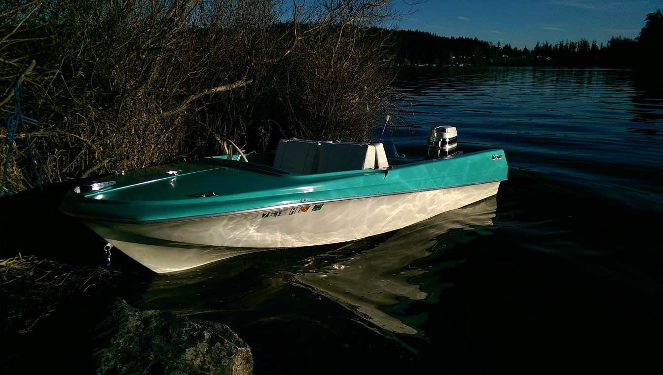

Got in the water for the third time, installed my nos 1964 back to back seats, had a great time and the motor is running great. Time to add electronics, lighting and instruments.

Great, she looks like a new boat, ya did GOOD!!!

Thanks Madbohunk, she passes the 10 foot rule, I plan on using it a lot so no garage queen for me. This lake was fantastic yesterday, 60 degree record for Feb and the lake as you can see was glass and only 1 fisherman in the shallow water so stayed out of his way. My gopro didn't work for some reason, have to try again today.
Re:My New 1967 Wacanda in Turquoise w/Merc 450 11 years 4 months ago #105964
Wow, what I wouldn't give for 60 degree weather !!! Enjoy while you can. Also that pic looks like calendar material for 2016 !!! madbohunk safe boating

Thanks, yes hard to believe we are breaking records here in the Pacific Northwest, thanks for the compliments, now I need to add some vintage ski stuff to the picture next time.

Outstanding and yep looks like calendar material to me.
