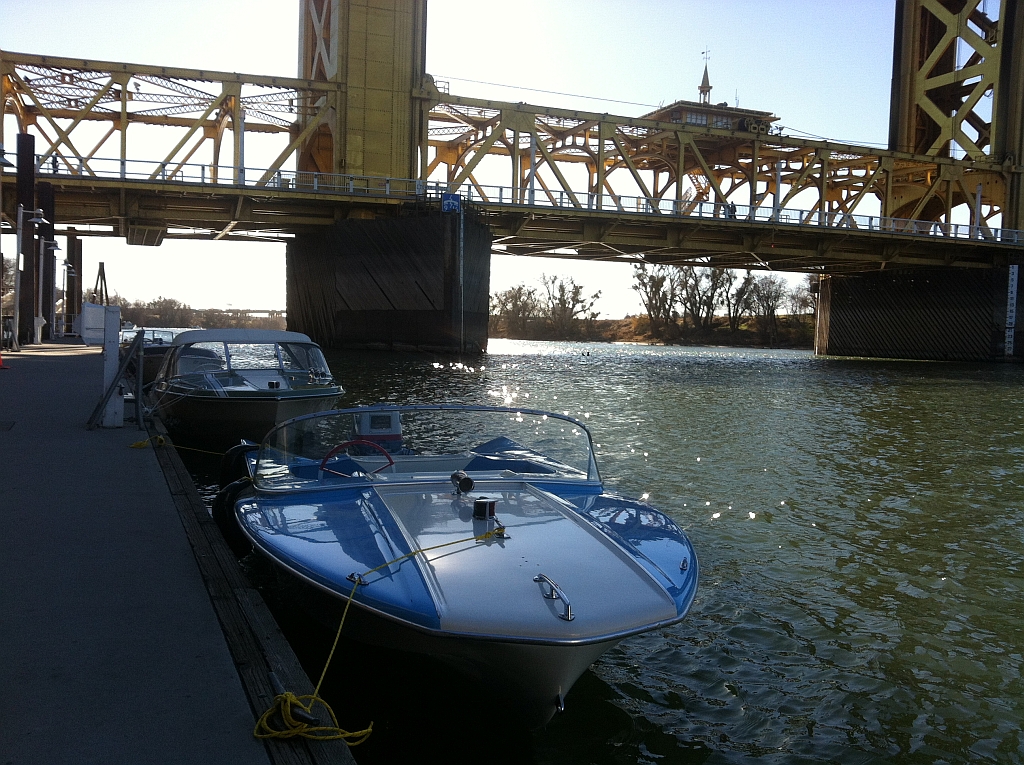

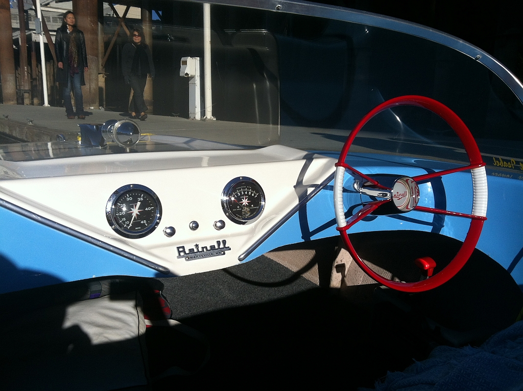

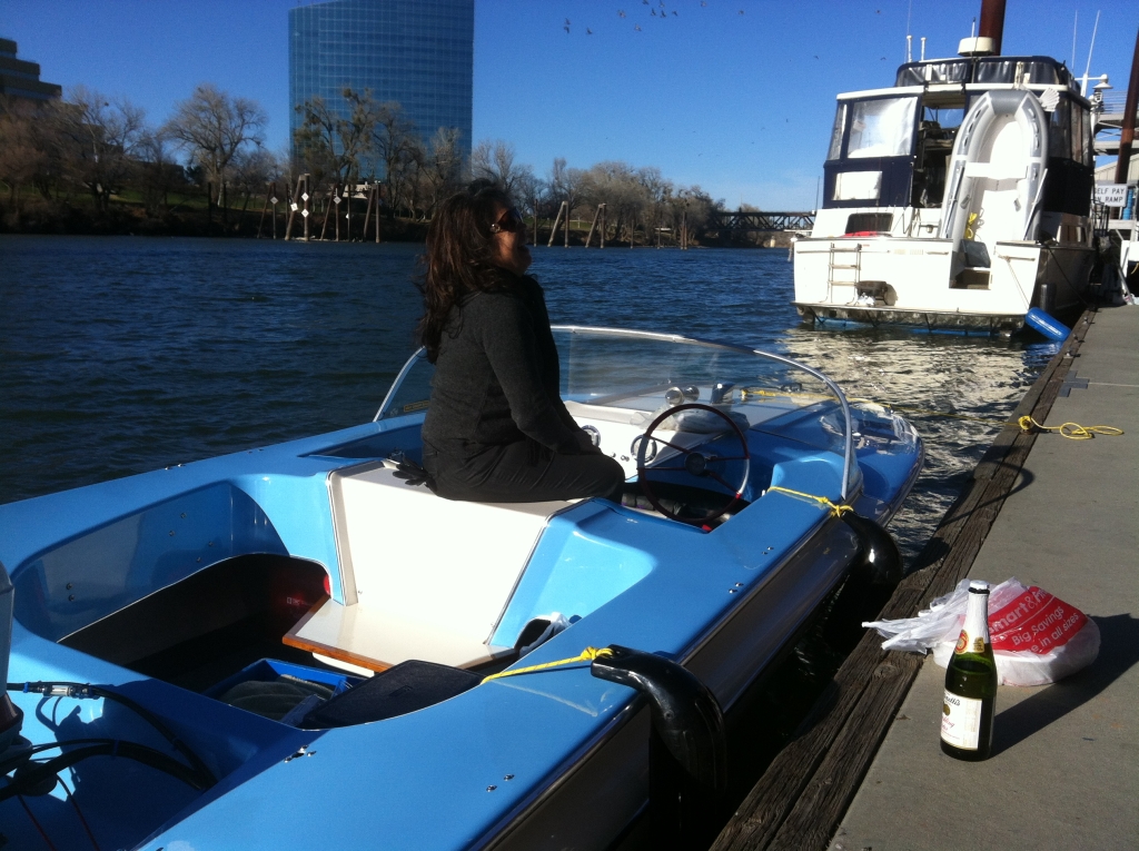

So not only did we have a successful shakedown, I had also planned to do a christening ceremony to celebrate our new old boat. I’ve never done one before so I thought let’s christen the Reinell, and that’s what we did. After almost 10 miles of testing the Jet Flight, we all cruised to Old Sacramento where we tied up our glassics. We celebrated the christening with sparkling cider, snacks and some homemade cookies. Three toasts and the christening of “Sweet Isabel” was complete. The name Sweet Isabel is from our very first grandchild, just born on the 28th of December, 2013.
Christening Sweet Isabel @ Old Sacramento
That's my wife Mercedes, my #1 supporter for my passion of glassic boats.
One more...

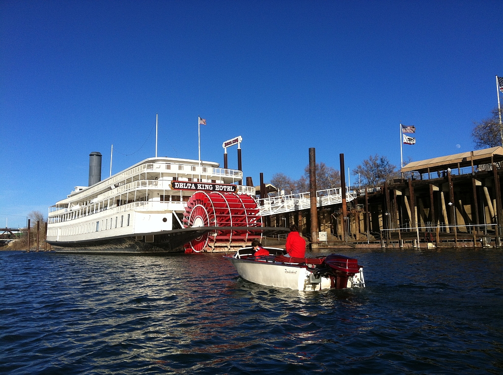

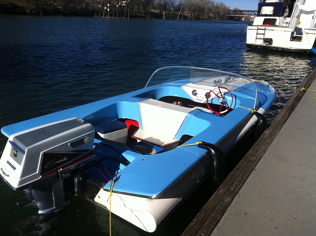

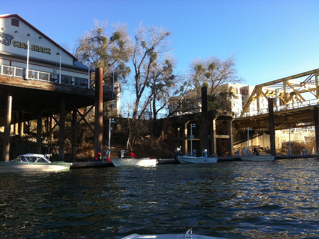

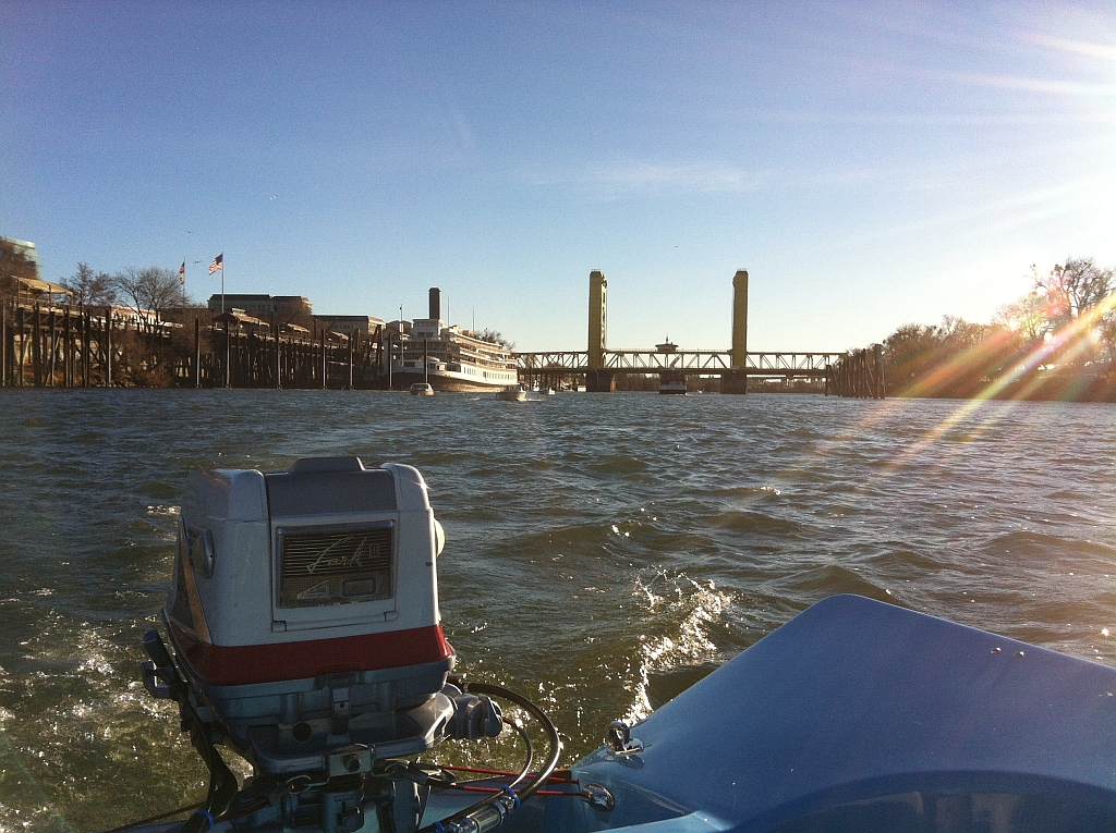

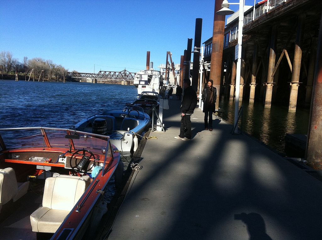

...since she's seen any water, over 25 years. I'm glad this winged glassic will now cruise our waters and will be truly enjoyed by her family and friends. So cheers to all who were involved, to all that were present to share this day with Mercedes and me.
Leaving Old Sacramento

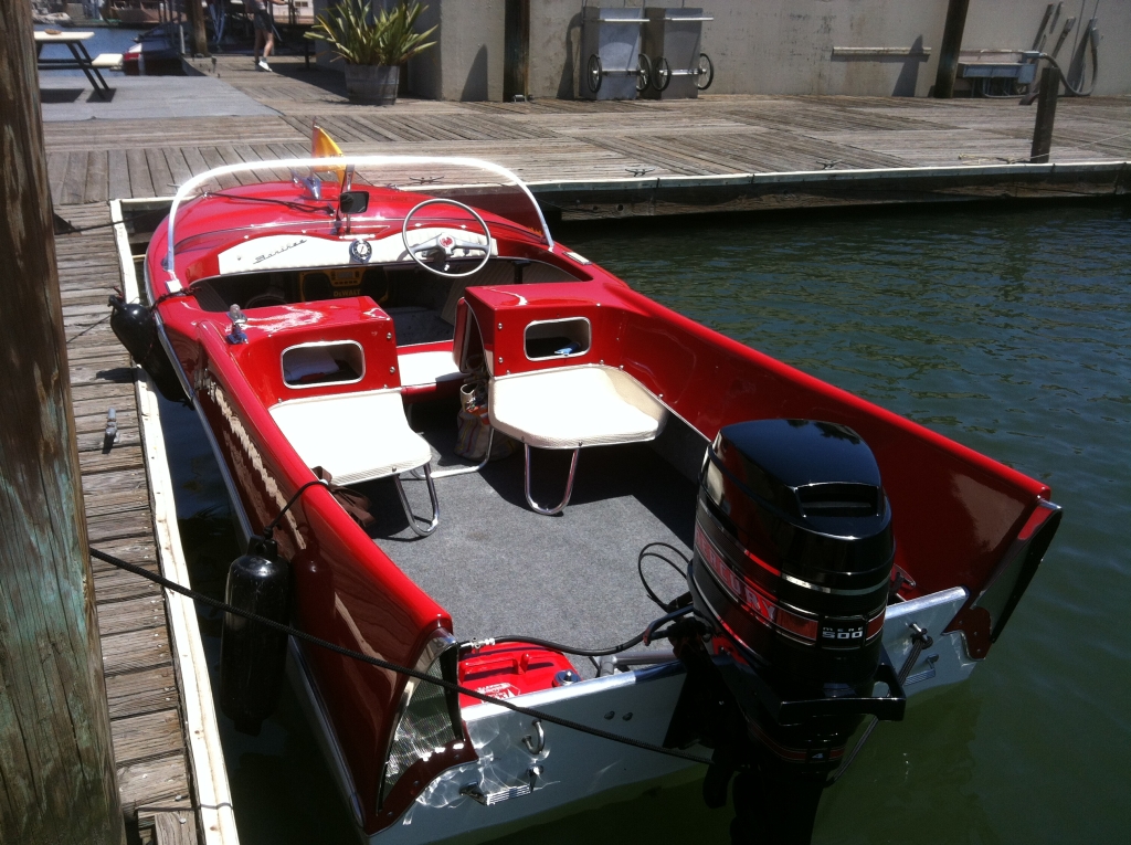

This is my good friend Glenn and Lan in their '62 Trailorboat Savoy. This is the boat that got me into these glassics. He's been there for me during all my shakedowns. Thanks Glenn.
Thanks for reading and a Happy New Year to the Fiberglassic community.

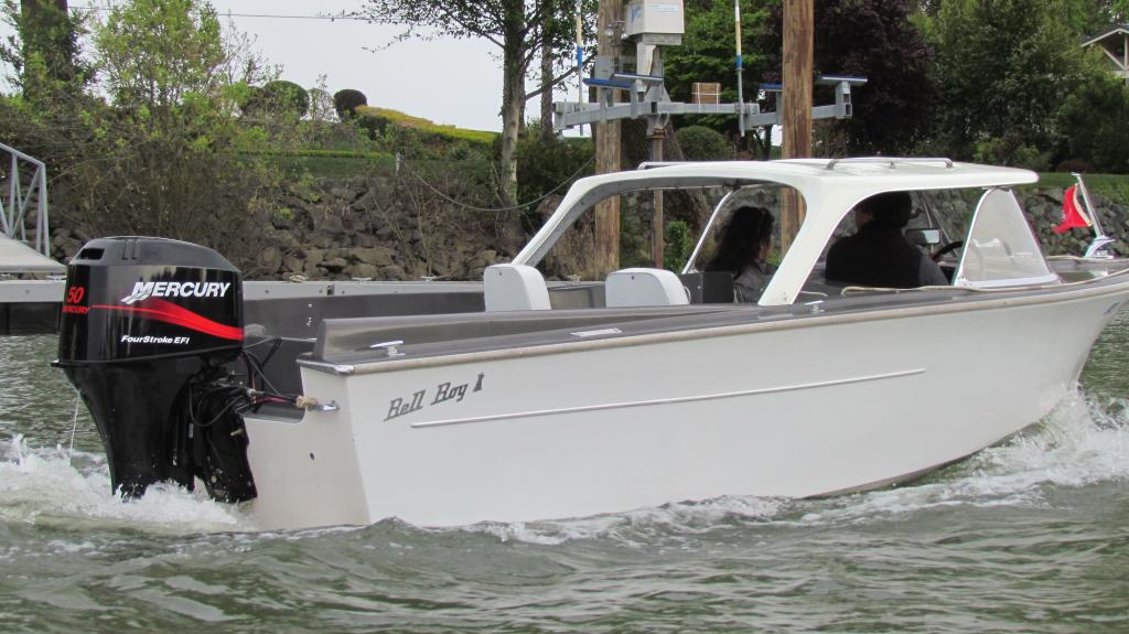

Thanks Doc. I appreciate that coming from you. I gave my '58 Dorsett El Dorado to my nephew and his fiance then. They enjoyed her in the beginning then he was busy with the wedding and hence, didn't look after her. So I encouraged him to let her go. So now she is in the good hands of a friend of mine in Bakersfield, CA. I sold the '64 Sea Ray in '06. I still have the '58 Bell Boy Banshee and '59 Bell Boy 265 Hardtop. You'd like the Banshee because she is powered by a Merc. Matter of fact, both Bell Boy boats are, the latter is a modern 4 stoke Mercury. I'm thinking of selling the Banshee now that the Jet Flight is done. It's hard to let her go though; she's a beautiful finned glassic.
Eduardo
Can you tell, I'm a fan of the Northwest glassics.

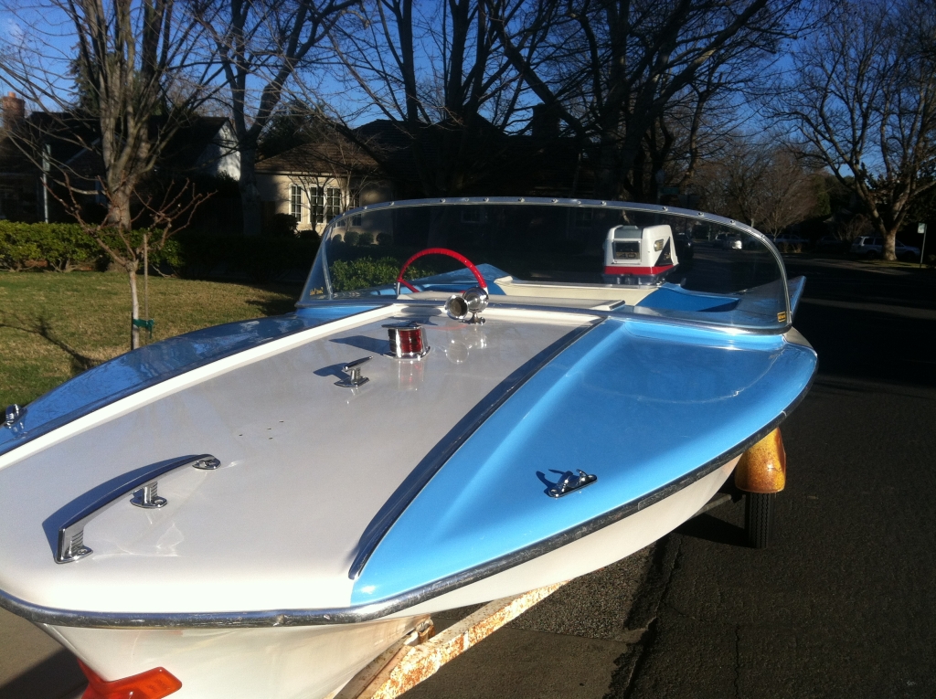

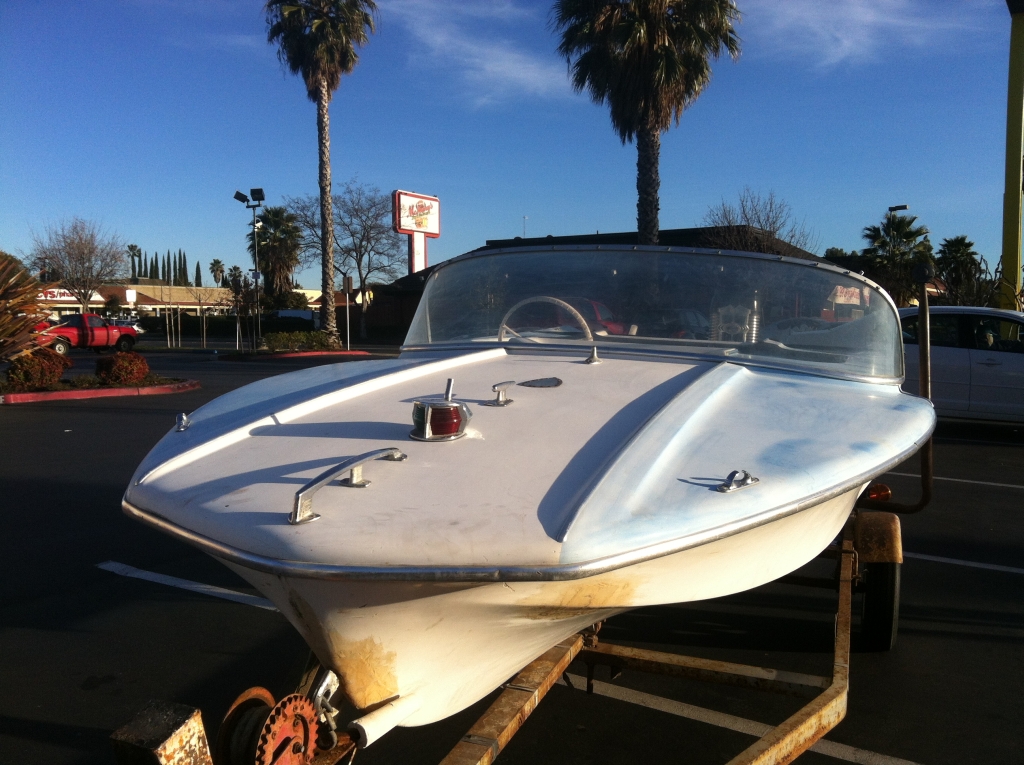

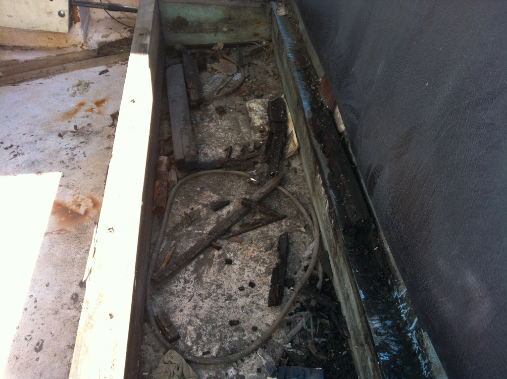

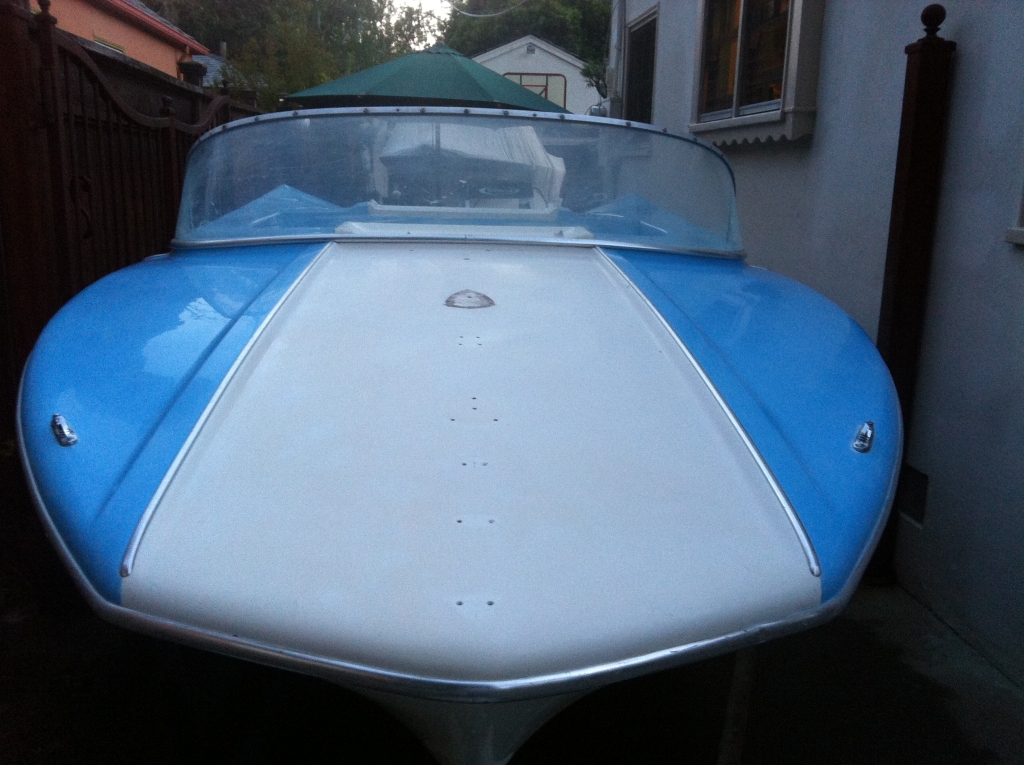

...images.
Sanding process next...

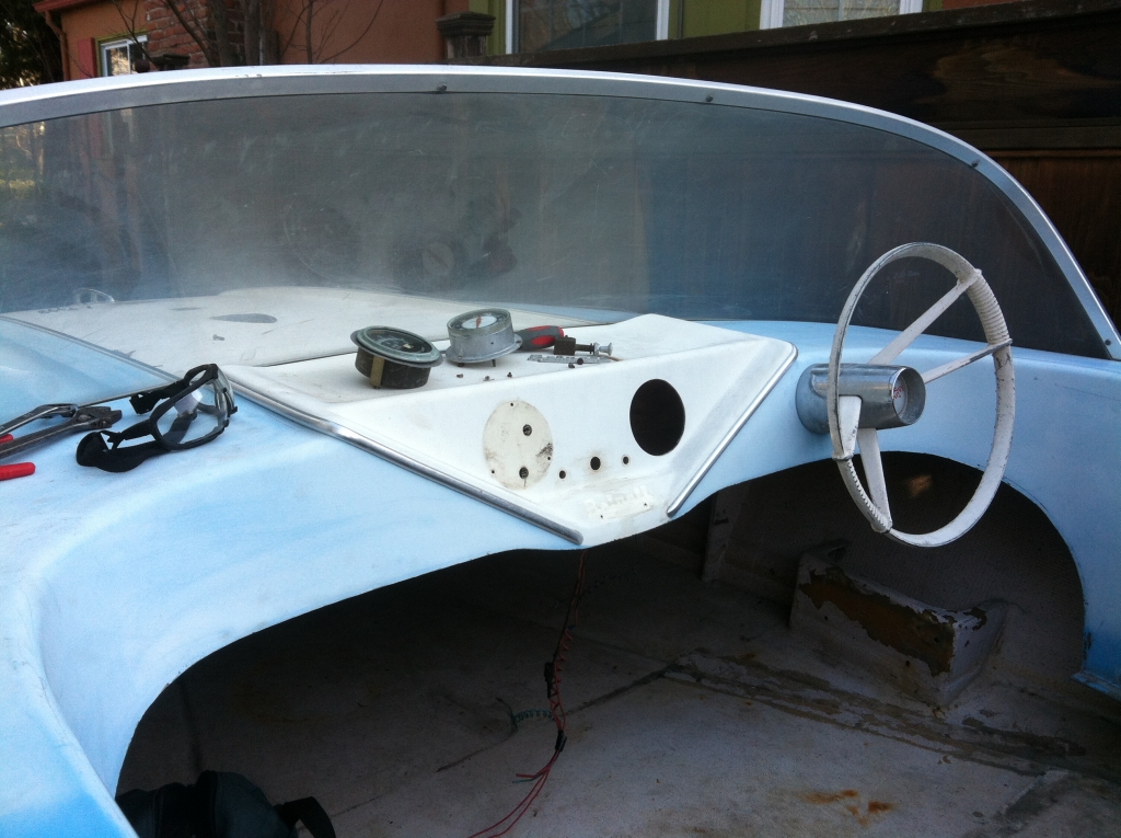

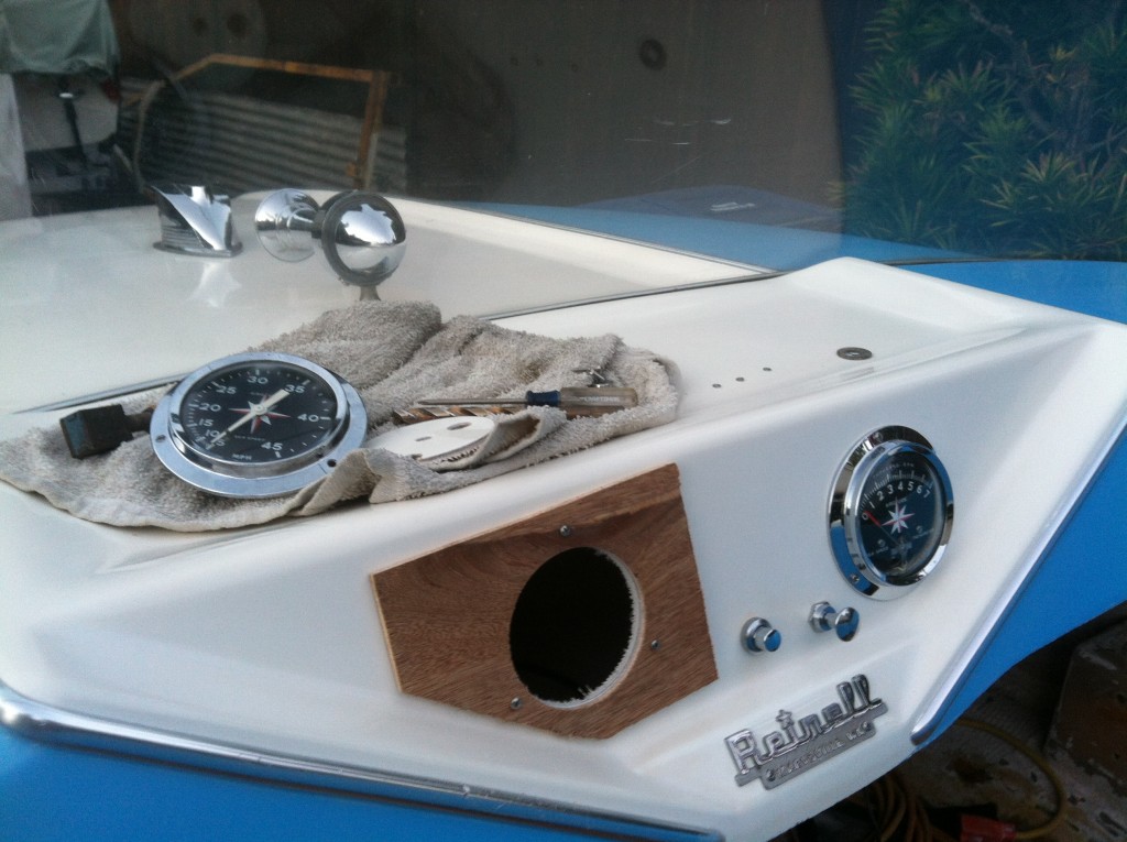

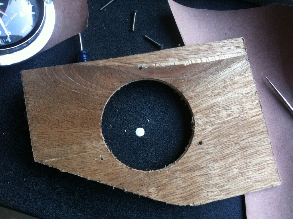

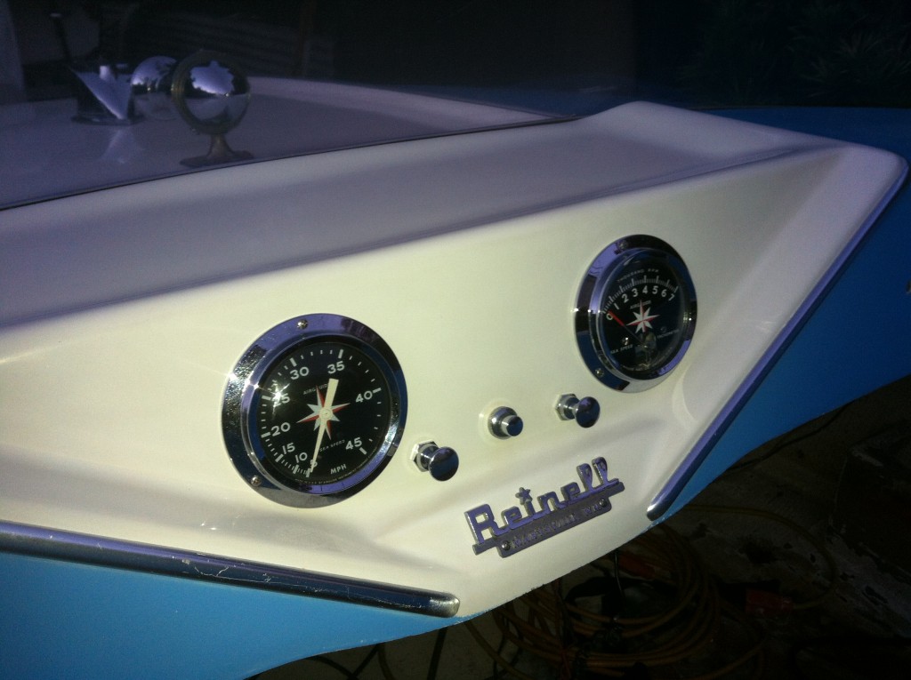

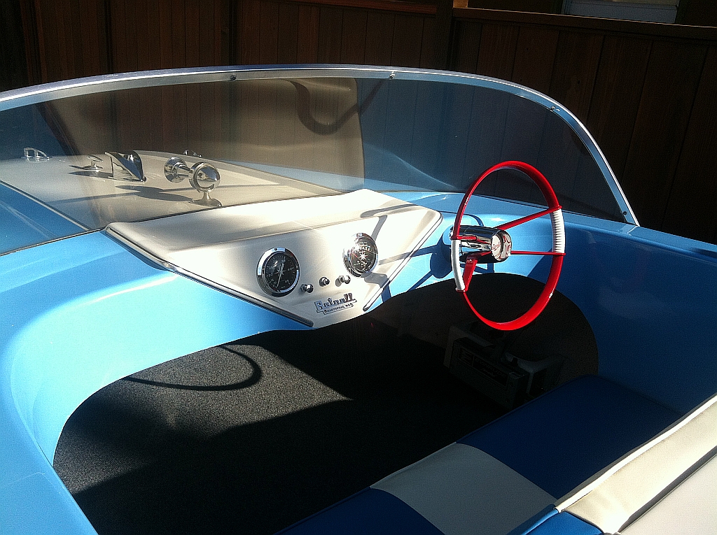

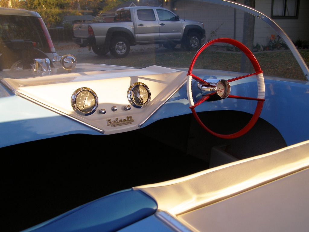

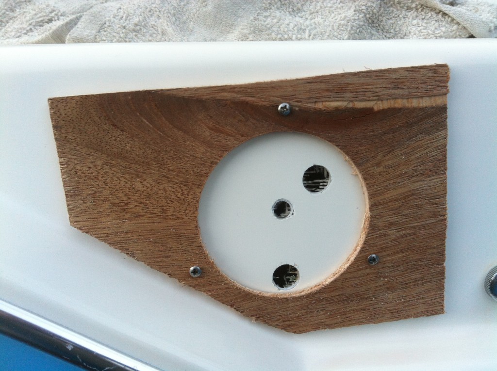

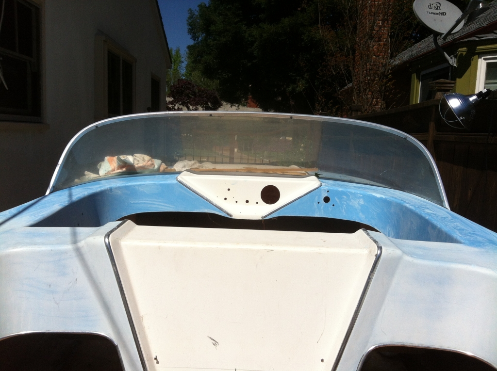

I noticed you cut a hole in your dash for a flush mount speedo. I know from experience that can be a little intimidating lol.

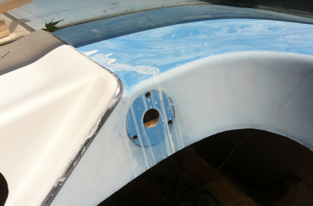

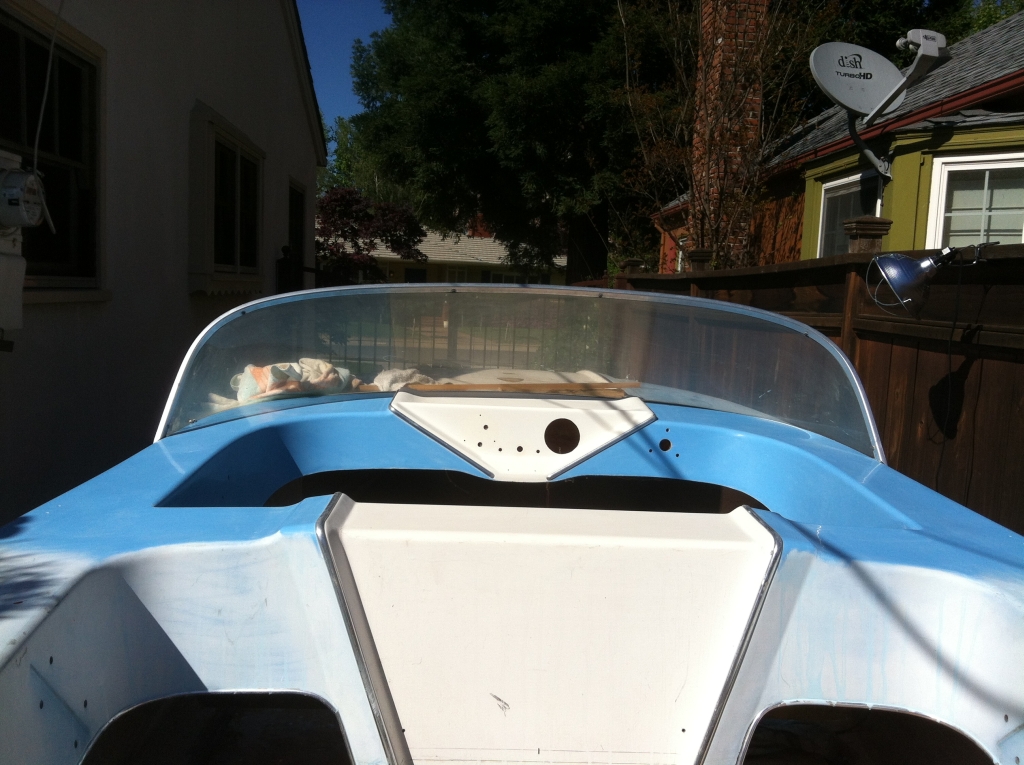

2nd Airguide gauge in... 12 years 4 months ago #88819
  • Eduardo
  • Eduardo's Avatar Topic Author
  • Posts: 309
  • Karma: 35
  • Thank you received: 5

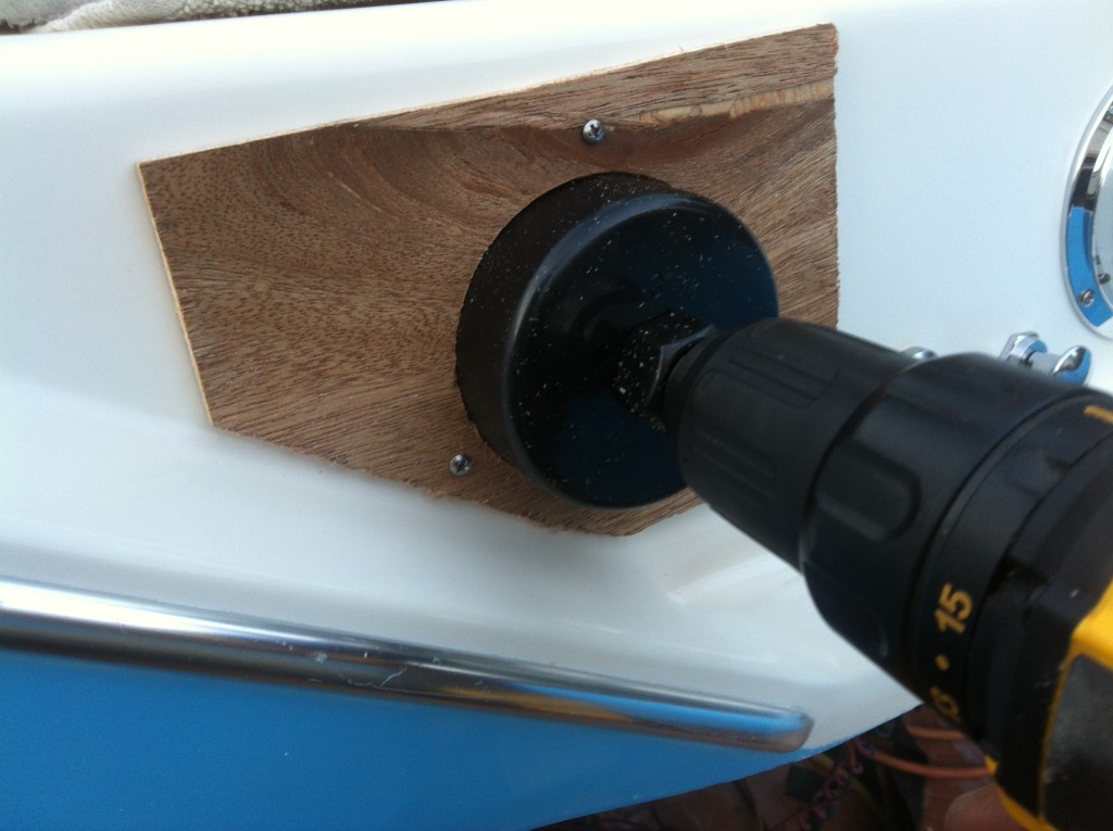

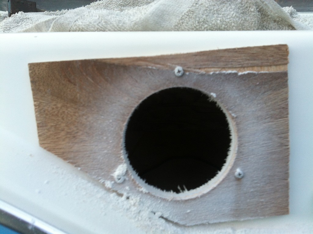

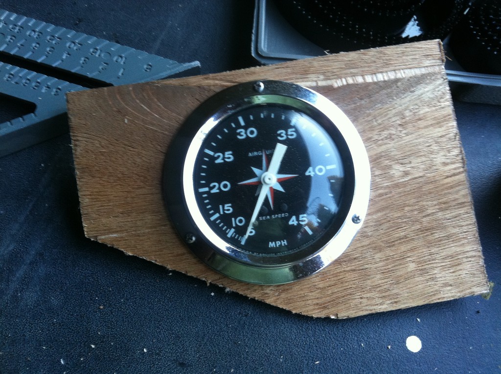

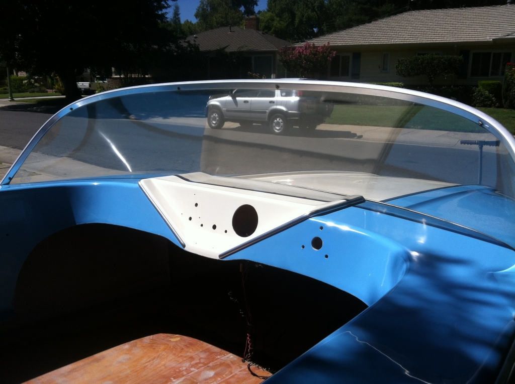

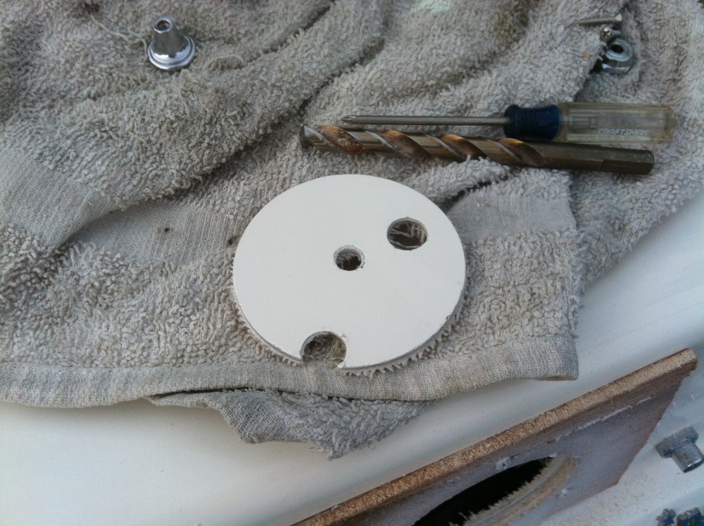

Jim don't get me wrong, I was thinking to myself, "Don't screw up Eduardo." I surely didn't want to make a mistake on this one. The right hole had a Stewart Warner gauge flush mount. The left gauge was a surface mount. The right hole is actually bigger than the outside diameter of the three screw holes on the Airguide tach that I intended to use. So I made a large size stainless steal plate cut like a big flat washer to fit over the back of the Airguide gauge and yet wide enough to overlap the size of the open hole. I drilled the three holes on the SS plate for the tach, and that’s how I secured the gauge on the right side of the dash. Now for the left gauge, I had drilled a hole in the middle to accept a surface mount Airguide gauge. My sister was visiting and I wanted to show her how the gauges would look when done. Not knowing that I needed the center to drill out a 3” hole for a flush mount gauge. When I was ready to drill out the hole, it dawned on me what I had done. I think it was meant to be. I thought about it a while. I made a template instead. The three holes for the screws on the bezel were already drilled in the dash, so I had to make sure that the 3" hole on the dash would work with the existing holes for the screws. The template served two purposes. One to help drill the 3" hole exactly where I wanted, and secondly the template helped to prevent the hole saw from getting away from me. It worked great. Take a look.
Airguide template
Template secured to the original three holes in the dash...
Hole drill out
Eduardo

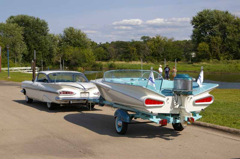

Nice Job,, I have had these side by side with a G-3 and the bottoms are very similar not 100 percent but close,,,I have ran 6cyl mercs and 4 cyl mercs and lovr running this boat,,Glad you got it done you will enjoy it Bill
Re:Shakedown of our Reinell Jet Flight... 12 years 4 months ago #88862
Now that's a hell of a combo Bill !!!!!!!!!!!!!!!!

Hello Bill and thanks. Yours is the first restored Jet Flight that I have seen and along with Motorhead's Jet Flight, the two winged glassics and many of your pictures were two of my reasons for getting mine done. When they see her back end, they mention that I should paint the molded tail lights. Then I'll show them pictures of your Jet Flight, and that's exactly what they are talking about. My friend first saw Isabel on the water yesterday; he's a car guy and that's what he said. This winged glassic rides beautifully and we will definitely enjoy her; you'll see us on the water a lot with Isabel.
Bob, yes indeed. One of the better combos I think.

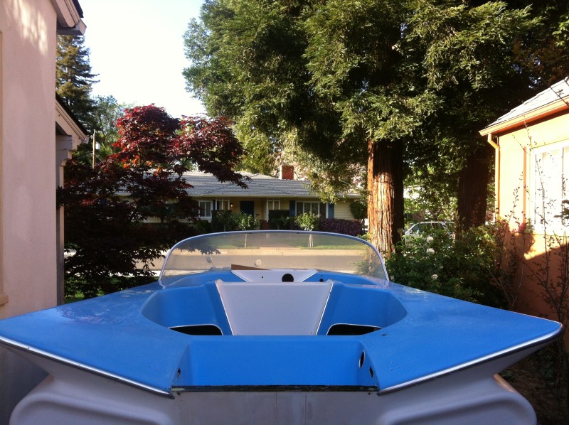

Bringing her color back (sanding)... 12 years 4 months ago #88892
  • Eduardo
  • Posts: 309
  • Karma: 35

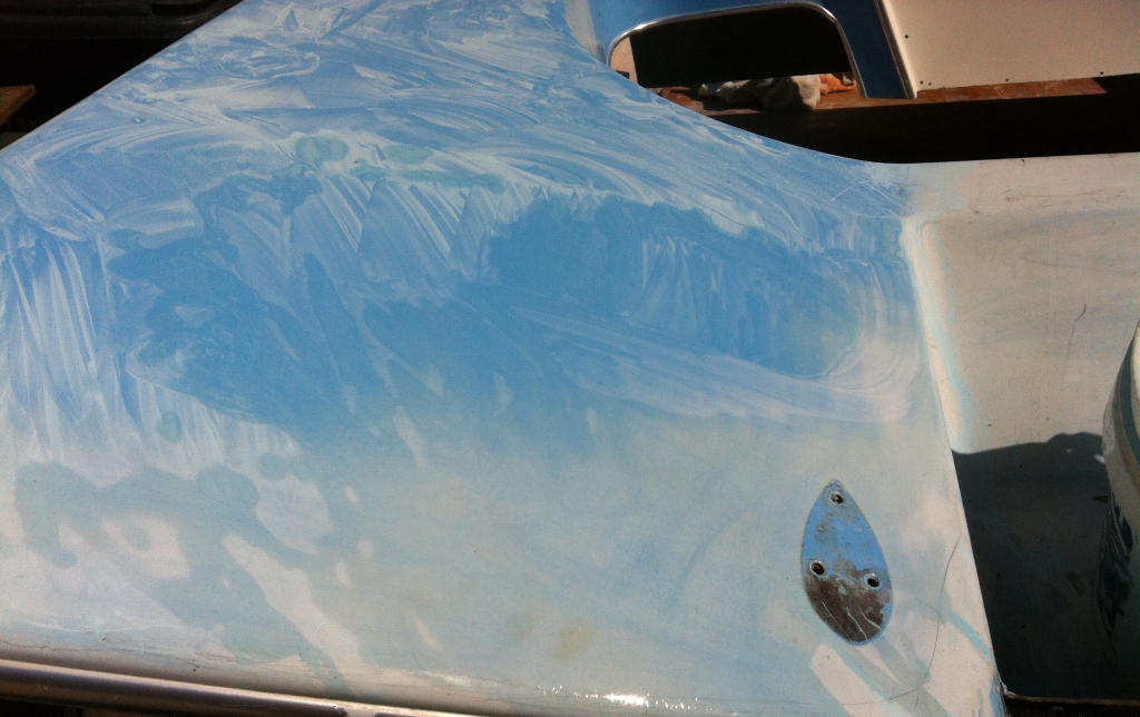

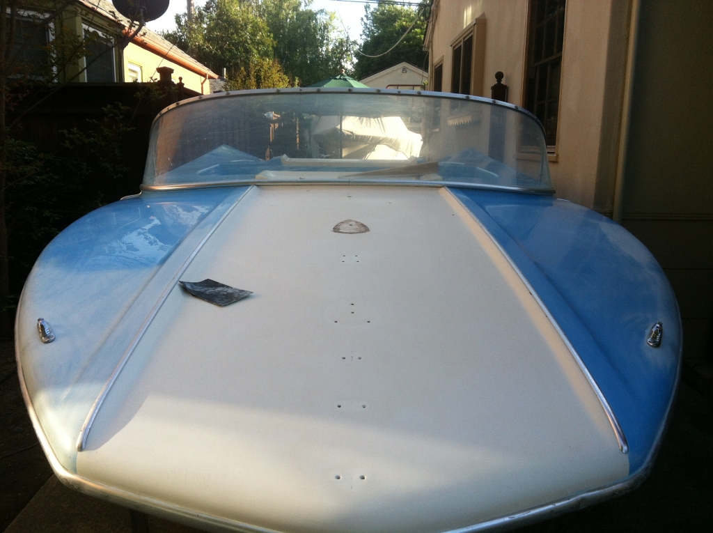

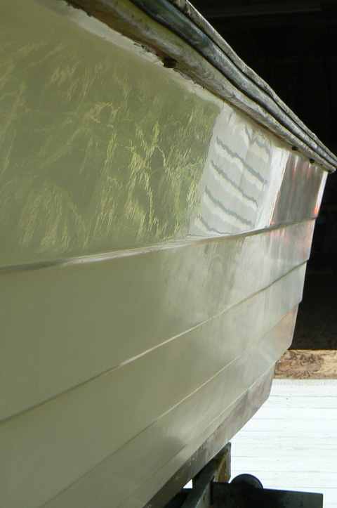

…was a challenge. She was heavily oxidized. First I started with 800 but that didn’t seem to work that well, so I went down to 600 wet sand paper, one pass, a couple passes with 800, then 1000, and worked my way to 1500. I was fortunate to have a decent thickness of the original gelcoat, because of the condition, I really had to be aggressive to get her original color back. It’s hard to say how many hours I put in her with just sanding alone, but I probably put in over 50 hours. Even after sanding with 800, you could really see her color coming back. I sanded the last pass with 1500. Take a look.

Excellent job. i did the same thing with my hull, only I started at 400 and went to 2000, then rubbing compound, polishing compound and then wax.

Hello Bob. Thank you. Wow, you really had to be more aggressive starting with the 400. I was a little apprehensive starting with 600 grit. To which boat are you referring? I don't think I've seen your fiberglass boat?

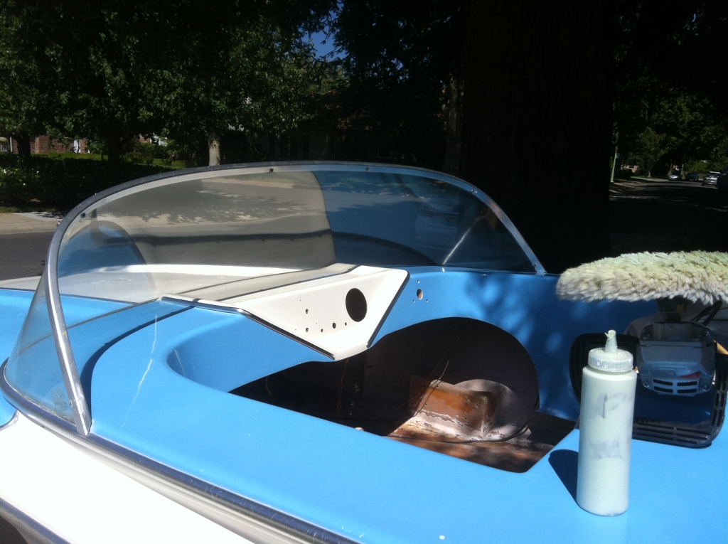

Re:Bringing her color back (polishing)... 12 years 4 months ago #88992
  • Eduardo
  • Posts: 309
  • Karma: 35

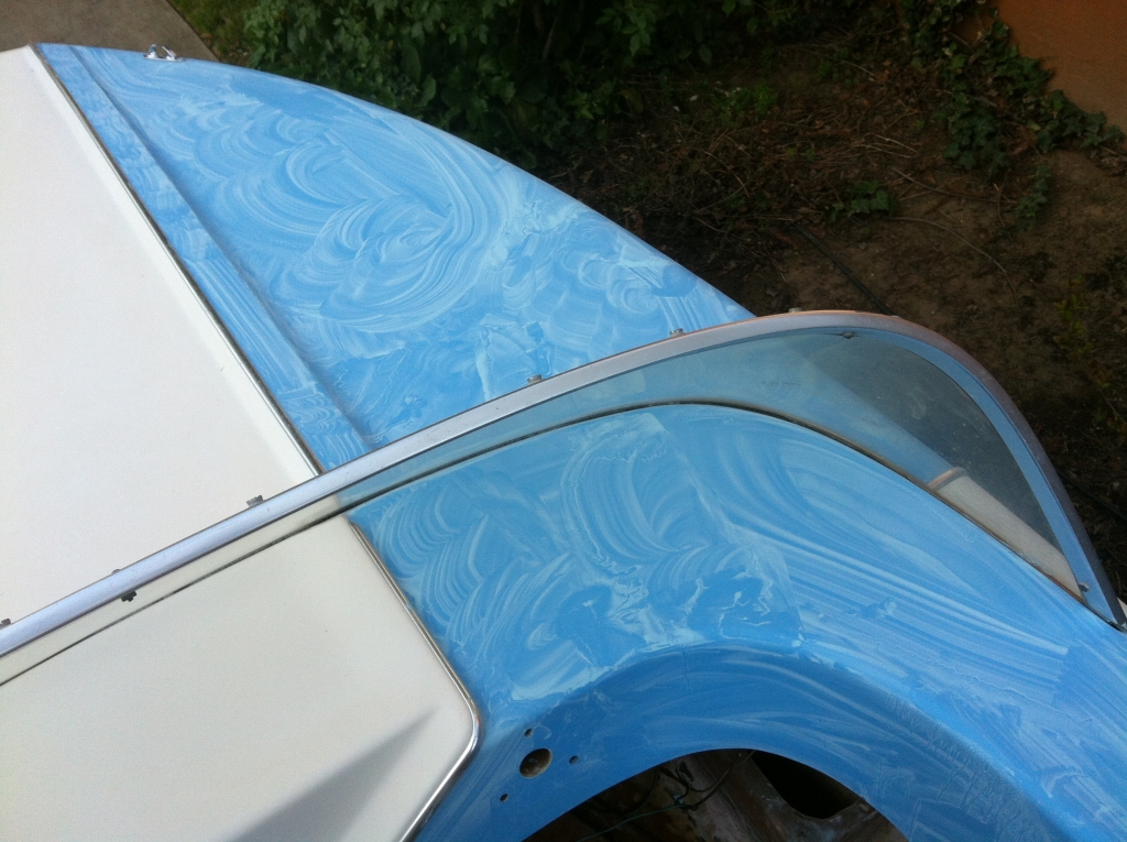

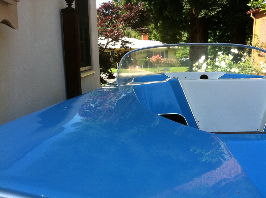

After the sanding was done, the next step was the polishing process. I polished first with a heavier grit polishing compound, then went with 3M Finesse It to finish it off. Then two coats of sealer, Starbrite with Teflon, and then finished with 3M Performance Paste wax, as described here on Fiberglassics.
It’s amazing to me how gelcoat can be restored to look not quite but almost new. I don't know but it's something about a gelcoat finish, maybe they way it feels or the warmth that it gives you. This finish turned out beyond my expectations. I mean I didn’t think the outcome would turn out like this. I’m very lucky I was able to restore her original gelcoat finish rather than having to apply a new finish. It's not perfect, but it's very presentable. There are stress marks hear and there, at a couple of corners of the center deck, and aft, the common areas. But these are very minimal, character marks I call them. I love this vintage color. What’s interesting too is the way they finished the color combo on this Jet Flight. Usually you’ll see the color along the center of the boat. This Jet Flight was the opposite, with the white color along the center and the vintage blue all throughout the deck. It's a great look. Here are some pictures after the polishing process.

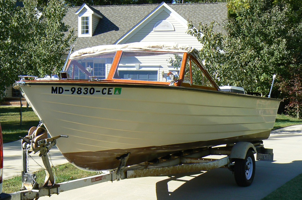

Eduardo,

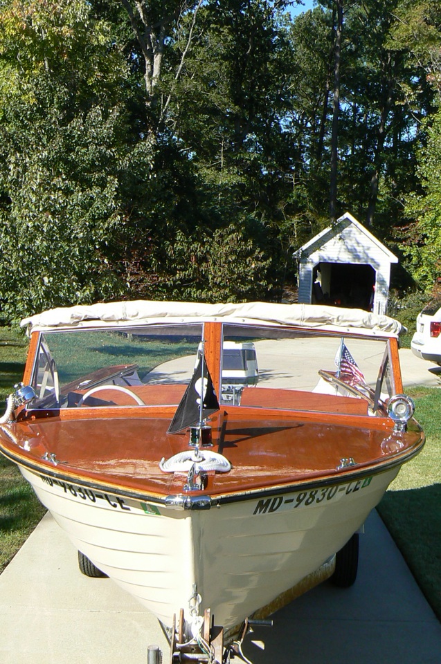

Here are before and after shots of the hull and whole boat.
1960 Wagemaker Empire Clipper 18'

Bob, way to get her shine back. It's a lot of work and a lot of sanding to get her looking like that. She looks fantastic. Well done.
Eduardo
Re:Our '60 Reinell Jet Flight... 12 years 4 months ago #89093
Thanks Eduardo, yeah it was a lot of work but I'm happy with the results. The $20 Harbor freight 10" buffer didn't hurt when it came to rubbing and polishing compound time either. ;)
