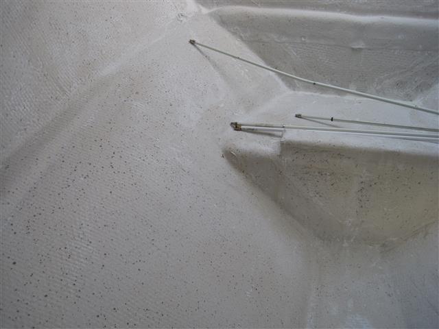

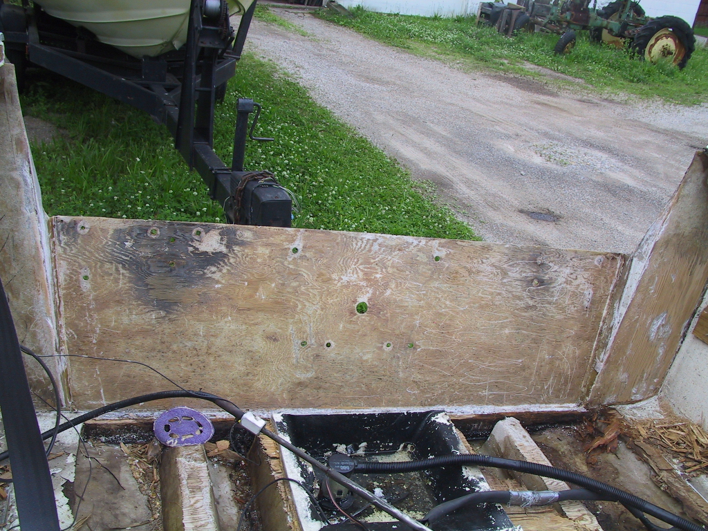

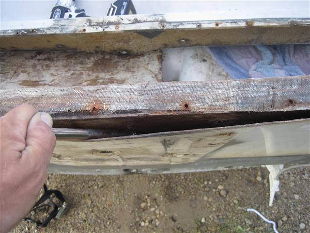

well, half of the info is true. the stringers are made of fiberglass. the floor is plywood with a glass overlay. if the transom is solid then i would think the motor weight would be ok. two of my sedans have merc 1150's on them. a 115 hp will push a sedan over 40mph. your boat is very complete,still has the cabin door,cushions and headliner,swing away helm seats and the full set of canvas. what does it have for the rear seating?
if it is necessary to replace the transom,then you will be happy to know that the sedan's transom is a fairly easy one to do. remove the rear seats,splashwell and you are there. the Glasspar owners association is a website devoted to the glasspar boats and would be a good resource for you too.
here is a pic of a 65 sedan transom with the wood removed. you can see the glass stringers and pieces of the wood floor
i think you will enjoy your sedan and i will be happy to try to answer your questions. if i don't know the answer,i know people that will. good luck,skipp

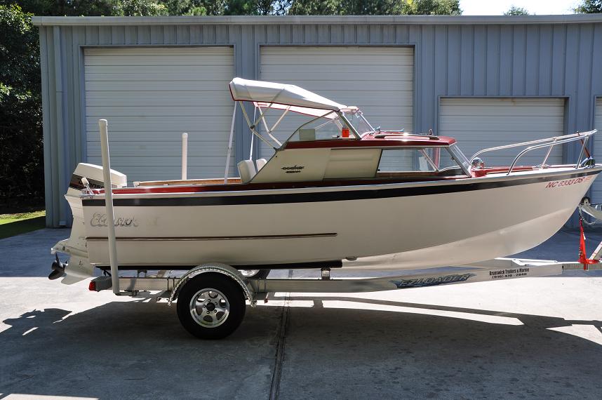

My Wife and I also purchased a Seafair Sedan last year but it was a 1960. It was in great shape but had the usual fiberglass cracks on the hull and stern so we decided to do a complete "refurbish" of the hull. We just got it done and I will post some pictures up here for you.
Skipp has given you great advice on the outboard motors for your Seafair Sedan. I think that "Mercury" 75 H.P. Outboard Motor you mentioned would work fine on your boat. We have purchased a 2009 Mercury 90 H.P. Two-Stroke for our 1960 Seafair Sedan. As Skipp said there are many Seafair Sedans with the older "tower of power" six (6) cylinder Mercury Outboard Motors ranging from 100-115 H.P.

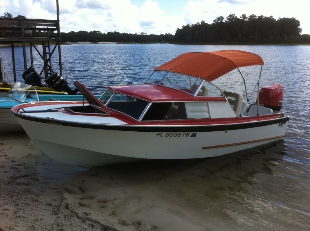

Here is a picture for you of our Seafair right after we bougt it
Good luck with your boat Sir.

Thanks for the replies, I see what you mean with how easy it will be to remove the transome. It looks like the plywood for the transome may have been replaced in the past, but I am not that impressed so I will be redoing that. I was wondering if I don't get the 75hp will a 50hp push the sedan on plan? For now though I am working on my brothers project so I can get that out of my garage :laugh: I will post that on the projects page.

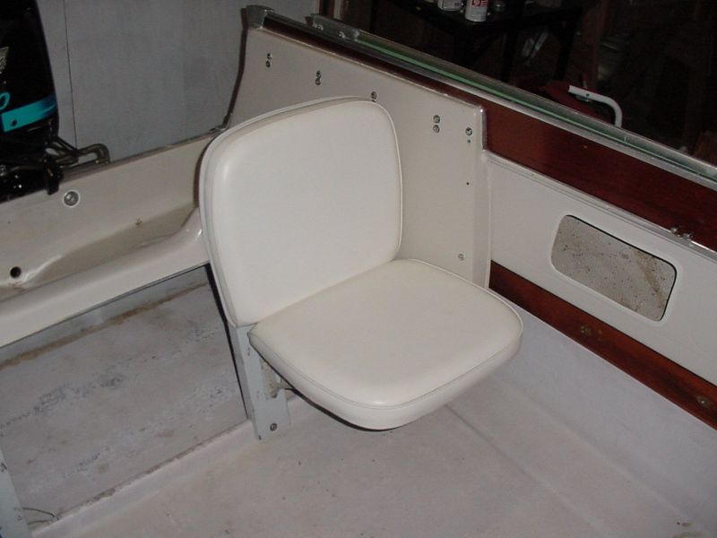

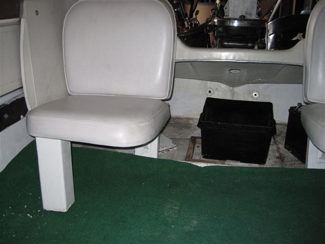

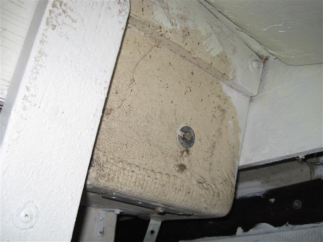

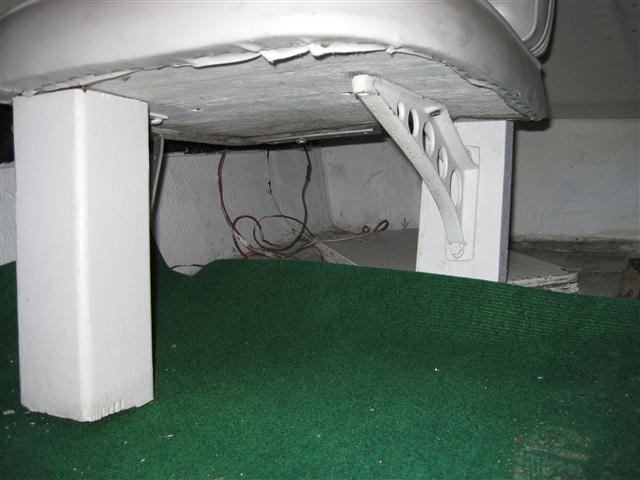

I finally got a chance to take a couple pictures of the back seats. For some reason I don't think 2x4 and 4x4 leg under the seat is stock so what are the back seats supposed to look like? This is a picture of the back of the seat
Re:glasspar sea fair sedan 13 years 11 months ago #71148
you are not going to believe this,but the 2x4 is part of the factory setup. the 4x4 is not. i have been going thru the pics of sedans that i have gathered and it seems the rear seating was not at the top of my list. there was a standard seating package where the seat is supported by the cast support arm attached to a 2x4 on one side with the other side of the seat being supported by a lip molded into the splash/motor well. on later boats there was a deluxe option. this was larger seats mounted on boxes with a fold up table between them. this table also served as a cover for the opening to the area under the splashwell. i did find a couple of pics for you.
naturally some homebrew solutions have been made too. benchseats with storage under them is a popular choice. i liked Ric's solution also. he made boxes for the seat support and then hinged the front of the seat. when the seat is folded forward,the support becomes a handy step into the boat.

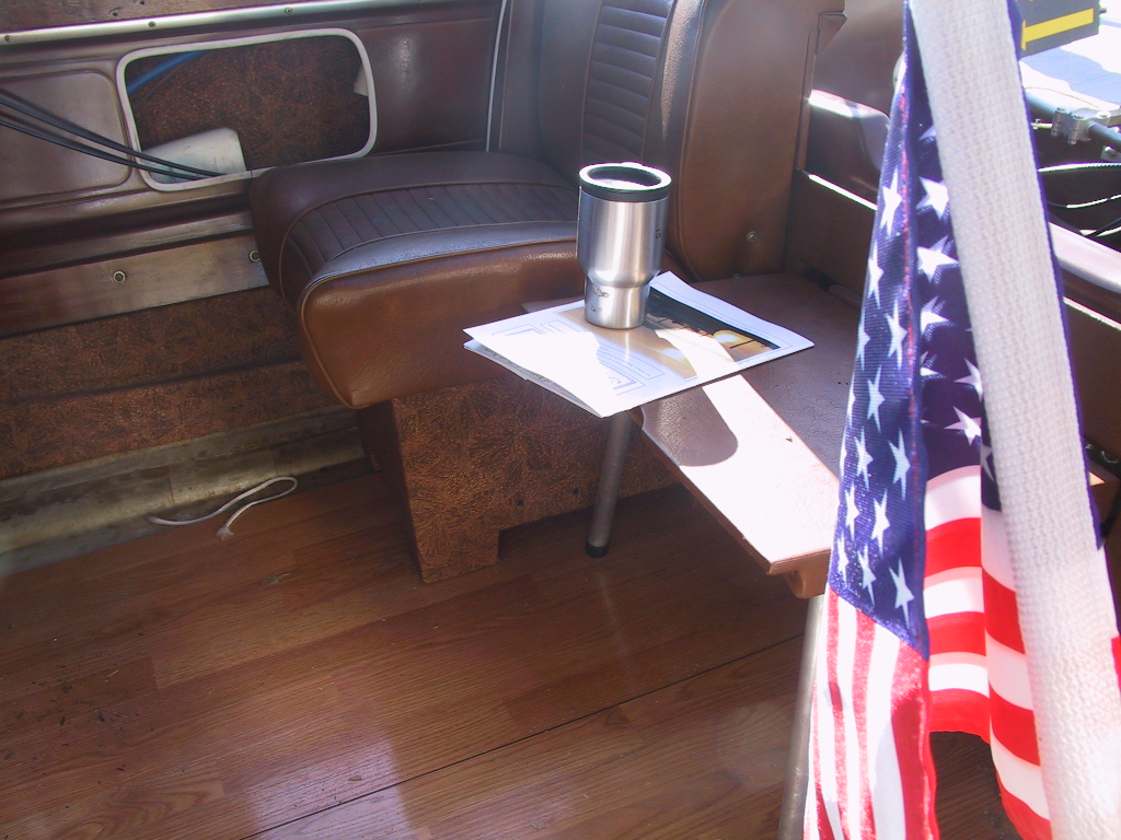

1968jetflite:
Here are some photos for you of what the original Glasspar Seafair Sedan Rear Seat Supports look like. This pair is from our 1960 Glasspar Seafair Sedan which I bead blasted and then repainted with the original "Zolatone" Paint:

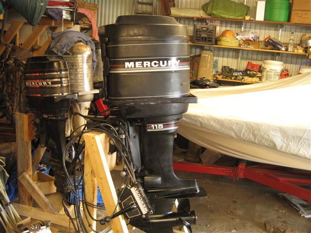

Well it looks like I will not have to worry about that tiny 50hp merc to push the sea fair around slowly, because I just picked up a 140hp mercury TOWER OF POWER :lol: with power trim . Also I got a second power trim unit in the deal which will be going on the jetflite all for a fantastic price. I could not be happier right now. :) Pictures will come later once I figure out how to get that beast out of the bed of my truck.
Now for the important question is a 140 merc that much heavier than a 115 merc and do I need to beef up the transom to take the extra weight if there is any?

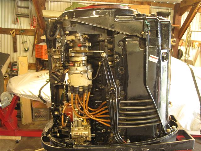

With the help of my father, brother, and a lot of grunting we got the motor out of the back of the truck today. The guy who sold it to me said the previous owner took the 1400 stickers off of it and put 115 stickers on the motor, because his boat was only rated for a 115. Is there a way to tell if it is really a 140hp? I can't seem to find any markings on the block to indicate anything. If it is a 1400 it is a 1972 according to the serial number.

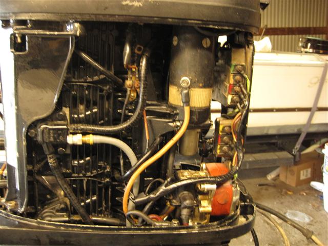

hey jetflite, what is the older tower with the blue rag on it? is it a long shaft and full gear shift. sure do like those old merc's. nice score on your boat and motor. frog
Re:glasspar sea fair sedan 13 years 11 months ago #71613
The motor in the back is a mark 78 with no lower unit and froze up. I got it with a mark 75 that it next to the mark 78. Some day I hope to get the 75 going. The 1971 merc 50hp next to that I am putting in the basement and hope to get it running this winter.

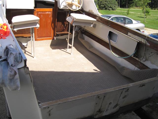

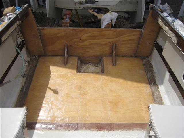

Here is a picture of the floor and transom completed, I put some braces on the transom because of the large motor I plan to use. The previous owner used interior white paint to cover up the zolatone. The good news is, it can be washed off with water and a brush, so I'll try to get as much of the white paint off as I can before I put the carpet in.
Re:glasspar sea fair sedan 13 years 1 month ago #82072

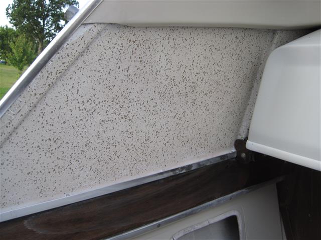

After about 6 hours of scrubbing with soapy water and brush, I have been able to remove most of the interior water based paint from the boat. Hopefully this weekend I'll be able to install the carpet and put the splashwell back on. Then its off to pick up the 140 hp TOWER OF POWER! If you look at some of the pictures I first posted you'll be able to see what it looked like before.

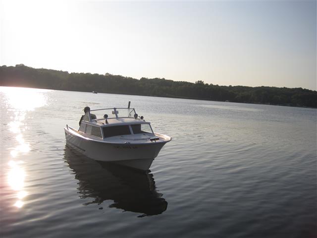

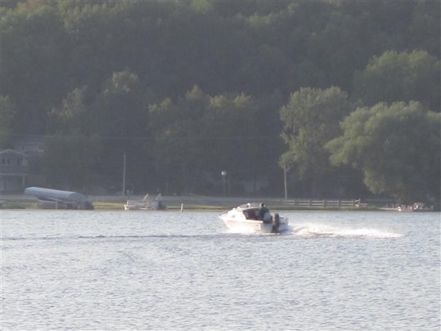

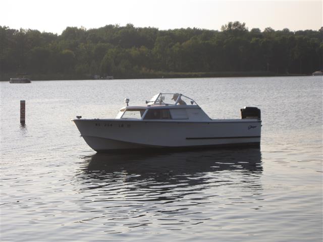

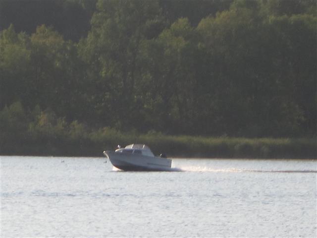

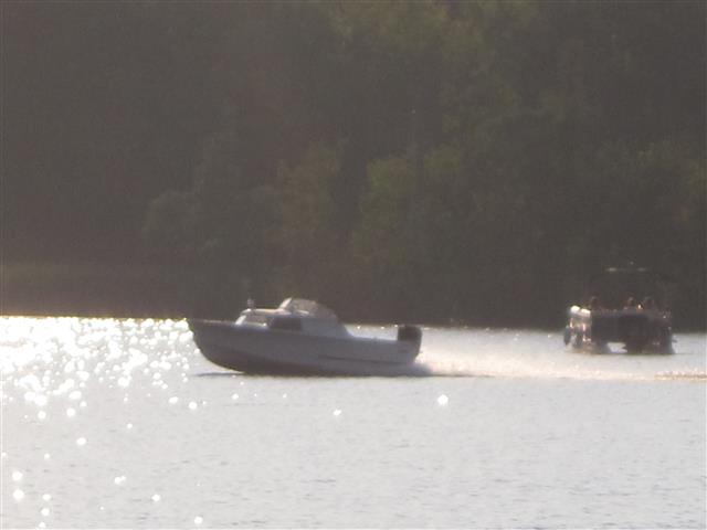

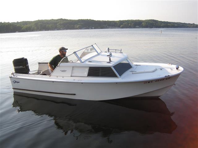

I got the motor mounted and running. Took the glasspar out to the lake for her maiden voyage and things went well for about 8 minutes. Put the boat in the water and it started right up, then I took it out for a quick spin so the wife could take some cool action shot before she climbed aboard for a nice spin around the lake. Well we got the cool action shots, but as soon as I came back to pick the wife up, the motor died and I barely got it to run enough to get back to the pier. Not sure what is wrong but I will do some tinkering tomorrow and see what happens, if anyone has any suggestions I would really appreciate it.
Despite all that the 140hp tower of power when it was running, took off like a ROCKET! Which has really got me excited about all the fun we will have when I do get it running properly.
Re:glasspar sea fair sedan 13 years 1 month ago #82886
Great to se that you finally splashed the Glasspar. Great looking shots of it on the water. I hope you manage to get the motor up and running proper for the weekend. Skip.

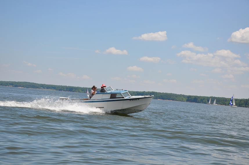

Well it turned out that the middle carburetor float was stuck. At least it was an easy fix. So the wife and I went on a nice slow cruise around the lake, and the wife loved it. The motor did die once about 20 minutes into the cruise, but once I got it restarted it ran fine. If I'm lucky this weekend I will be able to do some speed trials, and see how fast a 140 horses will really push the sedan.
Re:glasspar sea fair sedan 13 years 1 month ago #82932
Great pics, glad things turned out to be an easy fix. 140 ponies should push her along at a good clip.

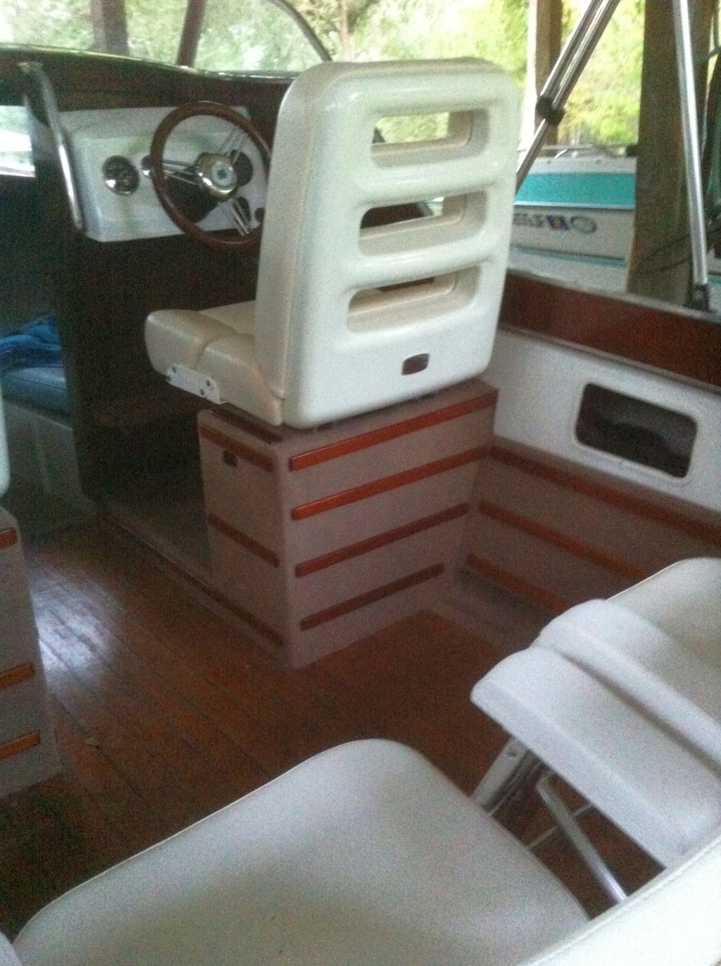

Well I thought I would update you guys on my planes for this spring, as I sit and watch it snow again outside. Last time I took the seafair out to the lake I noticed that the trailer really is quit rickety, and tends to sway the back of the truck around, not dangerously but enough to notice it. So this fall I managed to acquire a 1983 Larson open bow in terrible shape with a nice roller trailer and a 115 tower of power for only $250. So as soon as the snow melts I will be switching trailers and possible upgrading to a newer tower of power. I believe the 1972 140hp and the 1983 115hp are actually the same horse power at the shaft.
Also I still need to install the rear seats, and refinish the mahogany.
