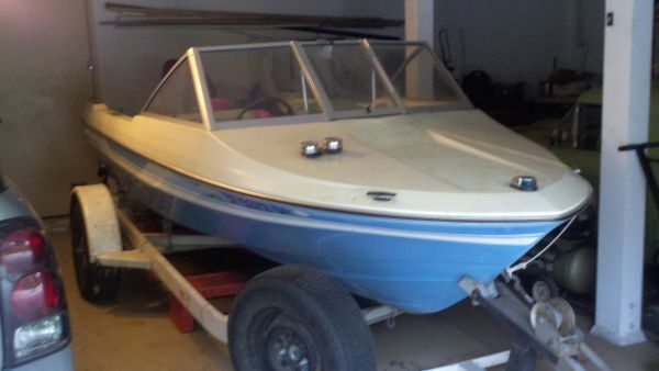

Re:First post, looking for first boat! 14 years 3 days ago #62117
Here's a pic from the for sale ad. This is the fiberform.

That fiberform looks pretty nice for the money- The trailer alone looks to be worth that! Buy it, enjoy it, and keep looking for that classic that you REALLY want...

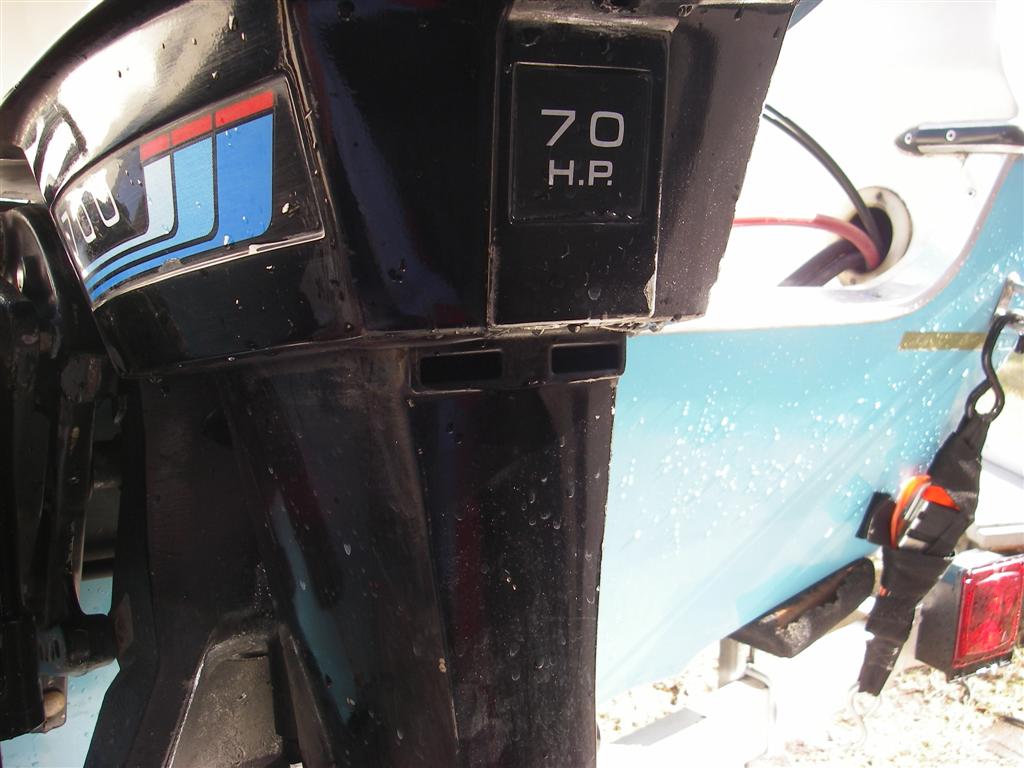

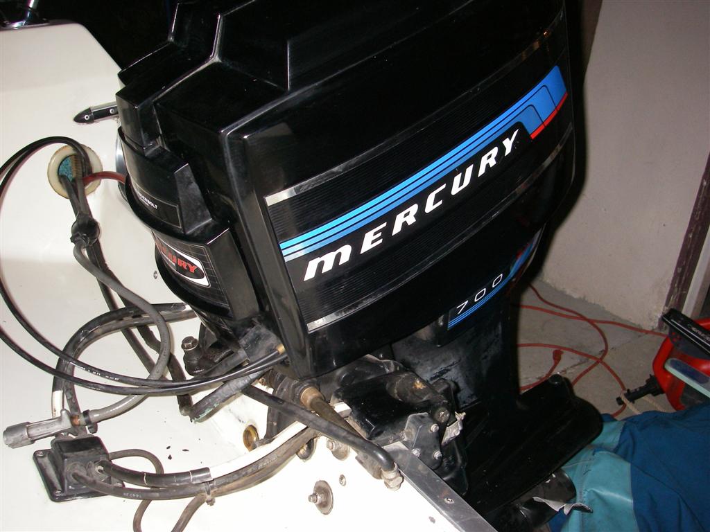

Re:First post, looking for first boat! 13 years 11 months ago #62483

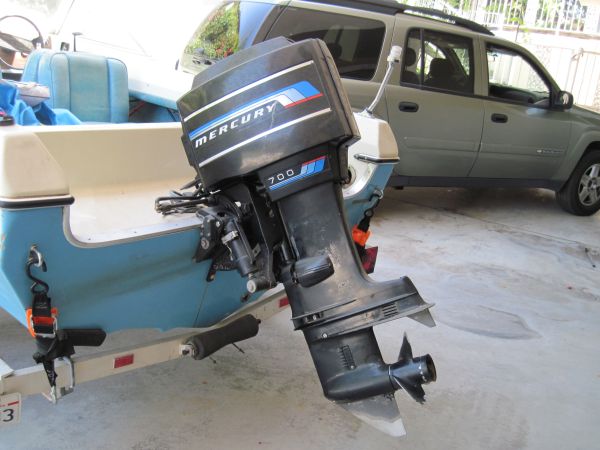

So the boat is home. Ended up getting it for a bit less than I thought I would. $400 and she paid the transfer fees at the DMV.
Spent a few hours cleaning and polishing. I'm very happy with it. Used Mcquires swirl remover, really did a nice job cleaning up the finger marks and brightening the gelcoat.
For the heck of it I threw a charger on the battery that has been sitting for 8 years. It actually took a charge. I'll probably replace it anyways, but it's nice to be able to test all the stuff.
All the electrical works. The battery cable to the motor needs to be replaced. The insulation falls off if you look at it wrong. It's duplex cable, if I can find some I will use it, otherwise it will get regular 4 awg cable which I already have.
I found a useable spare propeller under one of the seats, that's nice.
Added some fluid to the power tilt. So it would go all the way up.
Tires are in good shape.
I sprayed some 2 stroke oil into the carbs and cranked it over with the pull rope. Also squirted some into the cylinders. Feels good and no surprises under the hood.
I might get a chance to do the impeller tomorrow, but don't want to spend all day working on it again. Not exactly in the dog house with my wife, but I don't want to push it, lol.

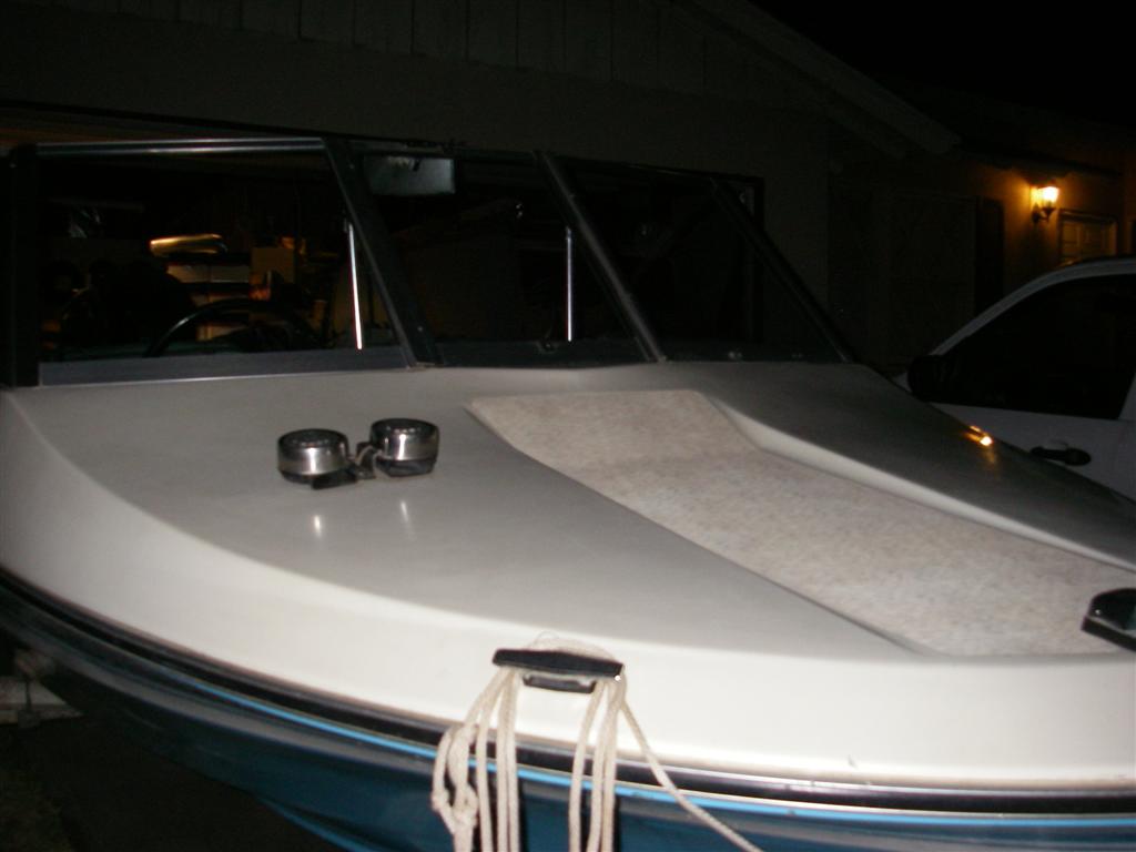

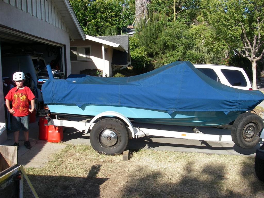

Here's a few pics after cleanup. It's 1 in the morning, pictures could be better I guess.

Lookin' good there Etc., I'd say she's shinning up pretty nice! IMHO you got a very reasonable deal, looking forward to seeing some "on the water" shots.

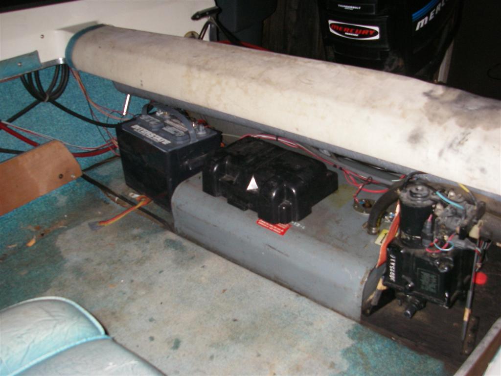

So I was at the junk yard today, poking around. Found a van with a wheel chair lift. The hydraulic pump/reservoir/solenoid setup looks exactly the same as the tilt trim unit for my Mercury. This one looked pretty bad so I didn't grab it. Kept looking around. Found a lift gate on the back of a pickup with exactly the same unit as the wheel chair lift. Both the truck and the van were from the 80's.
Just a possible source for parts/spares for people with these units.

Great find, but I do have one question. Is that a built-in gas tank? Is it fiberglass? If so, you could end up with some serious problems from the ethanol in gas. Might want to consider using portable tanks instead if it is a problem. ENjoy

Good point Todd. It looks just like the Tempo brand tank that was in the bow of the CVX. Looked great on the outside, but full of rust on the inside. Whatever the case, I'd agree that it definitely needs to be checked carefully before using it. ;)

Thanks for the heads up on the tank, didn't even think to check. When I got home I checked it first thing, it's pretty darn clean. I drained what little gas was in there a few days ago and it was clean also. It's a steel tank.

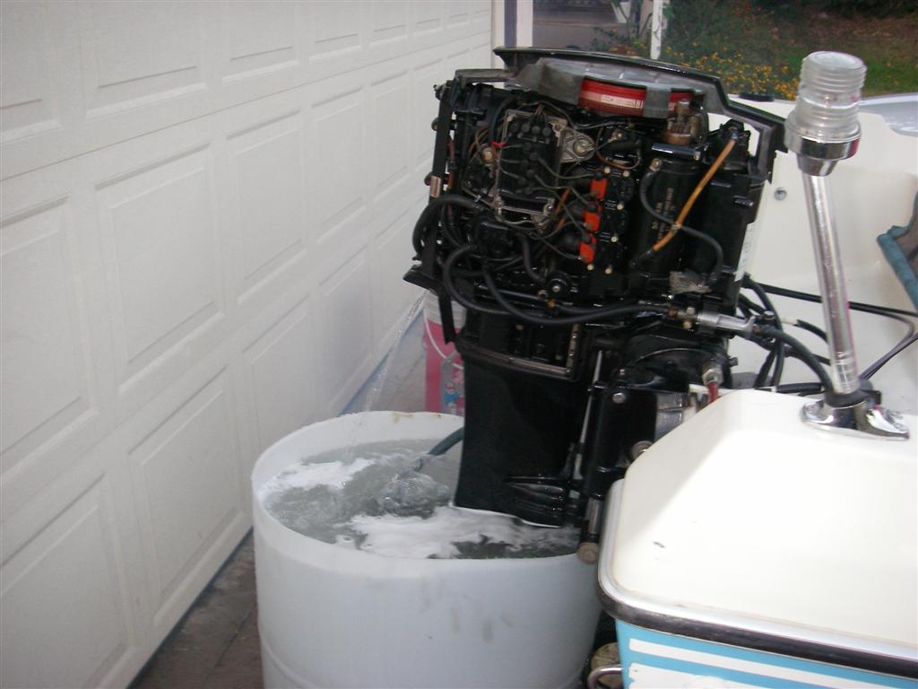

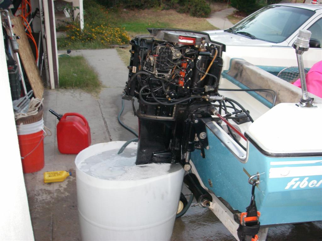

It's coming together. I made a test barrel from a 55 gallon drum. I'll do the impeller today once it cools off a bit.

If you could see me you would be looking at the happiest person with a boat. Impeller installed. Check. Fresh gas mixed and poured. Check. Cut down 55 gallon barrel in position and filled with water. Check. Fuel line connected and spark plugs torqued. Check. Primed. Check!
Pushed cold start lever forward, held choke button. Turned key for about 2 seconds and it fired right up!!! I mixed it a little rich because it's been sitting, so it's a bit smokey. At least at idle in a barrel she runs sweet!
Thanks for the advice given here.
Couple shots.
Here's the setup.
Here she is running at idle after the smoke cleared somewhat. Too bad we don't have mosquitoes because the initial smoke cloud would have cleared them all out.

Good for you Eric, looks like you're ready for lake trials. Don't forget to make your little buddy wear his life jacket, and don't forget to put the plug in! :blush: (It only happened once, I swear!) :laugh:

mtdoragary, If the connector or more of the wiring starts giving me trouble I'll do what you say and wire direct. There is about 3 or 4 feet of extra harness coiled up in the boat. I actually considered doing it anyways, but found the big connector and didn't want to mess with it at this time.
Tested forward and reverse, I might be ready to head out tomorrow. Went to full throttle for a second, boys got a kick out of that. Kind of nice having a barrel full of water to test in. Was very careful to no allow the water level to drop below the intake ports.
I have a question for you guys, not sure if this is right or not.
While running water is coming out of the exhaust ports under where it says 70 HP in the picture. 2 rectangular ports side by side. I don't recall water coming out there during the first test. Some exhaust exits there as well, I assume that is normal.
Thanks again for everyone's input. It's great to have a site like this for a relative newbie like me to rely on. If I can get the honey do list whittled down I'll take it out tomorrow.
Eric
Re:First post, looking for first boat! 13 years 9 months ago #67265
Well, I'm back. I still haven't taken this boat out yet, but it's looking good for tomorrow. I ran it again today and had 2 questions. How warm should the top of the motor get? On the left side (passenger side I guess) there is a weep hole that is part of the side cover. Water weeps from this. I think last time I ran it I had the cover on. Is this normal?
The top of the motor gets warm, not too hot to touch, but hotter than you would want to sit on.
I will have pictures tomorrow.
