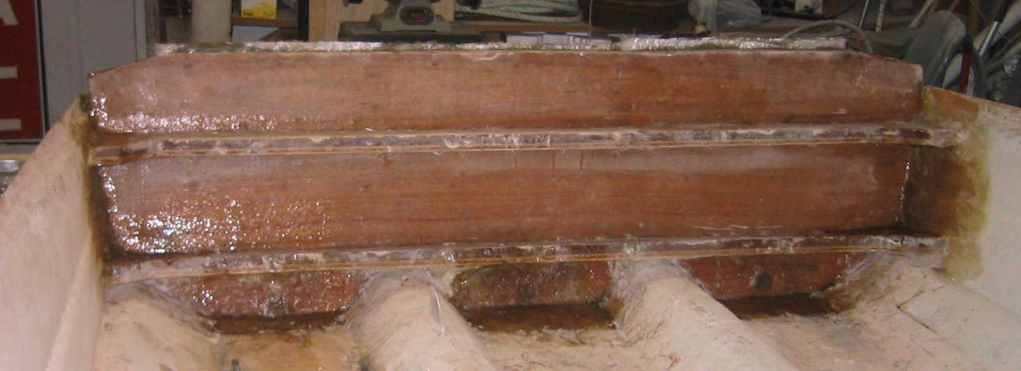

The G-3 transom presents a few challenges- One of them is the transverse curve. So, To replace the skin, I need a mold to form it... I used a sheet of 1/4" MDF, and an oak batten to form a mold over the outside of the transom-
The oak batten keeps the top curved correctly-
There is a layer of waxed paper attached to the MDF to keep the 'glass from sticking.
Now for a couple layers of glass-
Sorry, no photos of the layup itself- I don't like to touch my camera when I've got epoxy on my hands!
I used two layers of cloth so far. the first one was cut out to fit right inside the missing area. There is no strength to this layer, really- it just fills a 'void'. The next layer overlaps the edge of the repaired area by about 2" all around. I tapered the edges of the existing transom- so as I build up glass inside, it won't get too thick... In the end, I want the repair to be about the same thickness as the original skin.
After another layer or two in the repair area, I'll put a layer of Biaxial cloth across the entire transom... And then start with plywood.
Then come stringers. Then the floor.... What was I thinking :)

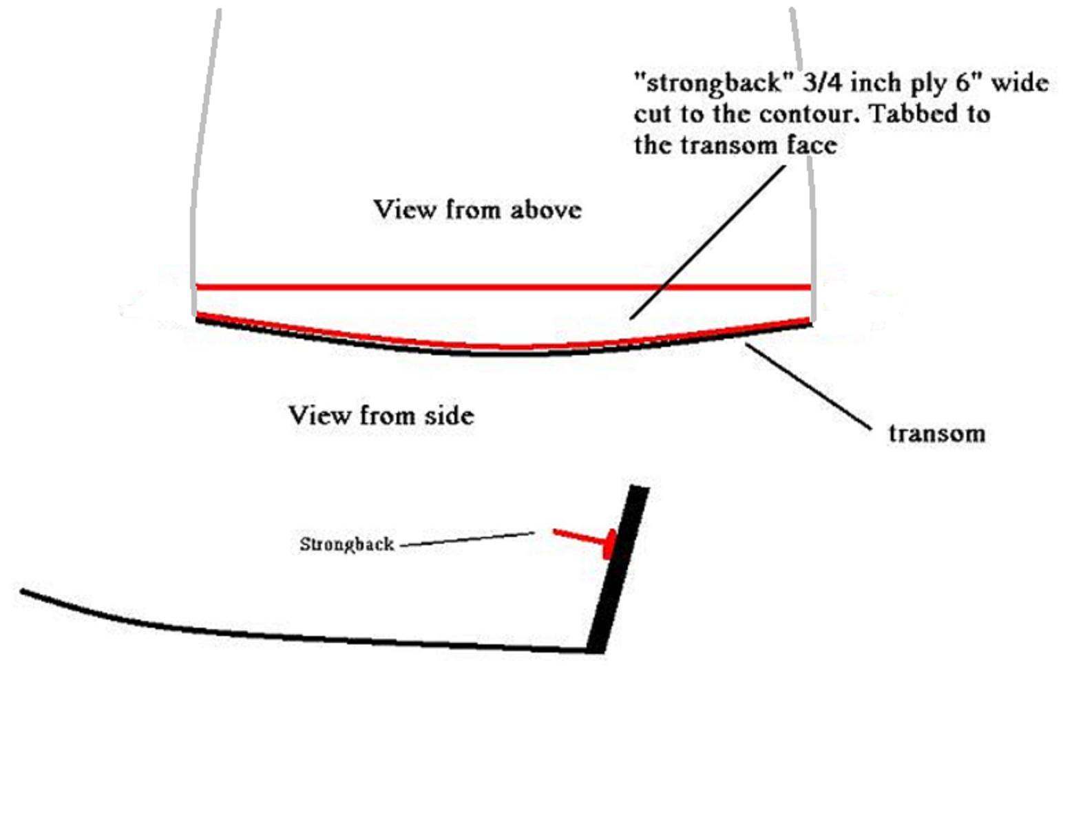

OK folks - let cool heads prevail please. Just a suggestion - if you ever want to get in a heated disagreement with another member - think about doing a PM rather than bickering in public. Having the world read your dirty laundry will just make you more angry.
As for the transom, the curved transoms are called "pre stressed" and it is true that they are able to provide more strength than a flat transom of the same thickness. This why most large dams are curved - because of the strength. The splashwell on most of our small boats limits the addition of knee braces. I've attached an illustration of a "strong back" rib, which is another way of adding tremendous strength to any transom, flat or curved. My Reinell Jetflite was designed with one of these. It was installed under the deck, just barely below the bottom of the splashwell, and can not be seen, even when sitting in the boat.
Bruce.

Re:Glasspar G-3 gets a new transom... 15 years 1 month ago #46575

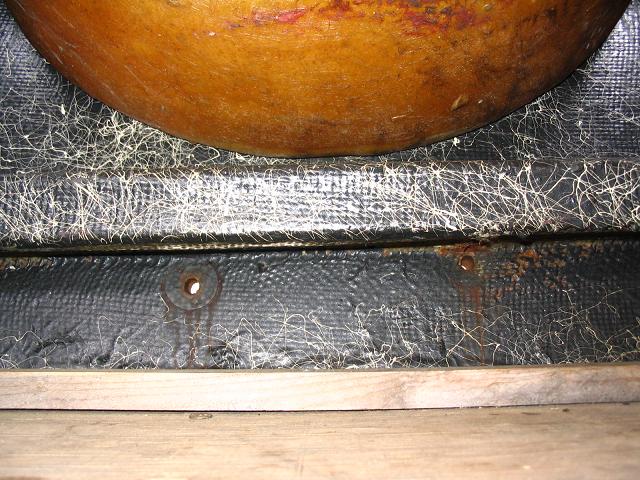

Bruce. [img]http://www.fiberglassics.com/media/kunena/attachments/legacy/images /Transom_rib-20111005.JPG
bruce, the mantaray has that same crosspiece,stringer, brace, whatever you call it. looks like the dimension of a 2x4 across the whole transom, just under the splashwell. the holes is where the motor bolts on. ron

A bit more progress... I used the FAST hardener this morning, and since it was a nice warm day, I was able to get a bit more glass work done-
There is now a layer of nice, heavy Biax across the entire transom, from sponson to sponson. There are 4 layers of 'glass in the repaired area, with an overlapping edge to tie it in to the old skin, and now an additional layer across the entire transom. This will provide a little more strength in the transom than the original had.
The curve is held fairly well still, But might not be dead on. I'll pop the cap back on before I put the wood in, to make sure that I get the curve of the transom right. I'll be able to use clamps secured to the stringers to 'push' the transom out where I need it to be, as well as to clamp the plywood in place.
Next step- PLYWOOD. Probably tomorrow. I need to get more epoxy, though!

Yep, thats a 2x4 glassed in under the splashwell Ron. The original on mine was not attached at the ends, the new one is.

I had one stock "2X4" across the transom when I got the Power Cat. I replaced it with two double laminated 3/4" marine plywood pieces left over from building the transom. I wanted it to be better than new. Who knows?

Here is the area in the condition it was in when I got it-
It had already been cut open for some 'exploration', so that will need to be fixed.
First, A bit of cutting and grinding to make it all square... Then, I tapered the edge down so I have more surface area to join the new plywood to the hull-
A plywood 'patch' is cut-
The edge is tapered, like the cutout-
It fits pretty well... A little fine tuning, but it's close. It has already been sealed in epoxy, and I'll use some thickened epoxy to glue it in place, and then fiberglass over the top of it.
But, before I can close off the sponsons, I need to reinforce the sponsons a bit. I'm going to use 2 layers of 1708 Biaxial tabbed into the hull... The fiberglass will be over 3x thicker than the original here, so strength won't be an issue.
And, on the Port side (note that the cutout is missing from this side!!)
That should be plenty strong. The sponsons are sealed off completely, and offer additional floatation, so it's important that they stay intact.
Today, hopefully, I'll get the sponsons sealed off, And perhaps some plywood cut. I need to get more resin before I go too much farther, though.
-Andrew

Thanks, She's coming along nicely. I 'glued' the patch panels in with some thickened epoxy today, and I'll start with some glass tonight, hopefully. I've got to take advantage of this GREAT weather while it's still here!

I got the replacement plywood in this morning. I glued it in place with thickened epoxy. Once that cured, I ground it all flush, and got a few layers of glass on top-
I didn't have the 'real' camera with me, since epoxy and expensive electronics don't mix, so you'll have to just get by with an IPhone pic...
