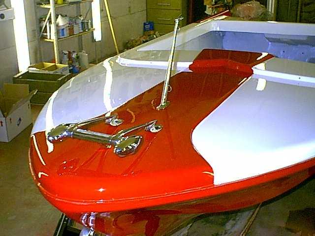

They look wonderful. Just goes to show you that you don't have to have big bucks in paint. I know my boat will be seeing gravel sand, rocks, boat ramp rash, submerged logs and what ever else. I just don't like the black boat. It shows all the dirt. Sure I'd like to fix one up to show quality. I make due with what I have. I have my ladder racks for my truck needing paint. I don't use them very much but they need paint bad. It will be rustoleum.

Very nice paintwork,bobo.I've had good results with rustoleum too.

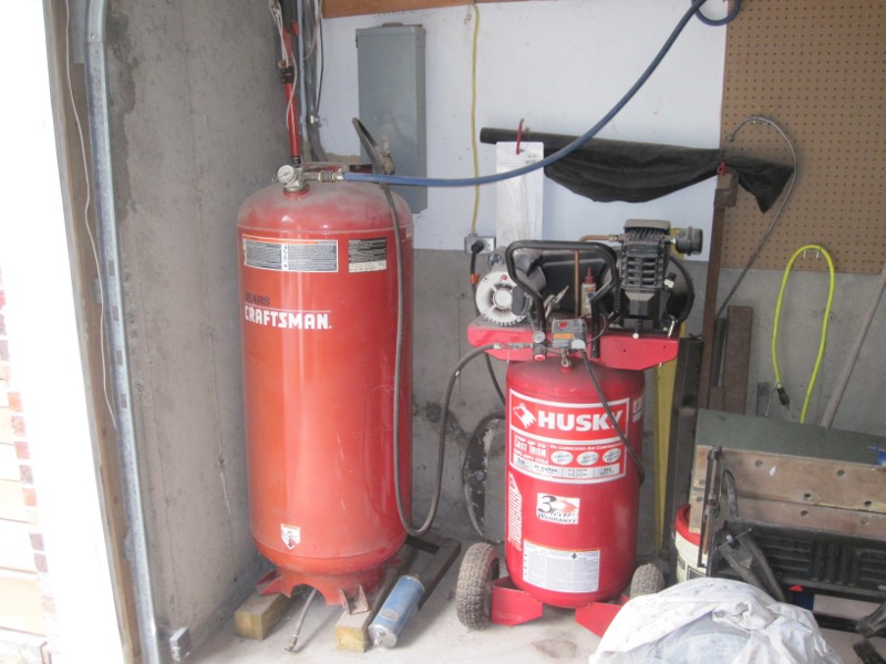

Painting just takes practice .Biggest thing is Prep ,Prep and More prep before you paint . Ya need a decent Air Compresor and water seperator . One cheap trick for us Poor guys .Get a extra compresor tank from a bad compresor you can find them on CL .Plumb your good compresor into it and drawl your air off of the non powered tank .If you push your hot air into a cool tank the water in your air will condensate on the 2nd tank and drop out of your air .Then run a seperator off of that tank and a cheap filter at your gun .IMHO Ild use a Siphon feed gun if its your first time spraying . I think they are more forgiving .Harbor freight has some real Decent spray gun for under $40 .one as low as $25 if on sale and peform as well as $400 Binks guns ive had .If you wanna know the good ones I can post them .Ya gotta make sure you got a gun with the right tip .Never spray outside in Direct sun light .Never shoot Enamel when humidity is High It will dull like crazy .Have a test panel Preped the same as what your spraying .On each coat spray that panel .Then you can touch it to see if your paint has flashed off enought to put the next coat on instead of pokeing at your Job .And if you get it looing good LEAVE IT ALONE ..Shut the lights off and walk away ..L.O.L..Dont know how many times Ild keep walking in to check a job and kick up some dirt into it or Have a Bug come flying in and crash land on it .They always got to crawl around to ...L.O.L..The paint will dry weather or not you keep coming in to stare at it . AND PLEASE PLEASE PLEASE spend some money on a GOOD resperator and a Tyvec suit .Tyvec Ive seen on Ebay for less than $20 . 3M resperator with Charcoal Filters $35 .Isnt $55 worth your LIFE ? Sorry if Im sounding like a Smart Butt .Just trying to throw up a few tips for Newby Painters . Just one other thought ..Most paints can be made to look decent if applied right in the right conditions .Often a Job takes a crap and we blame the paint .All paint has limitations . I think thats why some people will swear by a paint while others swear at it . Ya just have to learn each paint .First time I sprayed Croma One Dupont (( A single stage urethane ) It was on a Harley Tank .It cost around $400 a gallon then Pluss Hardners .First coat I shot like I was use to Then flashed it and sprayed the 2nd and 3rd .came back in to check it and it ran SSSOOOO Bad I had more paint on the floor than my parts ...L.O.L..Ended up wet sanding it and reshooting . Boss man was None to happy about waisting $200 or more in paint Pluss labor to redo ..L.O.L..Then I learned to spray it .You shot the first coat so dry it looked like sand paper and My Tip on my gun was way to big .Then let it flash off alot longer than I was use to .Shooting 2nd over a real dry coat made the thinner melt into the dry and kept it from running .After learning it it became one of my favorites .Dam Price thow .My point is we can have the best of the best and still screw it up Or shoot what others call Crap and make it look decent .Ya just have to find what you can afford and learn the paint .EVERYBODY has a disaster if ya paint enought . Just learn from them .

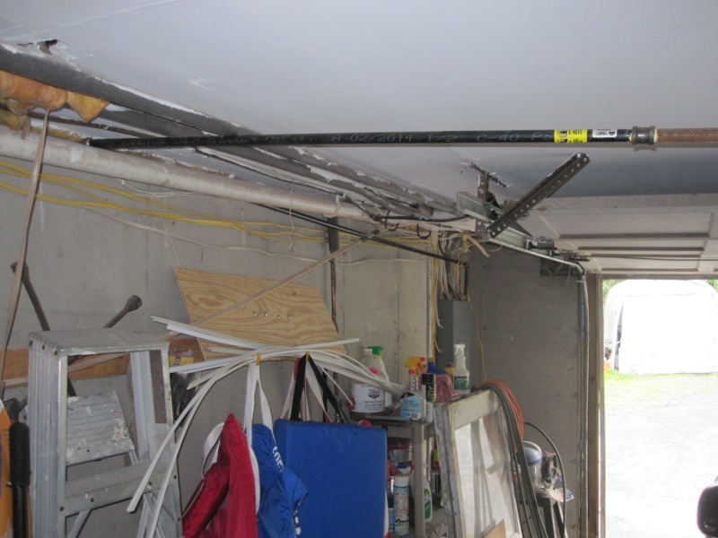

Thanks for the tips bobo, I sure do appreciate the advice. I'm good on the compressor set-up, using an old 60 gallon tank from a 220 compressor I used to have that kept throwing rods. Plus it was so blasted loud you couldn't hear yourself think. I got a smaller, quieter one and plumbed it to my old tank.

Goes on the other side of the electrical box, then comes out about a couple feet.
Goes across the ceiling dropping towards the compressor.

Who told you that Rustoleum products were the wrong thing to use? Rustothane is excellent polyurethane. I've used Imron for thirty years and I'm using Rustothane on my Seafair. Rustothane shoots with multiple thinnewr coats, unlike Imron, but gives the same finish. I'm very pleased with it. I'm also using Rustoleum Industrial epoxy primer. The price is DEFINITELY right!

I WOULD shoot Rust-o-thane on a car headed for Barrett Jackson. It's just as good as Imron. Limited color choice cabn be gotten around. Just use light base and have any paint supply shop tint it to whatever color you want. They use it on dump trucks because it's tough, like all two-part polyurethanes. The limited color choise is based on the industrial market they serve! If you compare the Rust-o-thane white to the Imron coral on my Seafair, you will see that the Rust-o-thane is smoother and shinier than the Imron!
