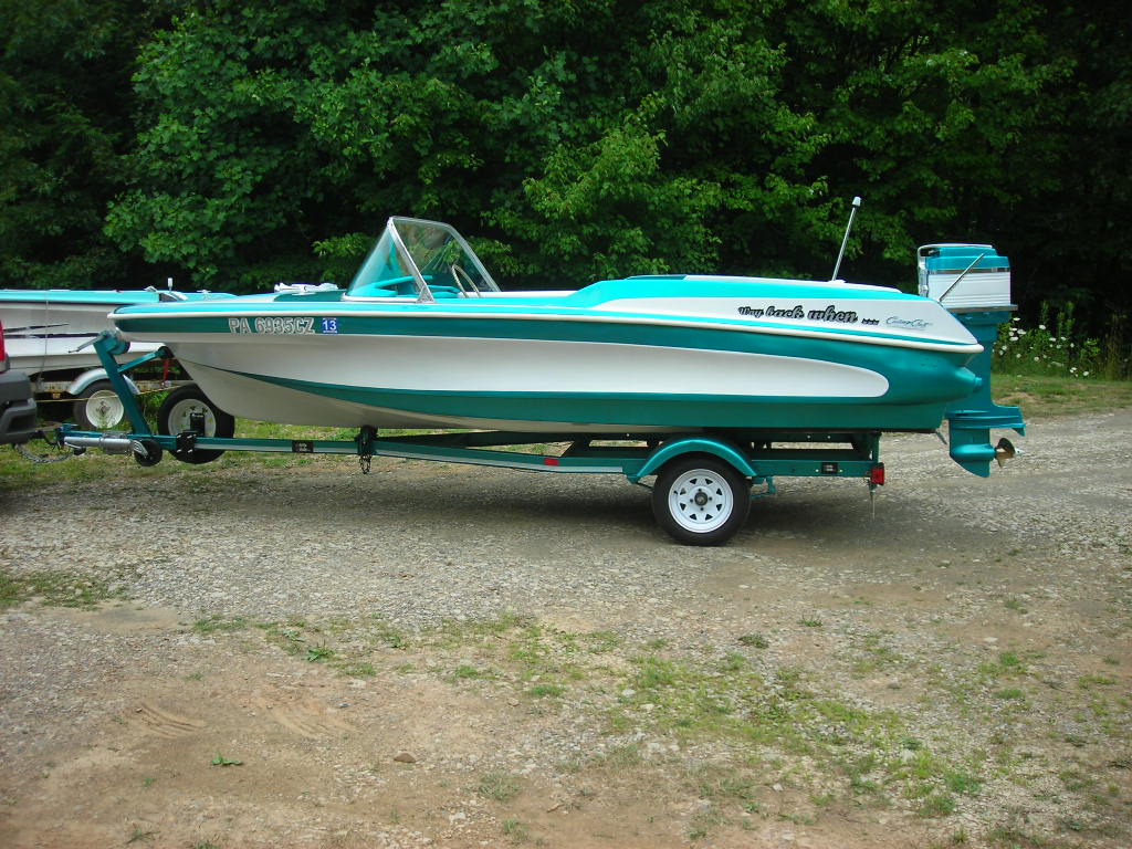

thanks frog,ed bought this boat about 4 or 5 years ago and we are still trying to finish it,most of the work was done the last 3 years,but im pretty happy so far,its not perfect but with the shed im working in its a little tough .
this boat was sitting in a farmers field for years,it was all white and all the upholstery was shot,almost everything has been redone.but i see a light at the end of the tunnel,and maybe someday we will finaly be able to get it wet,lol,john

Great custom look John, like the color scheme. That's what I think will eventually be done to a lot of these old boats. I think it will help to increase interest in fixing them up in the future.jim

thank you tim,i like to do the custom thing ,it was just rotting away in a field,so at least its still around,i used to customize cars and motorcycles,even airbrush scenes,i loved doing it.but im getting a bit decrepid now,lol.
i am glad you like it,its a high compliment,thanks tim,john

thanks jim,i think so too,i love original boats too,a whole lot,but when they are in as bad of condition as this one,then what the heck,it has gotten a bit of attention from the acbs guys and i take that very seriously.i hope it does help in some way,i love this hobby .john

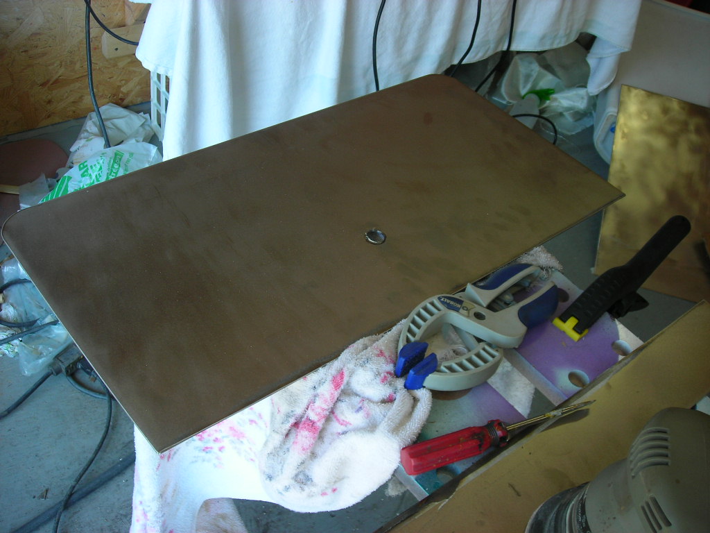

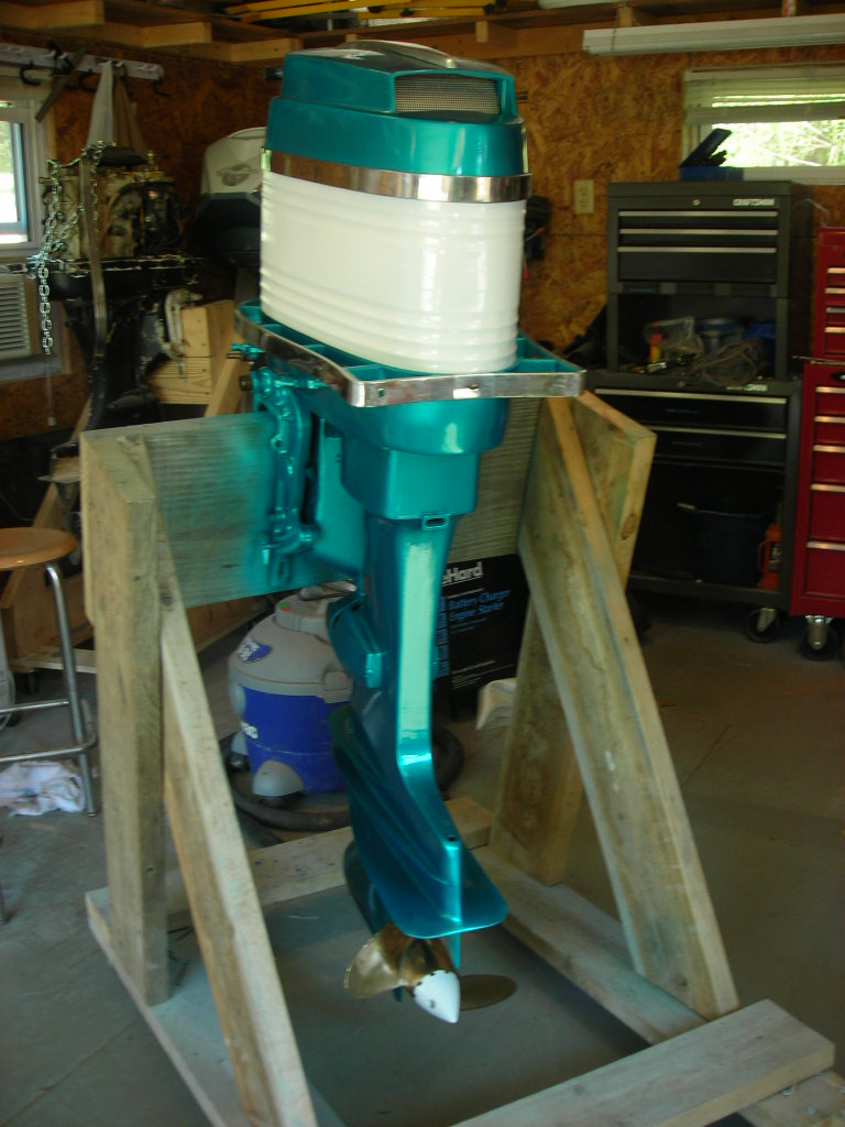

i just came in for a break,its hot out there,lol,i got the motor together,we just need decals and a good face plate,anyone going to the hammondsport show that can lend us one?its a 50 hp ,im not sure of the year 63 or 64 i believe,the faceplate on this one is really bad.
well back to cutting ,grinding and drilling the stainless sheet,we cut this out of a bigger sheet with a hand grinder and cutoff wheel.

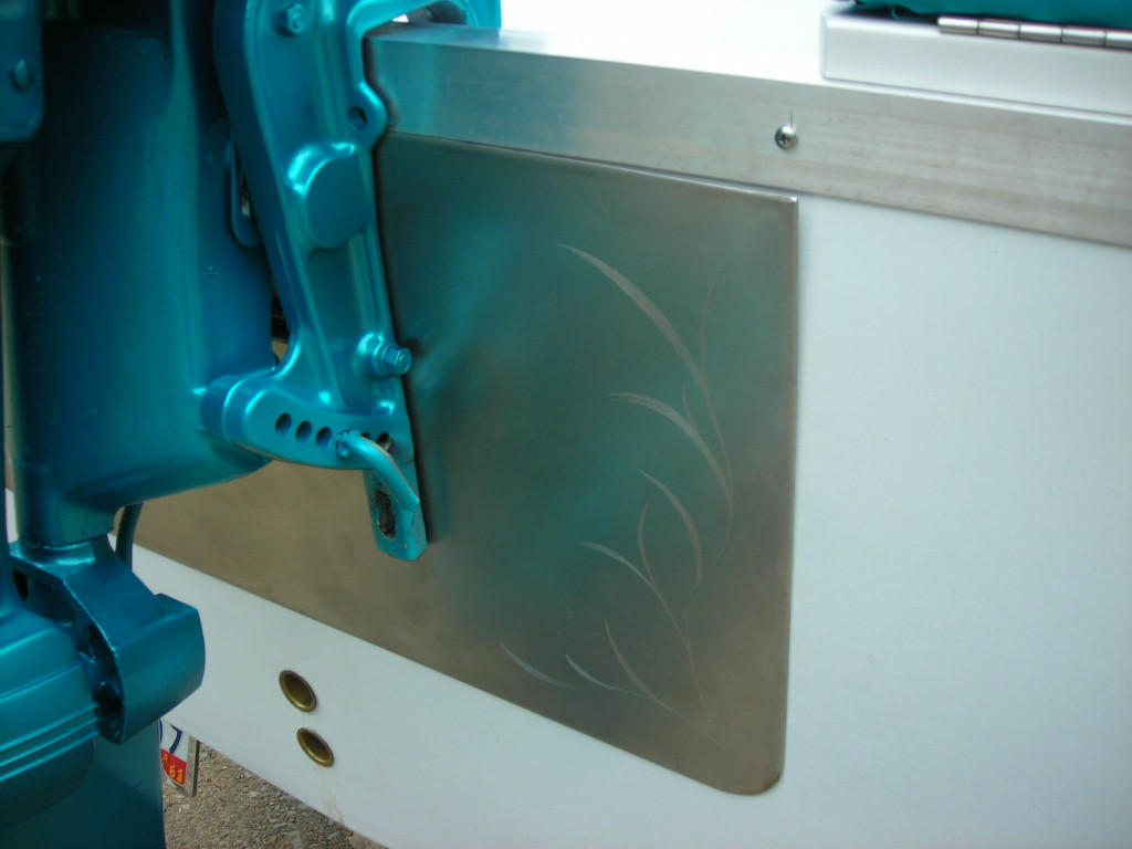

i am going to "try" to engrave the stainless steel transom plate,we worked all day cutting them and drilling them ,i buffed it up like a mirror the other day and when we held it up on the boat we got blinded by the sun,so i made it a satin finish,so we dont blind anybody following us,lol.

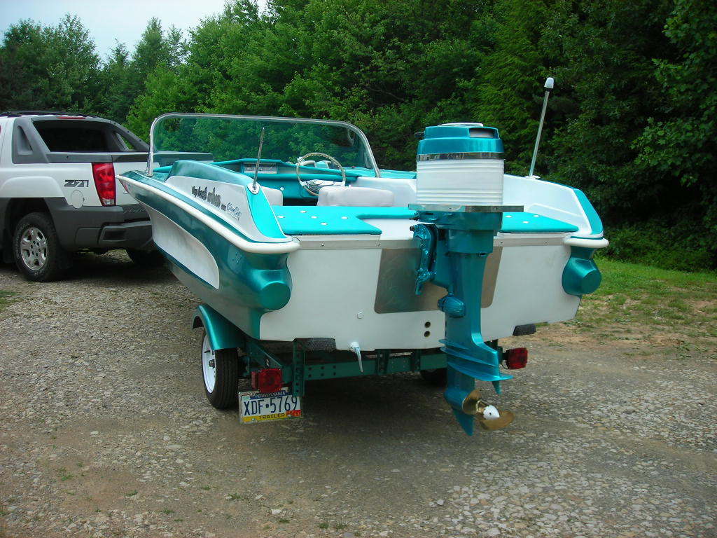

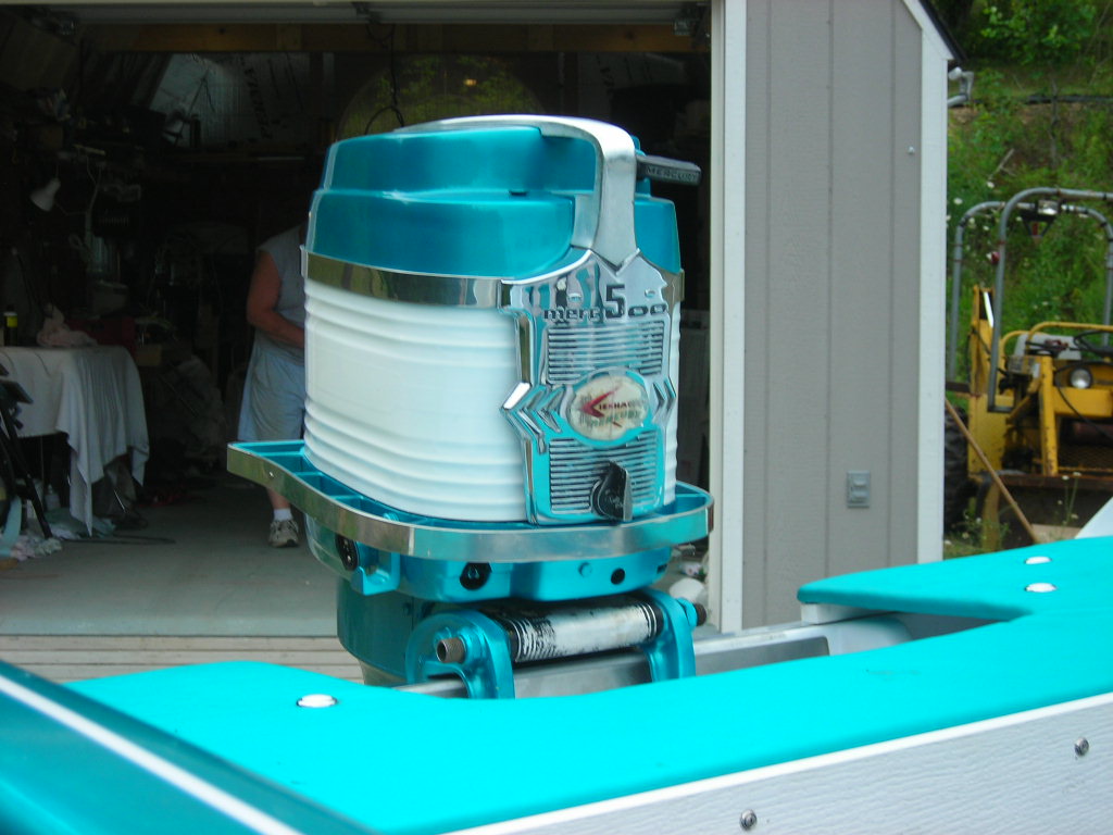

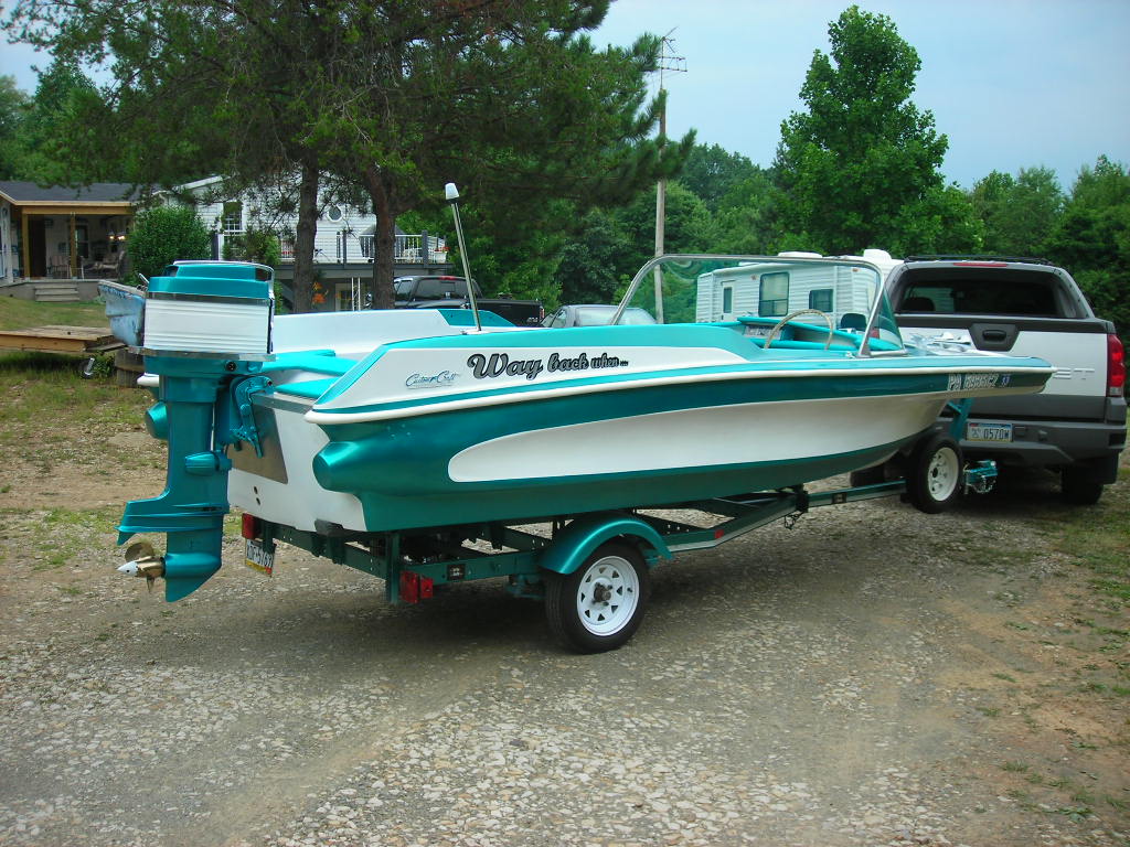

thanks bob and yahoo,at least the motor is mounted,we still have to bolt it down.
i engraved the stainless,its hard to see but its there ,lol,im just happy the motor is on,i dont think ill have it hooked up though,96 degree in the garage,way too hot even outside,its in the garage now.
i wish i had another faceplate logo though.

sweeeeeeeeet!

sue says your boat looks better than mine... :(
I AGREE...BY FAR.
Re:1964 custom craft sunray progress! 15 years 3 months ago #37051
Way too cool. I may leave the Aqua Ray under the tarp this weekend.
The maestro strikes again...

Per your uncertainty of the year on the motor.......
Your motor is a 1964 Merc 500 however your prop should be a thru-hub exhaust prop not the one you have on it now that would have been 1961 1962 and up would be the through-hub exhaust props.
The 63 and earlier Merc 500's had the triangular dyna-float covers on the bottom motor mounts and in 1964 (and up) they went to the more rectangular shape covers. The style of front cowl would be different as well it would have been the 25 anniversary style cover the one you have now is 61 through 63
She looks fantastic I can't wait to see it in the water. I wish I had a face plate and prop on hand I'd send it along.

I like it John.
It may not be the "correct" color, but it's got Mercury guts.
It looks great on the boat and it has your custom touch.
If it were mine the only thing I would change is the adress where it is stored. She is a beauty.

thank you jim,i wasnt exactly sure on the year.as far as the prop,i know its the wrong one,but the prop on this moyor is pretty bad,so i borrowed the prop off of mine,just for the show,we will get another for it after that.and thank you i know you would.

Wow, color matching that motor is like a crowning touch!
When you think about it, in the last 50 years, the motors hanging on the back of our boats were just that: hanging on the back! Never meant to blend, or be integrated to the boat.
[more often, we'd see trailers painted to match, but the motor- that was always, well, motor color]
I mean, many early motors like the Johnson Golden Javelins and Sunset Orange Mercs were beautiful, but the way John makes this motor an extension of the total package, well, it looks perfect!
Excellent work, once again. And nice visor, too!

i had the local sign shop letter the motor and the port side of the transom,i ilike it,i wanted peters decals but i waited too long and he is closed,and the hammondsport show is friday.
at least they match the lettering on the boat,lol,john
