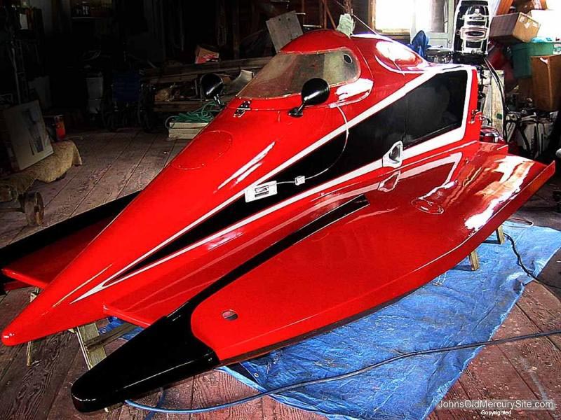

yes, I agree & Ive been using it for years, my hydros are my last 2 Rustoleum/garage jobs

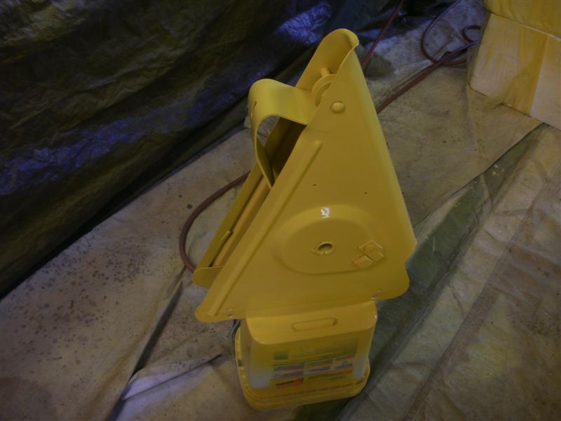

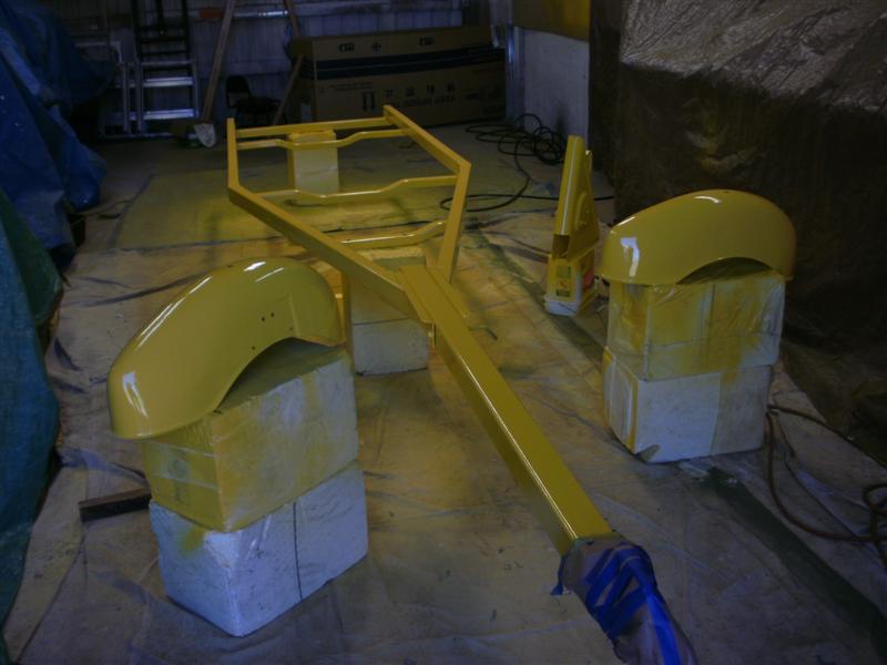

Painted my Tee Nee trailer with Rustolium "Sunburst Yellow " came out real nice and a perfect shine. Melanie (Oceans 2 ) can chime in with the specific's she did a great job of spraying the paint. I had the trailer sandblasted and I brush painted a coat of the rustoliun white metal primer on all the parts and pieces. Then sanded everything and sprayed the paint . Did not use a hardener but thinned with Mineral spirits. Trailer almost looks like it was dipped in paint -real thick and a great shine. I really like the fact they have Rattle cans available in the same color for the small pieces and touch up. I'm very happy and especially for $11.00 a quart. Nice job Melanie and Thanks for all the help ! I will post the pictures of the shine on the fenders next time I'm at the shop, these pictures are when it was still wet and is not completely laid down yet.

Re:rustoleum boat paint 15 years 2 months ago #42766
OK Rick, forget my last mail, I see the trailer pics, Turned out great, makes me rethink about the Imron. I wonder if I can squirt Rustoleum over the Imron? I could buy 5 qts of rust for the price of 1 qt of Imron.
