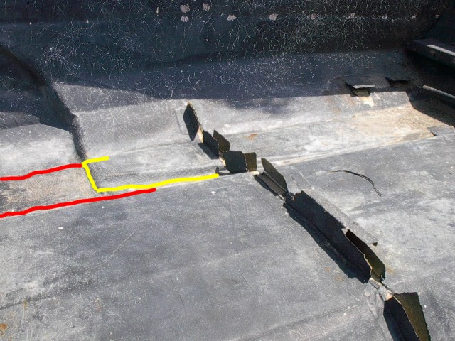

Just a couple heads ups, you may be aware of already. The top on my Manta was like under cooked lasagna pasta. It is very weak at the ends of the dash. Even with 3 people handlin' it gently it still cracked on both sides, from the rub rail lip in.
The hull has wood from the transom forward to the bow storage deck. There is additional wood from the transom to forward of the back seat, acting as a stringer. The wood in mine is in the same condition as the rest of the boat...worm food. I'm planning on access thru the outside to replace the wood with PVC.
The floor I tried to outline in red and the yellow outlines the end on the stringer.
