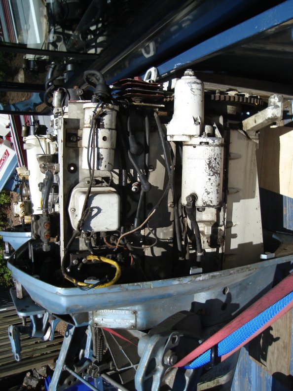

Now, here is my next Bearcat project. Like I said before, this motor is hodge podged. This cowling is a real mess. It has to be completely sanded, Bondo'd and repainted. On this hood, I think I won't use epoxy. I'll just use a good quality paint.
I can't figure out why they put some sort of screen on the top and over hung it, then filled it with Bondo. Poorly thought out and executed. Good thing they make a replacement part.

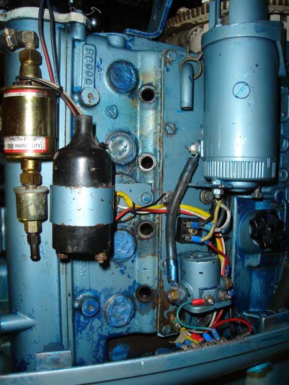

CraigLam wrote:
The wiring was a joke. The solenoid was actually mounted to the motor and if I'm correct, should be in the harness box inside the boat.
My second Bearcat's wiring was also a joke, wires hanging out all over and splices with wire nuts. Somewhere I have pictures of before and after. The solenoids are mounted on the block on all of them. Mounted on the water jacket cover with the exception of the first year which mounts on plate that is mounted on the block. There is no harness box outside of the engine.

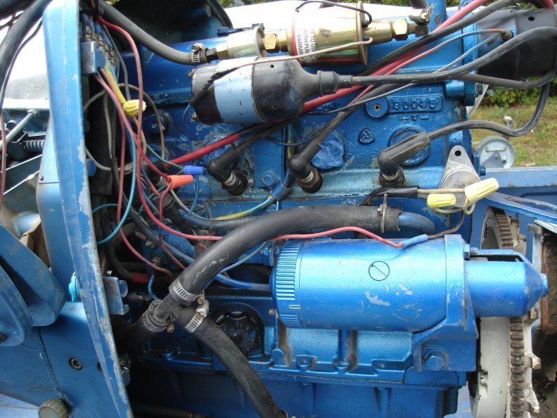

CraigLam wrote:
I had and old 59 Merlin where there was a harness box on the inside mounted on the transom.
Your motor is looks very nice. I gotta a ways to go before i get there.
Some have a harness box, but these don't. just hook the harness from the controls to the terminal strip and you're good to go.
Thanks for the compliment, it's not perfect but looks clean.
Found pictures of the "F" engine before and after I cleaned up the wiring. Also found a picture of my '61 with the solenoid mounted on the plate attached to the block.
The before
The after
