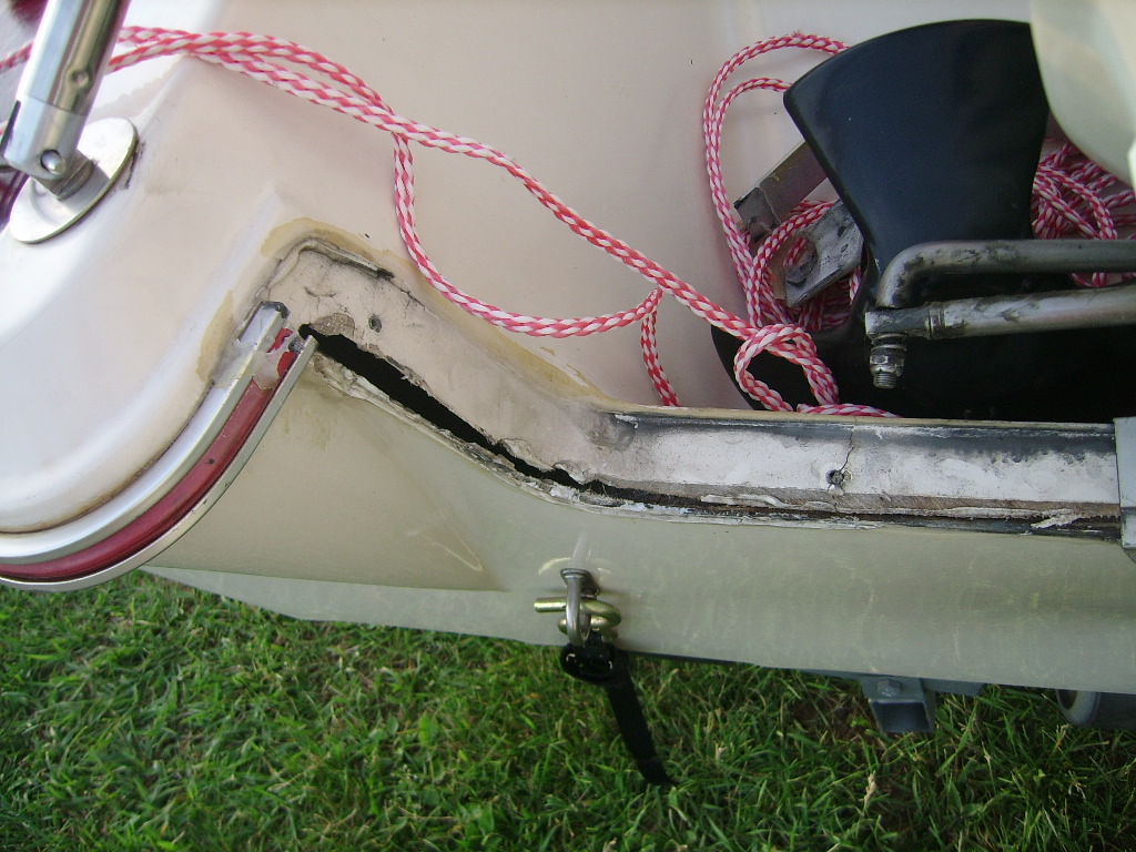

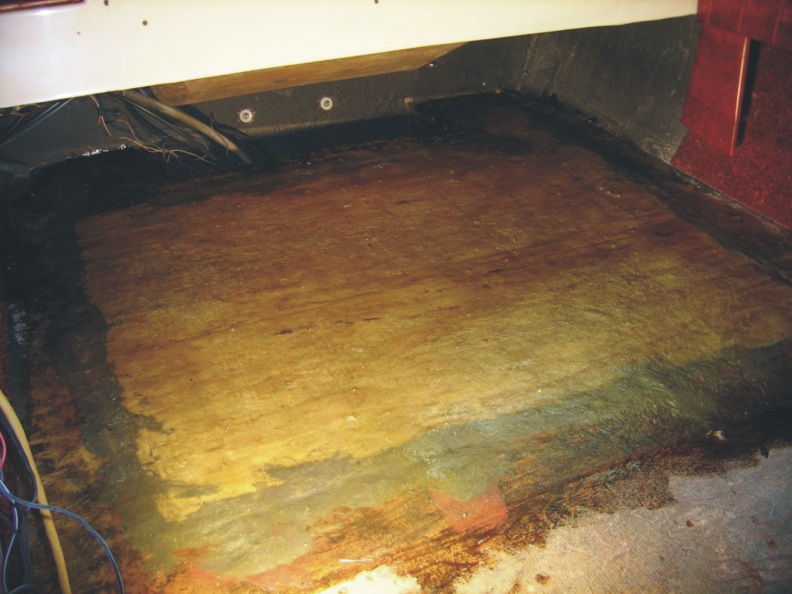

First major project was redoing the floor around the ski pylon. I knew about the damage and was the reason for the previous owner's selling. (I paid $600.00 for it) The Chrylser 105 ran perfectly and the rest of the boat was in great shape, especially the seats.
Re:1978 Chrysler Conqueror. 13 years 1 month ago #4731

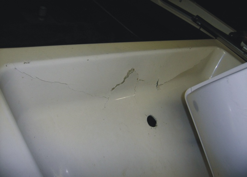

The floor had rotted out, and with three tubes on the pylon ripped out and broke the fiberglass in the engine well.
Re:1978 Chrysler Conqueror. 13 years 1 month ago #4732

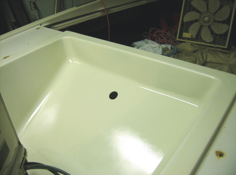

I reinforced the pylon area and cut new plywood and fiberglassed the entire floor.
Re:1978 Chrysler Conqueror. 13 years 1 month ago #4733
I refiberglassed the underside of the engine well. Then ground out all the cracks and fiberglassed the top, sanded, sanded some more then painted. Matching the paint was tough, it has a touch of beige in it!

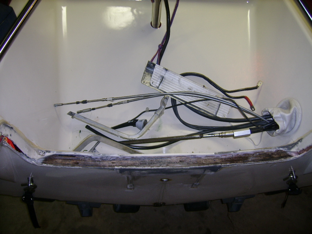

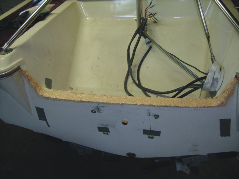

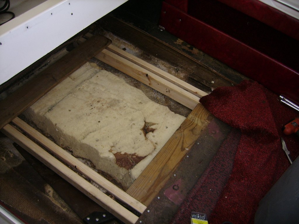

Re:1978 Chrysler Conqueror. 13 years 1 month ago #4735
After the first test out on the water, I came back with a good 5 gallons of water in the transom after only an hour on the water. After pulling off the transom covers, I quickly found the problem and had the motor pulled that same night to survey the transom integrity..........
Re:1978 Chrysler Conqueror. 13 years 1 month ago #4736
It wasn't horrible but not the best either. I started to do some research online for transom repair and found the SeaCast website. What a lifesaver. AND I got to use a chainsaw!!!!

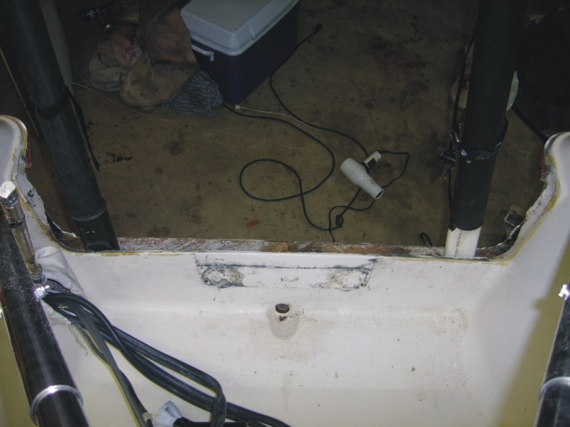

Re:1978 Chrysler Conqueror. 13 years 1 month ago #4737

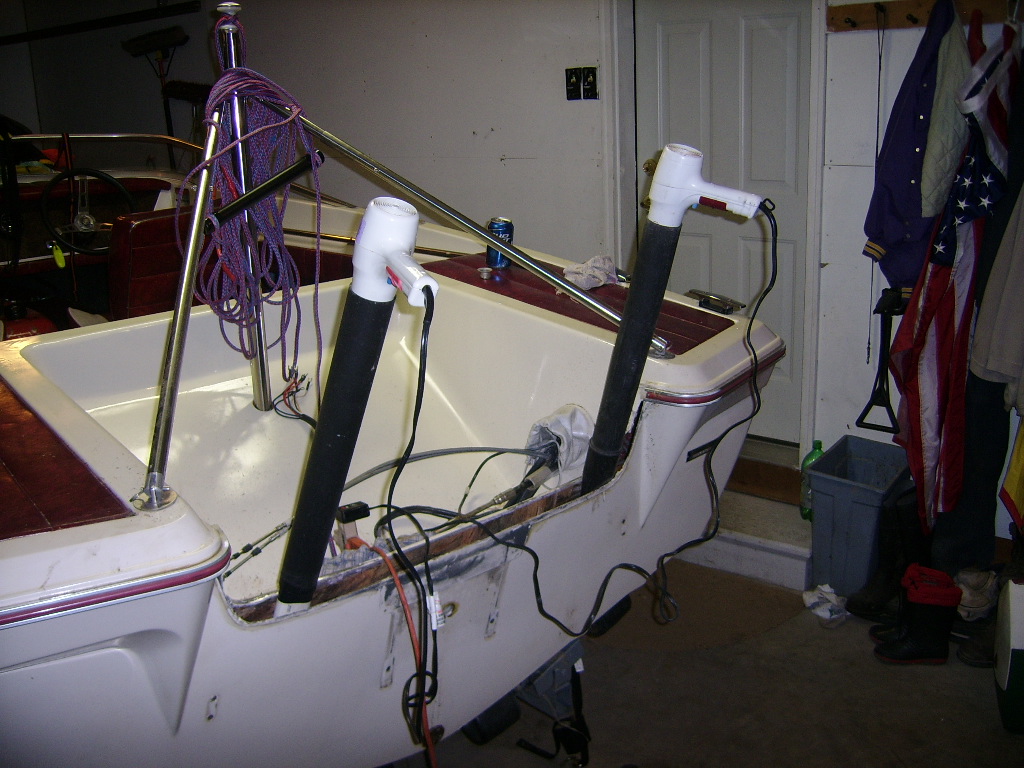

Old plywood removed, ready for some drying time. I bought two
hairdryers at goodwill and some vacuum tubes and let them run on low heat for two days. Nice and dry - a little overkill, I had all the moist wood out but didn't want to take any chances.

My dad gave me a hand with the mix and pour of the SeaCast. The stuff worked exactly as I hoped! I didn't have any leftover and it dried/cured extremely hard - there's a full five gallons of reinforced epoxy/fiberglass in the transom, about an inch and a half over 50 inches wide and all the way to the drain plug.

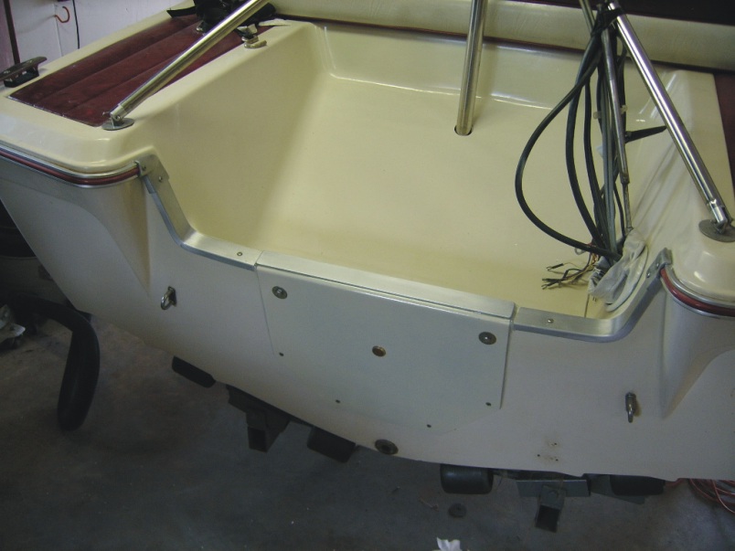

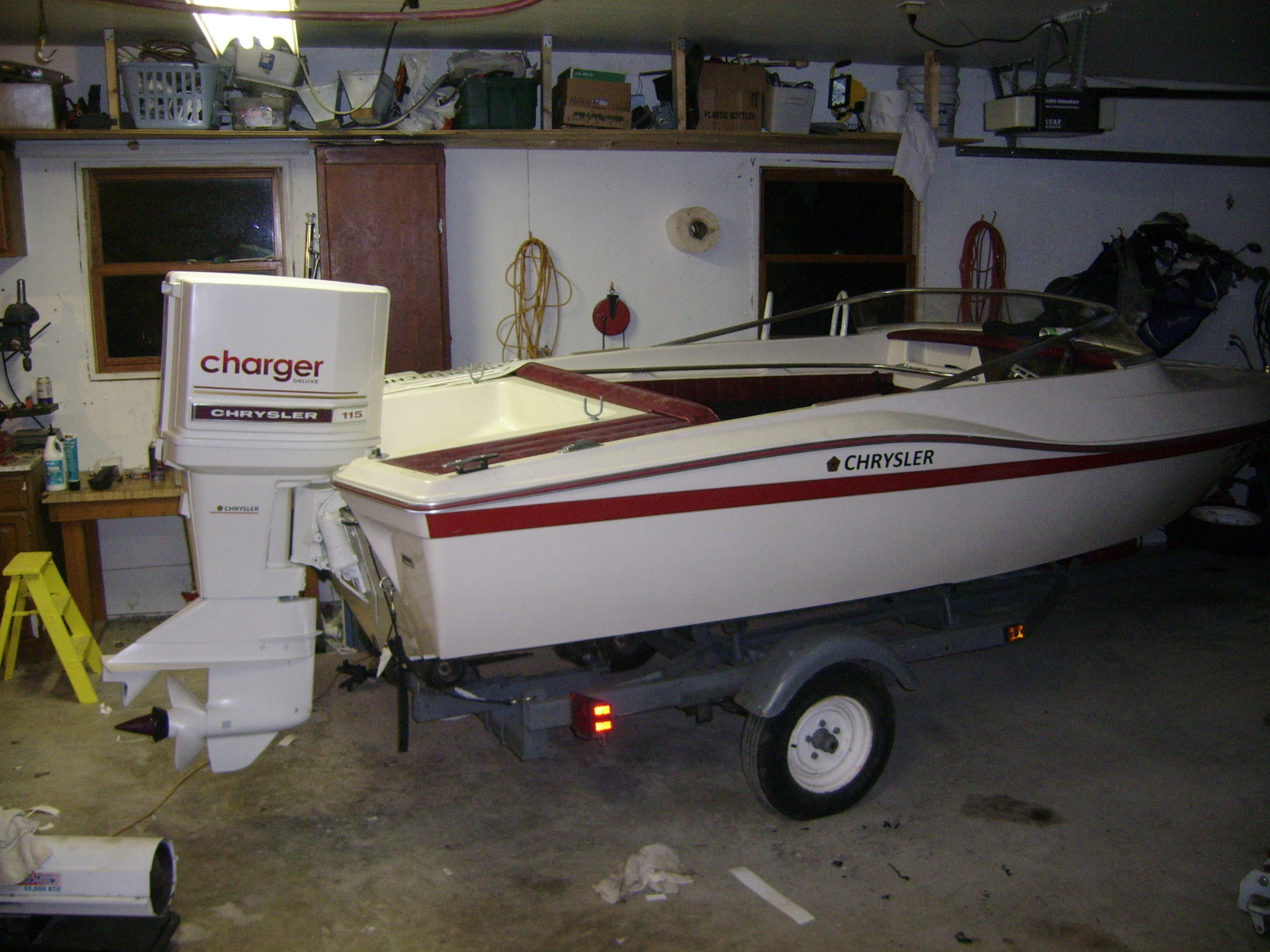

Finished and mounted. If I could have remembered to put the steering rod through the mount before I dropped the motor on the transom, it would have gone perfectly! (I did it again the other day, I'll never learn)

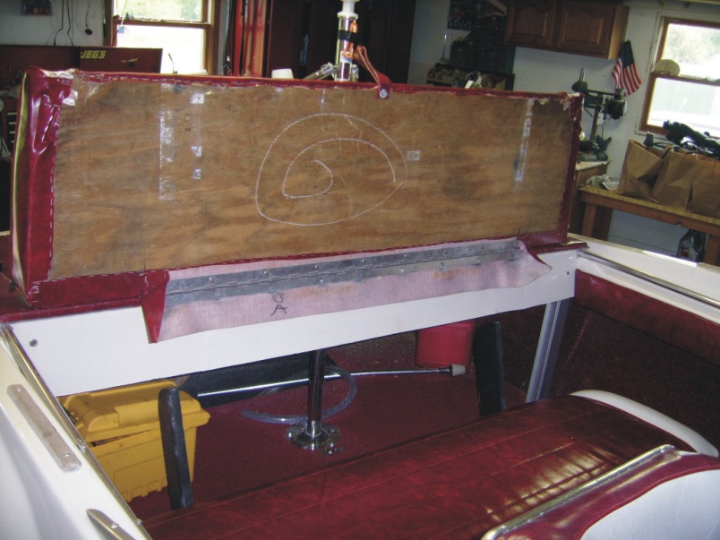

I also was working on the back seat modification. The access to the back area was horrible having to lift the seat back and bottom all as one piece. I restretched the vinyl and split the seat so you only have to lift the back. It works awesome and you don't have to kick everyone out the boat to lift the seat.

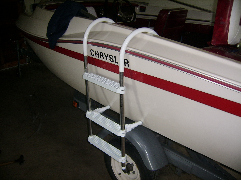

I customized the ladder a bit so the legs would hit the boat at the edge of the hull.

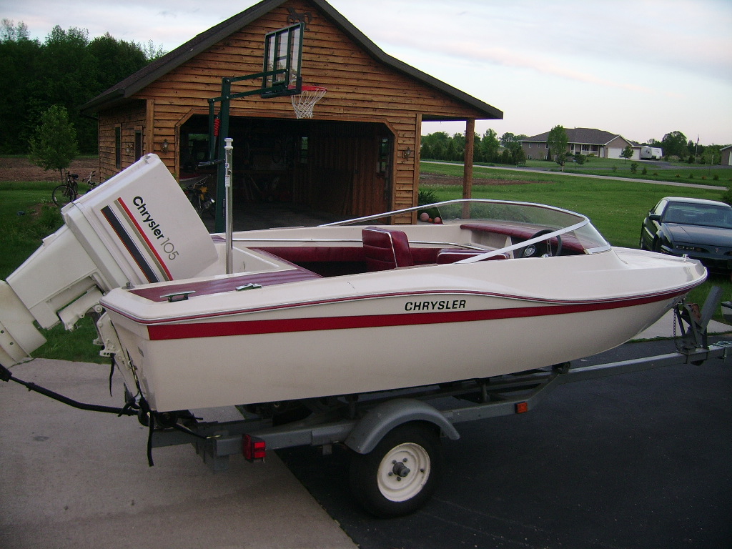

Re:1978 Chrysler Conqueror. 13 years 1 month ago #4747

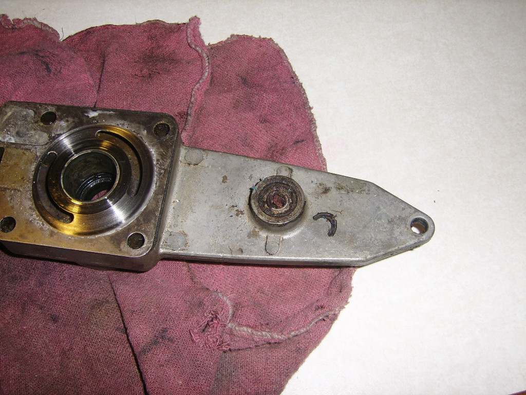

Did a lot of skiing last summer with it. Only one issue arose with it. The shifting started to get slower when engaging it. Through a great find online it was an easy fix. The washer around the shifting linkage was completely degraded and binding. Four bucks later and an hour of work - fixed!!!

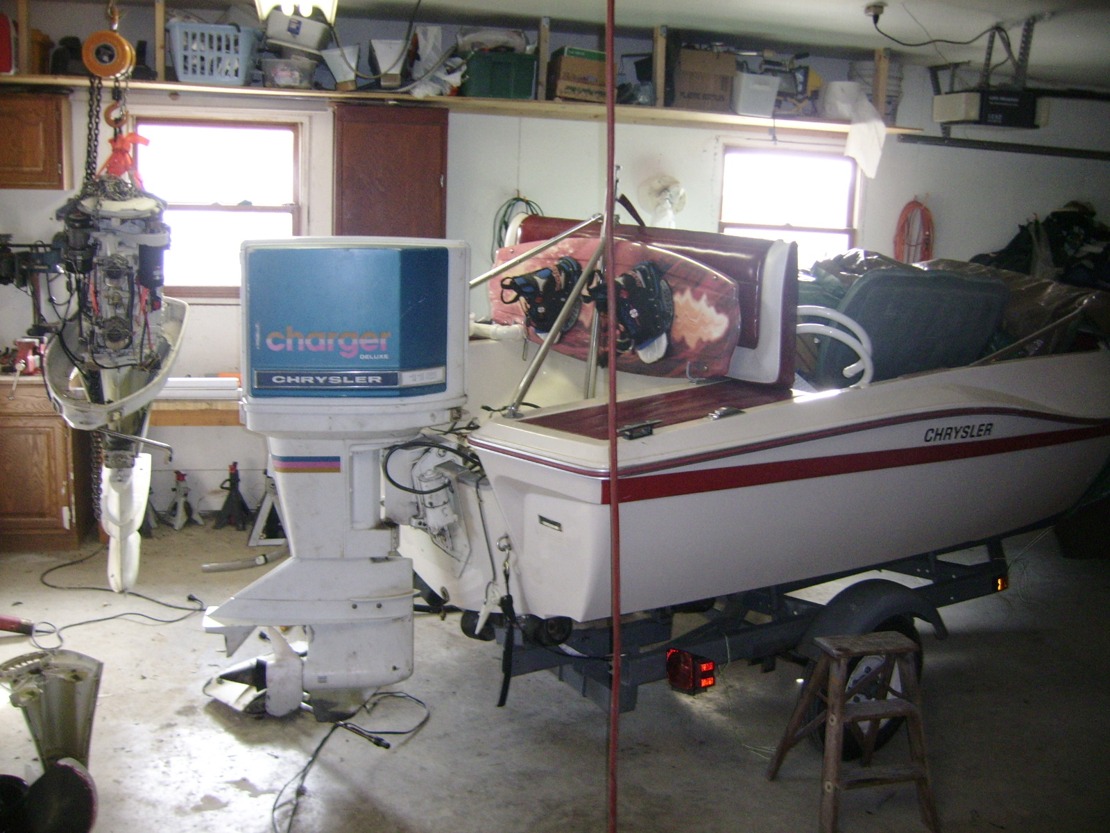

For 2010 I wanted to get the power trim from a spare motor I purchased for 60 bucks on and hooked up. It worked when I bought it but after sitting for winter, suddenly it was a no go. After further inspection, the inside of the motor cap was completely corroded and was jamming the motor. I got it cleaned out and working but found cracks in the pump housing as well. I did a quick Craiglist search and found a 1978 Chrysler Charger Deluxe 115hp motor for 250 bucks. Supposedly ran, and had working power trim. I was there the next day and bought it for 200 and crossed my fingers. After I got it home, I set it on the boat. The power trim worked perfectly and the motor fired up and ran great. I did notice that it would not shift!!!! Luckily I knew the fix already and had a spare bushing. After another test run in a tub of water everything seems to work great! Compression was at spec of 125psi, seems low but spec says 120-135, and they were all the same. Should be a fine motor, gives me power trim, ten more horses, and came with a 21 pitch prop. Looking forward to seeing it hit 50mph. I was getting 43 with a 17 pitch and 105 horses. We'll see sometime this week.........
Re:1978 Chrysler Conqueror. 13 years 1 month ago #4750

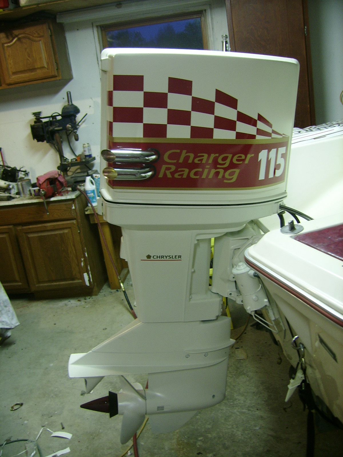

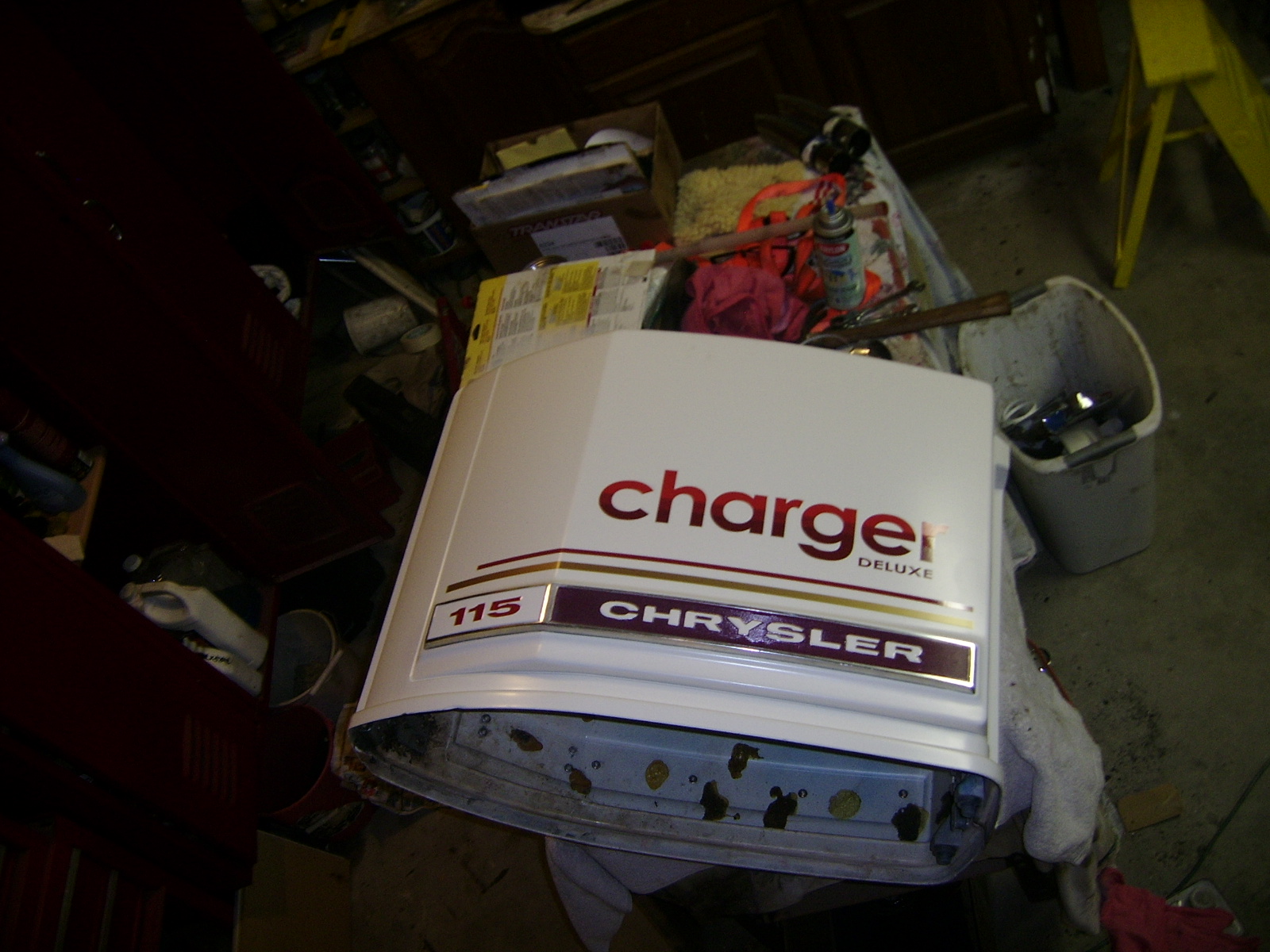

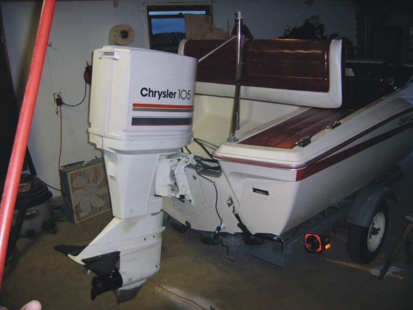

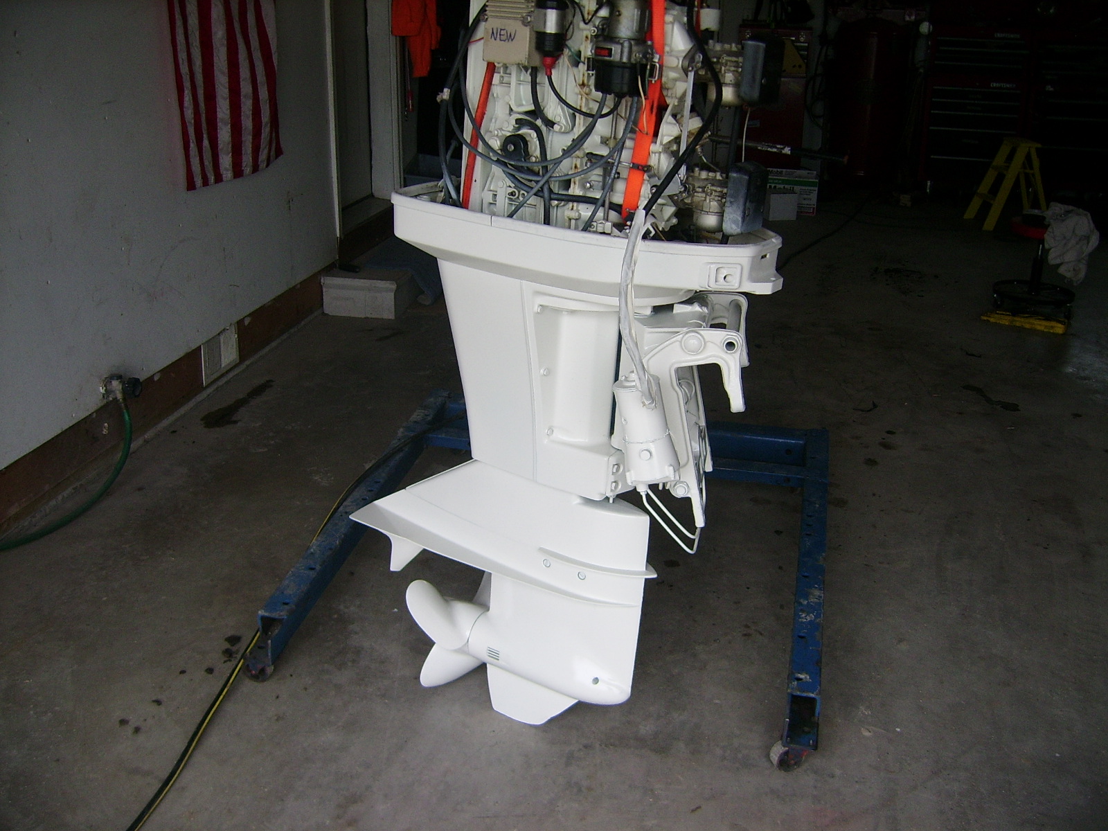

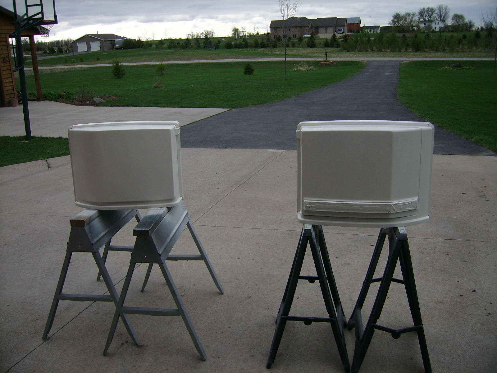

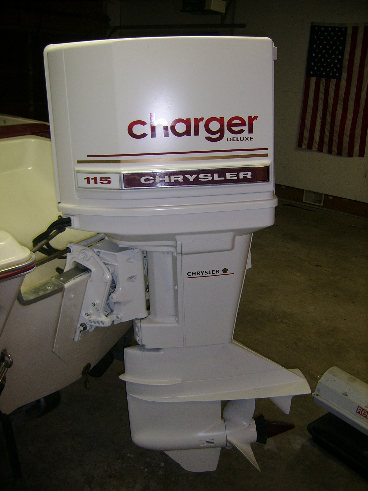

I couldn't stand the blue on the motor and had to get going on repainting the motor and cover (plus the extra one from the spare motor I bought). I kept the 105 cover and motor together and have that stored if I ever want to go back to the original.
Re:1978 Chrysler Conqueror. 13 years 1 month ago #4751
Covers.
Re:1978 Chrysler Conqueror. 13 years 1 month ago #4752

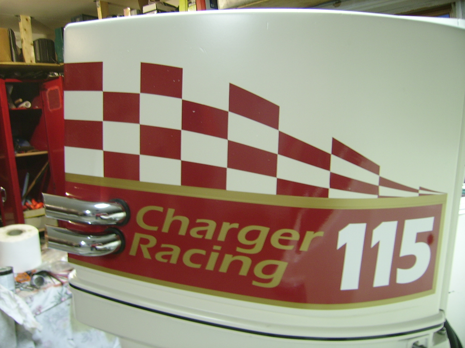

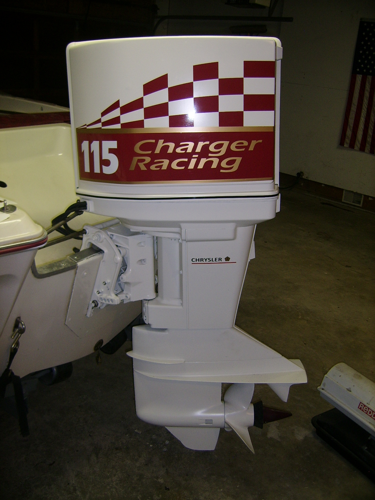

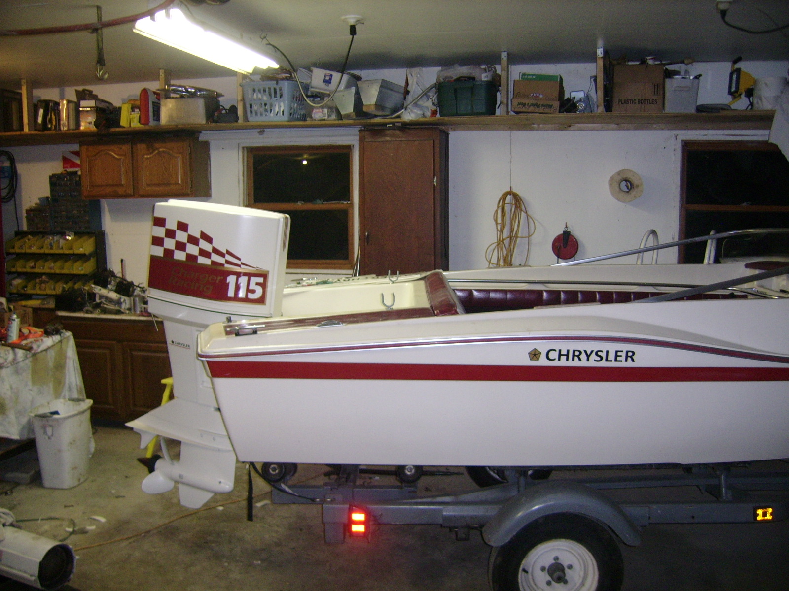

I made up some new designs for the covers that I had and wanted one that would stay true to the Charger design, but drop the blue. I made them up using CorelDraw and exported them for my sign buddy to cut out of vinyl. Here's the Charger cover. I just finished hand painting the 115 in red, and the Chrysler in white.........
Re:1978 Chrysler Conqueror. 13 years 1 month ago #4753
My son had an awesome idea of using a checkered flag for the "racing cover". I worked that into the design. Some chrome pipes will be added also once I get the second one cut correctly. I dented the second one last night so that will be another night.

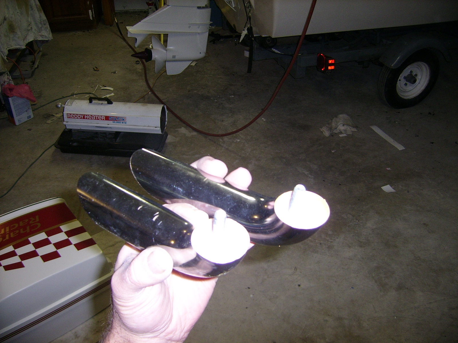

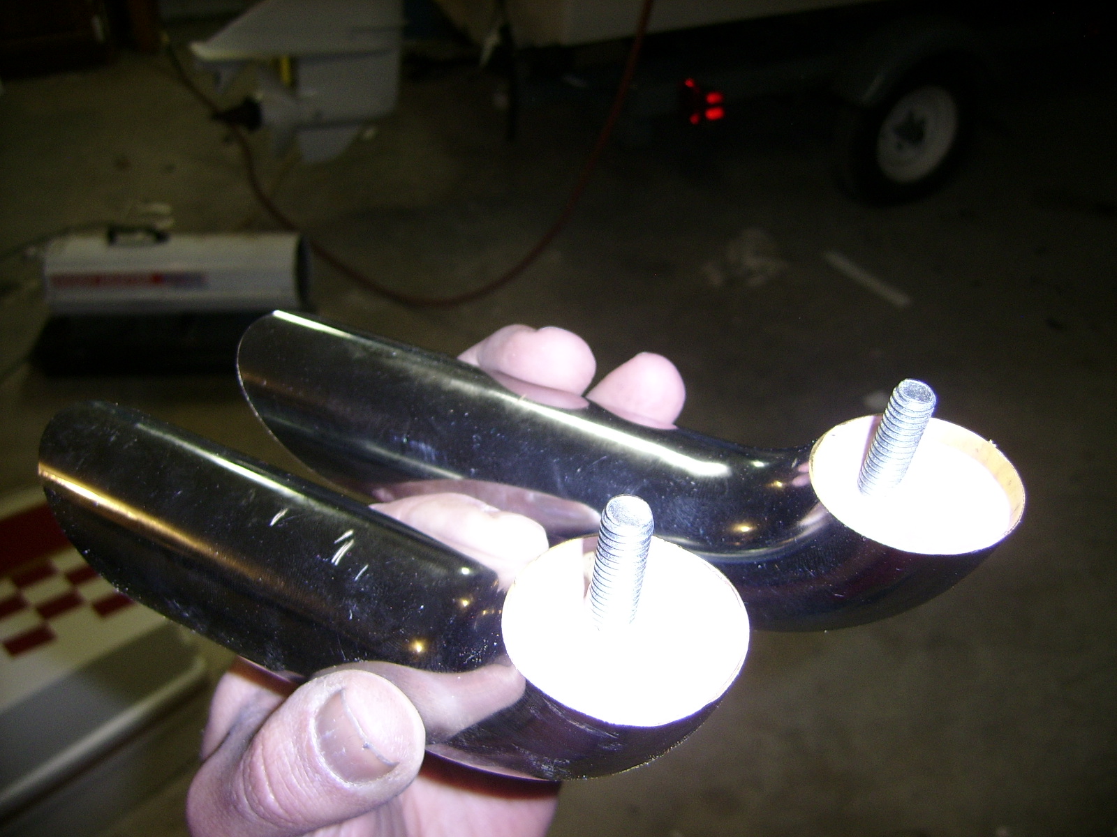

Update. I got the pipes done. This time I used my new cutting wheel setup to cut them instead of the sawzall - right tools make all the difference. I used a sanding wheel then to square them up and match the tip openings. I used bondo to fill the hole then set a 1/4" bolt inside. They hardened up nicely. I drilled a slightly oversized hole in the cover so I could adjust them perfectly.
My idea for the pipes...........
Installed!

Re:1978 Chrysler Conqueror. 13 years 1 month ago #4758
Cover pics.
Opposite side.
Re:1978 Chrysler Conqueror. 13 years 1 month ago #4759
Cover Pics.
Re:1978 Chrysler Conqueror. 13 years 1 month ago #4760
Vintage Cover.

If you look closely in the hinged seat picture, there's no gas tanks or battery in the back. The battery is relocated all the way to the bow of the boat and a new 18 gallon tank mounted under there as well, fill tube on the top deck. It makes the boat plane off much faster and pull skiers out of the water quicker as well. Plus, no switching tanks and a larger capacity than the two 5 gallons tanks.

Got the cover finished. Now just waiting on the correct throttle handle. I have a temp switch hooked up. Might have it out before that comes in, maybe Wednesday..........
